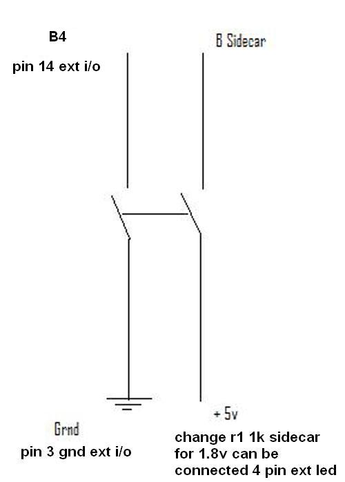

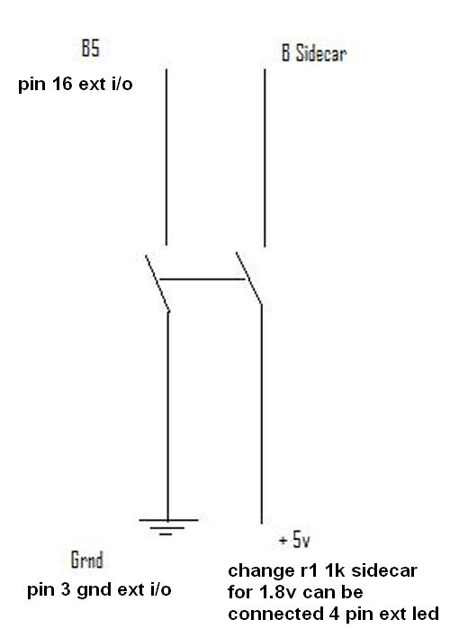

Good catch Leif. Thanks Russ! I attached a corrected image noting B4 in this post. I don't have the power to delete or change the image in my prior post but would encourage those who do to change it or delete it. Thanks!
Do I ground B4 to the chassis, VG on the Sidecar or a ground on the external I/O connector header?
I suppose pin 3 GND of the external I/O connector, Russ or Brian could you confirm?
A pic explain more than 1000 words, waiting it's correct.

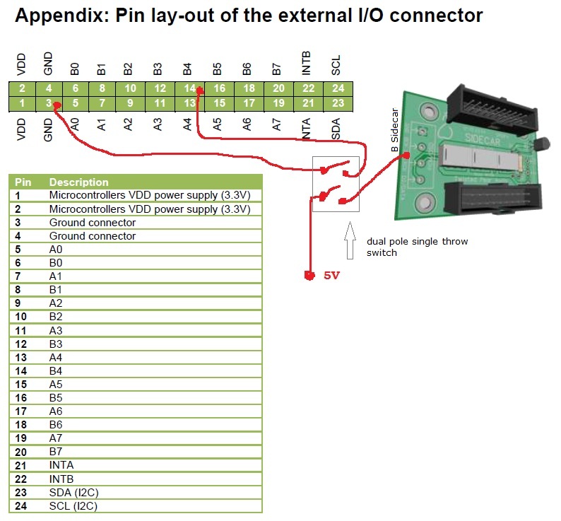

The auto-detect feature is especially prone to false positive on I2S data. This means when using sidecar that if you have the DAC SPDIF multiplexor set to receive either channel 2 or 4 (which map to D2 and D4 on DIN) it will *very* likely unlock the DPLL from time to time as it mistakes the PCM data for a new SPDIF signal and attempts to lock onto it in vain, only to once again soon re-lock on the I2S/DSD. This is especially true at high sample rates (192Khz and above).
The Buffalo III firmware exposes the SPDIF auto-detect register to the user using I/O B4. When B4 is high (default state - switch 2:5 open) SPDIF auto-detect is enabled. When low (same switch "on"/closed) then auto detect is disabled (or "bypassed" if you will).
If you wish to use the 2-bit selector to switch between 4 SPDIF sources (using the SPDIF4 module) and the sidecar to switch between I2S/DSD and SPDIF you should always pull I/O pin B4 low on the Buffalo 3 when you have I2S/DSD selected. The best way to do this is with dual pole single throw switch. One pole should be connected to GND and "B4" on the Buf III I/O header - the other to 5V and "B" on the Sidecar. In this way when PCM/DSD is selected SPDIF auto-detection is disabled. You also get to use all 4 SPDIF selections.
Cheers!
Russ
If I got it right it should all be connected as shown in the image, Right?
But where to get the 5V from?

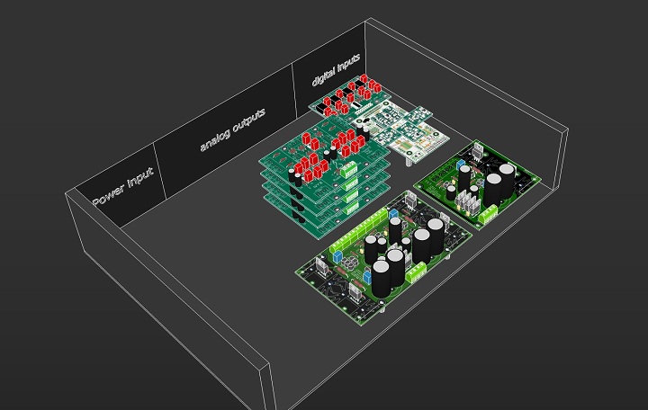

This is currently where I am with my BIII project: http://imgur.com/TxNPb The question I have is - is there an issue with the distance of the S/PDIF Switcher Board to the BIII? If needed, I could switch places with the IVY boards and S/PDIF Switcher board. I don't know if those I2S lines can be that long... will I have unlock issues?

Cool build. Perhaps you could shorten down the wires a bit by placing them like this.
Great explanatory graphic! (What did you use to make it?) I can't really mount the BIII on the side, since it piggybacks on top of a USB-I2S converter, and then my custom 2-8 channel switcher is mounted on top of the BIII.
*If* the long lines are an anticipated problem, I could always swith places with the S/PDIF board and the IVY boards, and move the inputs to the same side as well. But then, the lines from the 2-8 switcher to the IVY boards will be longer, too.
Ok. In that case I would place the dac board, the sp-dif input rca/optical etc. and those other boards in that stack to the same side of the ivy`s and align the sigma11 and sigma22 to keep the wires as short and to the point as possible (I use Google Sketchup 8 to make the 3d models).
