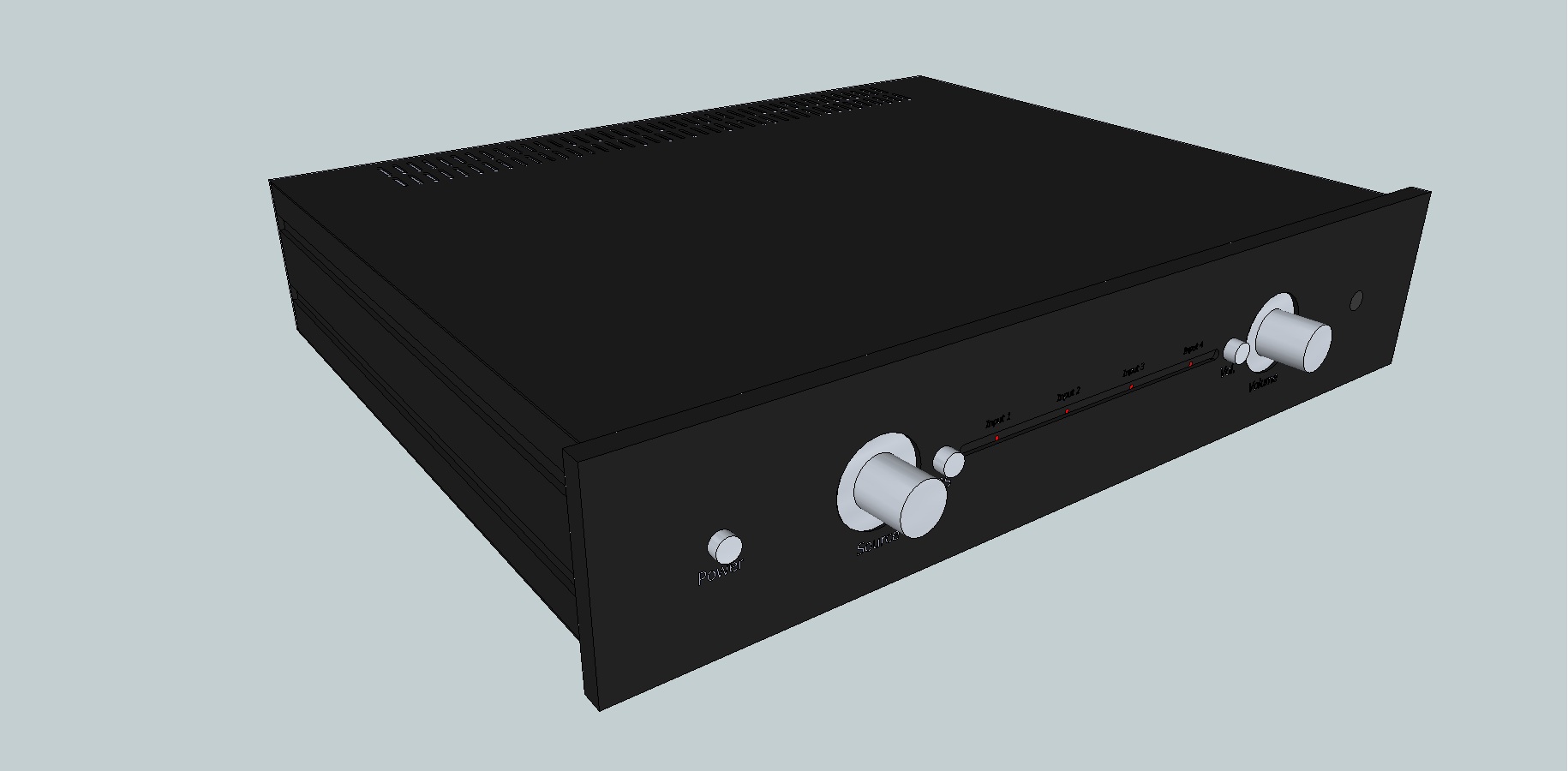

Here's the sketchup file you asked for. You also got a pm

No they are not. You just need a workaround :
Download all files and then rename them by removing the last 4 characters (.zip) from each file name. Then unzip the first file, the others will unzip automatically. I used 7zip for this, but windows standard zip will probably work just fine. I split them into multiple files because the file size exceeded the maximum allowed file size for uploading to the forum.
Most components in the design are grouped, but you can blow them up into smaller grouped items. Such a the side panels, front panel, back panel, volume control, placid HD etc.
