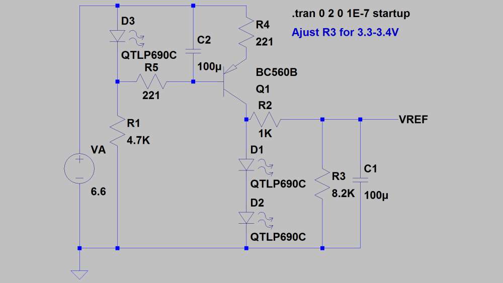

My first choice of CCS would probably not be a JFET, but it should work fine. I would probably do a bipolar type CCS. But it does take more components. Honestly just the resistor will yield excellent results as long as VA is well regulated, which it will be if you are using LCDPS.

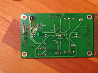

Hello
I have just finished the mod at 5.30 in the morning, it works!
I made up a CCS from a npn and a green LED. Because I did not want an additional board, I have soldered the CCS on the empty side. I cut the trace and soldered the CCS output to it. On the upper side I soldered the 2 green LEDs around C13, R4 remains, and finally I soldered an Oscon on both sides of C6 with a 10k between its legs. 10k give me just 3.4V.

rolls said:I made up a CCS from a npn and a green LED.
I think you mean PNP?
Of course you are right, just my writing is wrong.

If the simualtion is to believed PSRR should be about 105db at 60hz, and about 130db at 1Khz.
At 1mhz it should be in the 140-150db range depending on the ESR and ESL of the caps etc.
I have no idea if those results will stand in real life. But it definitely sounds really good.

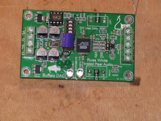

I'd like to suggest a small daughter board for Buffalos sold. Ideally this should take VA from 6-9V for those who are not on variable output supplies.
Perhaps using the LTC 6652 or Maxim 6043 can reduce component count.

Russ White said:This should be pretty good here. Now the VREF itself has much better PSRR.
This is how I am running it right now.

Sorry, I fail to see VREF in the buffalo schematic.
Where is it?

Rolls: Could you email me a higher resolution picture of the trace you cut underneath the board?
JoshauG: The vref is the feed to the opamp, you connect it to one side of C6 which then leads to the opamp. See AVR300s first pic on the last page.

Fran, did you figure it out. Rolls post 1066 says it all. Otherwise I'll gladly take a picture.

Thanks Russ, mine is now upgraded to the bipolare ccs.
