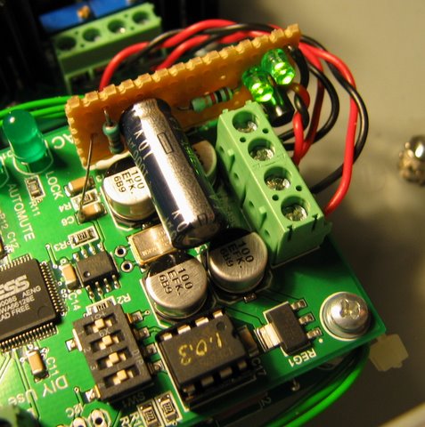

Thanks Russ. Makes a lot of sense! Noise level from 30uV to 100nV 50db lower...
Russ White said:Ok for you die hard tweakers out there. I will throw you a bone. 🙂
Here is one mod which I know will pay dividends.
Now you have a sub 100nv (I will have to measure it later but I know its quite low) noise voltage reference that is not connected to the digital supply in any way.
You still have the excellent PSRR of the LM4562 and milliohm output impedance.
Cheers!
Russ

Russ White said:Now if you really want to go crazy replace R1 in the VREF schematic with a 3-5ma CCS. 🙂
you mean the 120R?

eaoyama said:
you mean the 120R?
I think he means the 1k feeding the series leds
The simplest ccs is an n-channle jfet with Vgs=0. Would this be a suitable part http://search.digikey.com/scripts/DkSearch/dksus.dll?Detail&name=J112FS-ND?
Thanks.
Correct link: http://search.digikey.com/scripts/DkSearch/dksus.dll?Detail&name=J112FS-ND

I believe 2SK117 GR or 2SK170 GR will do:

One more here. Done with 2SK170-GR as ccs.
Don't ask yet. I don't even know if it's working or not.

Ok, so is it working ok for you? 🙂
