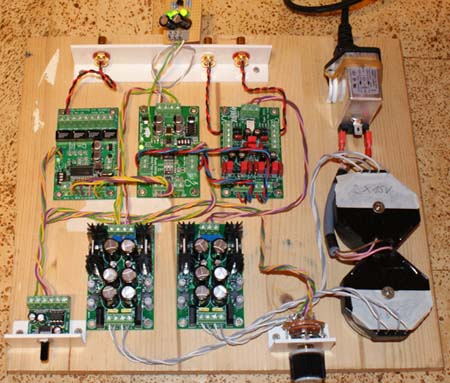

up and running!!
Hi
No big news, just wanted to say that my baby is up and running (including the new VREF). Everything worked as it should. Soldering and assembling was straight forward.
And what about the sound? All I can say: I'm very happy. To me it just sounds right - and that's fantastic. 🙂
Next thing will be a nice case - but first I'll have to sit down, take a deep breath and have some listenings.
Brian and Russ, thanks a lot for making this possible.
Cheers!
Mario
