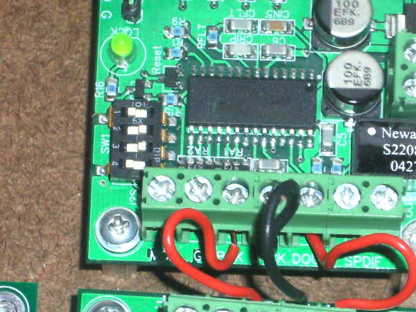

Hello
I hope there is anybody around who can help.
Yesterday I was happy, because the AV Ref mod works very well.
Then I wanted to add the MUX, but it does not work at all.
I have checked everything:
layout in the net and on the board of the buffalo are different, I don't know which is correct, I have tried both, without success.
When I follow the I2S markings on the board, buffalo locks, but the LED on the MUX is dark, even If I connected the missing ground link (I have an early board).
I have connected input one, for this select 1 and 2 are tied to gnd.
switch 1 on buffalo is neg
I have left the switches on the mux untouched.
All the voltages are O.K.
I soldered the relays that their point is on the same corner as the small white dot on the board.
When I switch to SPDIF, buffalo works, but with added clicks sometimes.
Thank you!
André

Hi Andre
If you put the I2S output of the MUX board against the I2S input of the buffalo board, the terminals will line up.
Here is a pic I hope will help.
I have GND connected elsewhere, thats why you don't see it.
Data,BCK,LRCK
Add GND if your MUX and Buffalo don't share a common supply.
Data,BCK,LRCK
Hello Russ
Buffalo and Mux are stacked,
but DOUT to D2
LRCK to D1
BKC to DCK is correct I think.
I just hear loud hiss with faint music.
Ground is everywhere. Relays are O.K?
thank you!
André

If you have a very very early Buffalo (very first run) remember that D2 and DCK are swapped.
Also, isolate the MUX itself and make sure its locking. Is the LED installed backward?
My buffalo is from the second round, the one with the hosting company problems you had.
I have removed the mux now, unsoldered and checked the LED, flat side is connected separately to ground. selectors 1 and 2 still to ground, no lock!
Slowly I start to think about to replace it with another mux.

Yes, it sound like the MUX might be suspect.
If it won't lock on its own, then there is no point to proceed with it.
I guess maybe it could be a solder bridge or a dry joint.
Very sorry your having trouble with it.

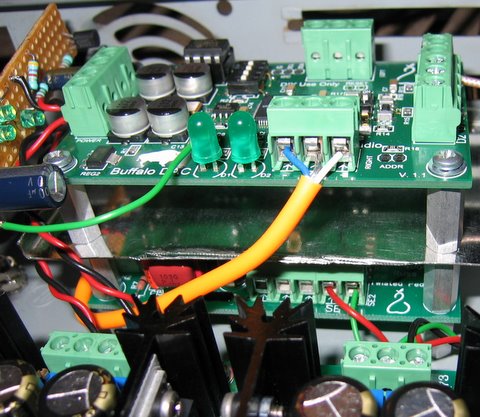

Noise problem solved
Hi guys..
I have been struggling with noise problems, cracks, pops, hiss, yes, some really nasty digital garbage.
Barely audible at normal listen level, but easy to hear when using headphones. Not constant, came and went, influenced by the touch of a finger or two.
This night I tried shielded cables between the Buffalo and the IVY - no difference.
I should say, that my setup is stacked.
Then I tried increasing the distance between the two PCB's. That did the trick. Further on I placed a shield between the two stackings.
Russ and Brian, I think stacking the Buffalo and the IVY needs to be reconsidered. The distance between them is too little with the supplied stacking hardware.
It must be radiated HF which in some way upsets the IVY.
It's just so much more revealing now, it's absolutely dead silent when it's supposed to be.
Even the sibilance is gone - which I claimed had been introduced along with the ...... wait a second ......., digital garbage radiated from the XO down into the caps, the caps of the shunt cap mod.
Anyway, look at the picture, sorry for making it ugly, but it surely sings like ... now.
Big smile - 😀

That's so strange, nothing like this is happen here.
and all my pcbs are close, including the toroidal transformer.

Hi Russ
you may not believe it, but my Mux works now!
Two strange things had happened at the same time:
Mux started to lock with another player on my workbench. Later I found out, that Buffalo and Mux probably don't use the same signal for locking. With my Denon player, Buffalo stays always locked, but Mux just locks when a disc is playing.
But even this way there was just hiss with Mux. Accidentally I found the trick:
When I flipped the tiny SPDIF input switch on the buffalo, there was music!!
Very strange, I wonder if you have an explanation.
Now the sound is better, it is a bigger step than with the AV ref mod.
Thank you for your great products.

rolls said:Hi Russ
Andr�
Yes, I can tell you why it was happening. The "SPDIF" switch pulls D1 to the comparator output. So when using I2S you have to open that switch. 🙂
I am glad it is working. 🙂
Cheers!
Russ
Re: Re: Single Side PCB PDFs for VREF
Yes take the supply from VA if you want complete isolation from VD. That is what I do.
I attached an image for the cut. It is marked black.
Good observation on the voltage. The datasheet says the absolute maximum of AVCC is 3.8V so just stay well below that. I have been using 3.5V on my latest tests(the last schematic I posted) with no issues. It at the voltage because I was to lazy to adjust it down and I wanted to see if there were any problems using it. 🙂
In practice 3.35 to 3.4V would be great and more safe.
:EDIT: here is the pic :EDIT:
Cheers!
Russ
