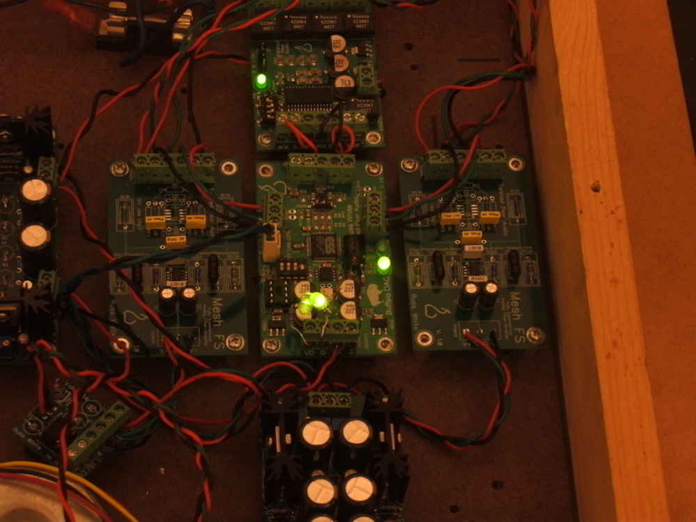

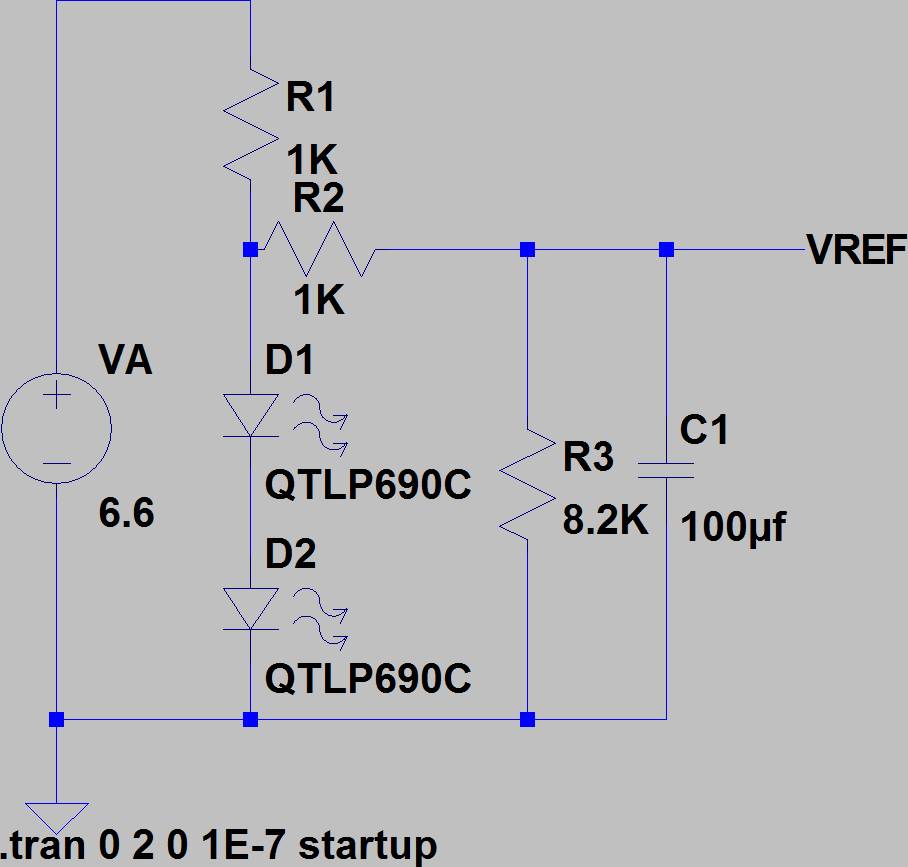

Some VREF fun...
Ok for you die hard tweakers out there. I will throw you a bone.
Here is one mod which I know will pay dividends.
It requires you cut a trace, so do not do it unless you are quite confident you can pull it off.
Near R4 on the bottom of the board there is a via, and a trace that runs to DVCC(3.3V). You have to cut that trace right near the via.
Then make yourself a little cct that looks like the attached picture.
The two LEDs are two standard green types.
The cap should be low ESR.
I solder the cap to the opamp side of C6 and the GND side of C13, but there are many ways to do it.
Ok then you simply run the ref to opamp side of C6.
Now you have a sub 100nv (I will have to measure it later but I know its quite low) noise voltage reference that is not connected to the digital supply in any way.
You still have the excellent PSRR of the LM4562 and milliohm output impedance.
Now see guys, I have fun modding too.
The next version of Buffalo will have something quite similar to this.
Cheers!
Russ

One more note, you are shooting for slightly more than 3.3V.
I got 3.4V which is just fine.
Adjust R3 to get it dialed in. Do this prior to actually connecting it to the DAC.
My experience is that the DAC sounds better when AVCC is a bit greater than DVCC. I have no idea why. But I have tried it both lower and higher and find it sounds better to me higher.
Cheers!
Russ
Cheers!
Russ
