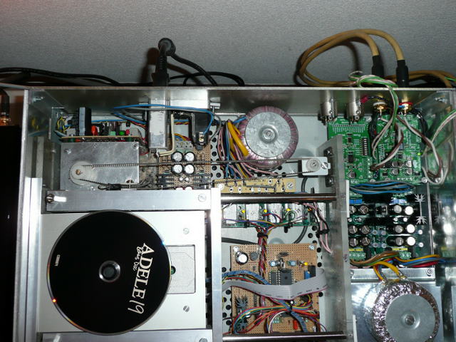

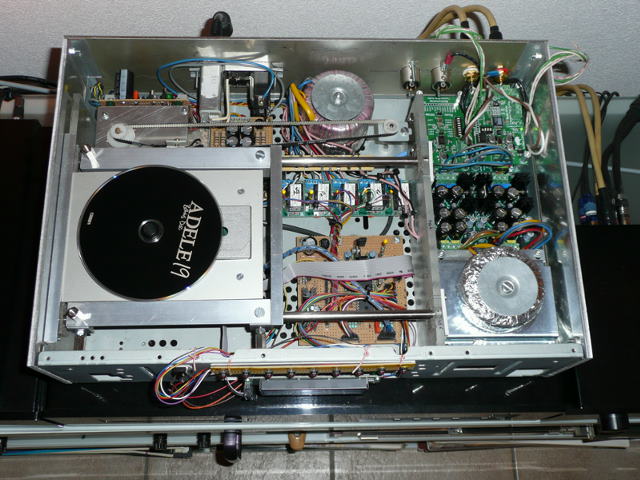

Re: TP cd Player up and running
Some context would be good - in comparison to what please?
muizel said:Sound is fantastic thanks Russ and Brian !
Re: Re: TP cd Player up and running
Hello Studley,
I spend a lot off time to listen between my Sphinx project nine
and Philips SACD1000 with APL modification, not alone but with friends and my wife , we all agreed that the sound was much more detailed and 3d without fatigue, you can listen the whole day long without feeling the need to lower volume or get irritated.
Anyway I am very happy.
