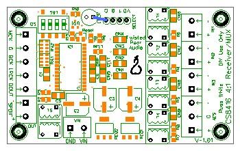

CS8416 S/PDIF MUX
I just made the prototype MUX modules available on the site.
http://www.twistedpearaudio.com/digital/cs8416mux.aspx
These are identical to the production modules except for a small error with the LED's ground pin (not connected to ground). This can be fixed by adding a small jumper wire from the LED's pad to the GND pad of the control header (about 6mm).
Kit comes with a 4-position rotary switch for selecting input. You could also rig a simple digital circuit for this, or use our AC1 when it's available.
I have about 20 of the beta boards at this price. The production boards (layout error fixed) should be in stock in a couple weeks.

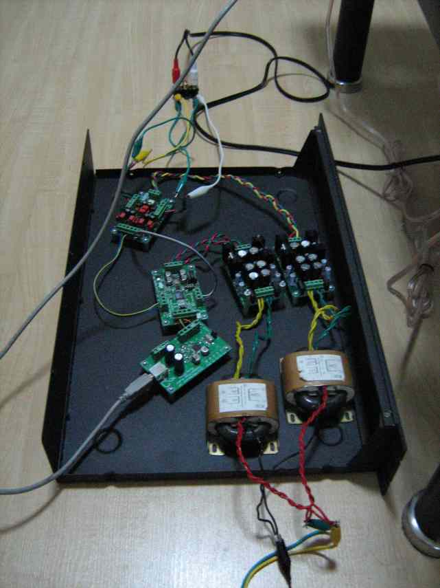

Hartono said:today I managed to hook them up and have a listen, sounds good and no shrillness
Excellent!
Enjoy!
Re: up and running
You will want to shorten up those wires between the Buffalo and IVY for final installation. The shorter the better.
