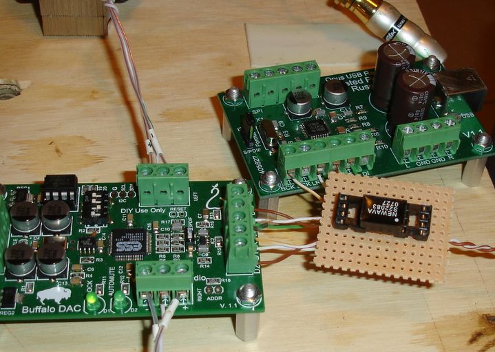

But on this DAC my pioneer universal player via the SPDIF output with digital isolation transformer is clearly better that my notebook via USB.
It is clearer, more low level detail, more open and dynamic & more 3D. In other words - much more realistic !

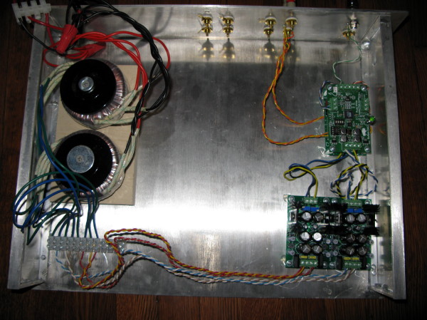

I attach a pic - you can see I added some sockects so I can try different transformers - but this one sounds fine and I notice it's same make ( but not model ) that russ & brian use.
hope that helps.
