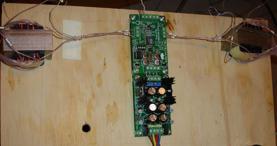

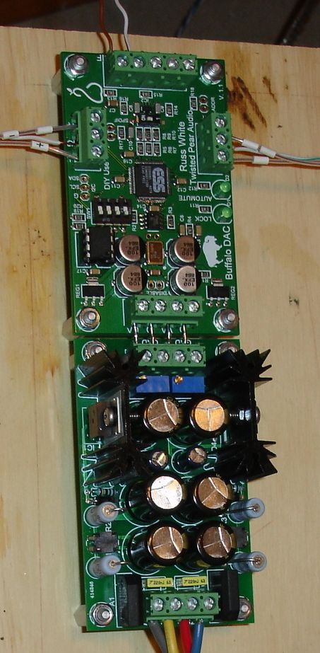

It's Alive Pic-5
And the finished product.

Re: It's Alive Pic-5
Very nice work!
Cheers!
Russ
cantskienuf said:And the finished product.
Very nice work!
Cheers!
Russ
