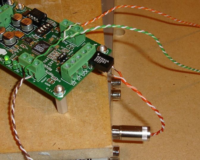

well Russ - at present I have:
DPLL - medium
Notch delay - none
and the input as shown in picture - as before, I have found a very short digital lead sounds best - the transformer does not seem to make much of a difference - but it does not make the sound any worse as far as I can hear.
It is the best so far - only very occasional crackles - so it looks like I'm on the right track.
does this mean I have a naff transport ? If so it hard to understand how it sounds so good.
my normal analogue instinct is to be as minimalist as possible but from what you have said about it sounds as if the SPDIF MUX / receiver might help this situation. Did you find that it gave better sound when you switched to it from direct SPDIF
convenience is not really an issue for me - I just want the best possible sound . . . . please advice
thanks
mike

Mikelm,
Have you tried shielded balanced cable for connecting the Buffalo to IVY?
My Buffalo had crackles noticeable on some music, some tracks was worse than others, swapping the cable for Buffalo output to IVY input from twisted to shielded greatly reduced it for me.
The cable I used was balanced mic cable +/- Screen, the screen was connected to the middle pin on Buffalo and IVY socket
It may not cure your problem but it maybe worth a try

t. said:Have you tried shielded balanced cable for connecting the Buffalo to IVY?
thanks t. - I will try it. My noise is already very occasional so this may stop it completely.
your idea makes sense to me - it may be that having transformers on the o/p is not ideal for the sabre because any noise picked up down stream gets injected back into the DAC - perhaps some kind of buffer, perhaps jfets, on the o/p would stop this because a buffer is essentially a one way device and as such would protect the DAC o/p from outside interference
I'll let you now how I get on.
mike

Mike-
What are you using as a low pass filter on the outputs? What you are hearing could just be high frequency digital hash that needs to be filtered out (part of the task Ivy performs).

my transformers have a very steep roll off at about 200KHz and the sound I am getting is really smooth, sweet & detailed so I think my amps are happy.
In my experience amps affected by HF rubbish tend to sound rough & gritty and I am just not hearing anything like that - the sound quality is actually really excellent.

Mike, all in all, I have found using the DAC with I2S input is the very best situation. I would definitely suggest trying the MUX board. Its like having an extra degree of jitter rejection. And the galvanic isolation is a big plus. Also being able to switch between four sources is mighty nice. 🙂

Mike, I am not sure exactly when the MUX will come online, but probably in the next month.
Some things I noticed about your setup.
1) Shielding is good, try putting it a case.
2) When running the balanced signal out of the DAC try braiding the three wires. Just twisting the two and running the GND wires separately will not the best for shielding.

Mike, the most important wiring to keep short and neat is the analog output from the DAC.
Also, you will have a better chance top pick up noise etc if you run those lines into a high impedance. Its much better to run them into a low impedance like the IVY are other such I/V stage.

Sure I take ur point but rolls says he tried everything and transformers sounded the best so I will persevere with them and wait for counterpoint . . .
It takes quite a determined effort for solid state active circuitry to sound as clean as good quality passive ( but it is possible ). I'm sure the passive route can be sorted out to remove these crackles and I will be interested to compare my best passive effort with counterpoint when it arrives.
I will shield & encase everything over the next few days and in the meantime I will continue to enjoy the sublime sounds ( the crackles really make it sound like analogue - hehehe )
