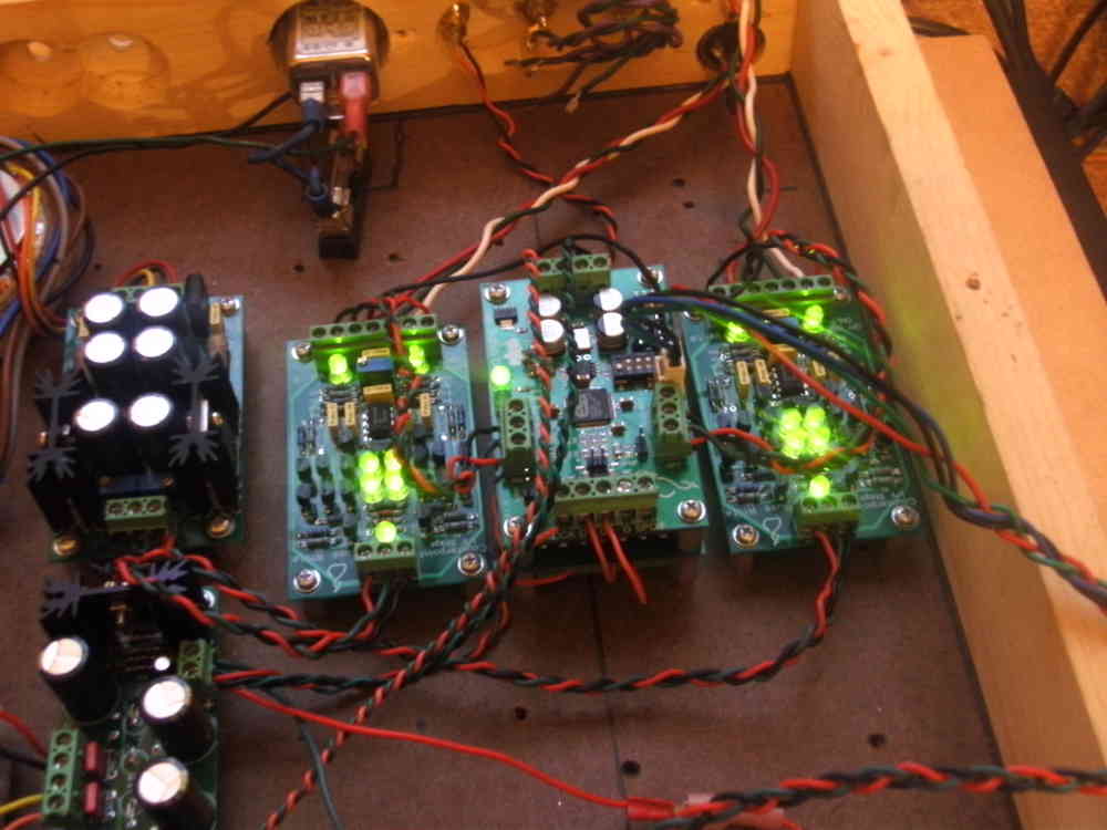

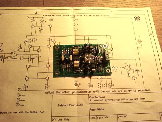

Countrepoint in action.
Counterpoint sounds very nice indeed!
I have been running it all day.
It is nice and quiet when it should be, and just sounds "right".
The counterpoint can run in two modes. Zero global feedback mode, and emitter feedback mode. I found it difficult to make the emitter feedback mode work correctly, but ZFB mode is working like a champ!
I have the input bias voltage set at 1.65V This does wonders for the buffalo!!!
Here is how it looks, the light are hypnotic. 🙂
