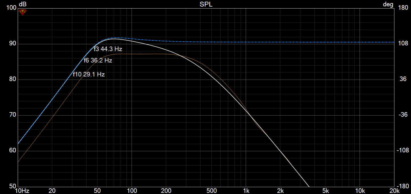

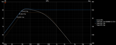

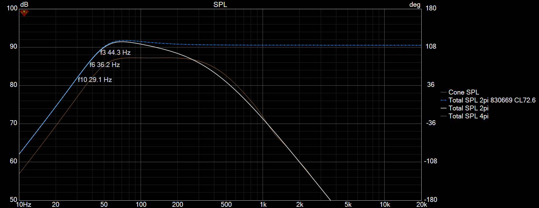

The Peerless SLS 830669 data sheet at Parts Express is from 2017. Here is the most recent (2021) on the Peerless product page. Sensitivity is a little lower, xmax higher.
Simulation in VituixCAD at 2.83V
Q = 0.90, Vb = 72.6L (larger than we want)
Blue dot-dash line is 2pi. White line is 2pi with a 2nd order low-pass filter at 350Hz, Q=0.5
Brown line is 4pi with the same LP filter, flat at 87dB.
It would seem a midrange with 86-87dB 2.83v/1m sensitivity is the minimum we should be looking at.

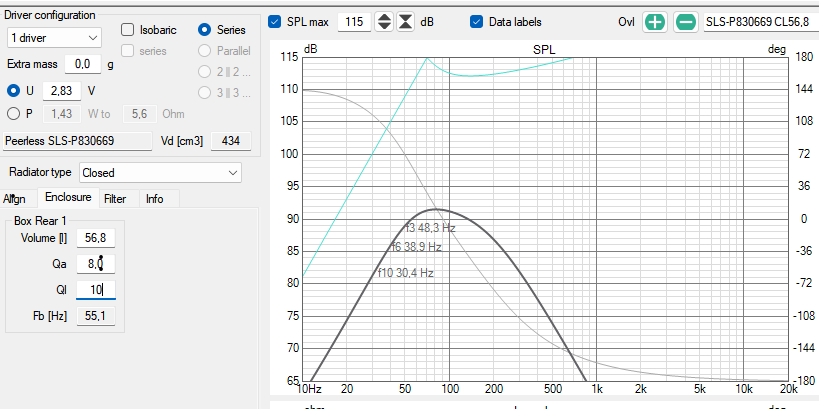

@A4eaudio , I see you have showed the baffle step (brown curve), I am surprised it is only - 4 dB at 50 Hz... , but we have indeed the -4dB circa at 100 Hz. You worked with 70 cm x 38cm width (sorry for the cm)
With the data of Dibirama (91.5 sensivity), I have 75L with Qtc 0.8 but 57L with Qtc : 0.86 (Qa: 08 ; Ql:10).
The filter for each is a 180 Hz 12Db Bessel, acoustical cut off near 220 Hz.
If 91.5/2.83V was due to the unconcistency of the unit tested by Dibirama we can indeed targett 88 dB to 90 ?!
The 87 dB after baffle step is a good result for a cheap driver like that.
Too bad no one has one to test ! Because 75L is not 57 liter.
As you can see I chose an heavily damped load with very few leaks.

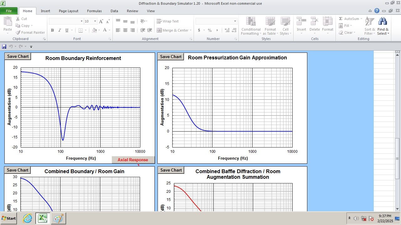

About the sensitivity. I think 87dB speaker sensitivity is the highest we need to go and what I would assume a good target.. It might be that 84dB could be better. I say that solely based on this software room response prediction. The better part of the woofers range may be seriously decreased depending on placement in the room. If this software is accurate then a lot of mid-bass could be missing. This does not take into account where the listening position is.
