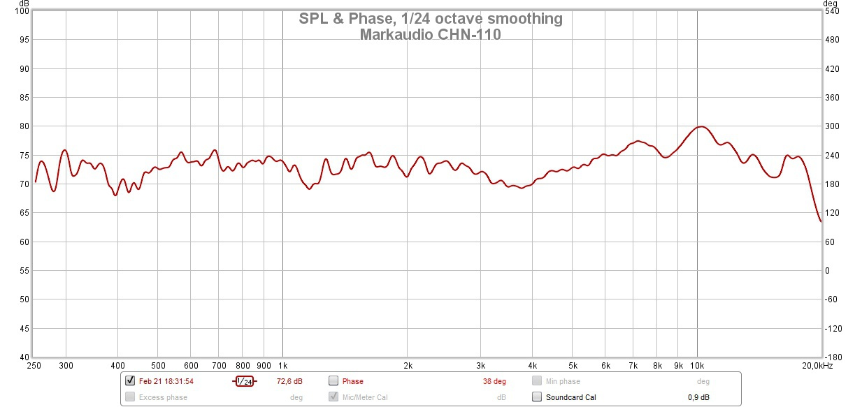

Profiguy mentioned the CHP-90 earlier, 5" paper version. It is supposed to sound very good. If the NE149W is unavailable it might be my top choice. It may not sound better than the SB12MNRX and is not as cheap as the 5FE120 but a Markaudio full range would have a uniqueness factor and the white cone would look cool 😎I don't know if you considered it, but some fullrange drivers like those from Mark Audio are also excellent midrange drivers i think. The 5.25 (in reality) CHN110 is such one, and very cheap (60€) and worldwide availeble....
Never trust spec sheet measurements is something i learned along the way. This is a third party measurement off the CHN110 from a german diy site:Exhibit A:
Mark Audio CHN110
€60

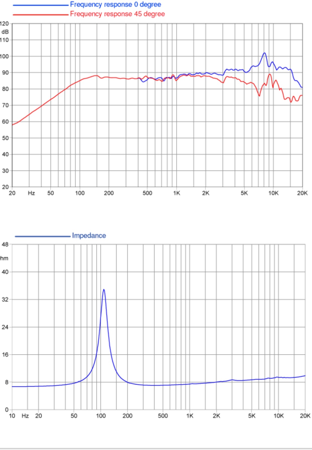

Exhibit B:
Faital Pro 4FE35-8
€26
Would you please consider reviewing what I wrote in post “how to read data sheets” and tell me which one you understand to have potential for higher performance/€, as a pure midrange in a budget classic 3- way, targeting sensitivity 87-88 dB/2.83V.
And this is in line with my own measurements that i can't post now as i'm not home. But i have this driver, and can measure it when i have time. I've already build (single driver fullrange) speakers with it and listened to it for quiet a while. I still have those.
I would agree that it is wise to verify your own samples with actual measurements, instead of relying purely on datasheets.
Datasheet may have been taken at a different point in time, taken with a different measurement method, or a different microphone.
On the other hand, people who do not have measurement capability, might benefit from datasheets.

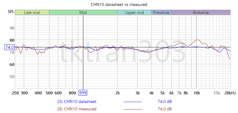

Here is that measurement, with the Mark Audio's datasheet's measurement on the single graph.
All I've done is shifted the SPL of the datasheet down to match the SPL at 1KHz. (-18.7 dB)
It would appear to me that
1. remarkable similarity between 250Hz and 5.5KHz.
2. The difference is that Mark Audio's datasheet seems to have than 1/24th octave smoothing, than the German DIY site.
3. Both datasheets and measurements could be used to estimate suitability for a midrange, since the midrange is within 250Hz and 5.5KHz.
I would prefer less smoothing.
In a pinch, a user who does not have measurement equipment could reasonable use the datasheet.

The Mark Audio CHP90 is a decent sounding driver overall. It doesn't have quite the full bodied lower mids of the NE149W, but it does do well in the imaging department as does the SB12MNRX2. The NE149W definitely has a fuller lower midrange than the others and sounds more punchy.
I would agree the frame on the equivalent Faital is pretty much a non-starter for ease of mounting. Sort of requires a rear mount to a plate that then mounts in the cab.The PRV 4MR60 looks like a very good driver.

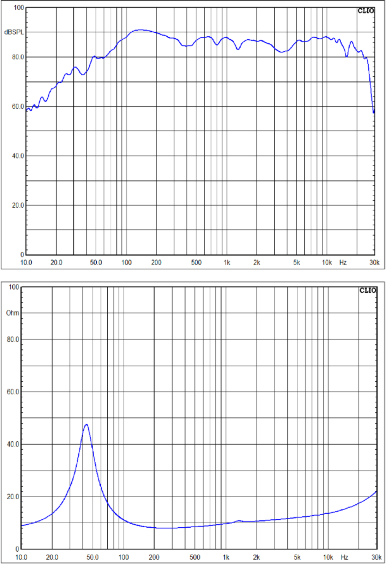

I would suspect the wiggly curve is either an echoic measurement with too little gating, or something else is broken. With a typical gated measurement down with the lowest frequency at 250 Hz or so, the second lowest point would be at 500 Hz, followed by 750 Hz. The smoothing of the blue/datasheet curve corresponds roughly to this frequency resolution, and looks overall ok to me. Not so with the wiggly brown curve, which seems amiss to me.I would prefer less smoothing.

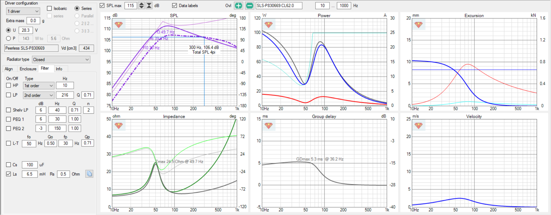

If we select the Peerless 830669, with a 4pi sensitivity of 87-88 dB/2.83V, the standard SB15NRX2 has a sensitivity of 86.5dB which comes up a little short. The shortened VC will be enough to increase the sensitivity to make it a suitable midrange.
But if the SB15MNRX2 has a sensitivity of over 90dB/2.83V, then the 830669 then becomes the limiting factor, and we may benefit from reconsidering the 830669 as the woofer.
If we want to reach as close to the OSMC in terms of performance (but a drastically reduced cost) we will need a 4” driver (or smaller) and a higher sensitivity woofer to get close to the high sensitivity (92dB/2.83V 8 ohm) and wide dispersion of the OSMC, which one of the reason's for its high performance. (IMHO)
