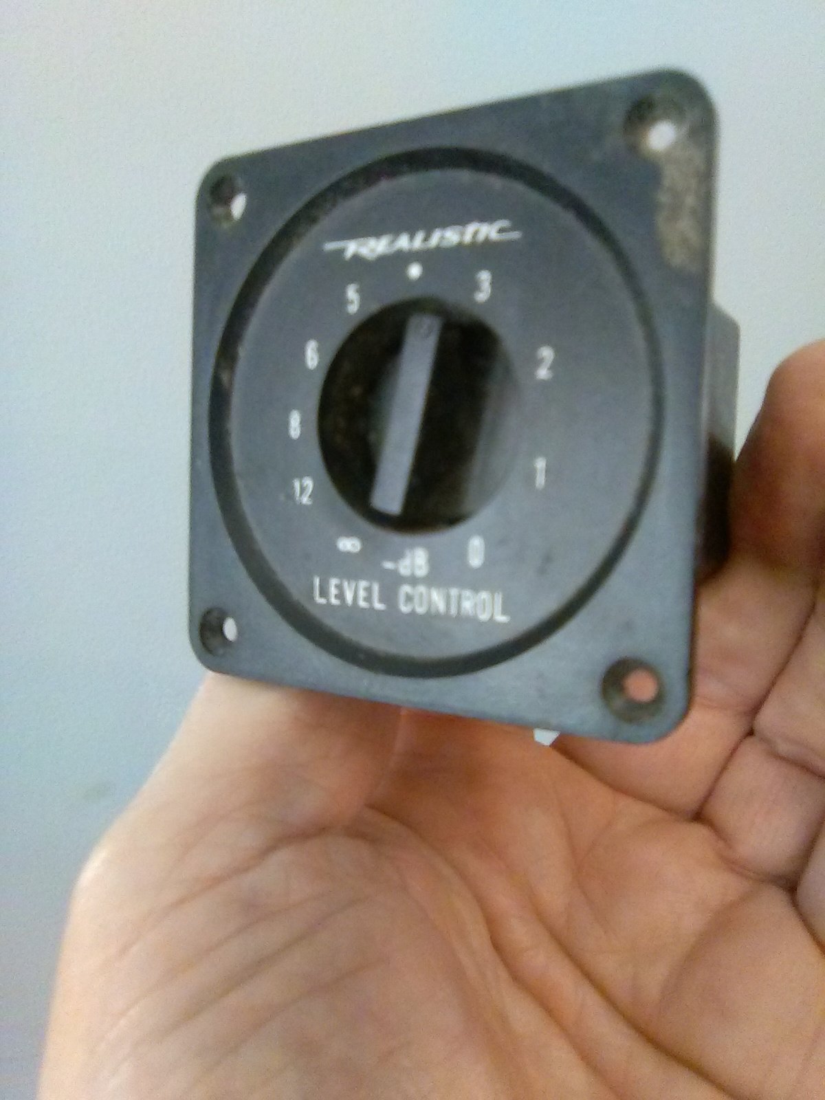

Should we include one of these in the design? My thinking is to parallel it with a padding resistor, to allow a total SPL change of 3dB or so.

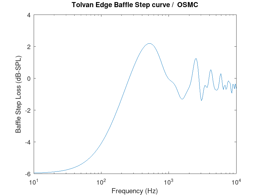

You'll need to work out the exact answer by taking a good look at the baffle step, i.e., the shape of the baffle step curve. In the OSMC project we used the Tolvan Edge calculator, which seemed to work well. You could also take a look at Fig. 2 in the OSMC paper, which shows the 4pi woofer response. This was calculated from a 2pi measurement, and then the Tolvan baffle-step model was used to convert this to 4pi.
When considering the baffle step, I highly recommend to accept that the 6 dB loss is pretty darn close to reality. I often read comments that low-frequency response will be boosted by room gain, which is of course correct, but the effect is not nearly as much as one tends to hope.
I plotted the OSMC Tolvan curve (see attachment). The curve is at -0.2 dB at 250 Hz, and at +0.7 dB at 300 Hz. This means that for 4pi you'll need roughly 6 dB more from the woofer than from the mid.
Another point is to take into account the losses in the woofer x-over, which usually has a coil or two with substantial DCR in series with the woofer. I'd factor in at least 1 dB for this, maybe more if using budget coils with higher DCR.
In total you'd want the woofer sensitivity about 7 dB than that of the midrange driver. My guess is that won't happen, and you'll have to pad the mid down to match the woofer / mid outputs.

@temp25 That Lpad you're considering costs $20 (for the 100w model, which is the minimum I'd pick). These also vary greatly in quality and precision, plus they get intermittent and noisy after a while. I'd put that money into the right midrange.
