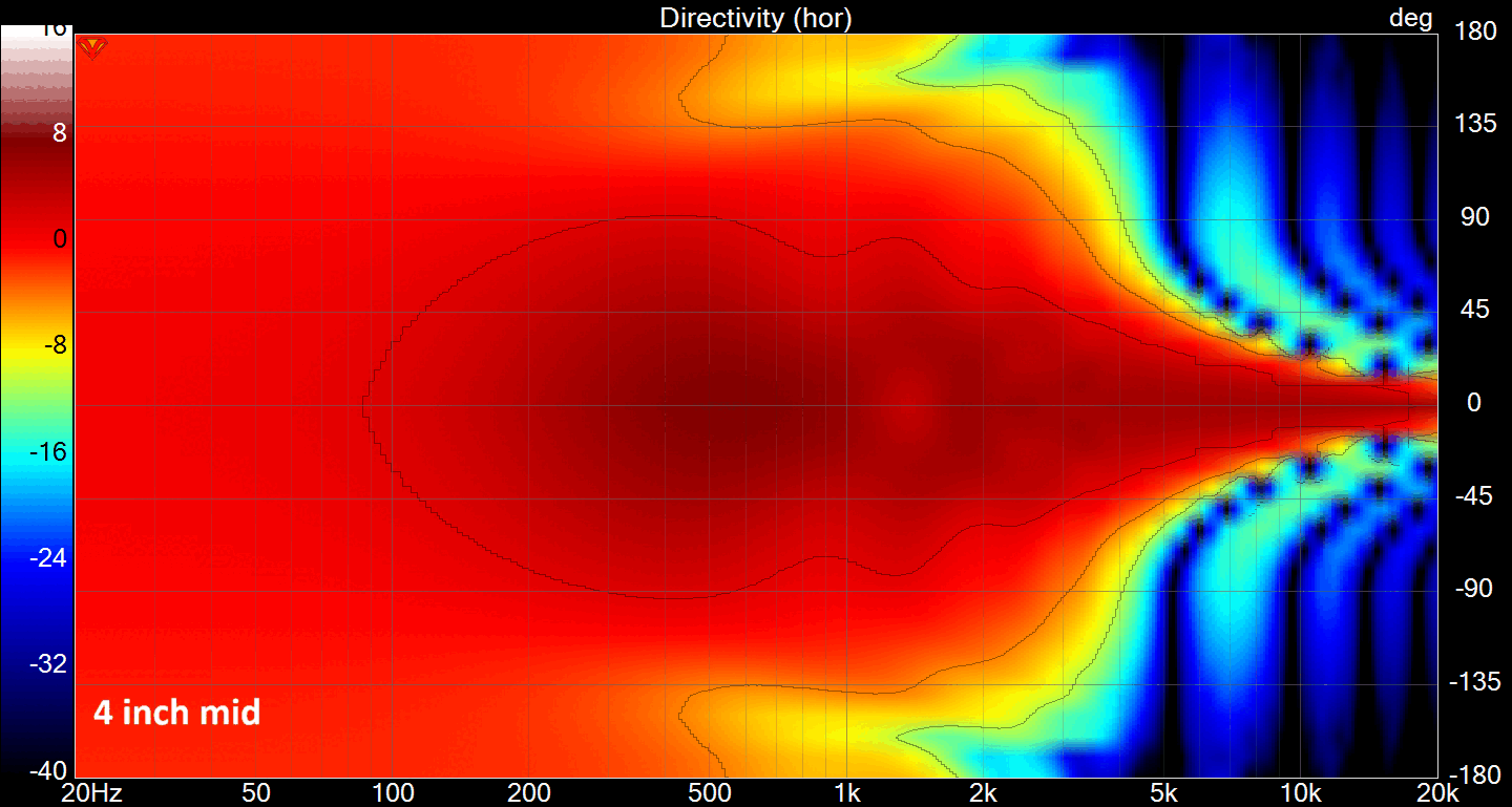

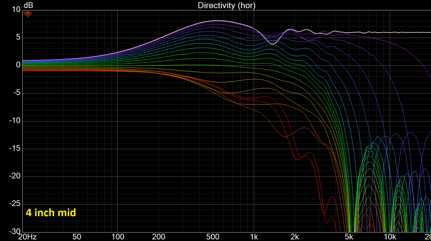

I don't quite follow. Are you saying the off axis when mounted on a 13"to 16" wide baffle is going to be any different between the two sizes?
Yes. While the cone profile and cone material can make a difference, the driver diameter will be the most important determinant of when it beams. Below are the polars of an ideal driver on a 15-1/2 inch wide by 27 inch tall baffle with the midrange placed where I think it will end up with this design. The divers are based on the Sd of the SB12MNRX, 5FE120 and SIG180.
What does the desired off axis look like?
That I don't know. It may be that a more directive (larger midrange) is actually better on this wide baffle as we get more direct radiation and less reflected from the baffle. Smarter people than me can address that.
Are the differences near the 1k to 3k range?
Yes, absolutely, see the gifs below...

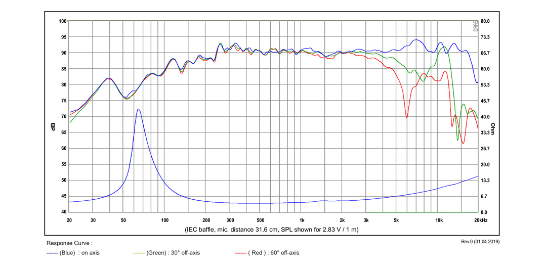

Based on the FR and impedance data, there is a slight dip/blip around 1K5 Hz, and cone breakup is significantly rises above 6KHz (60 degree off axis data), so the ideal upper limit of this driver is around 3KHz.
Reference: https://sbacoustics.com/product/4-sb12mnrx2-25-4-norex/

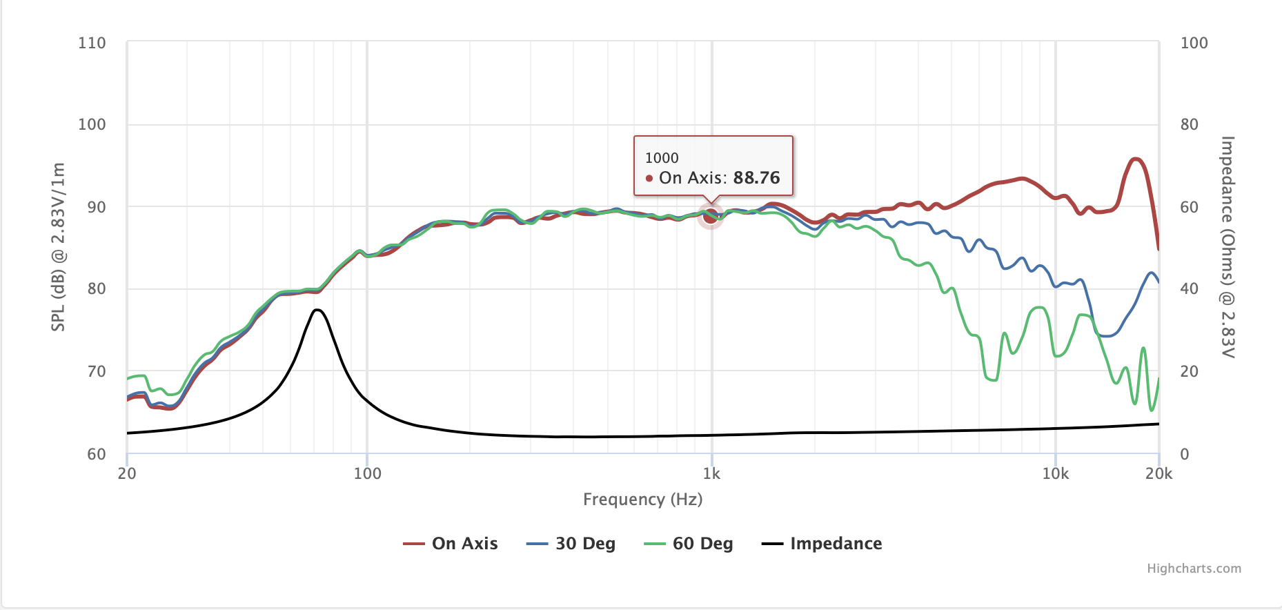

If one is to consider the SB12MNRX2-25-4, I think it would be prudent to also consider the Tymphany NE123W-4
Although this slightly lower in sensitivity (88.75dB / 2.83V (4 ohm) Ref: 1KHz), the upside is that it has slightly larger 1-1/4" voice coil wound on a titanium former, a full copper cap for lower odd order distortion.
At first glance it's frequency response may not appear as smooth as the SB12MNRX2-25-4, but sometimes it's challenging to compare because different manufacturers measure in different ways, and also display in different ways.
Here I make an attempt to scale the X and Y axis to be similar, and on closer inspection it's first cone edge dip is around 2KHz. The upper end of the frequency response becomes chaotic past 6.7KHz, so the ideal upper limit of this driver is around 3.3KHz
Please note that when I say ideal , this does not mean this is a hard boundary. Attention needs to be paid to the tweeter it's matching to and how to speaker baffle affects the response.

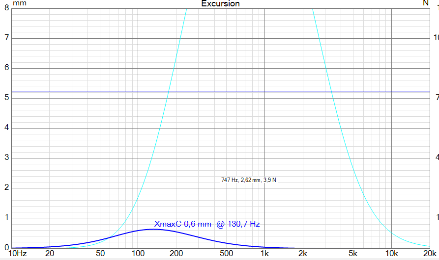

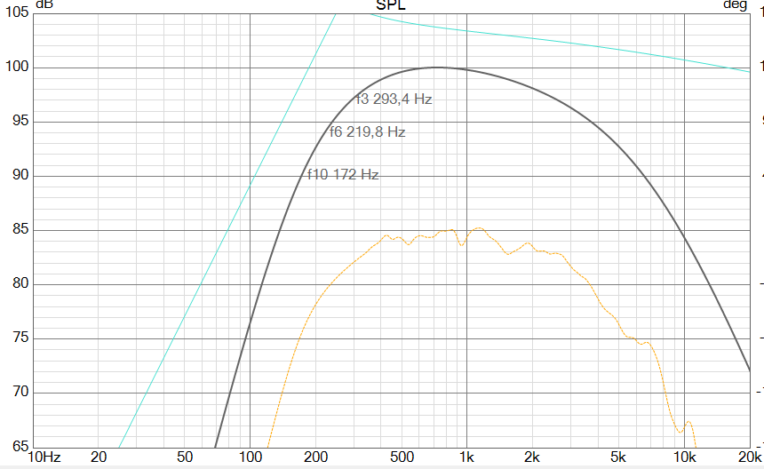

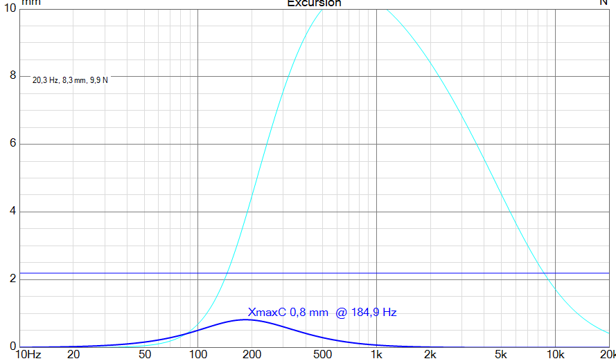

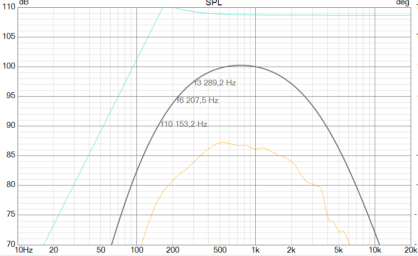

Here is the SB12MNRX in a 0.08cf sealed enclosure with no HP filter in place. Fs is 62Hz per data sheet. Is this just about natural roll-off due to the enclosure (as shown) or do I need to add a filter?
Can you explain this in more detail?
Intuitively, one of the reasons for a 3-way is to have the larger woofer handle the lower mids.
If you’ve been following @DcibeL’s adventures in FSAF testing, almost all drivers benefit from a high pass.
This evidence for me moves it from maybe to there is absolutely clear sonic evidence for a high pass on a midrange.
