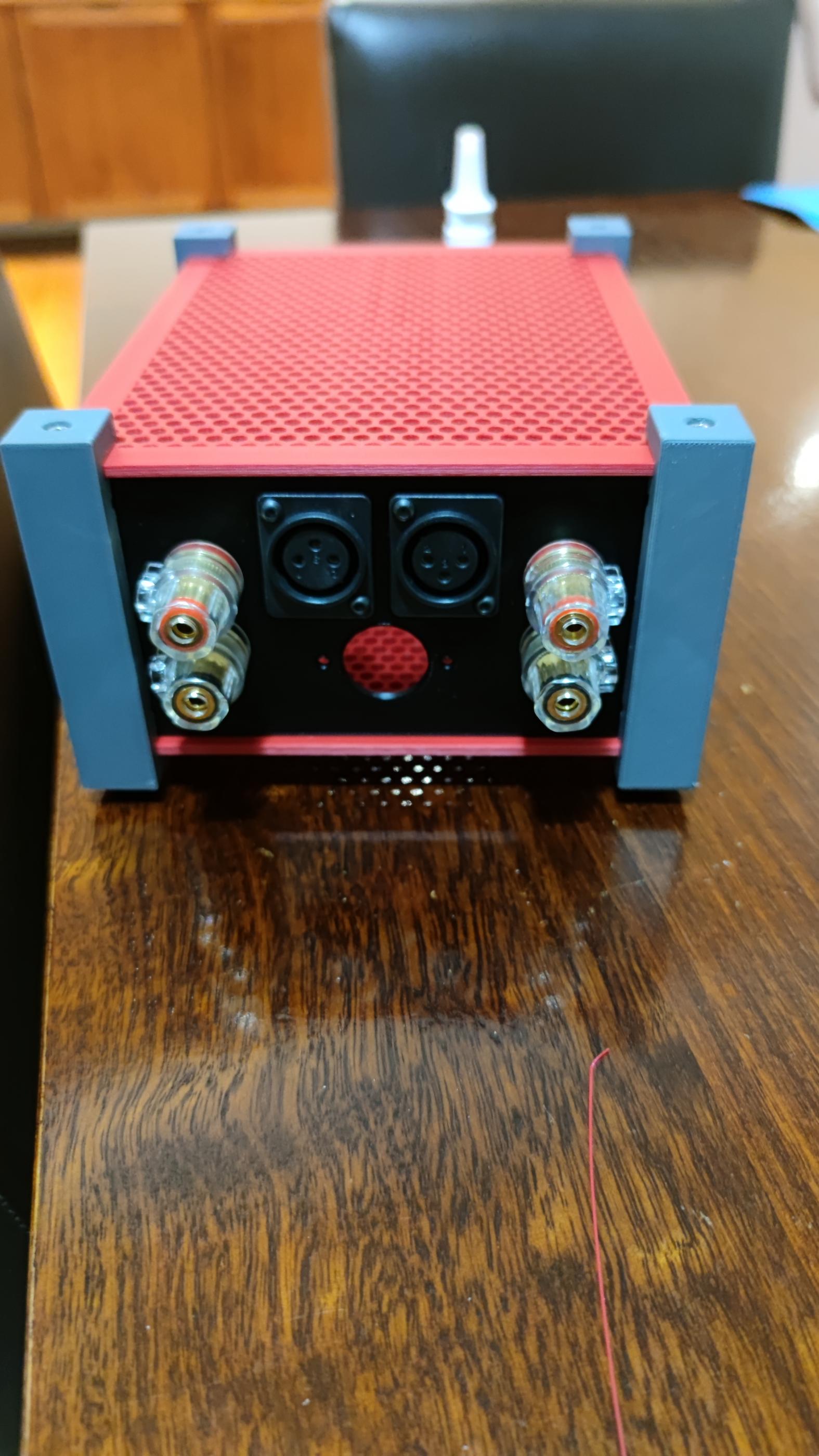

I made a 3d printed case for the TH BTSB. As XRK mentioned a very handy accessory to have on hand for connecting almost any source to any amplifier.
As finding a good quality case and drilling it can often be harder than doing the board, I would love to be able to save that precious time and use this case.
Especially because I need/ want several BTSBs

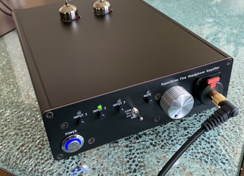

Another way we can do this is to have me make custom PCBs as front and rear panels that will fit a standard Hammond case. That’s what Jhofland has been doing to make front and rear panels for our prototype headphone amps. They can even be covered with copper for RF shielding as they are PCBs. I just saw today that JLCPB is offering aluminum PCBs for $2 and will drill holes as small as 1mm. Now that might be an interesting option as wel.
Here’s an example of how a PCB can be made to have holes and lettering for a Hammond case. This is a hybrid tube/SS headphone amp capable of 5w into 32ohms that we have been working on:

Yes happy for anyone to use it. Files are stl which is a common standard. 3d builder which is part of windows can open them.
Love the case and wish I had a 3D Printer !!

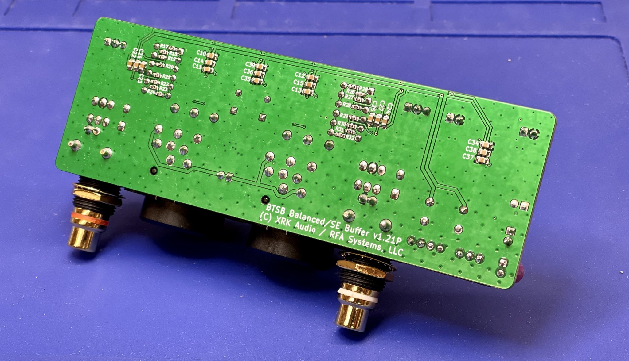

When you soldered up the board did you manage to solder the pads on the Balanced Driver ICs as well as the pins ? I am just worried about cooking the IC !!
To solder chips with belly thermal pads (LME49724 or OPA1656 etc) s l as it’s best to use solder paste and hot air. You could use paste and iron if you apply a large chisel tip iron to the vias beneath the belly pad. Still use solder paste. The chips are pretty rugged if you only heat them for under 10 seconds to temps that melt solder. If you use low temp solder (165C) that’s even safer.

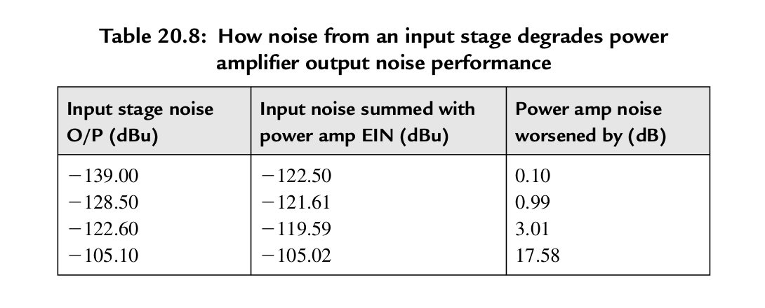

- Doug Self talks about how the conventional single op-amp balanced input circuit has a lot more noise than a single-ended input voltage follower, because of the Johnson noise of the resistors. We are not using any of his four-opamp and eight-opamp designs to cut the noise, yet we are getting pretty low noise. How is this happening? Is this because we use newer opamps than his NE5532?

Why is it low noise? NE5532 is a good part but is all BJT technology. I think the OPA1656 has MOSFET inputs. OPA1642 can also be used and is even quieter with JFET inputs. I’m not sure the noise of the NE5532 is that audible is it?

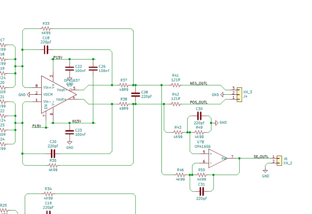

In the schematic, it seems that the inputs of the U7B opamp are coming from the balanced line driver outputs just before R41 and R42. So if I omit the balanced line driver chip, will the U7B work? Or will the signal reach U7B via R33 and R35?
The book illustrates the impact of the input stage noise on the overall power amp noise through this table:
He then goes to design multi-opamp balanced inputs which really cut down the noise of the input stage. He explores other low-noise opamps too, beyond the NE5532. He also has such an input stage on his website: http://www.signaltransfer.freeuk.com/lownoisebal.htm
I was wondering how we are getting low noise in our balanced input circuit without all these techniques.

My doubt comes from the output stage of the circuit:You can leave balanced driver off if not needed. Or leave SE out if not needed.
I'm no expert. I was just referring to what I've read in Doug Self's books. If you see his Audio Power Amplifier Design Handbook (5/ed, 6/ed, take your pick), you'll find a chapter which talks about input circuits, and there he discussed balanced input circuits. He first shows a balanced circuit with just one opamp and passives, and then says that this is far worse than a single-ended input with one opamp. In his words, "the noise output of a 4 x 10 k balanced input amp using an NE5532 is -105.1 dBu, which completely swamps the power amplifier EIN and degrades the overall noise performance by 17.5 dB."Why is it low noise? NE5532 is a good part but is all BJT technology. I think the OPA1656 has MOSFET inputs. OPA1642 can also be used and is even quieter with JFET inputs. I’m not sure the noise of the NE5532 is that audible is it?
Hope I'm making sense?

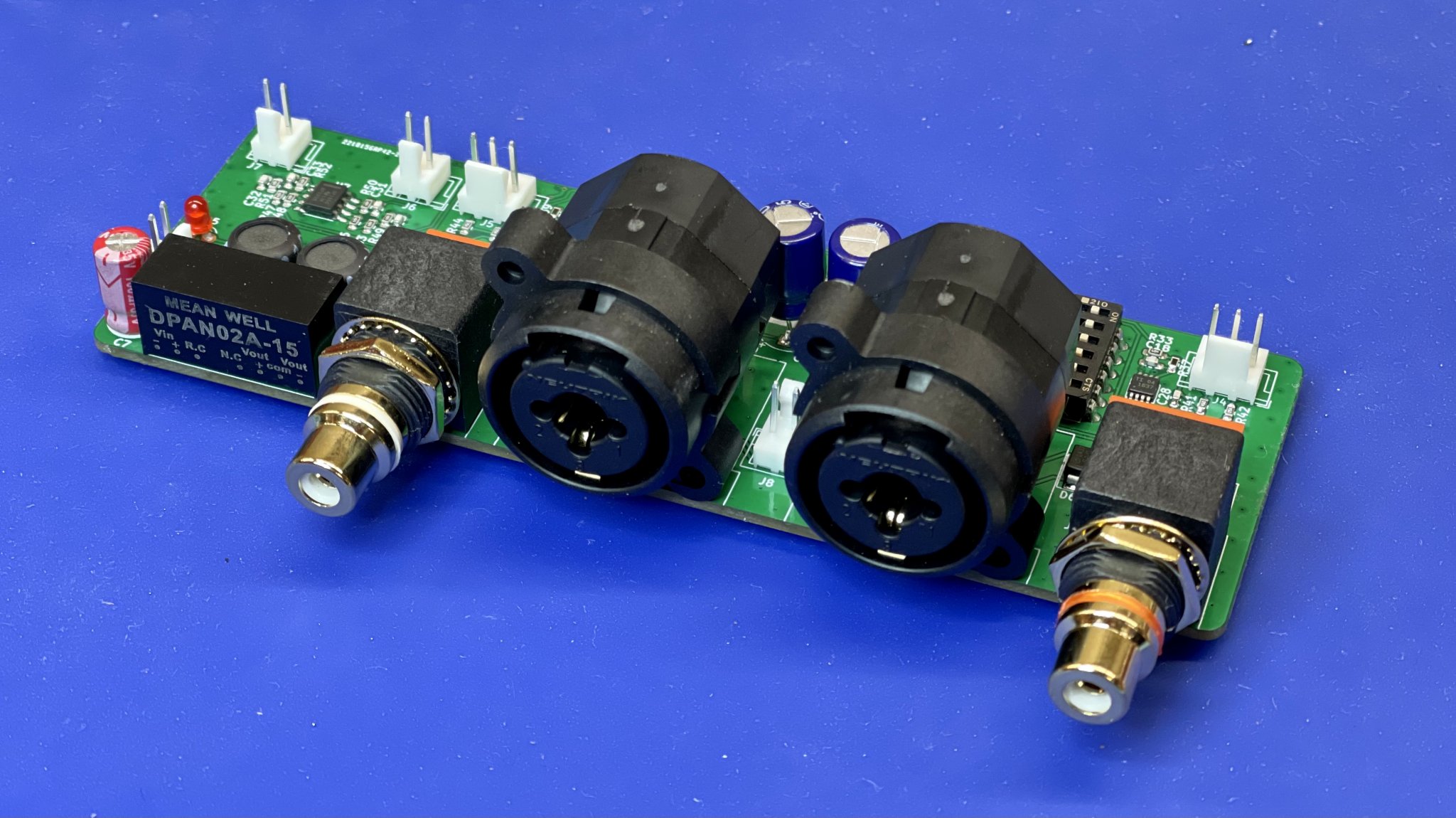

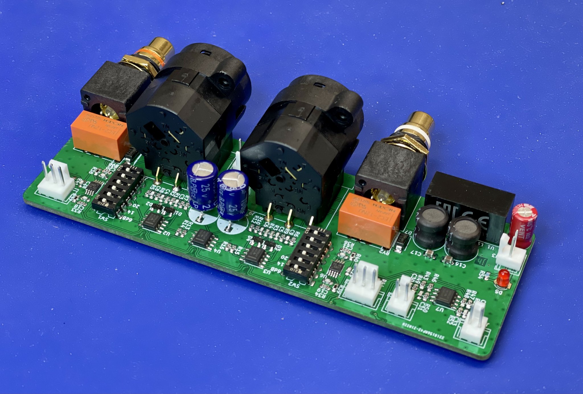

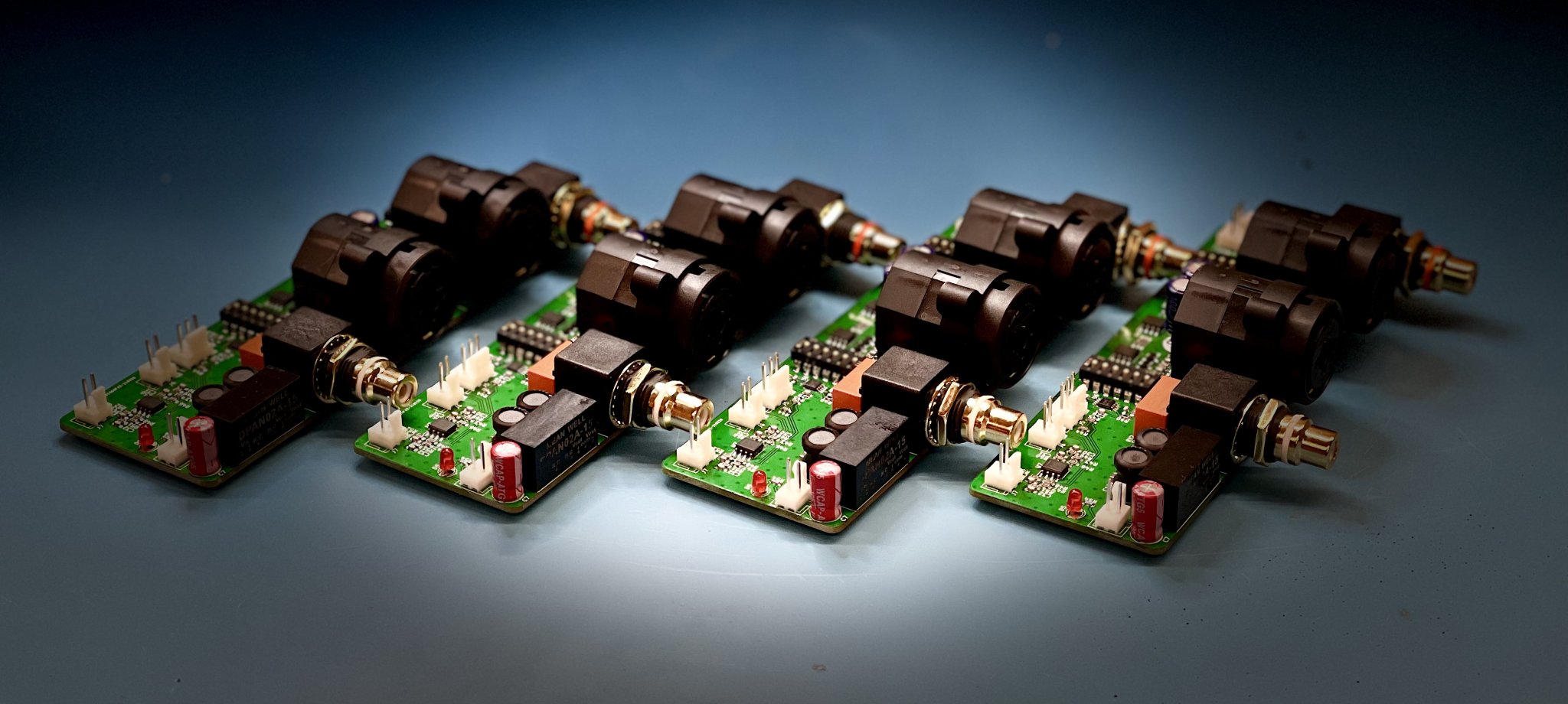

Thanks! I’ve had parts since last summer but had other projects to do. Finally got to it a couple weeks ago. They’ll be part of an upcoming project where they should be super useful.Sweet work Chris! Your lucky to be able to assemble these with the worldwide parts shortage. Very handy board to have
Learned a lot new techniques building these. Had to be super careful making sure all the parts went in the right spots!
