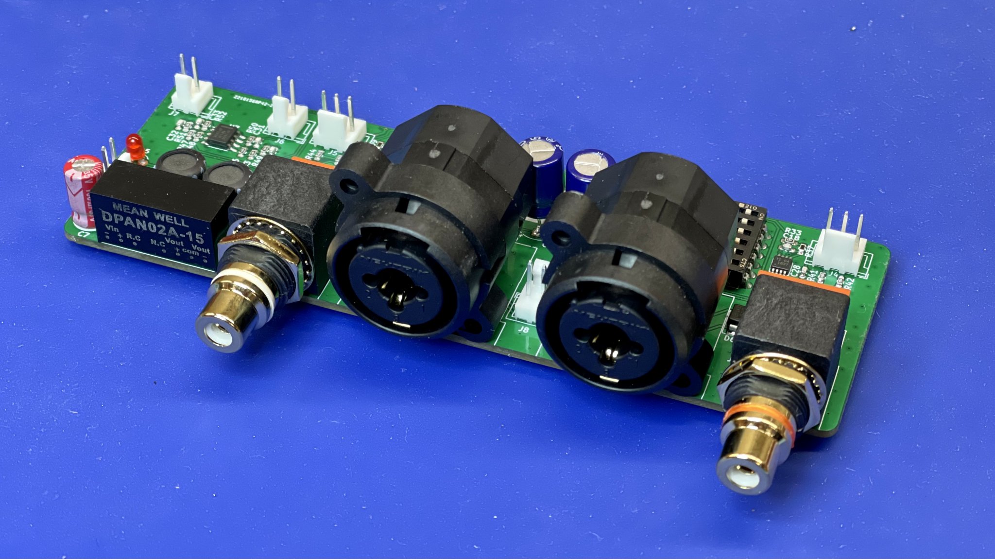

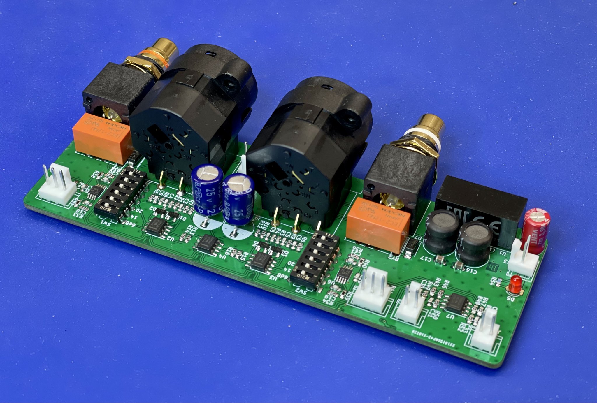

Great looking work Chris. SMDs can be real fun! I always order the resistors and caps in multiples of 10. When go flying out of the tweezers, they’re usually gone for good at my bench. Almost impossible to find in carpet too. 🙂
Beautiful work, Chris! 👍
Great thing that you stocked up on parts long ago. It’s getting harder and harder to build projects lately. Do they all work well?

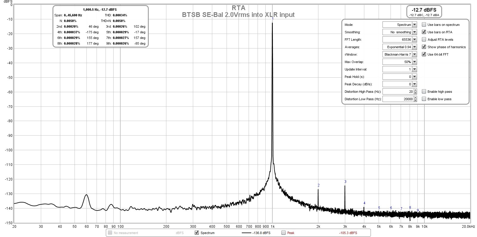

I’ll let Jhofland, the designer of the BTSB answer this. The balanced input circuit uses three halves of an OPA1656 or OPA1642. The balanced driver uses either LME49720 or OPA1637. When I built and measured this circuit, the noise floor is below what my system can measure (better than -130dB relative to 2Vrms full scale - or 0.63uV rms). There’s no noise to be heard if you look at the FFT below. The small blip at 60Hz is actually EMI pickup from the air onto the signal cable even when the BTSB was turned off.Thanks for all the answers, XRK.

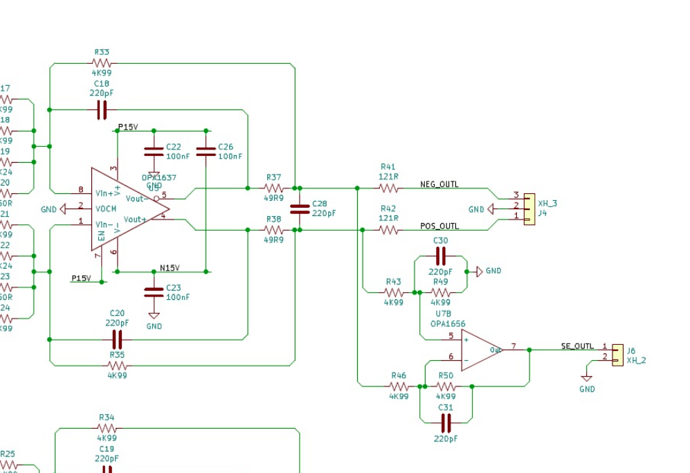

My doubt comes from the output stage of the circuit:
In the schematic, it seems that the inputs of the U7B opamp are coming from the balanced line driver outputs just before R41 and R42. So if I omit the balanced line driver chip, will the U7B work? Or will the signal reach U7B via R33 and R35?

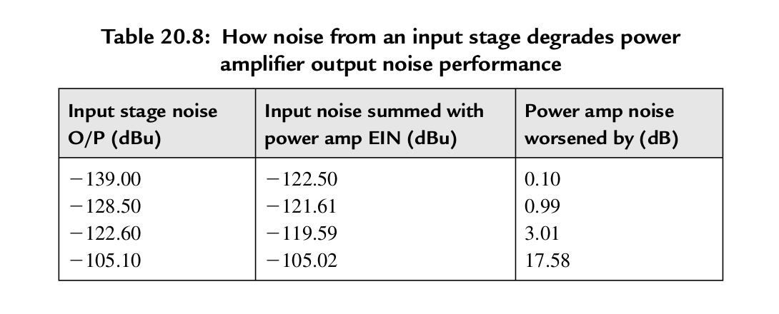

I'm no expert. 🙁 I was just referring to what I've read in Doug Self's books. If you see his Audio Power Amplifier Design Handbook (5/ed, 6/ed, take your pick), you'll find a chapter which talks about input circuits, and there he discussed balanced input circuits. He first shows a balanced circuit with just one opamp and passives, and then says that this is far worse than a single-ended input with one opamp. In his words, "the noise output of a 4 x 10 k balanced input amp using an NE5532 is -105.1 dBu, which completely swamps the power amplifier EIN and degrades the overall noise performance by 17.5 dB."
The book illustrates the impact of the input stage noise on the overall power amp noise through this table:
He then goes to design multi-opamp balanced inputs which really cut down the noise of the input stage. He explores other low-noise opamps too, beyond the NE5532. He also has such an input stage on his website: http://www.signaltransfer.freeuk.com/lownoisebal.htm
I was wondering how we are getting low noise in our balanced input circuit without all these techniques.
Hope I'm making sense?

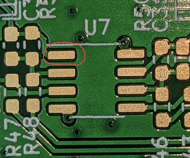

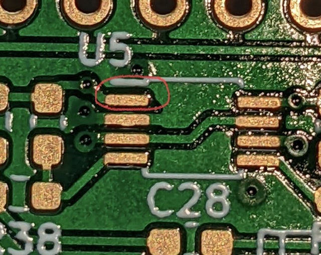

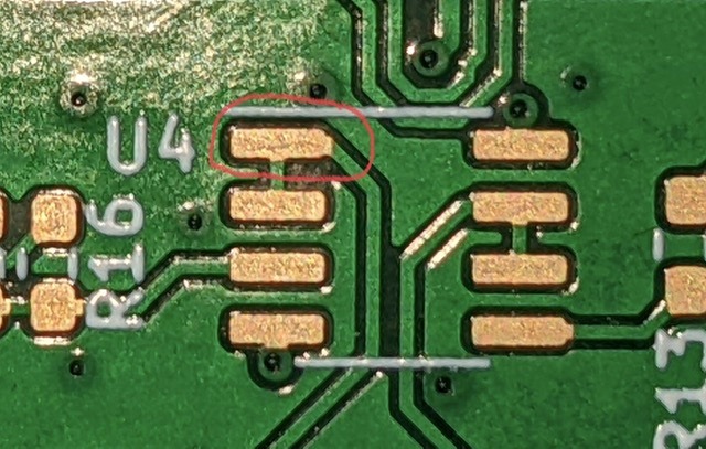

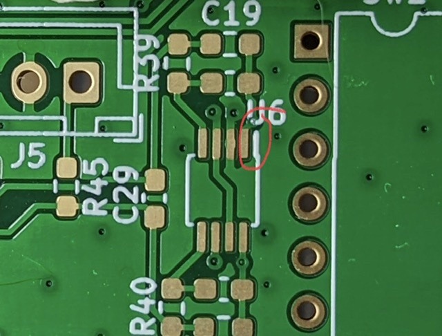

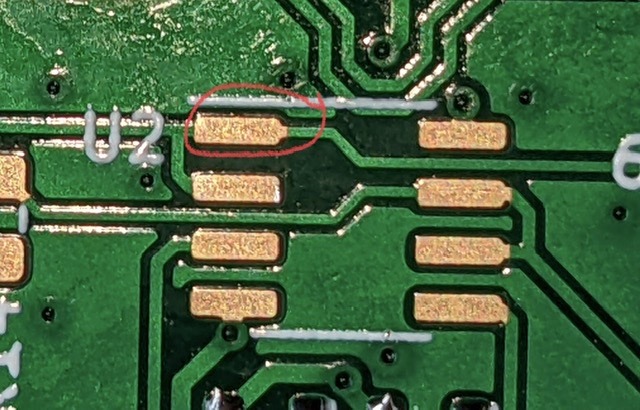

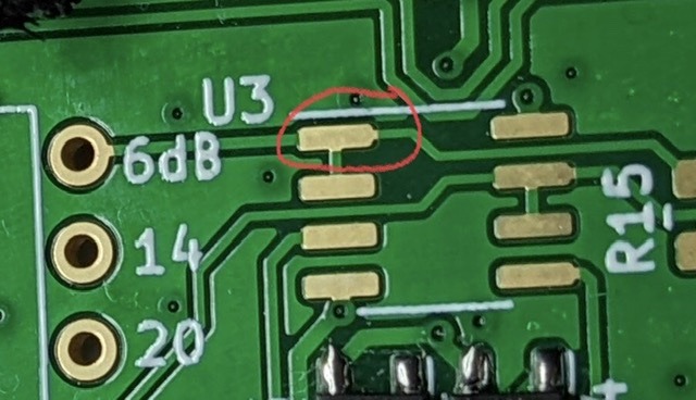

Hi X & Chris: I'm building my panel mount board now and in scrutinizing Chris' nice pics. I want to check if I have pin 1 of each opamp correct on the board. See red circle in pics for my guess as to pin #1.
Thanks, Pete
Thanks, Pete

Hi X: just a question about your hot plate/hot air gun technique for soldering SMDs. I can see it being useful for boards where the SMDs are on one side but how does one manage a board with SMDs on both sides like this panel mounted board?
Somewhere I read the use of the hot plate & skillet combo but with the use of fine sand and the idea was to evenly warm the board (from underneath; just not hot enough to melt the solder paste) while using the hot air tool to finish the job on the topside mounted SMDs.
Thanks, Pete
Thanks, Pete
Good question. The way I do this is to make sure the side that needs heat from both sides gets a smooth flat surface for the hot plate first. So for example, if you have SMT capacitors, inductors etc that need heat from both sides, do that first. Then add the bottom side SMT parts last using hot air only.

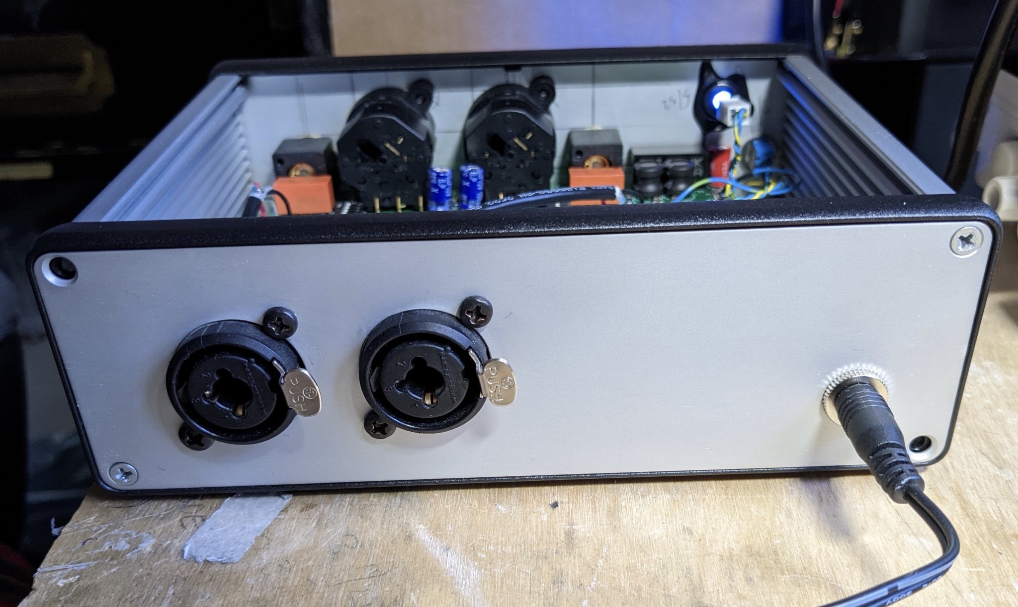

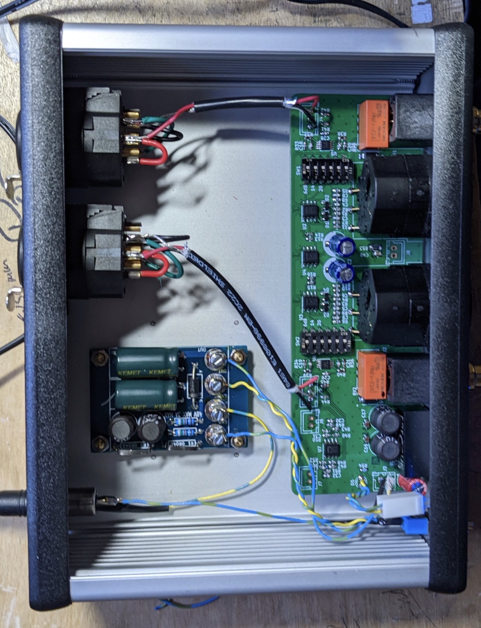

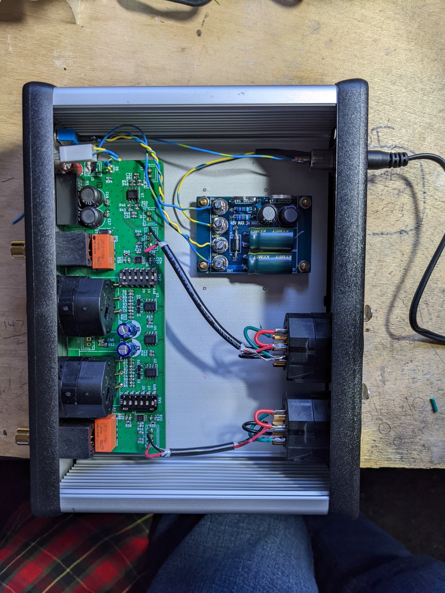

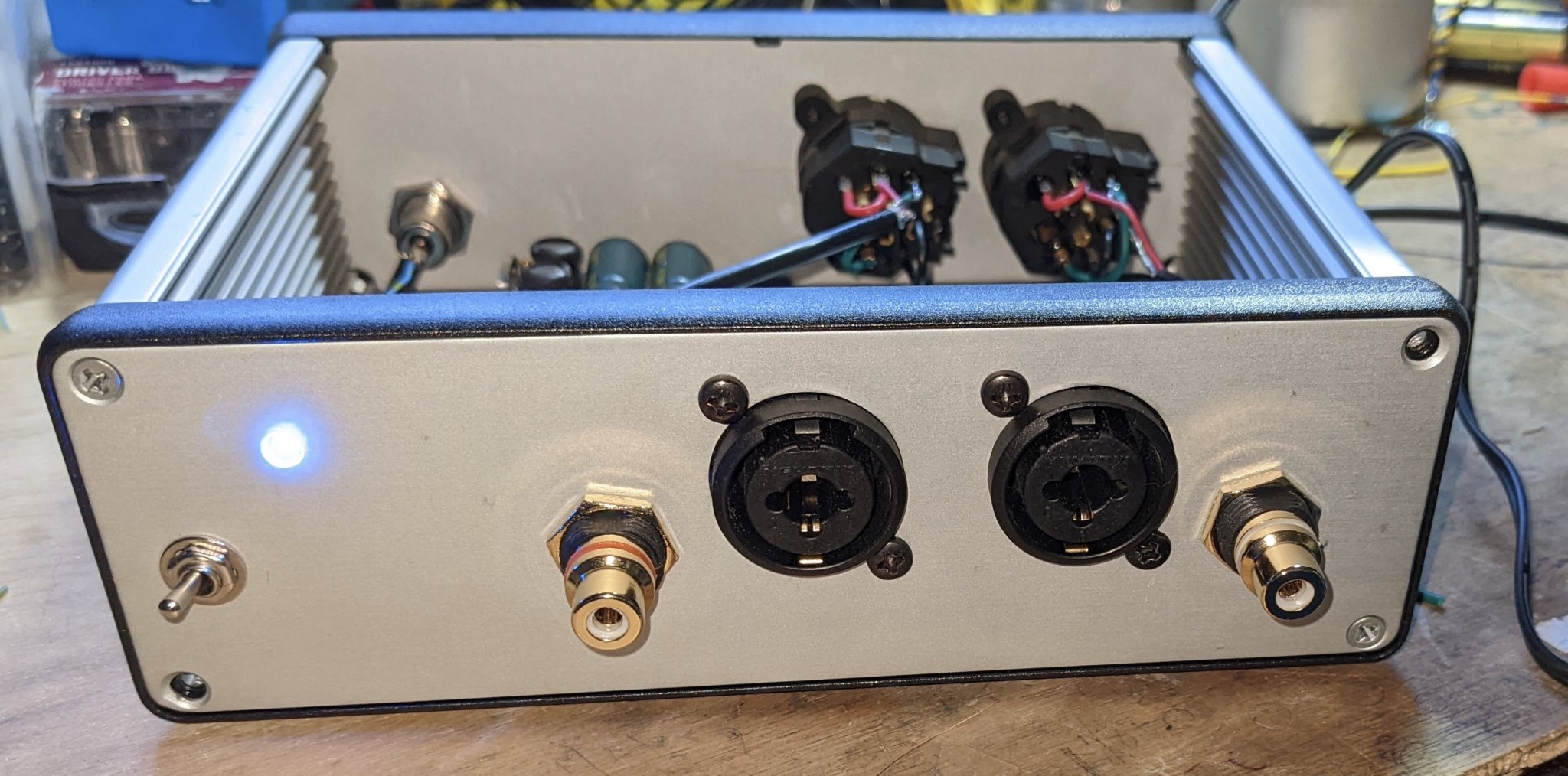

Well, I hand built/soldered the panel version and placed it in a Hammond casing. I don't have any components that actually use Balanced connections but wanted to be able to go from SE to Balanced (probably to try amps like the Purifi variety) somewhere in the future. Guess I won't know if it actually works correctly until I get a Balanced in amp?
Cheers
Pete
Cheers
Pete
Nice work Pete! You will soon find how handy this box is once you have balanced gear. It’s also handy for balanced preamps outs. They can run longer distances without less noise pickup and then drive SE input amps.
