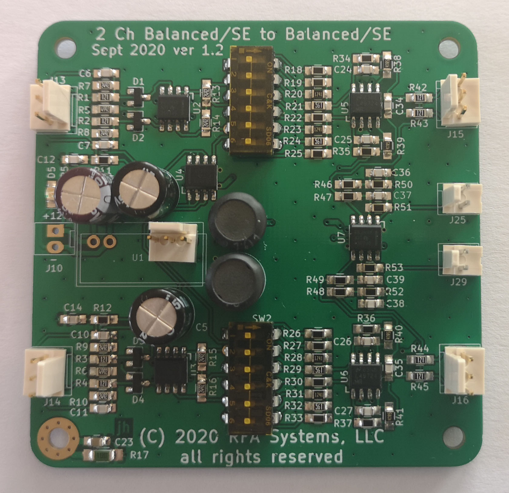

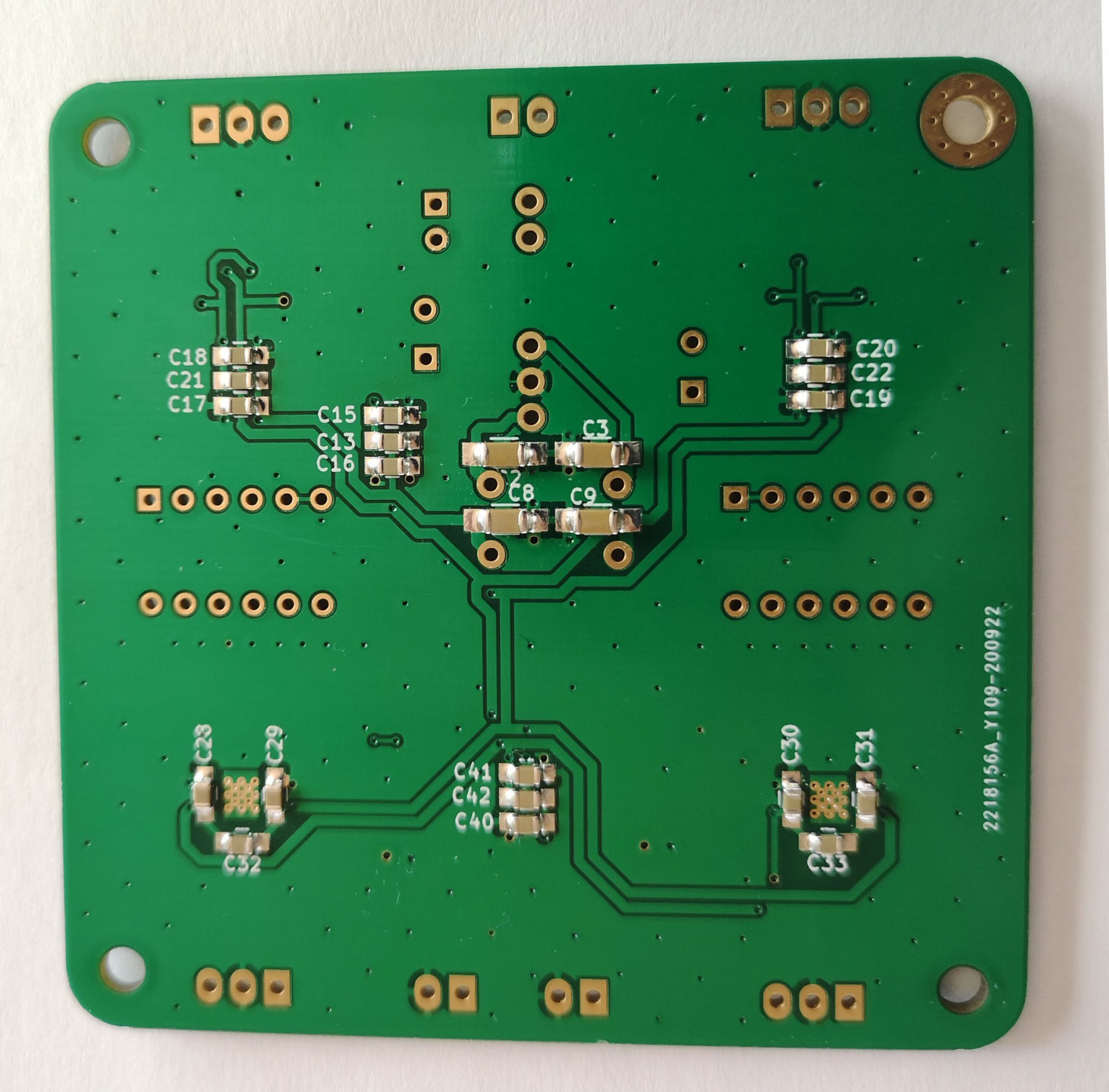

Mine are not either. I have to use flip up magnifier goggles for anything smaller than 1210. And a stereo microscope is a must for small stuff like 0402.

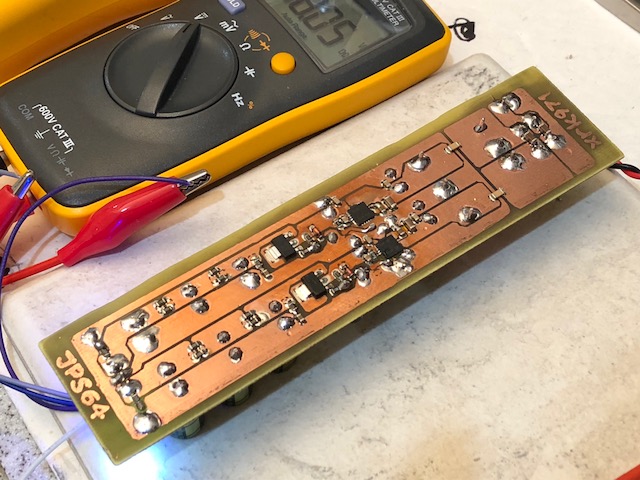

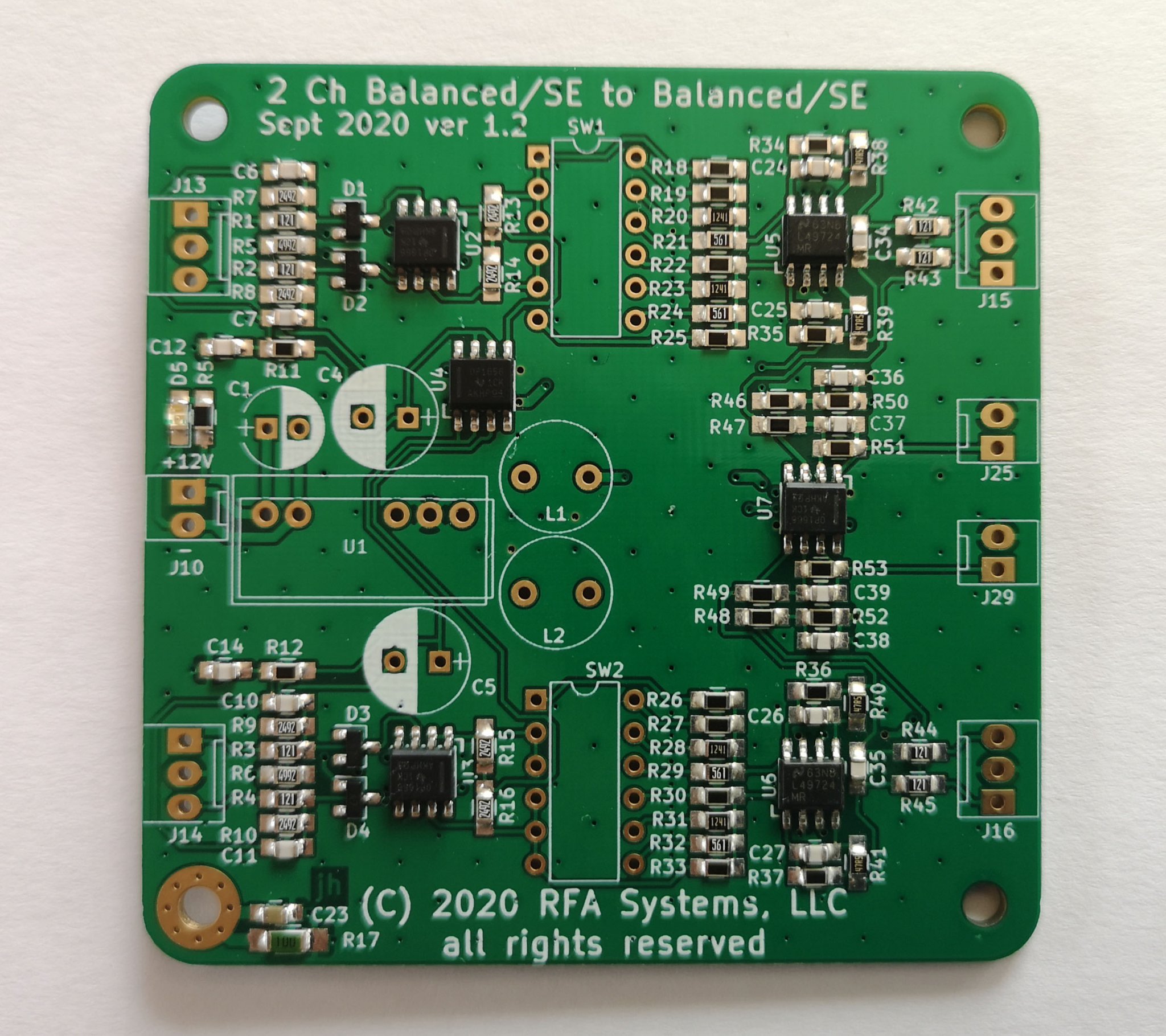

Nicely done! Just checked over some of your resistor pads with some flux and touch up with an solder iron so there’s no cold joints.
SMD is not so daunting 😊

Beautiful work, JR! Neat solder joints.

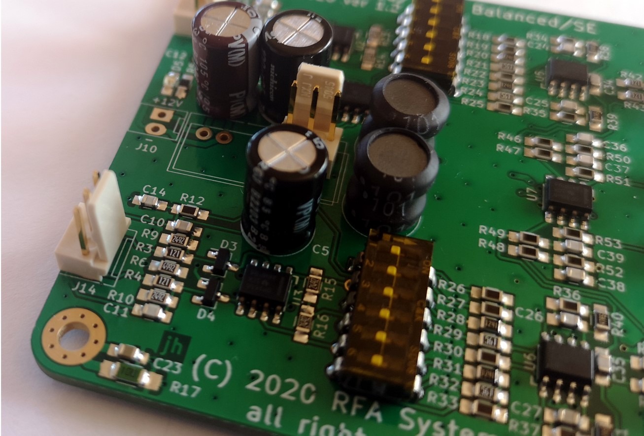

Only thing I would do different is to place the resistors label up so that you can debug the board visually if there was ever an issue. Leaving the filters for the PSU is a good thing even with an off board PSU. It will clean off any stray RFI.
Now have a listen and enjoy.

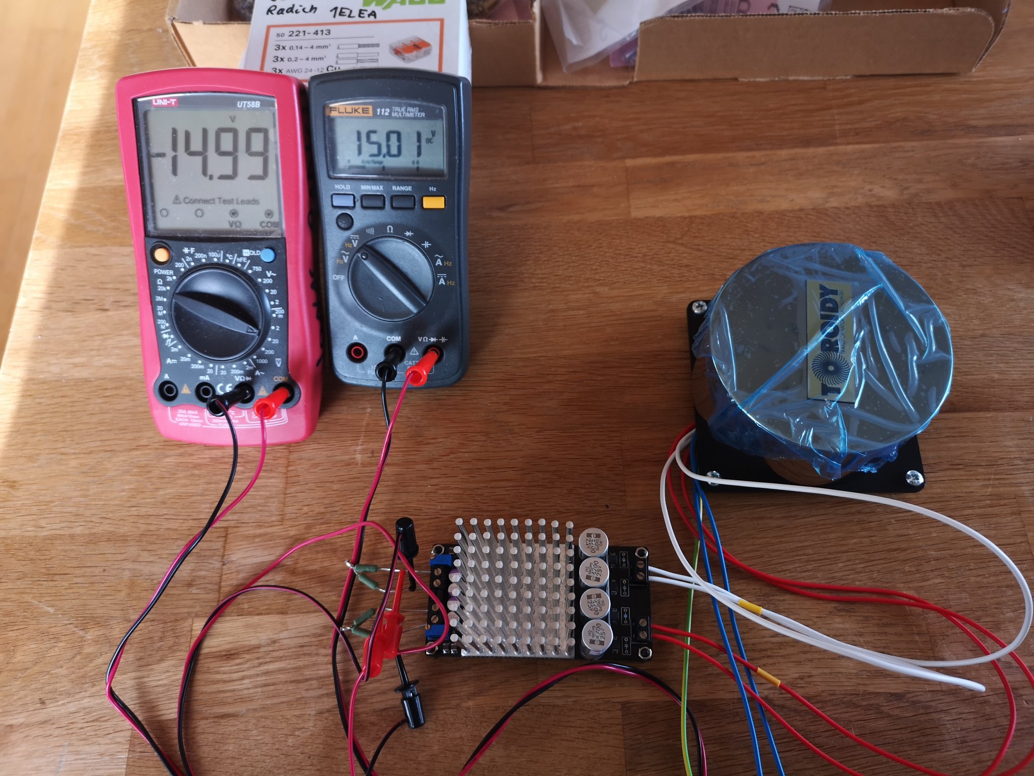

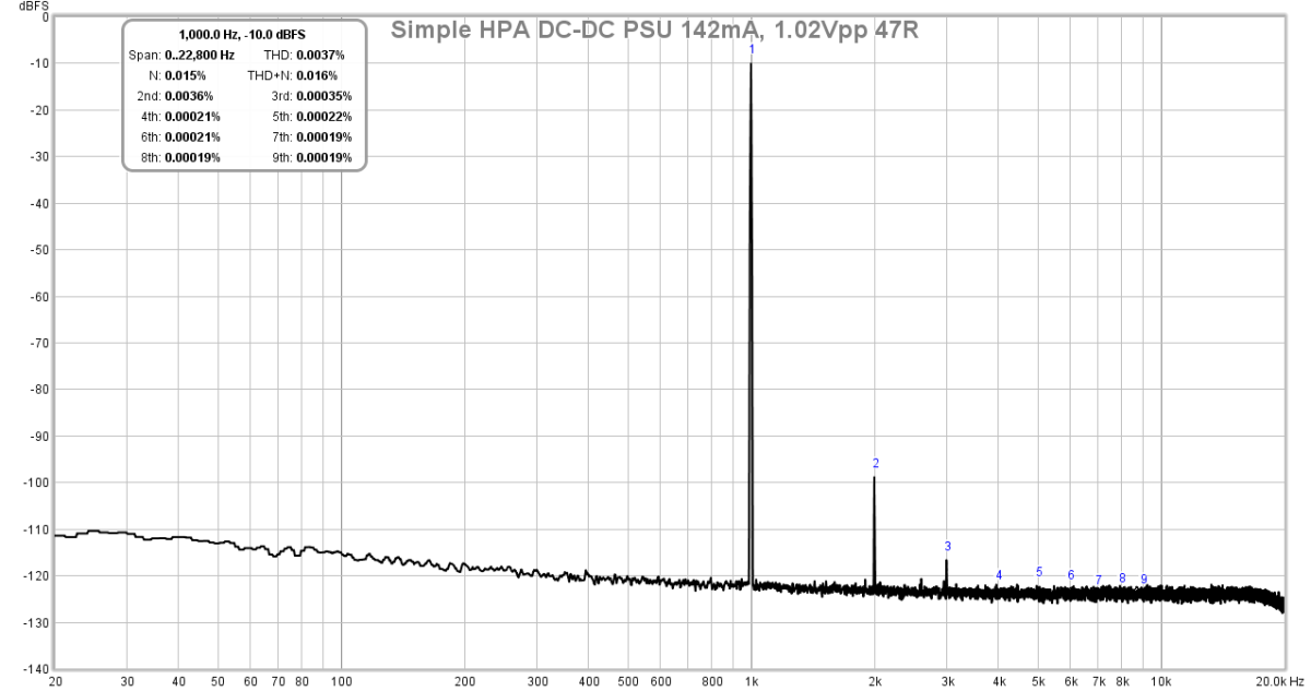

Can I ask what PSU you will be using and why you chose not to use the DCDC? I even gave you one as a bonus. They are simple and very low noise in the audio band as can be seen in the FFT noise floor that I measured and posted. Not all linear supplies (even fancy shunt regulated ones) can live up to -130dB noise floor at 50/60Hz.

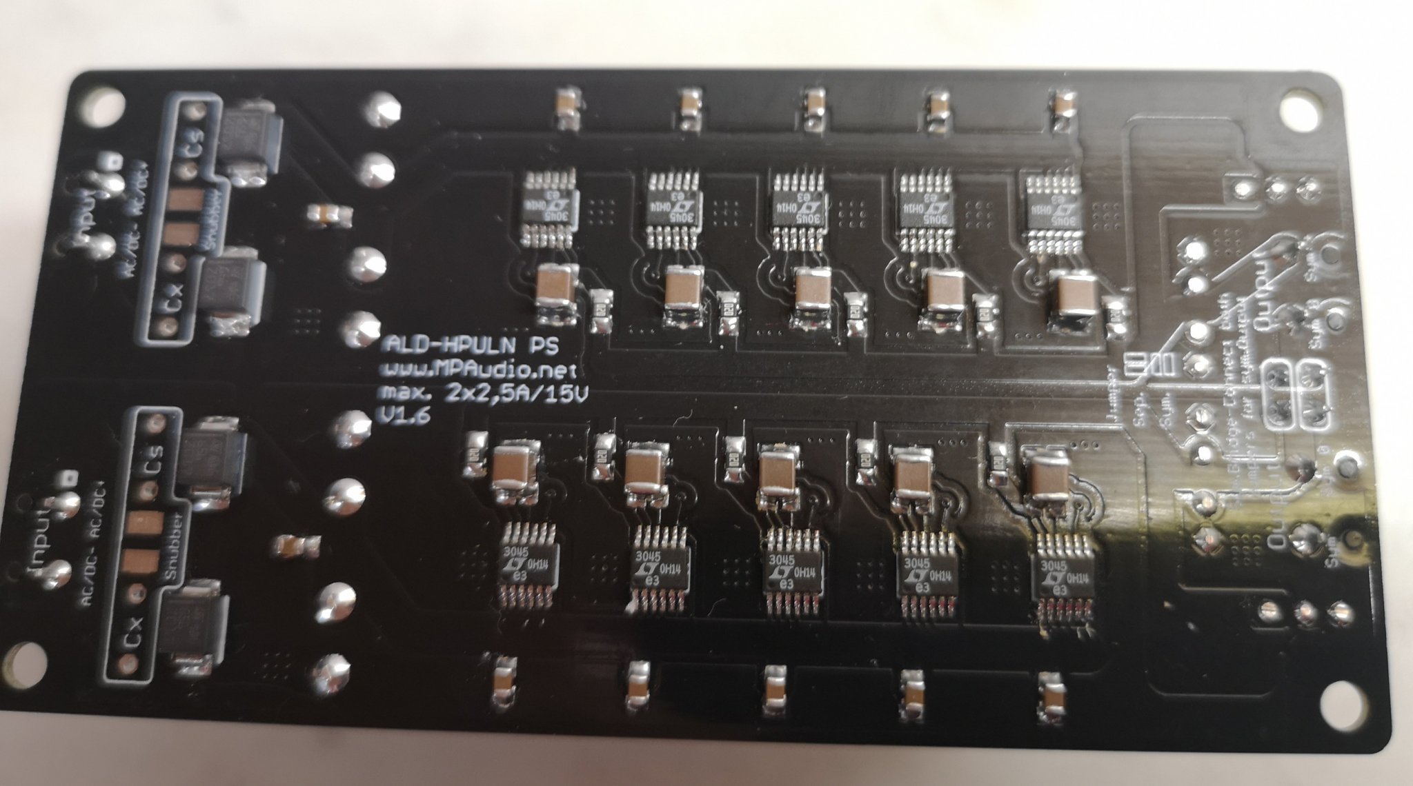

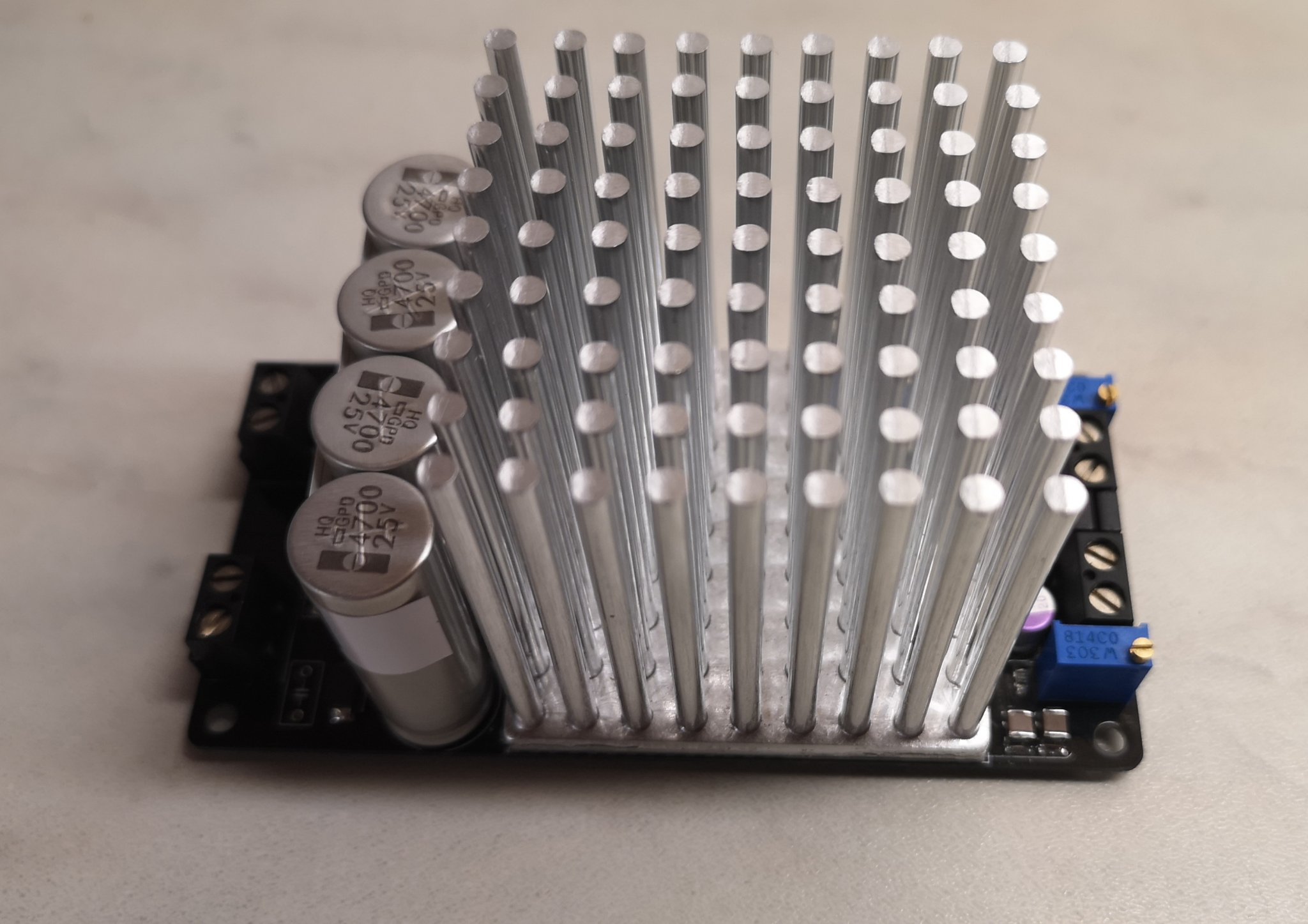

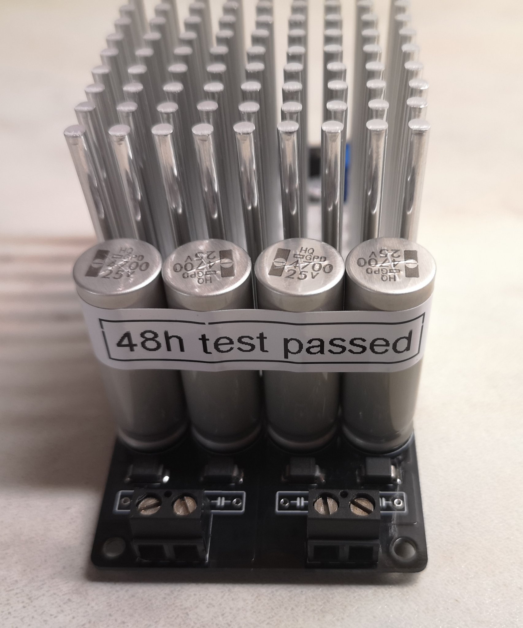

I will use this power-supply: ALD-HPULN PS
Details / Features
Dimensions: 101 x 51mm / 3.97 x 2.01"
Input Voltage: max. <14VAC / <20VDC
Height (without spacers): 52mm / 2.05"
Output Voltage: Adjustable 0-<15VDC
(Preadjusted to your desired output voltage)
Output Current: max. 2,5A / rail
Ultralow RMS Noise: 0.8µVRMS (10Hz to 100kHz) per regulator
Further reduced noise by 5x LT3045 in parallel operation per rail
Ultralow Spot Noise: 2nV/√Hz at 10kHz
Ultrahigh PSRR: 2x76dB at 1MHz
High Bandwidth: 1MHz
High quality parts only
Low ESR capacitors
Low TC resistors
Aluminium-Polymer capacitors (OS-CON, K750)
Soldered with silver alloy
Further reduced noise by 5x LT3045 in parallel operation per rail 😎Wow, nice PSU! Looks great then. 0.8uV rms is awesome.
Hi XRK 🙂
Regards
J.R
If you look closely, you will find that the resistors that are missing a label, is only the 4K99 resistors. These don't come with a label from the manufactor. 😉Beautiful work, JR! Neat solder joints.

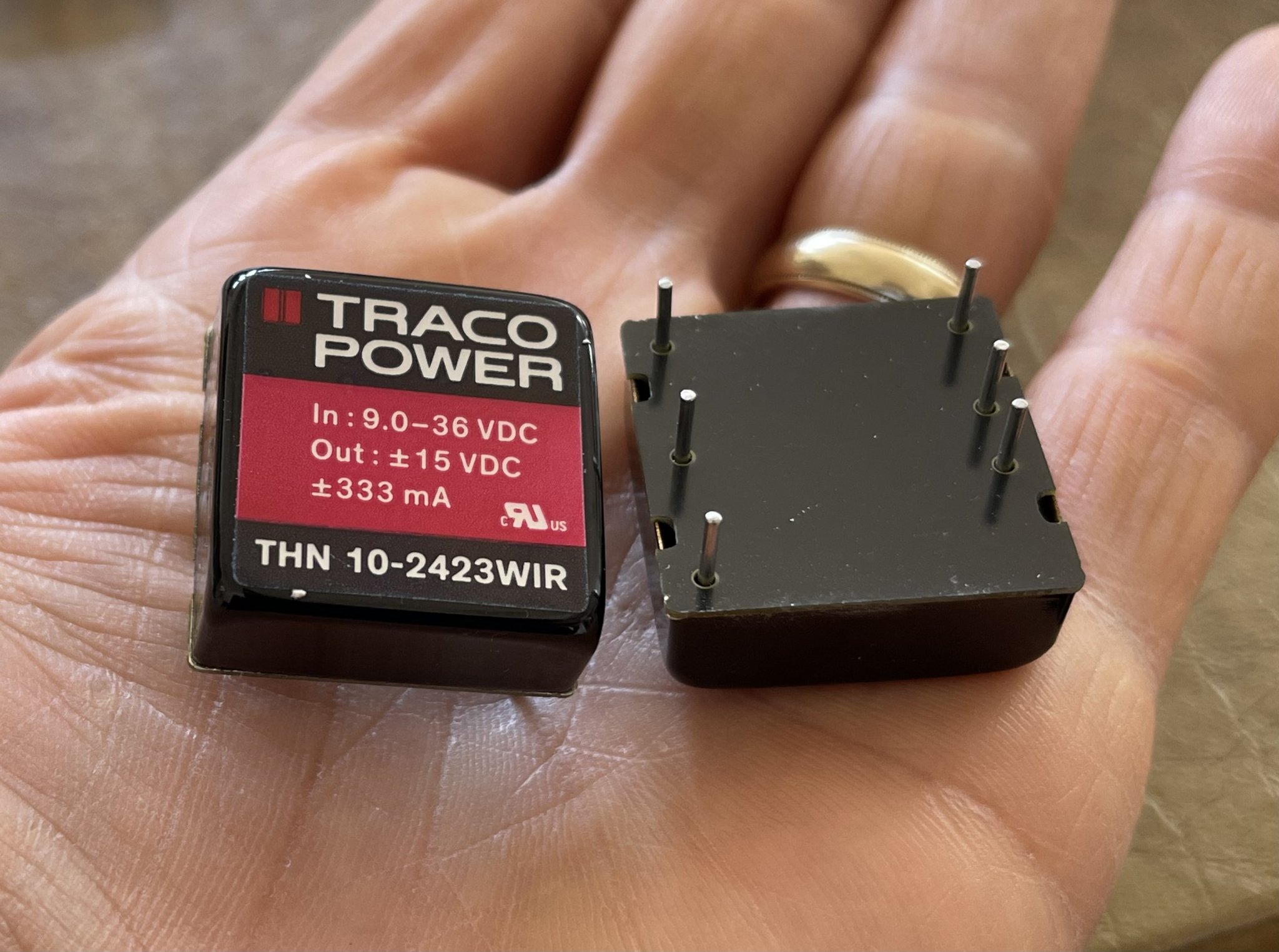

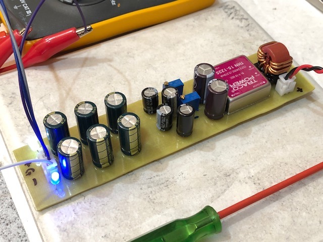

That ALD PSU sort of reminds me of something I made years ago with a TracoDCDC followed by some TPS7A4XXX ultra low noise regulators and some soft start ramp up MOSFETs followed by CRCRC. It was very clean. I used it for a nice headphone amp which I gave to good friend.
FFT for 1Vpp into 51ohms
I recently got a few more of the Traco’s to play with. These are 333mA.

I think the Traco Powers are very good. A member in a Norwegian Audio forum is using them in his upcoming MC/MM Riaa. Measurments seems promising 👍

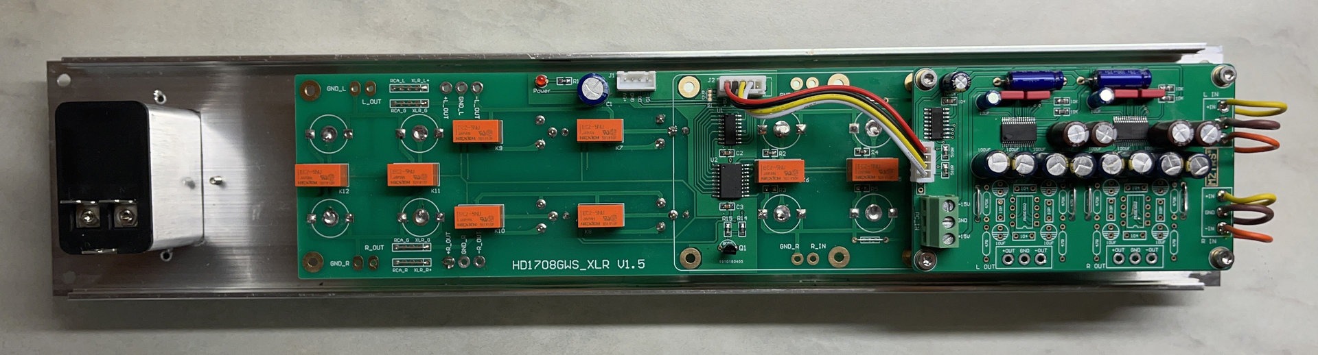

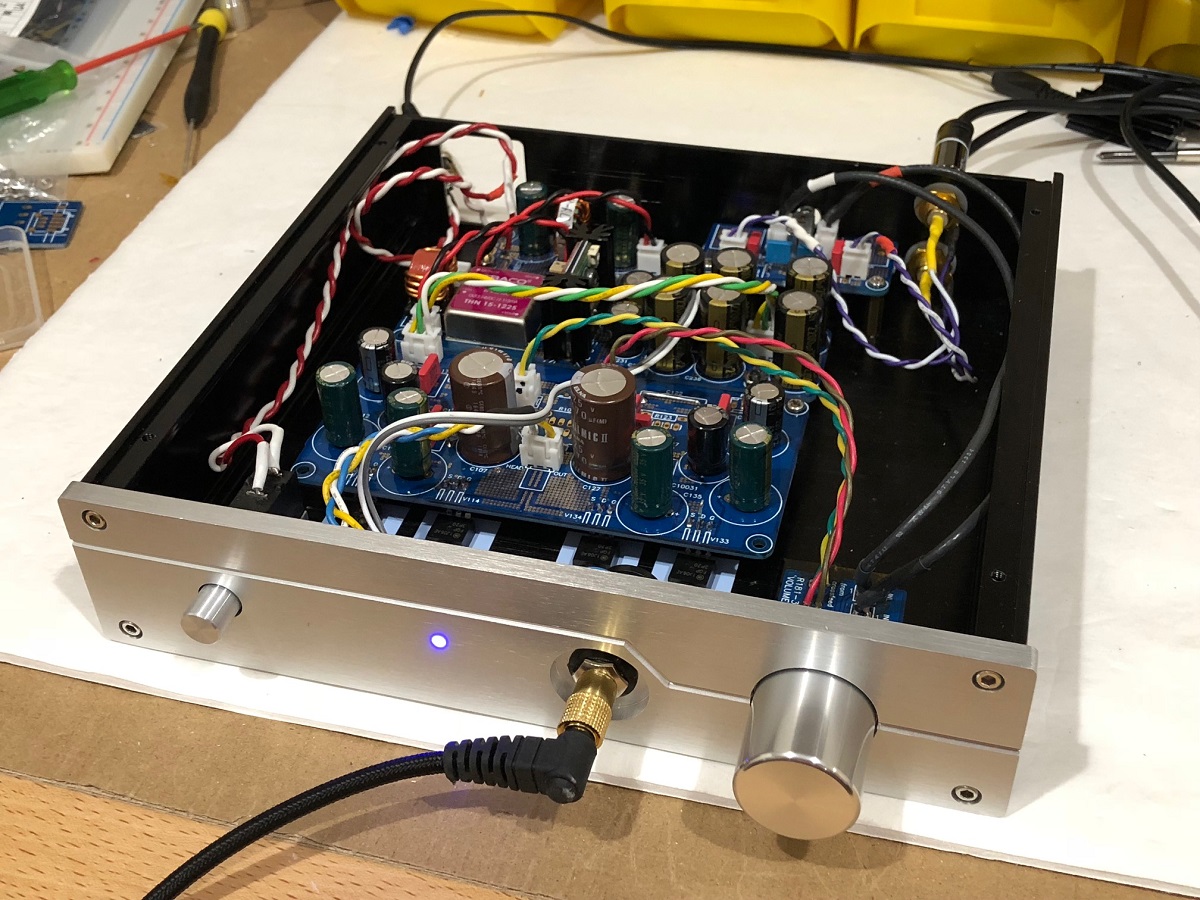

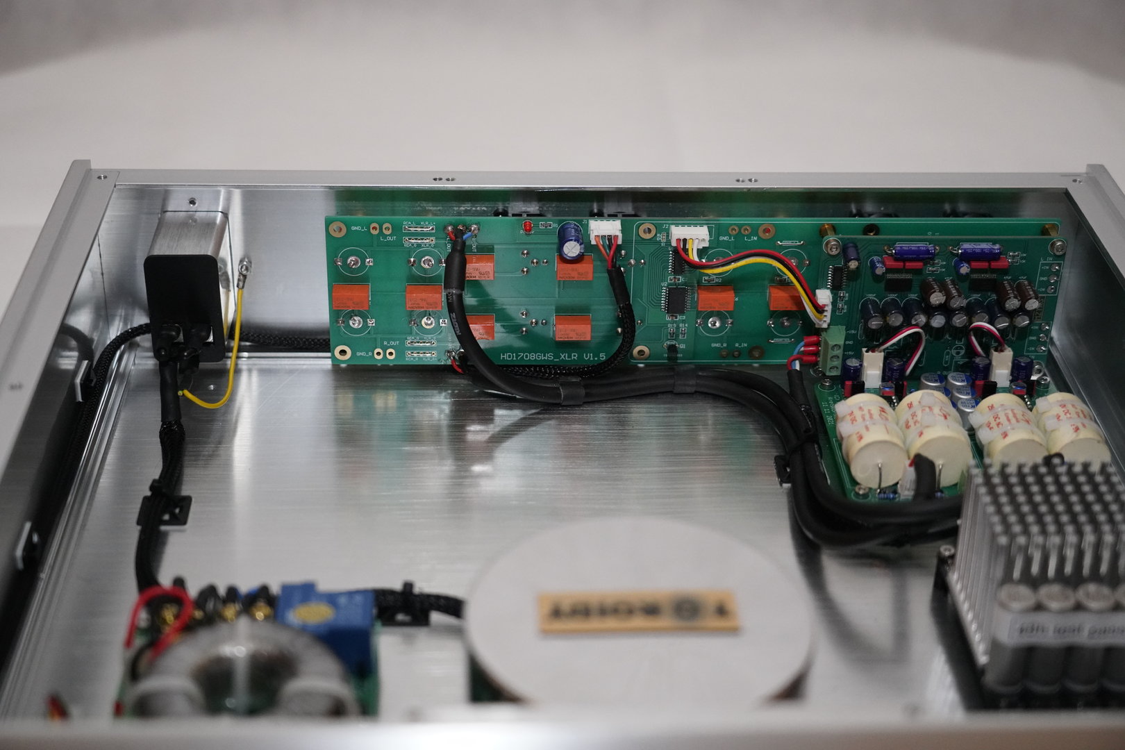

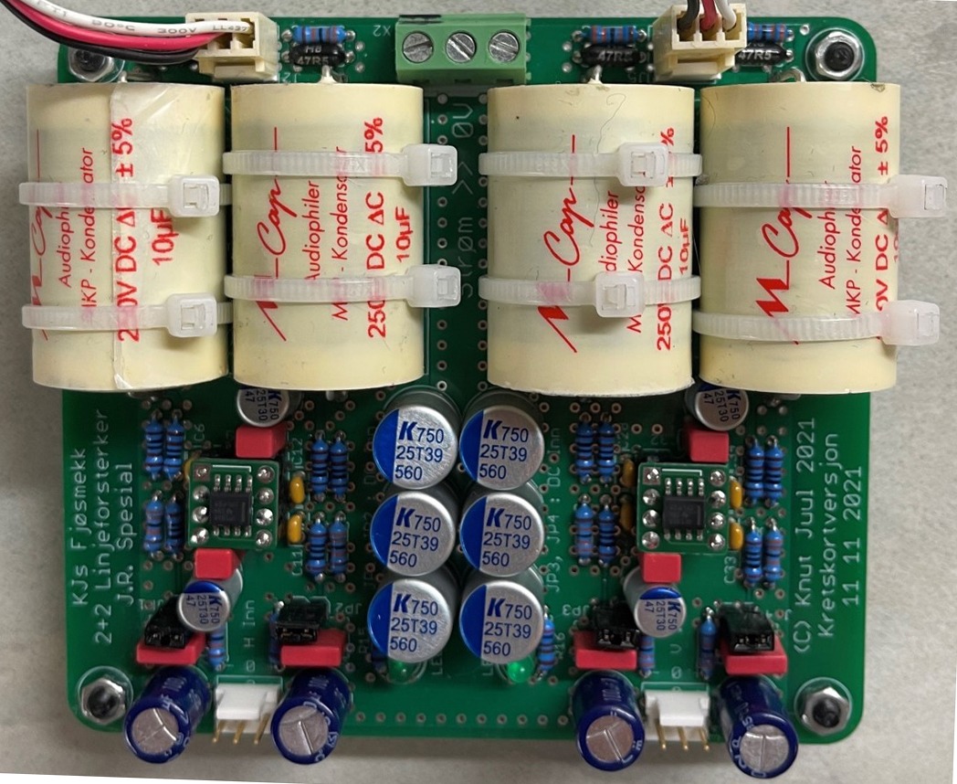

Ine , your soldering skills are impressive, well done!

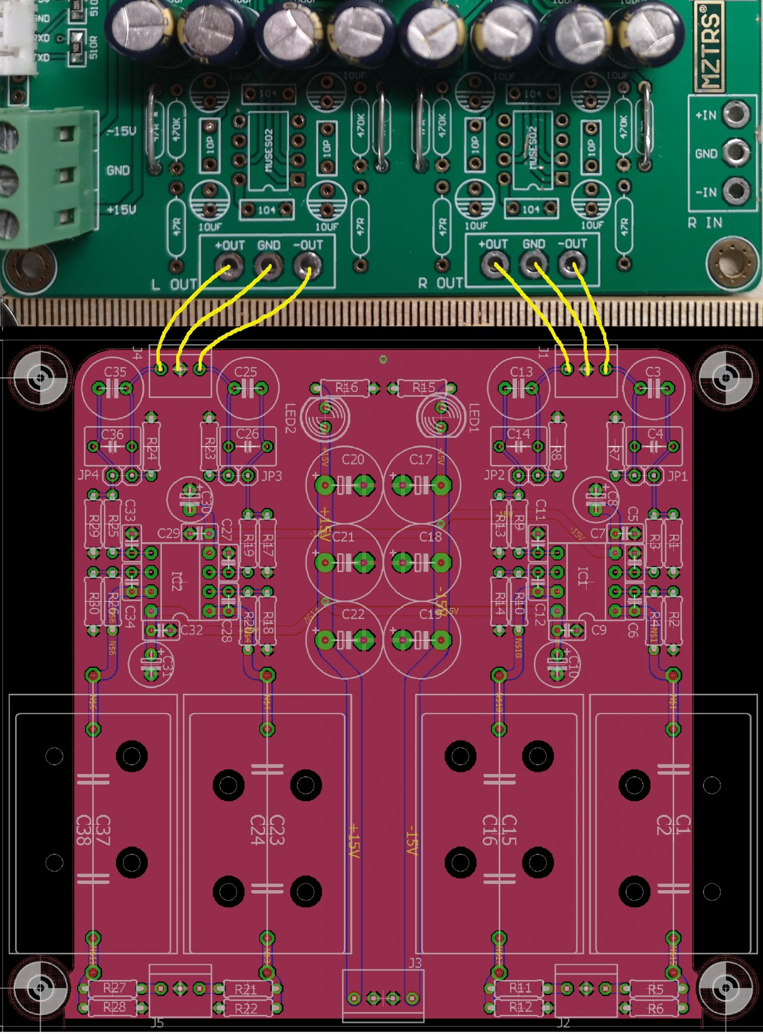

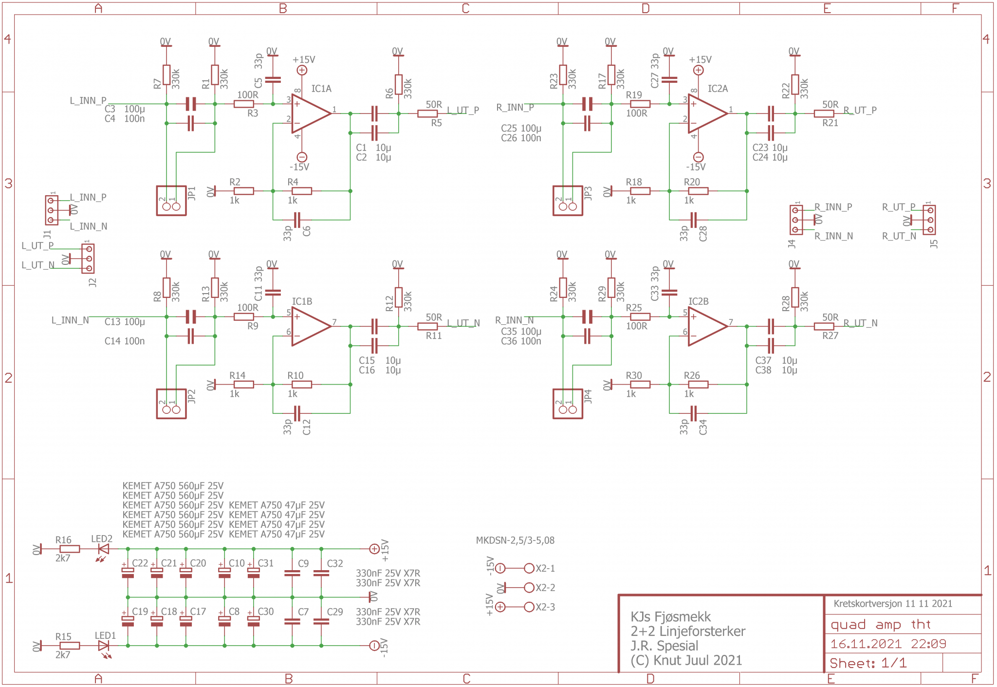

Nice system. The BTSB provides the 6dB gain already. Are you making another gain stage with OPA1656? Nice preamp!
Hi Ine,
Did you get first sound yet? Please let us know how it sounds and works when you get a chance.
not yet. Have some rewiring in the preamp to do, to get this new board implemented . Maybe next week 🙂

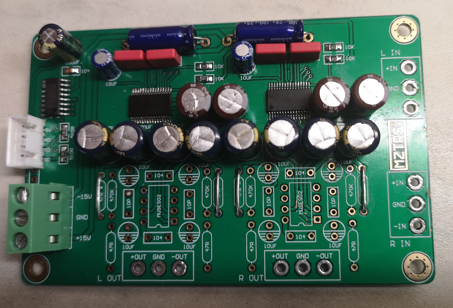

Hmm, this buffer has caught my attention. Wonder if it is a good match at the output of the raw outputs of my soekris dam1021 dac?
SE to Balanced and from there on direct into a couple of icepower 1200as2 based amps. Volume is digital 32bits float from the dac..

The BTSB does not have the relay feature but you could implement one yourself using small signal relays easily. Or use my headphone protection solid state relay to do the same thing. Just trigger the relay externally somehow (probably apply DC 1.5v to 5v to the input of the comparators would be a good trigger (negative logic)).
