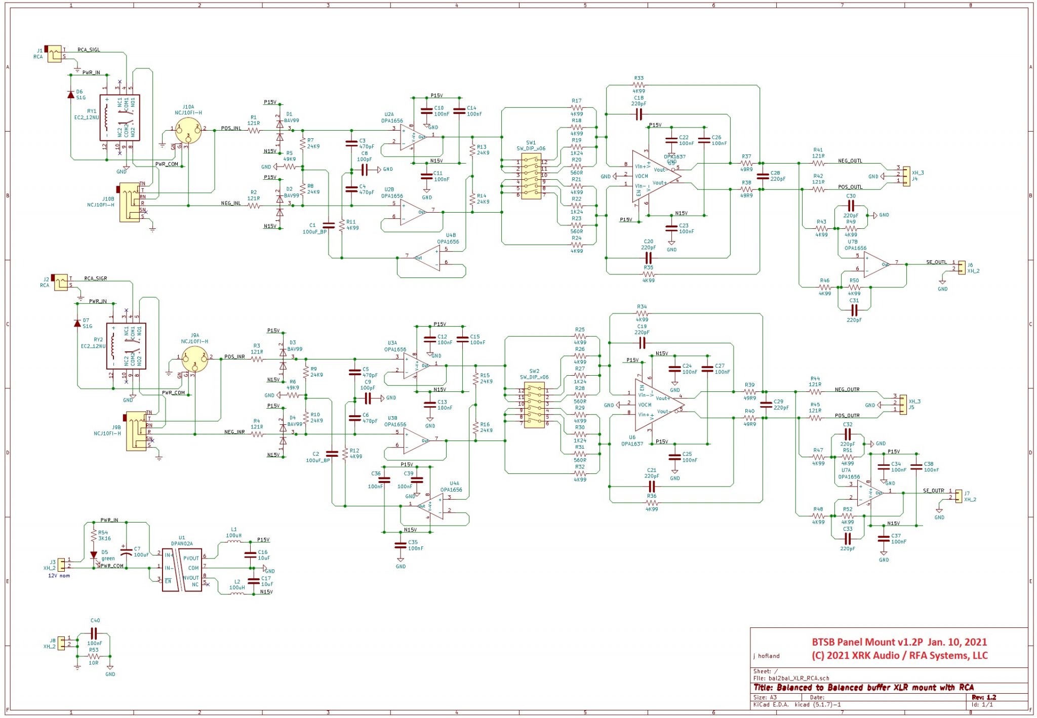

You ordered the BTSB Panel Mount and the latest version is Rev1.2p. The BOM for the panel mount is quite different than the non Panel Mount. Let me get you the BOM. Please PM me your email.
Here is the schematic and you can see that the DCDC converter is different and the balanced output driver is OPA1637.

Posts 101-103 discuss how the calculation for gain arrives in this circuit. Is there is a resistor combination/possibility for negative gains? Ideally I would love a (-6) dB option. Specifically reworking the values for resistors R17-R32.

If you change the feedback resistors R33, R34, R35, R36 from 4K99 to 2K49 it will reduce all the gain settings by 6dB. I think that's what you are asking about.
So the new gains will then be: -6dB, 0 dB, 8dB and 14 dB ? Yes? And R17-R32 stay as the stock values as referenced in the schematic?

yes. The generalized gain expression is Rf/Ri, where Ri consists of various combinations of resistors in parallel. In the original design with no switches closed that value would be 4K99/4K99, or 0dB. If you cut the value of Rf in half it becomes a gain of -6dB, which is what you asked for.

-6dB, 0dB, 6dB, 14dB is a very useful range. I often don’t need 20dB.
