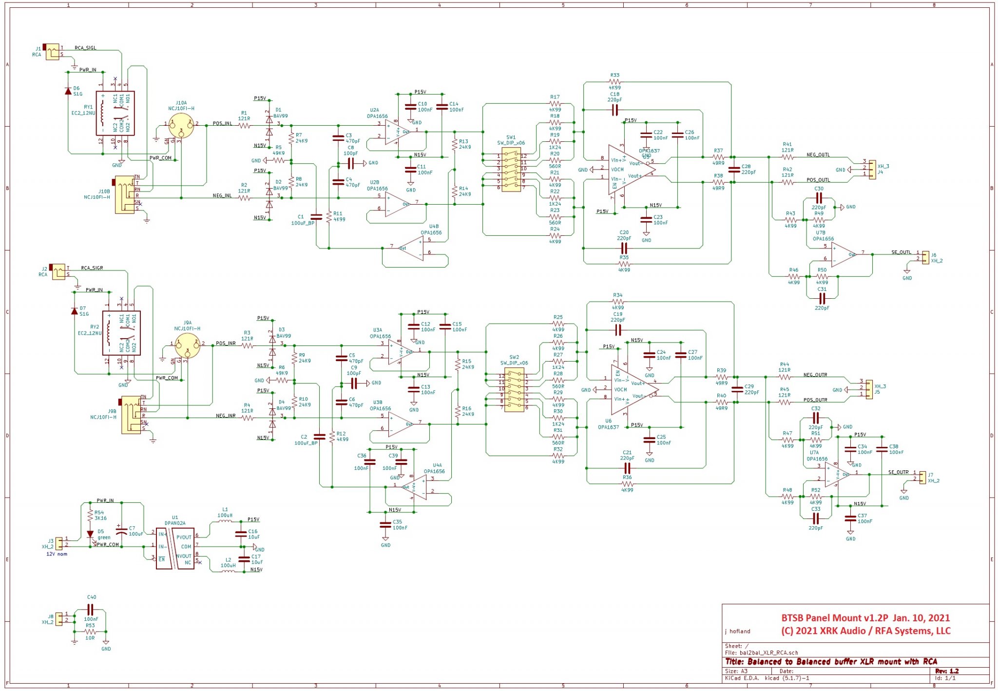

As I will principally be using it for testing of power followers I need to know the bandwidth. Is this limited by LME49729 or is there a low-pass filter in the circuit?
I think there is a 470pF in series with 100pF to ground as input filter. There is a 121R input series resistor with equivalent 87pF cap for -3dB RC filter of 15MHz low pass. Jhofland can correct me if I am wrong in these calcs but you should be good for most any audio application.

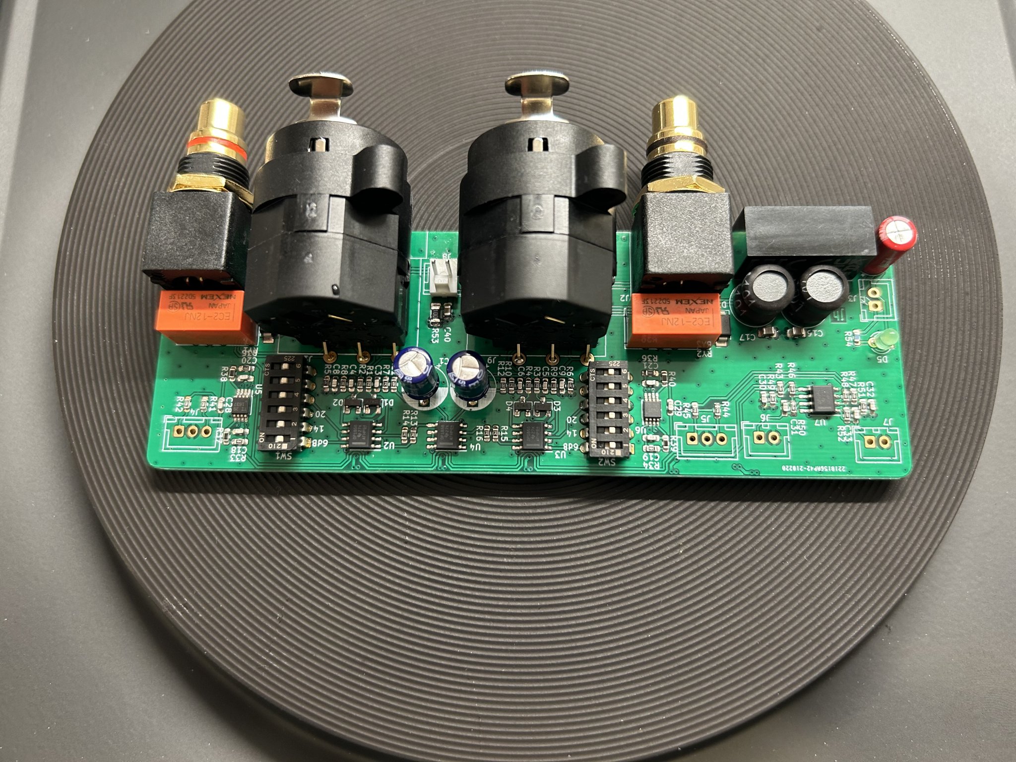

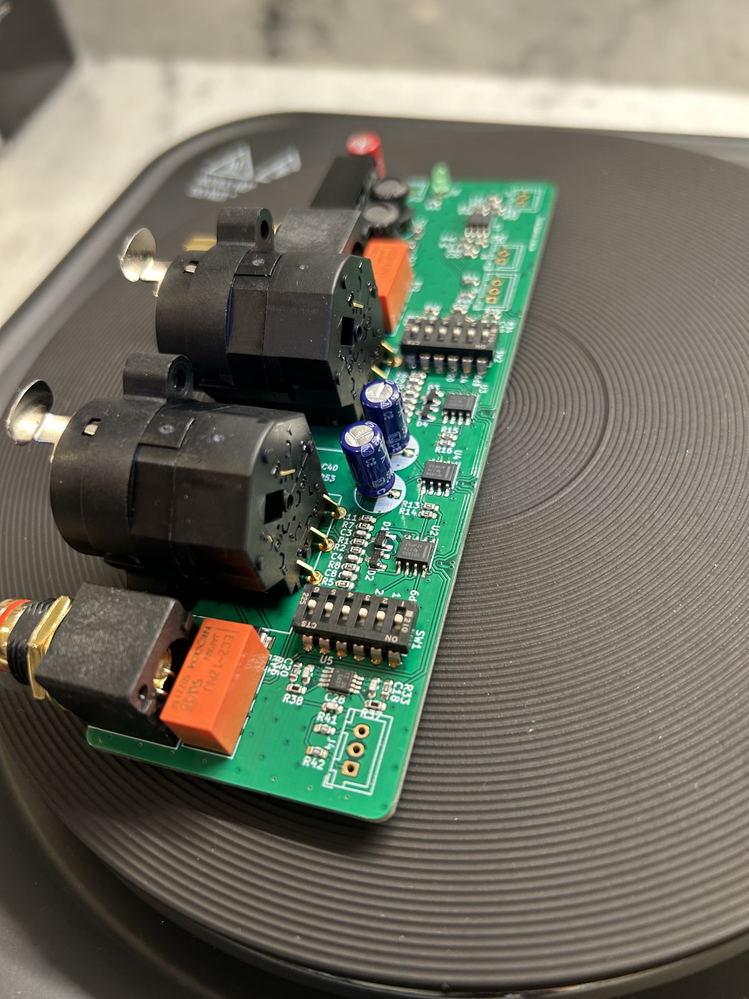

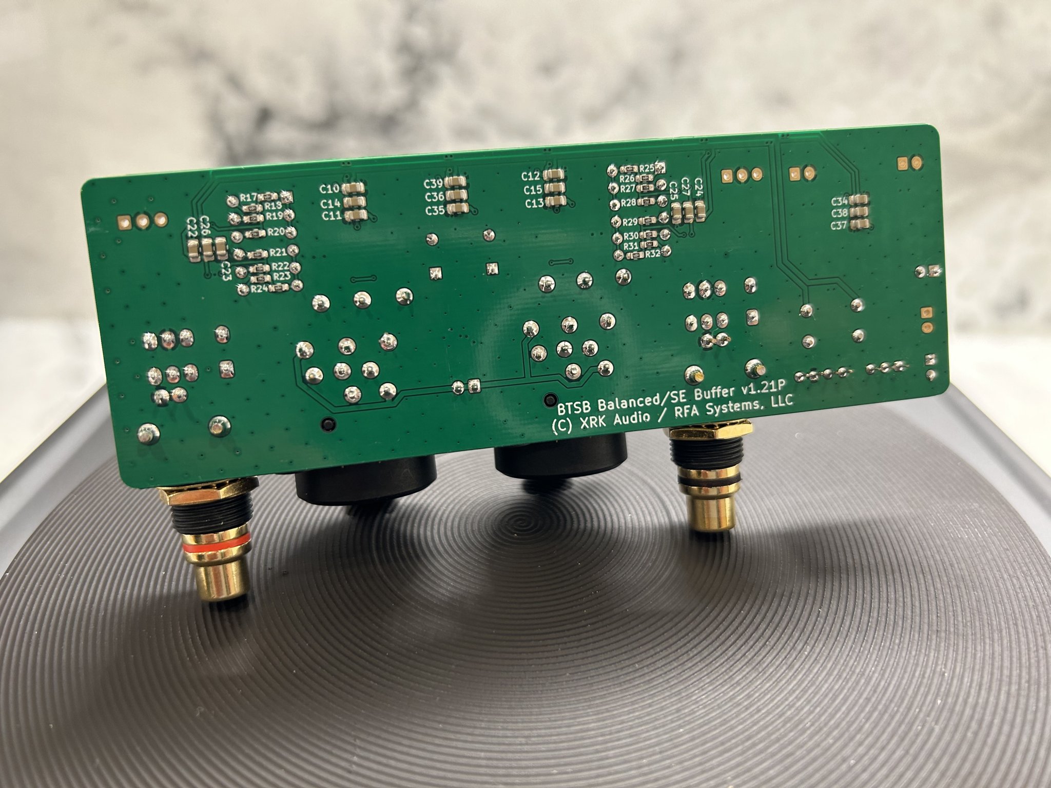

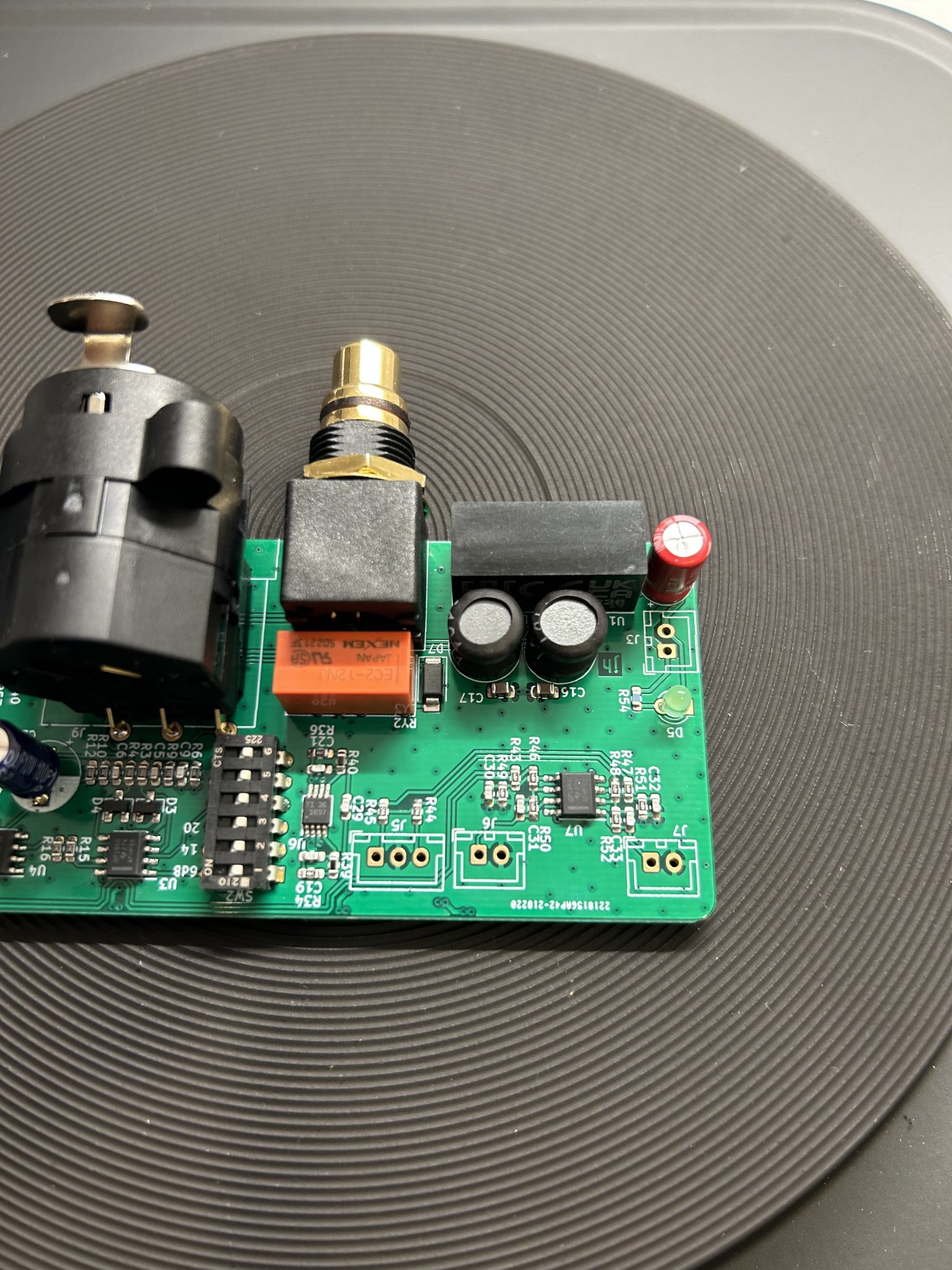

Before:
After attached below 👇.
My heartfelt thanks to jhofland, xrk971, etc…
This was definitely easier than the Headphone SSR protection! So much more space!
Time to test on the scope!

Nice work, Anand! You are becoming a natural SMT’er.
You will love the sound and how handy these are. Convert any source to suit any amp.
Congrats.
Congrats.
As much as I find your RTR versions a time savor, the satisfaction simple isn’t there! SMT is cathartic and really not hard at all. The tools needed cost well under $100 and my speed on this build was much faster than the headphone SSR protection board. This was partly because a majority of the parts on the rear of this board are the same values. I thought about a stencil but honestly, if you prewarm the board to about 100 degC with hot air, then the syringe with your 22 AWG nozzles dispense the solder paste at approximately 1 dot/sec. So you feel like a baker in a bakery. Reminds me of the pipets I used when I was a research student at NCI/Bethesda. Every drop of solder paste was precise and timed.Nice work, Anand! You are becoming a natural SMT’er.

I have done SMT several times before, but my last major SMT build was the Starkrimson and previous to that it was the Neurochrome Modulus 286 v1.1 which I did solely with a soldering iron.
This method today with hot air was demonstrably faster and better looking to boot. The unit above will be at the front end of my FH9HVX build.

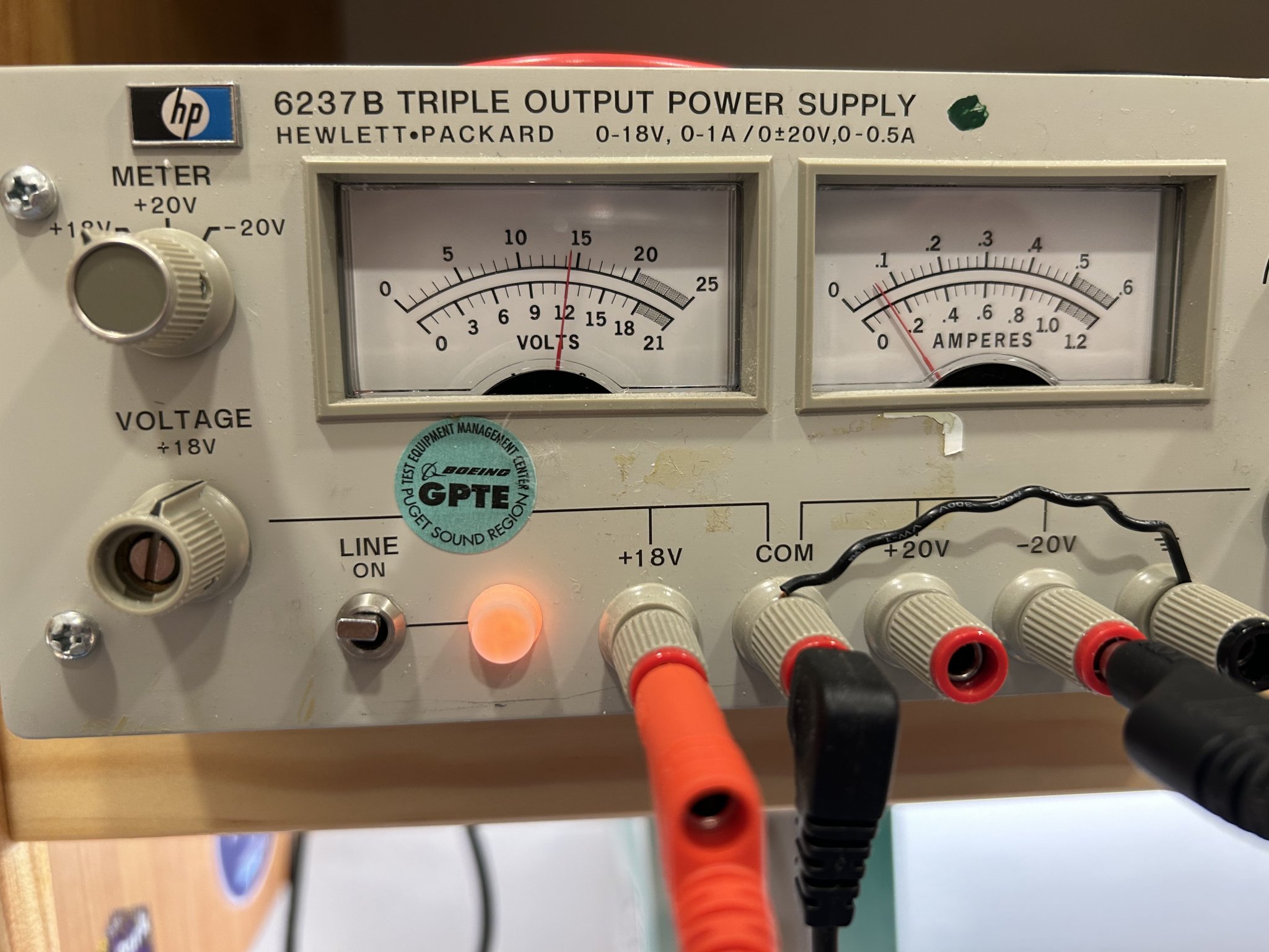

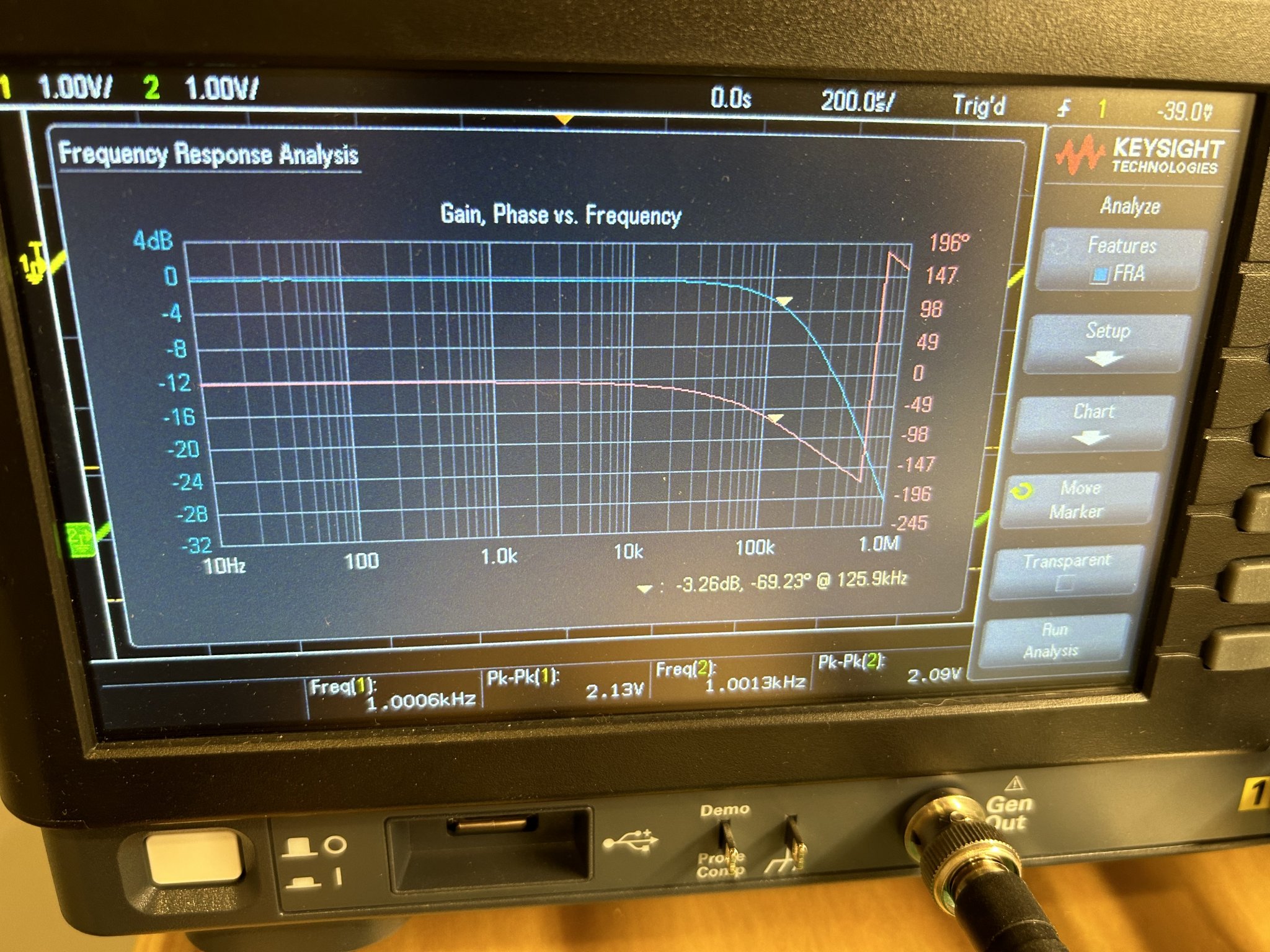

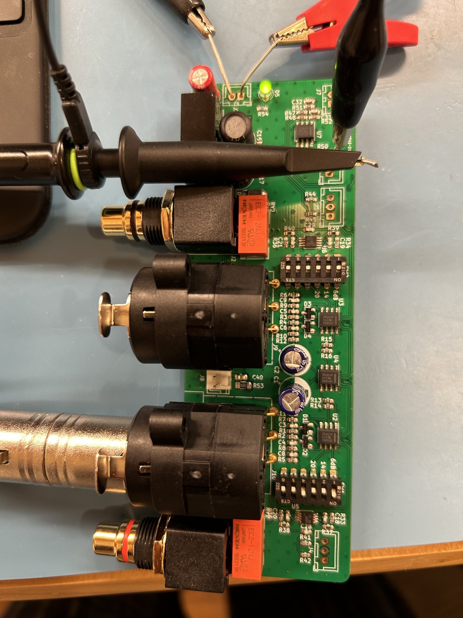

Bode plot from my Keysight scope of one of the channels on this BTSB board. I set the dip switches for “0” dB gain for easy visuals. All the other settings (-6, 0, +8, +14 dB) look the same - recall I did the (-6dB) modification by altering resistors R33-R36 to 2K49. Bode plot shows -3dB @ 125khz from the unbalanced output. Phase is flat to about 20khz, -25 degrees @ 40khz, -60 degrees @ 100khz. Used my HP6237B bench supply to set it to 12VDC. The board draws about 100mA of current.

Nice tools! I never had an automatic Bode plot thingamajig… 🙂
The phase is probably a function of the input EMI / RFI filter network. If those are removed it would be much higher. Although flat to 20kHz should be fine for most folks.
