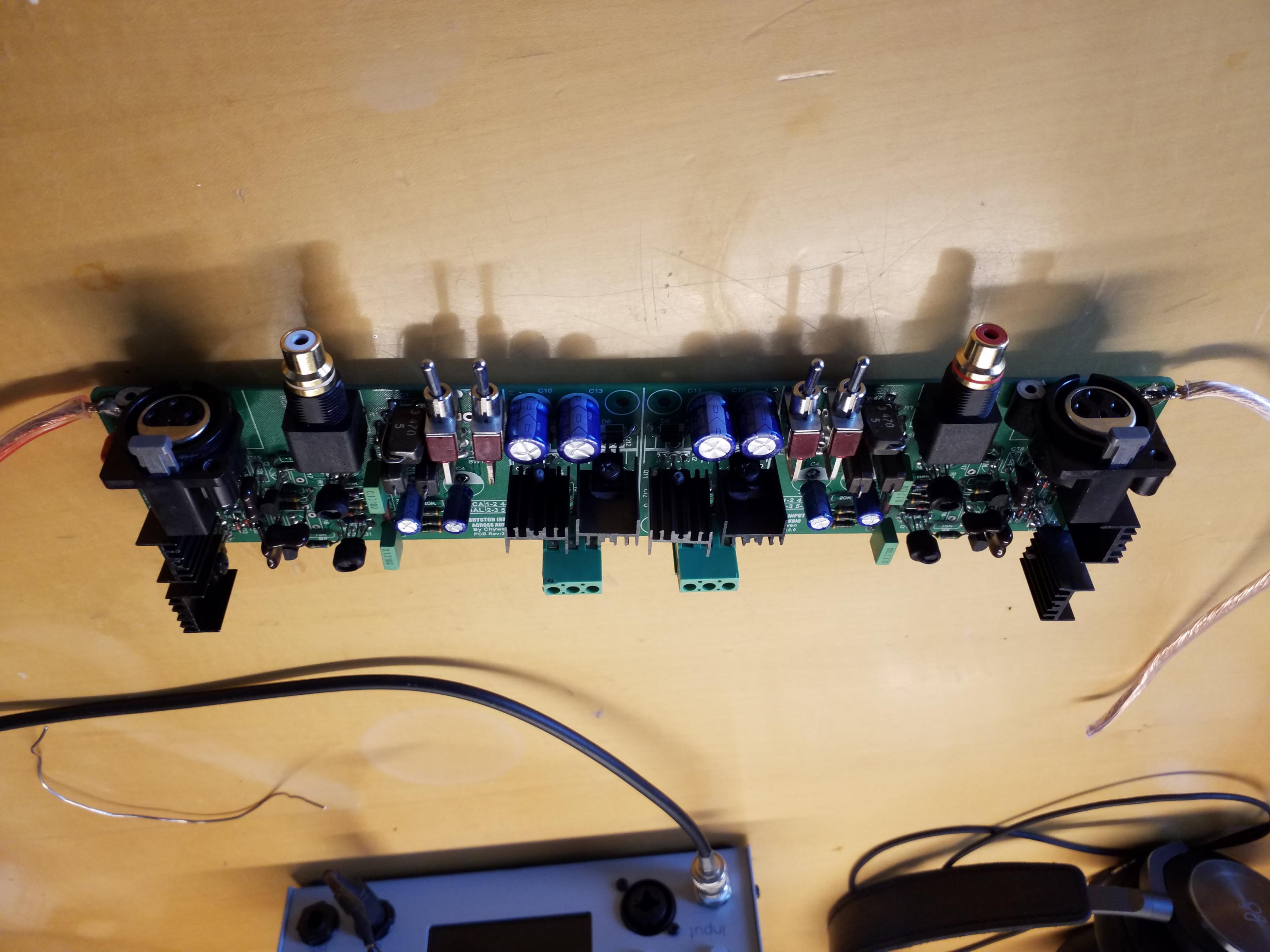

Bryston input board
Hello again.
I decided to put my input board for the Bryston 4bsst up for sale, I want to use external buffer amp, and experiment with both discrete and chip .
The board is populated only with quality parts.
You can find it in swap meet, I also have most parts for a complete new build if anyone should get the urge.

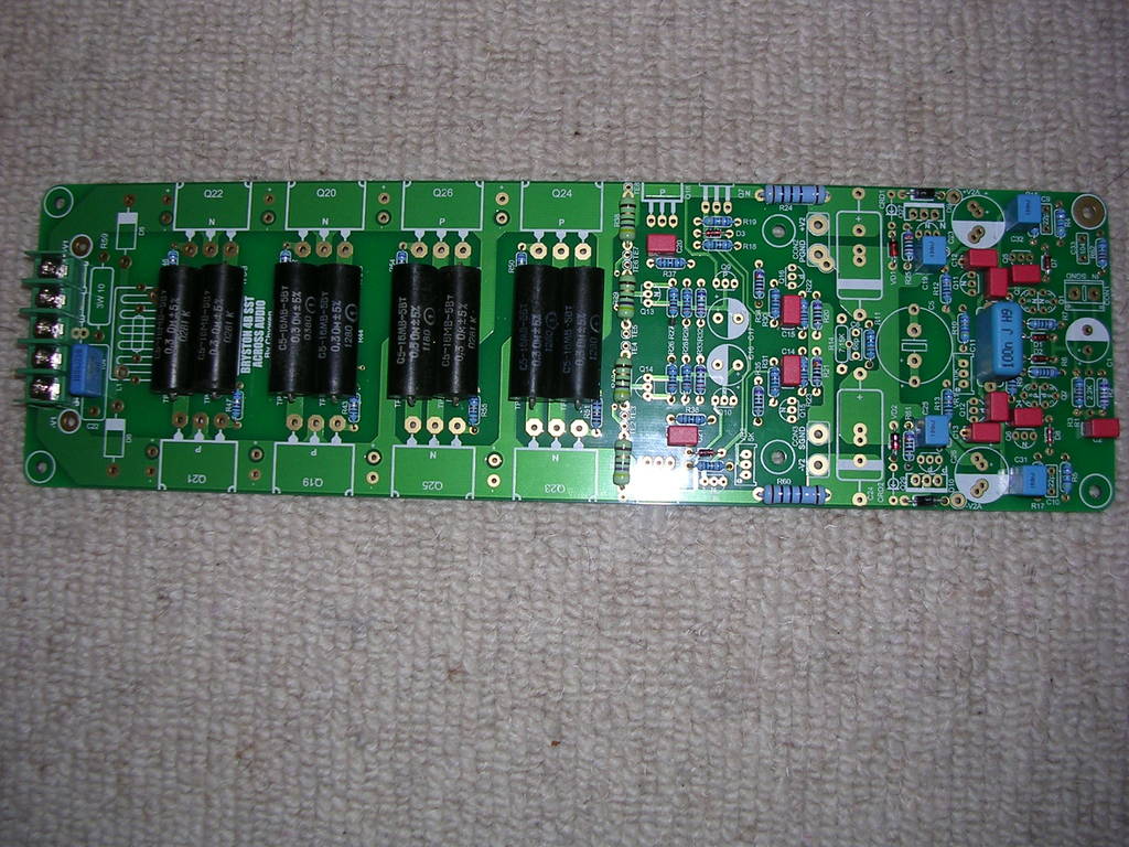

Some progress at last! Getting on with the power amp modules. I tend to review each component as I insert it into the pcb and I've come up with a couple of things. The "real" Bryston is dc coupled but the "clone" has 10uf ( standard electrolytic ) dc input blocking capacitor at the input. Not a problem if the capacitor has the right value and is of the right type. However both the Bryston and its clone power amp module have a very low input impedance ( 1k ) and are intended to be paired with a high current drive input module. No problem with the dc coupled Bryston; but the 10uf capacitor and the 1k input impedance of the clone lead to the voltage output of the amplifier module being 6dB down at 12.5Hz. This is a bit too high for me so I use a 100uf bipolar to reduce the lf rolloff to well below audible frequencies and reduce the distortion. I also use a 2200uF 16V bipolar electrolytic in the feedback path instead of the standard electrolytic in the BOM.
New builders should note that the PN100A/PN200A small signal transistors used in the input and power amp modules are now obsolete and pure unobtainium from the major distributors. Fortunately the BC546/BC556 are a good substitute as long as you remember to put them in backwards; the leads run cbe rather than ebc. The BC546B/BC556B ( hfe 200-450 ) are readily available, but the more desirable BC546C/BC556C ( hfe 420-800 ) less so because the major manufacturers no longer produce the C variant. Fortunately Diotec still manufacture the BC546C/BC556C and can be found if you shop around.
This may be a blessing in disguise because the PN100A/PN200A have a lower hfe range ( 300-600 ) and a lower Vceo ( 45V vs 65V ) than the BC546C/BC556C. Notice that a PN100A/PN200A pair are used as a complementary VAS in the input module discrete opamp, in both the Bryston and the clone, running off of +/-33V supply rails! I wouldn't test the clone input module by itself at full output for any length of time! Not a problem with the BC546C/BC556C pair.
The matching between PN100A and PN200A seems to be a bit of a problem - In my case one set of hfe is clustered around 300 and the other around 400. Not ideal. I'm waiting for my BC546C/BC556C to arrive and if the matching is better I'll replace the PN100A/PN200A in my input modules with BC546C/BC556C and lso use them for the input LTPs of the power amp module.
Finally I used 1% 1W metal film resistors for R14 and R38-41 rather than the 0.25W and 0.5W listed in the BOM.

Diotec BC546C/BC556C arrived today. I sampled 12 of each and both types have hfe in the range 480-530. Looks like I'll be able to get perfect matches for all of my Bryston clone pcbs. Yippee!!! Haven't checked the Vceo yet but will do so today and report back. I got the devices from V&U Electronic Components in the UK, but Diotec have distributors in most EU countries and the US so availablity shouldn't be a problem.
Vceo measures 75V for the npn and 95V for the pnp parts, so they appear to be generously specced. Definitely be using these rather than the PN100A/PN200A.

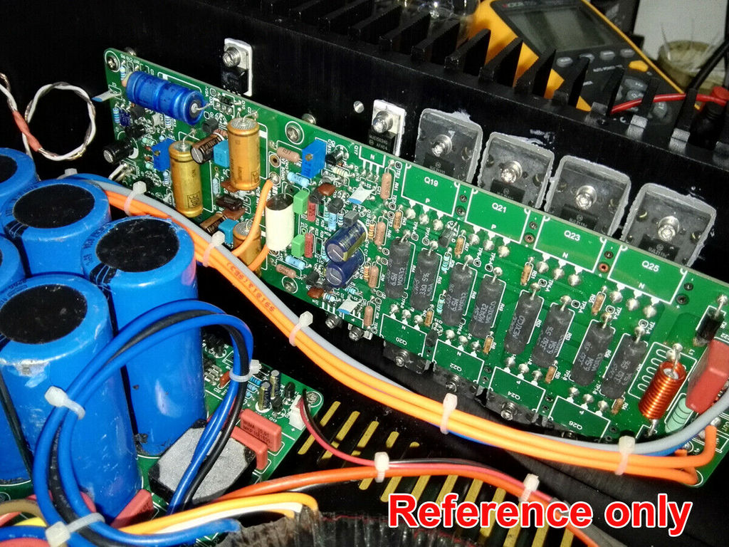

How is the bias spreader thermal sensing done on that clone? Exact same as the real bryston? One TO92 and one TO126? The TO126 mounted on the heatsink just like the rest of it?
Any photos with such details?
What bias current ended up being adequate? 25-50mA or so?
Yes its done in exactly the same way as in the Bryston amps proper. You can see the to92 at the top middle of the pcb next to the blue trimpot. The T0126 is vertically below the to92, bolted to the heatsink with a stainless steel capscrew ( its the leftmost one ). Don't know about bias current as I haven't quite finished my power amp boards yet. If Amplitude drops by he'll let you know as his amp is finished and working.
Forgot to mention; my BC546C/BC556C turned up a day or two ago and both the pnp and npn parts have hfes clustered very close to 500 - Result! I'm really pleased with that. I also have batches of closely matched 2N5401/2N5551 which are also used in this amp.
Are you certain you're pointing at the right one(s)?
It would make sense for the trimpot to be very close to the to92 bias tranny, and it would also make a lot of sense if the other bias tranny wasn't overly far from that. But from what I can see, the TO220 that is near this, is also right next to the outputs, which would be one of the drivers (MJE1503x), and I don't see a to126 so close to the to92 and trimpot.
Now that to220 further on the left, near that big blue electro cap, isn't a to126, unless the mje180 was replaced by something else in to220, and it seems a little far away from the trimpot and to92... Weird!
It does make sense not to use the to92 for thermal sensing, mostly because it's awkward to mount properly for thermal contact, and that contact can never be that good anyway. It's not geared for that purpose, so it's much better to use a to126 properly mounted on the heatsink, for best thermal contact.
It seems there it a to92 very close to that to220 on the left side there near that big blue cap, but then no trimpot nearby, which hints at not being the thermal/bias stuff...
If we had a schematic to refer to, with part names, we could remove ambiguity and make sure we're looking at the right parts.

The to92 ( 2N5551 ) is indeed at the top of the pcb next to the trimpot and the other half of the bias spreader is a to225 ( MJE182 ) on the other side of the pcb. Weird I know, but there you are.
Weird indeed. Why go so far away...
But I get it now, having poked around the blank pcbs and blown them up on screen hoping to see a little more. I see what was done with it, and the traces crossing that board to reach that other one on the board's other side...
I wonder what the motivation was for that far separation, but I see now how it was done.
So it confirms the fact that the to92 isn't used for thermo-sensing at all, and only that other one is doing it. I'll have to do some spice sims on this, to understand more how it really works.

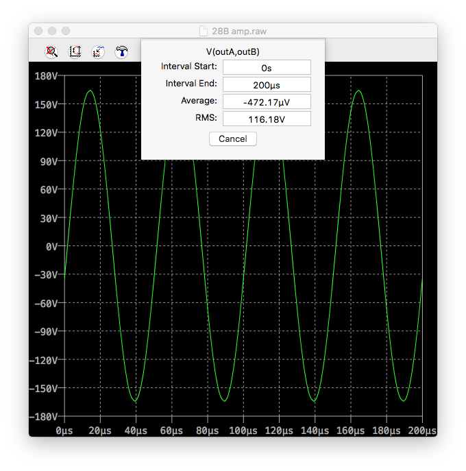

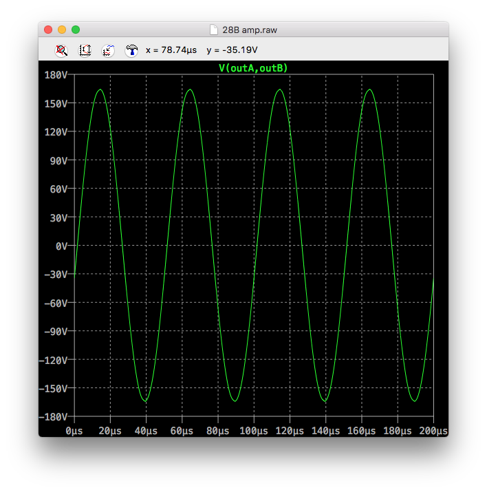

I'm playing with a full bridge right now of the 28BSST2 in sim, and it's doing great even at 20khz, with lower than 20ppm thd at some 1kw of power output on 8ohms resistive. With the rails set at 92V (unloaded) as they are on the real thing, with their 2kVA toroidal giving 2x65V...
And I just pushed it some more, not clipping yet, and although thd has increased to a little more than 0.12% (still 8ohms res load), we're talking about nearly 1.7kW output power. Must not be very far from clipping though, which would explain the rising thd...
Attaching some screenshots of the output..

I wanted to attach a couple of screenshots from that bridge sim:
- Bryston 4B SST clone
