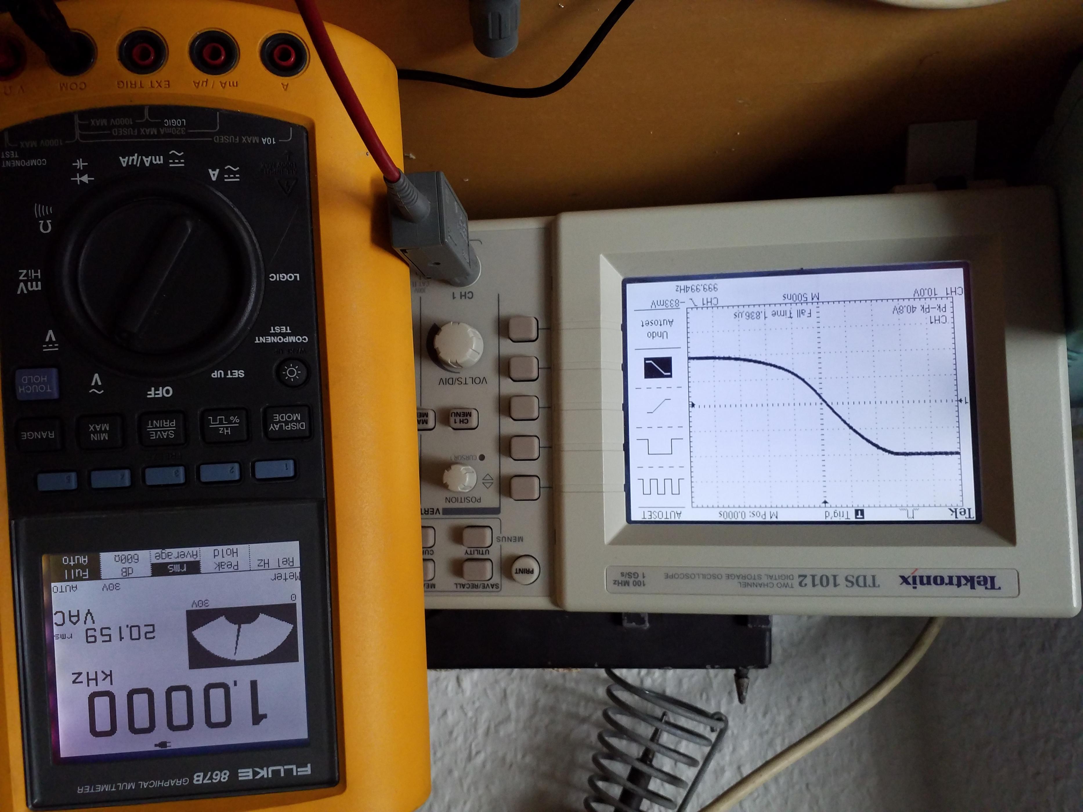

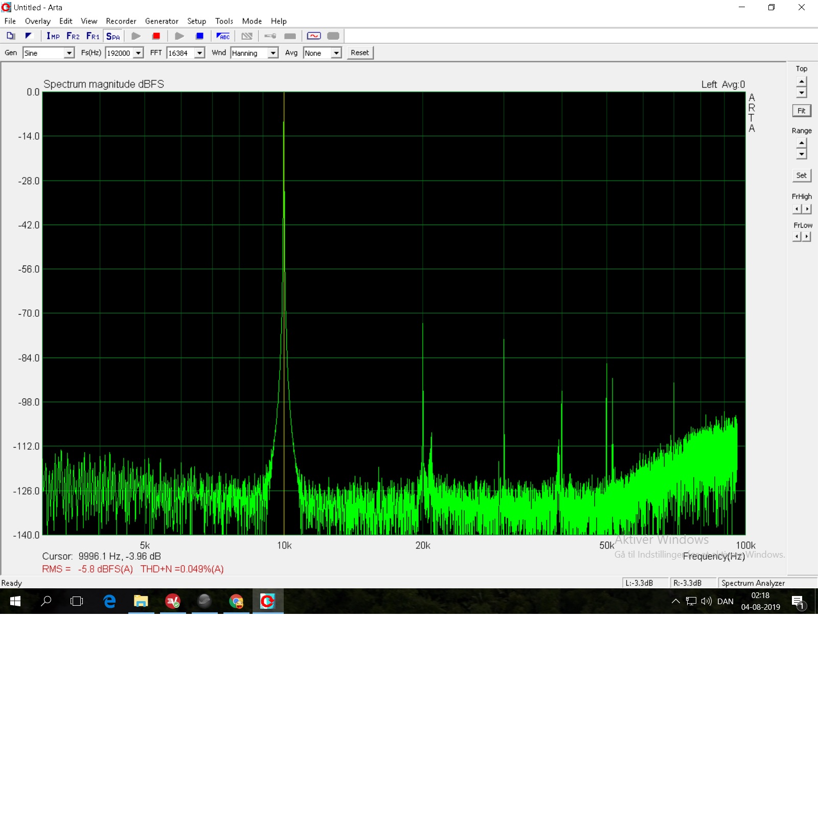

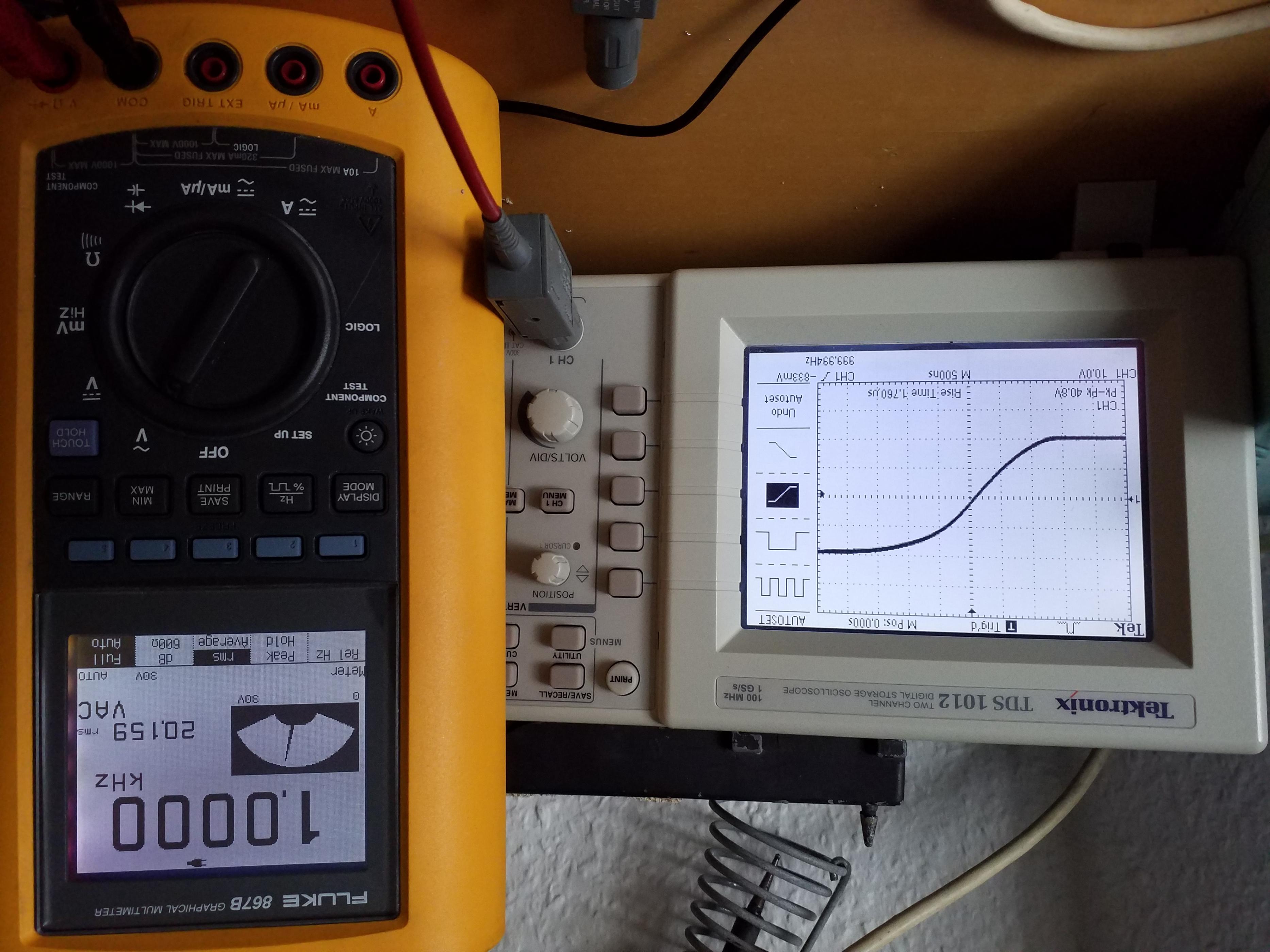

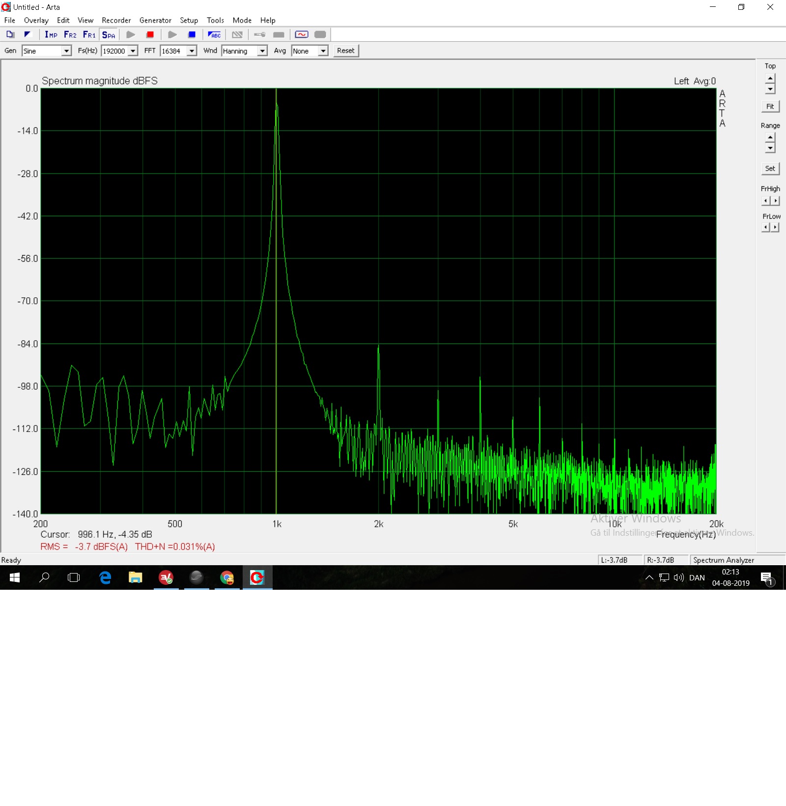

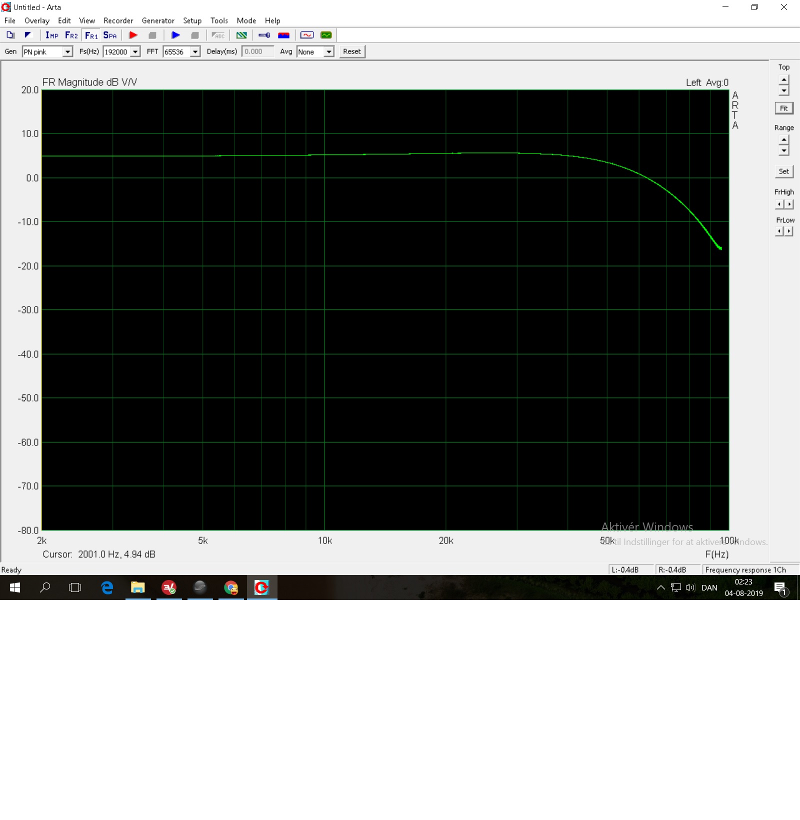

A few measurements.
sound card is not able to deliver full voltage swing.
1. response
2. 1khz 20v rms
3. 10khz 20v rms.
sorry for the rotated pics.
i found an old noisy signal generator and with 1 khz amp started clipping at 45 volt or approx 250 watt into 8 ohm load. i dont have a 4 ohm load yet.

Interesting, quite decent results. Thanks for posting. Bryston themselves quote distortion figures of < 0.005% 20Hz to 20kHz at 300 watts into 8R. However they do closely match all of their transistors, an option that isn't open to us.
In general terms I wonder how much of the distortion comes from the front end and how much from the output stage. The front end has lowish open loop gain and so there won't be an awful lot of negative feedback to lower the overall distortion. But maybe this is intentionally a low feedback design. Ideally Q5 and Q6 would be Darlington pairs and Q1-Q4 should have emitter degeneration. This would certainly give a degree of distortion reduction. The emitters of the vas transistors are heavily degenerated with R15 and R17 at 2.2k, and the vas current is a bit on the low side at only 2mA. Decreasing R15,R17 to, say, 470R would increase both the vas current and the open loop gain; I wonder how much effect this would have on the overall distortion? Good photographs by the way but I have to stand on my head to look at them, lol.

Yes it doesn't quite live up to bryston nice specs, I will measure sound card it self, to see it's own distortion, then only the input stage, that must give an idea where to poke around.
But I will have to build a low noise buffer for my soundcard it cannot drive the amp, am looking at lme49600 capable of an quarter amp drive and 0.00003% distortion.
The harmonics on the spectra look a bit like crossover distortion "like soldiers marching off into the distance". Perhaps try to minimize distortion by carefully adjusting the quiescent current whilst observing the spectrum. Then try leaving it for an hour or so to see what happens to the distortion. I assume that the amp was driving an 8R load when you measured the spectra?
Yes I only have an 8 ohm load, it's made up from 275 2k2 5 watt resistors, it can take some beating, I Will try adjusting bias with analyzer hooked up and see if I can get the soldiers back in their trenches:)
