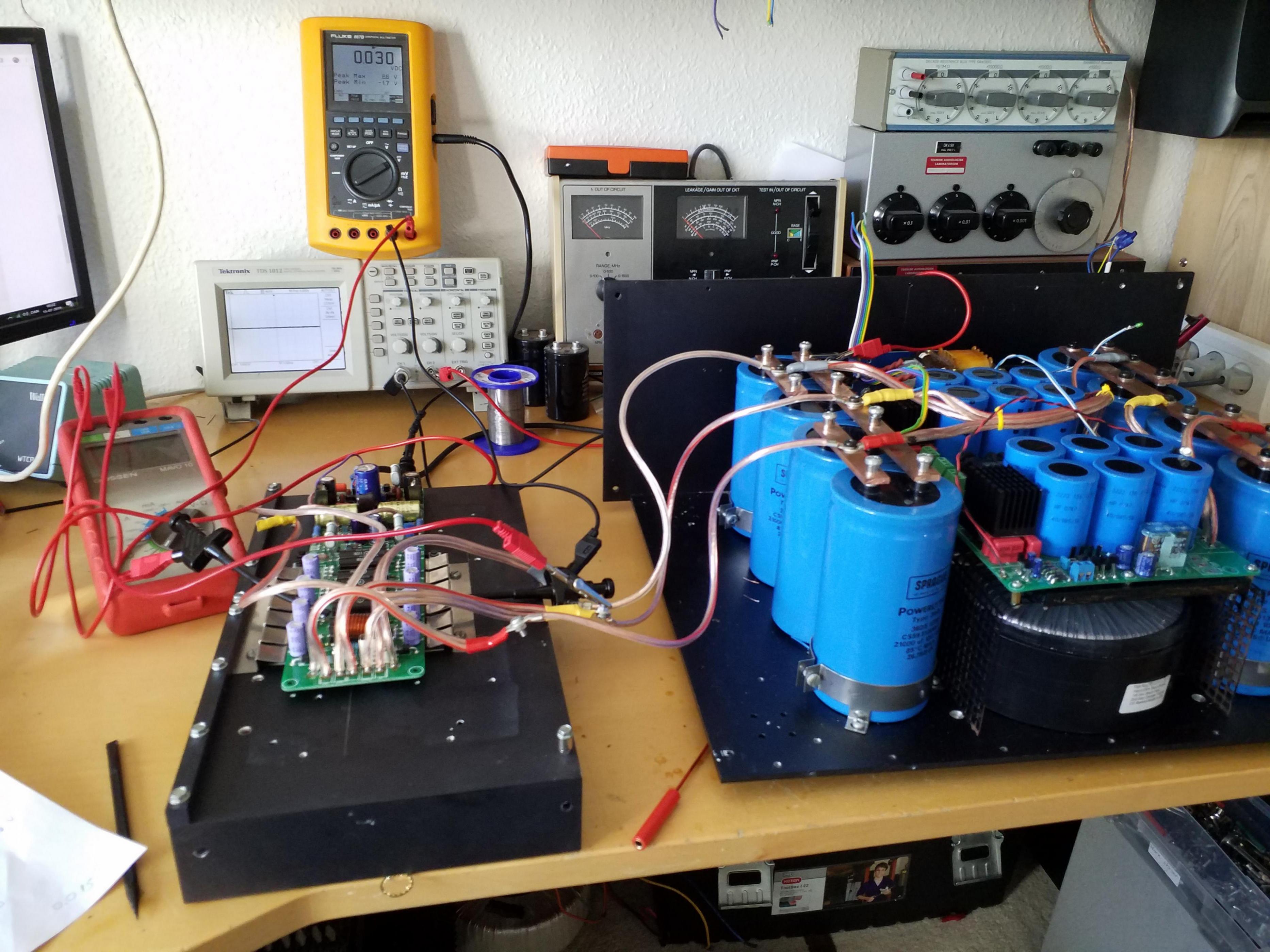

I'm tempted but it's a costly project, oh by the way the output board is running smoothly, at trafo primary it's idling at 70 watts,
Good to know design is ok before I build my output boards - thanks. By the way what voltage are you running the boards at? As you say the 28B sst2 project would be costly - the power supply and output transistors alone would cost a substantial amount. In my experience if you're tempted then at some point you're gonna do it - that's why I have a lab full of power amps that I rarely use!!
I ran the output today at +/- 50 volts, I only used the bench psu, and it maxed out at 50, but ran it for 15 minutes at 50 volt 1khz and lowered it to 40volts for a good hour, heatsink temp stabilized at 38 degrees Celsius, with around 200w output, so I'm happy, the toroid for final build is +/÷ 65volt.

Stock is nice to have, well not if you ask my wife..🙂 finished second output board today, and it's working to..
Thanks chalky,, yes the two toroidals are underneath the protection board in a perforated metal cage, for reducing emi, they are rated 45volts 1200w each, a leftover from an old hypex project, think tomorrow it's ready for powerup,

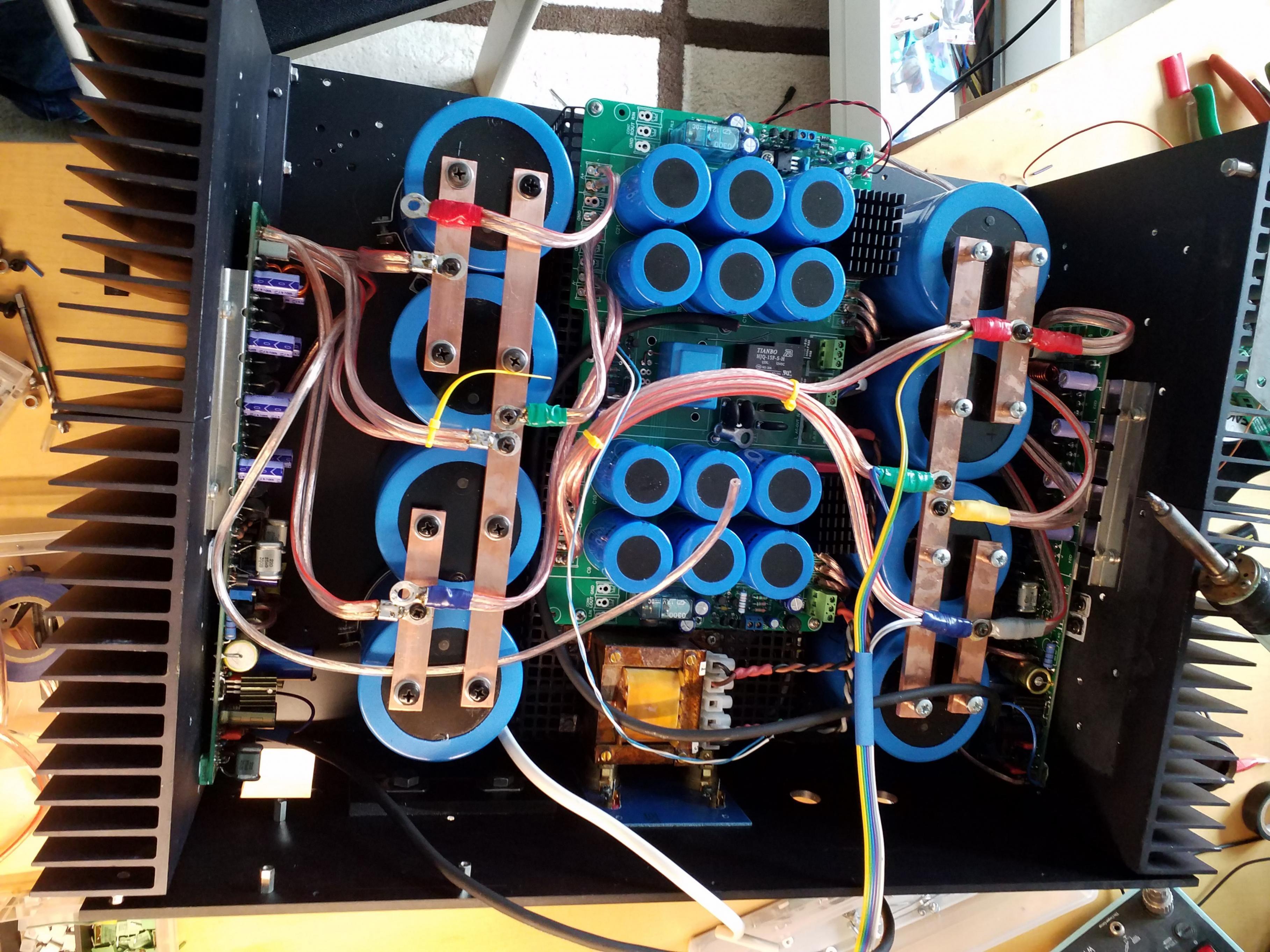

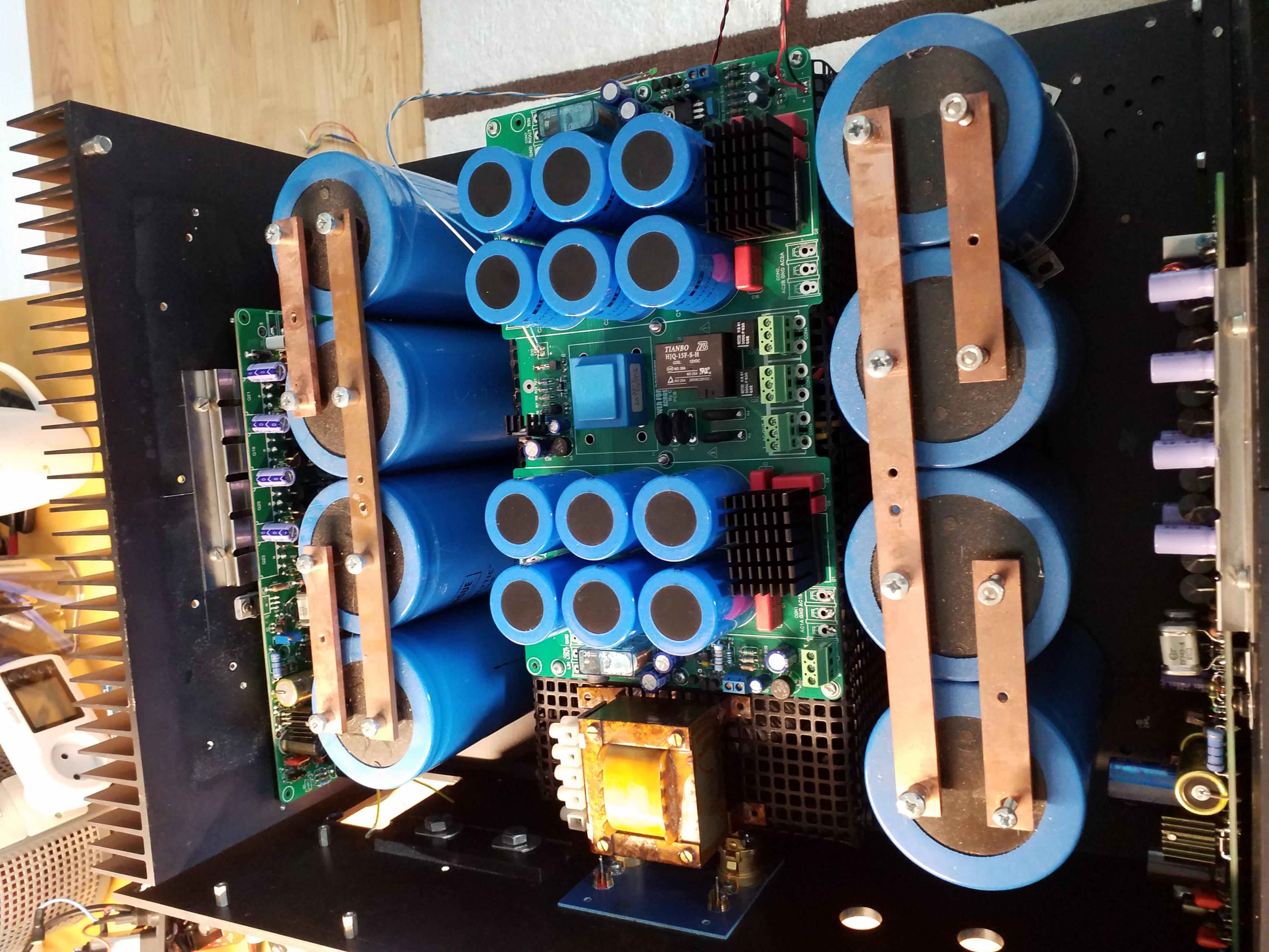

I just noticed that you've added some extra off board smoothing caps to the power supply. What is your total capacitance per rail now? Saw your "nearly completed" pics in the gallery -very nice work!
Hi..

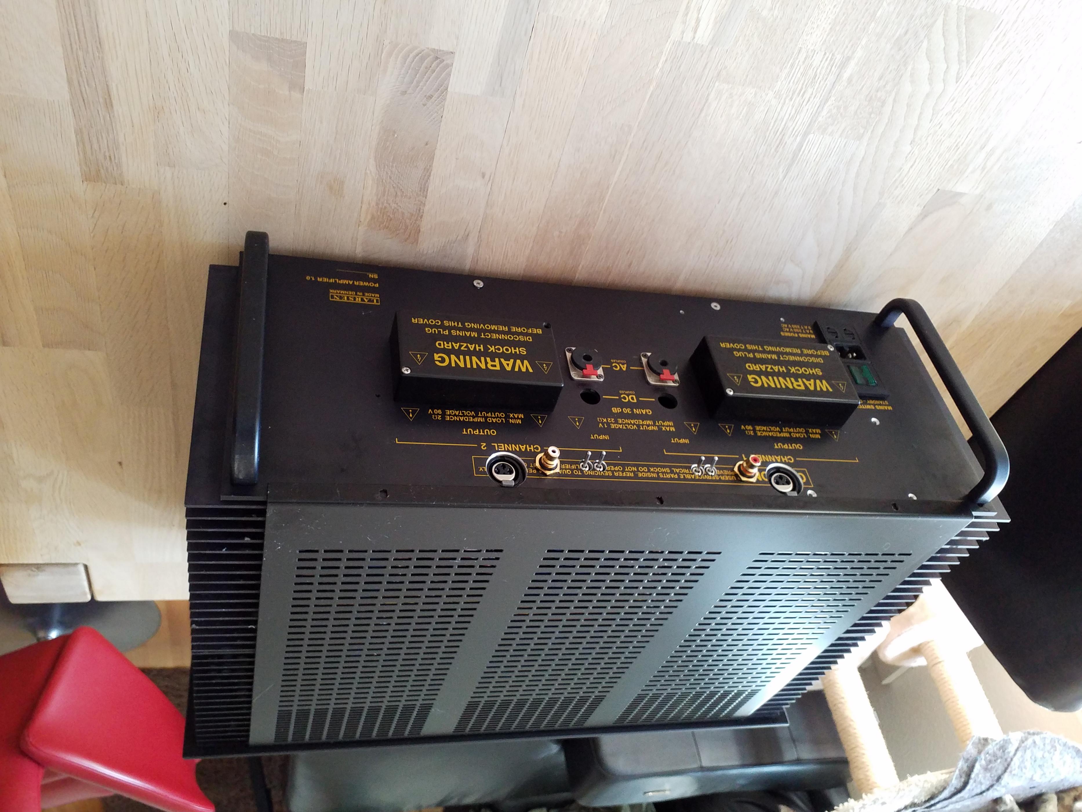

The extra capacitance is because of the amp chassis history, at first it was a proto type for a Danish high end brand, it shorted a lot of to3, and I doomed it dead, then it became a blameless by a guy here named Carlos (destroyer dx), well then the itch started and it became the bryston, so extra caps always been in chassis, total capacitance is 114000uf per rail.
Is there a company that can make rear plate costumized, preferably not to expensive?

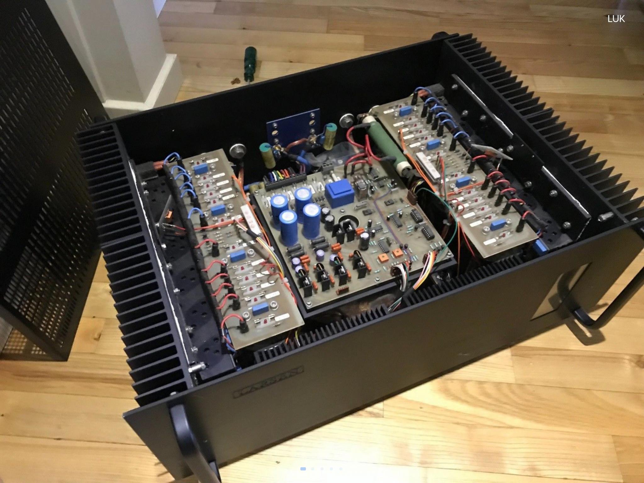

Pic is of the original amp.
If you look on CNC Zone you should be able to find someone fairly local who will do the machining for you ( there's a section for posting work required ). Most big cities have at least one anodising shop so the finish shouldn't be a problem.

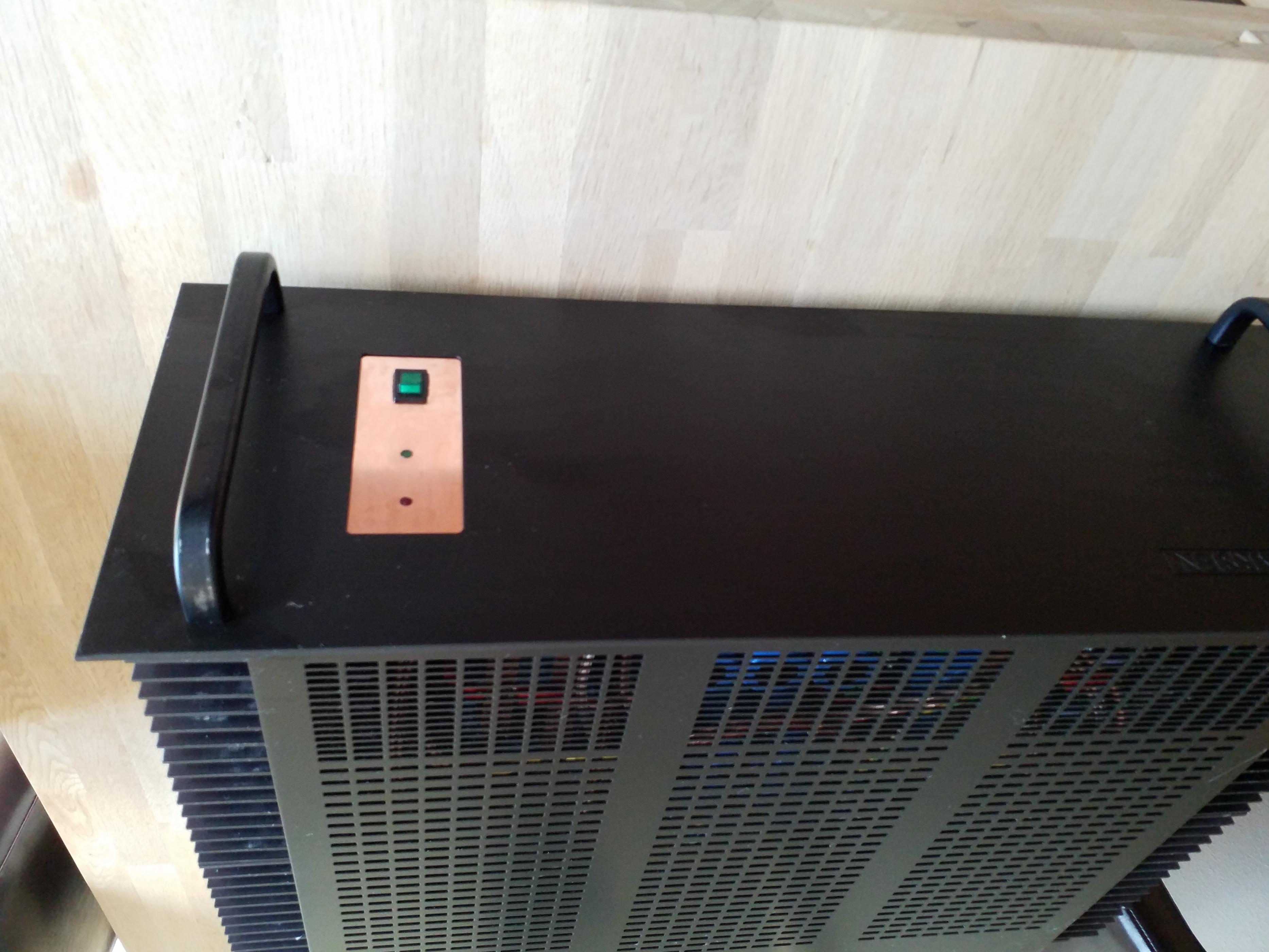

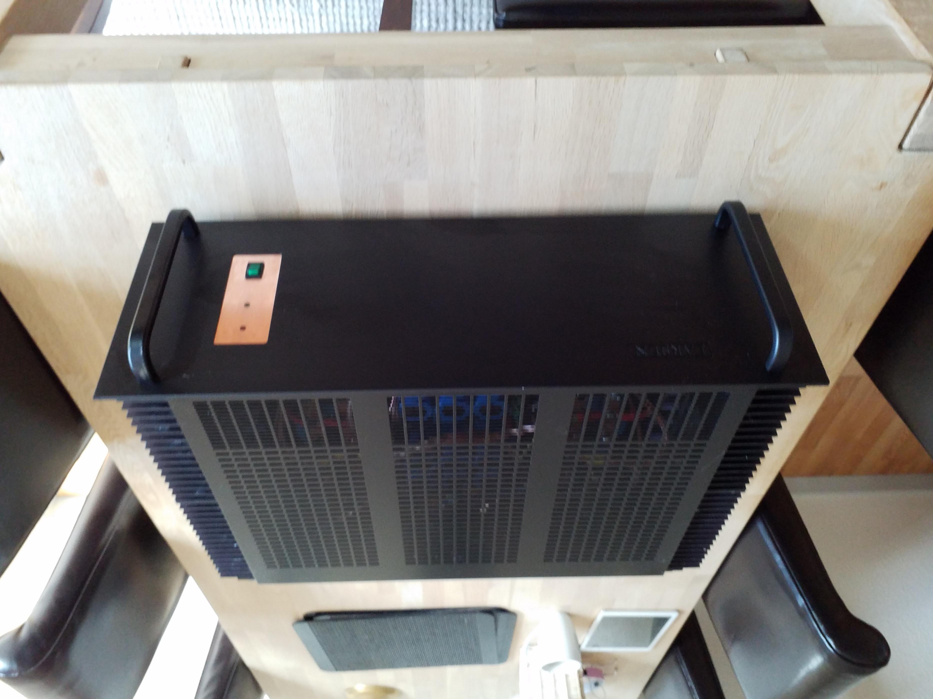

I will do some research cause backplane looks like Swiss cheese, been fiddling with on/off for the amp, front panel has a cutout of 4cm by 10cm, I want to put frosted glass in and a capacitive switch for on/off , using a 555 for latching relayIf you look on CNC Zone you should be able to find someone fairly local who will do the machining for you ( there's a section for posting work required ). Most big cities have at least one anodising shop so the finish shouldn't be a problem.
Finished

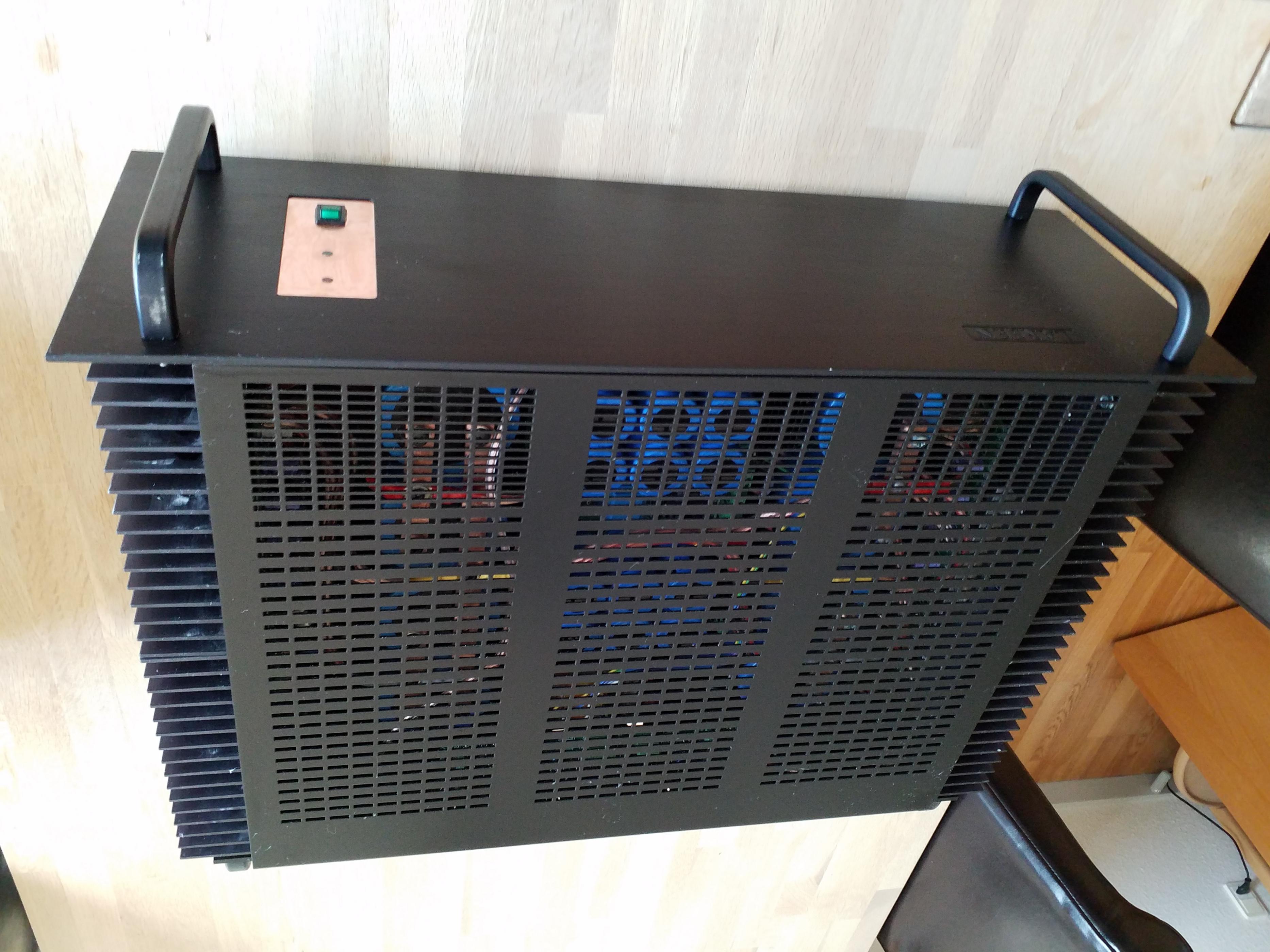

Today I finished the amp, rear plate is fine enough, no need to spend a gazillion on that, I tried a capacitive switch in front panel as on/off switch, through a piece of glass , I couldn't get it to react stable so I went for the good old rocker switch.
