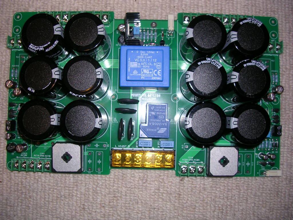

More progress. I've attached a photo of my nearly completed power supply and protection board. I'm going to fix heatsinks to the bridge rectifiers, and make up a couple of solid state relay pcbs to replace the loudspeaker protection relays. I'll make them with the same footprint and connections as the mechanical relays so that they are a drop in replacement on the main pcb. Initially I'll make them up on small pieces of perfboard and then later on I'll do proper pcbs.

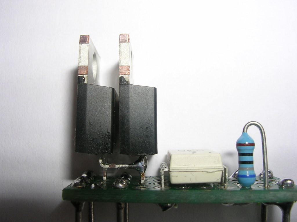

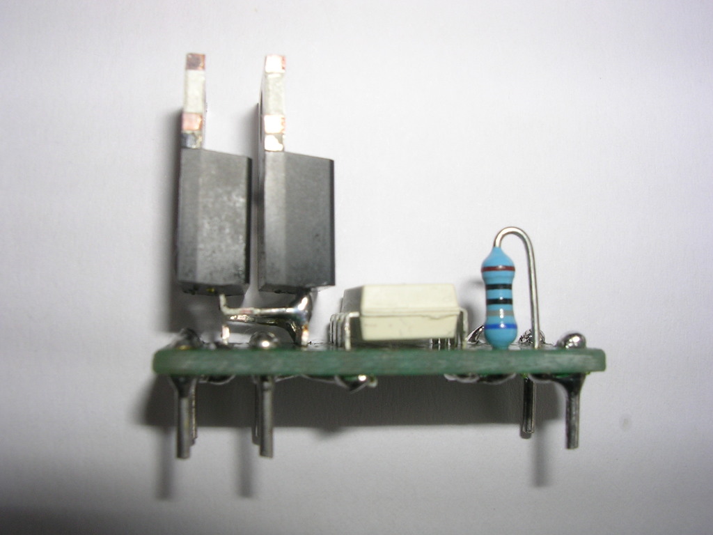

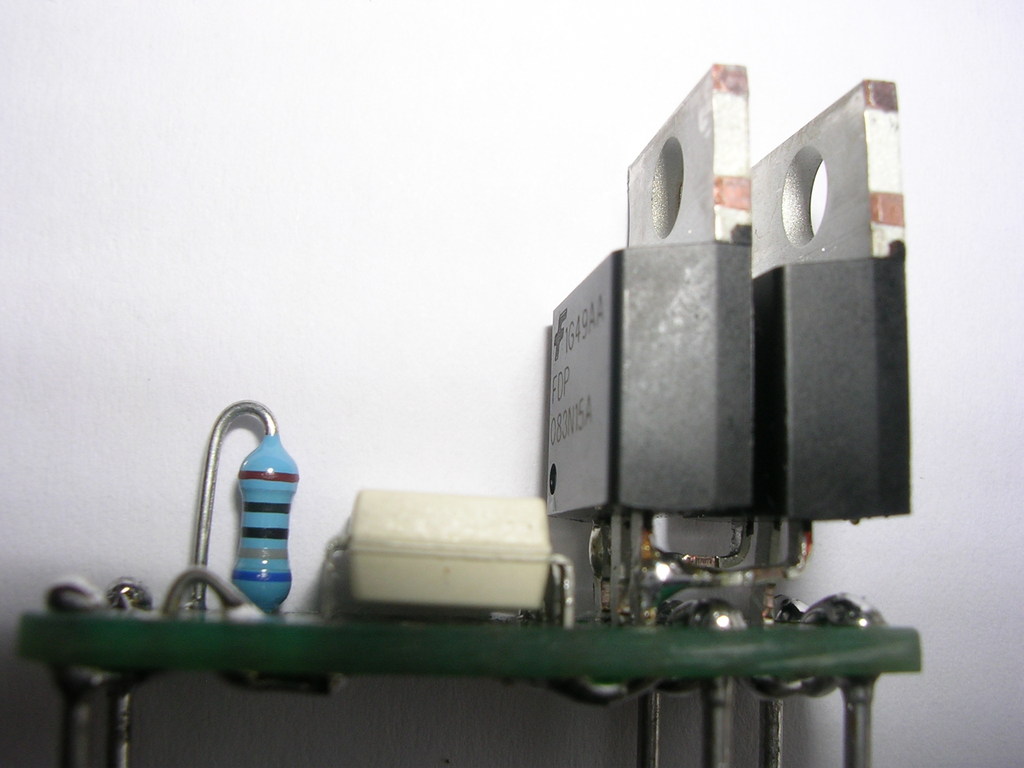

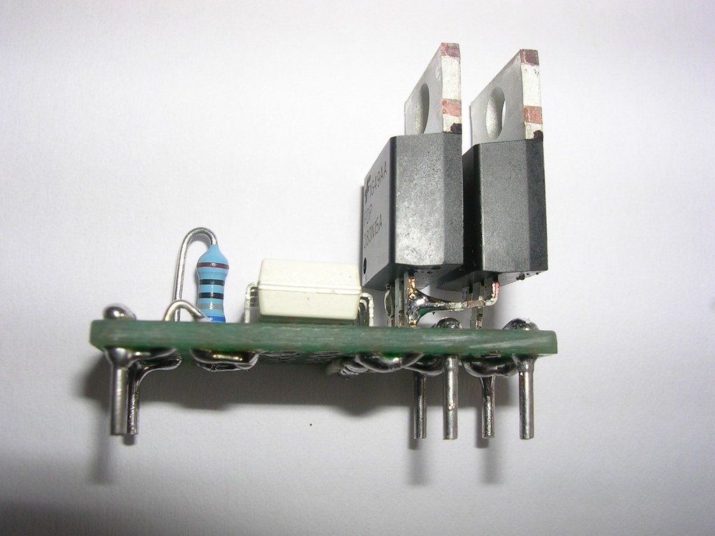

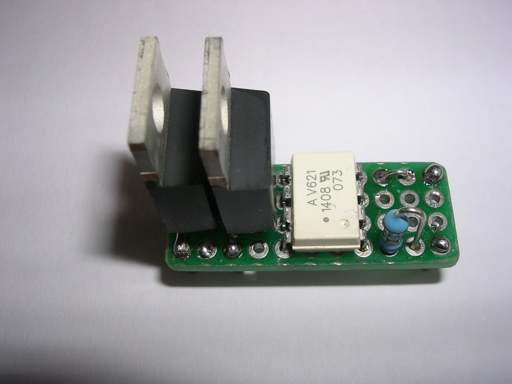

Got perfboard prototype of the solid state relay for loudspeaker protection finished today. It uses an Avago ASSR-V621-302E photovoltaic opto coupler together with a pair of FDP083N15A mosfets ( 150 V, 117 A, 8.3 mΩ ) in the "standard" circuit found all over this forum. The ASSR-V621 leds are connected in series and the photovoltaic outputs in parallel. I use a 680R series resistor to give a led current of 15mA. The polarity of the coil connections to the relays is immaterial for mechanical types but it matters for the solid state version. Unfortunately the designer of the main power supply/protection pcb has not been consistent in his choice of coil polarity connections and so two versions of the solid state relay are required - each with a different polarity for the "coil" connection. The module simply drops into the pcb in place of a mechanical relay.

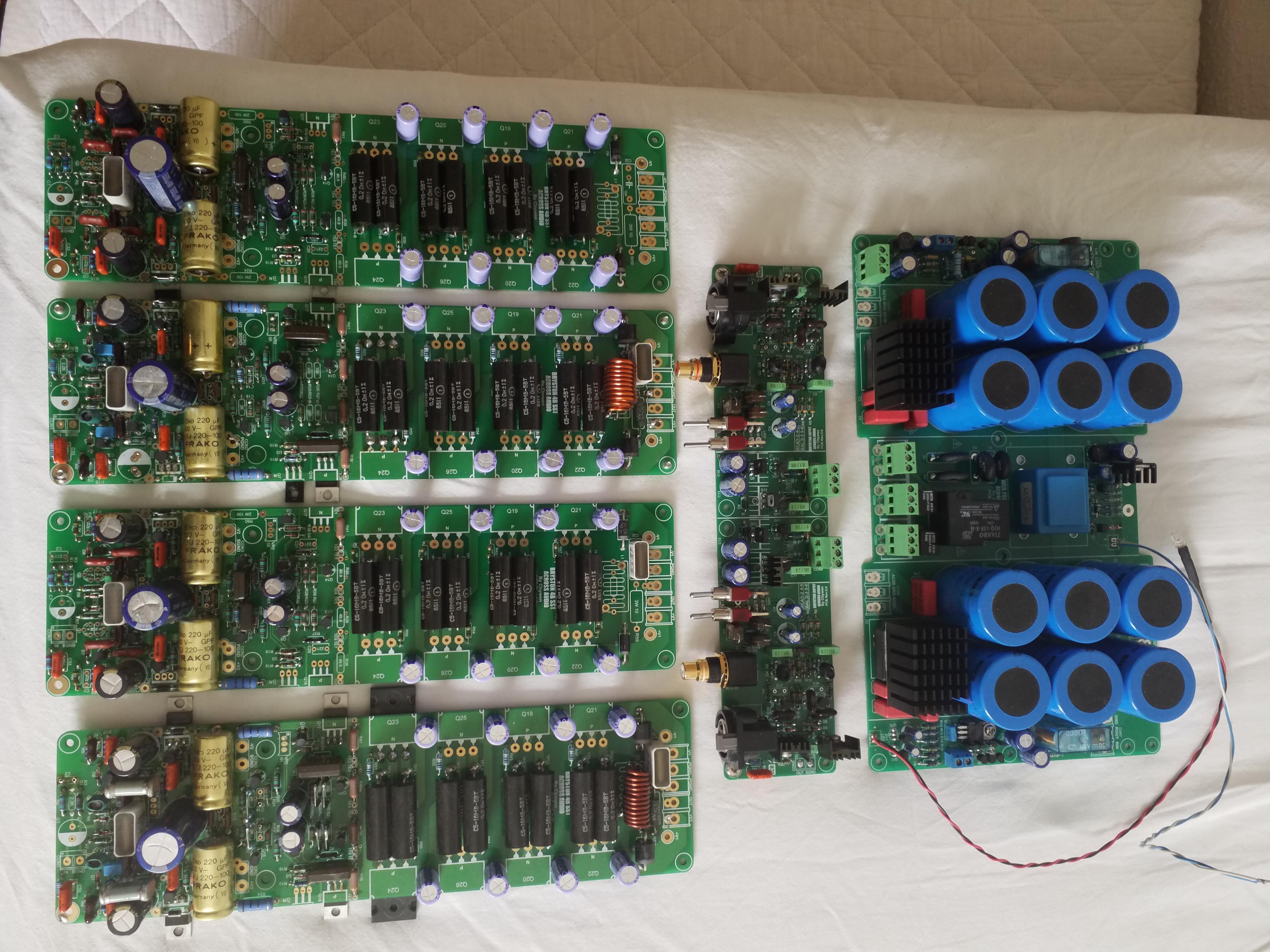

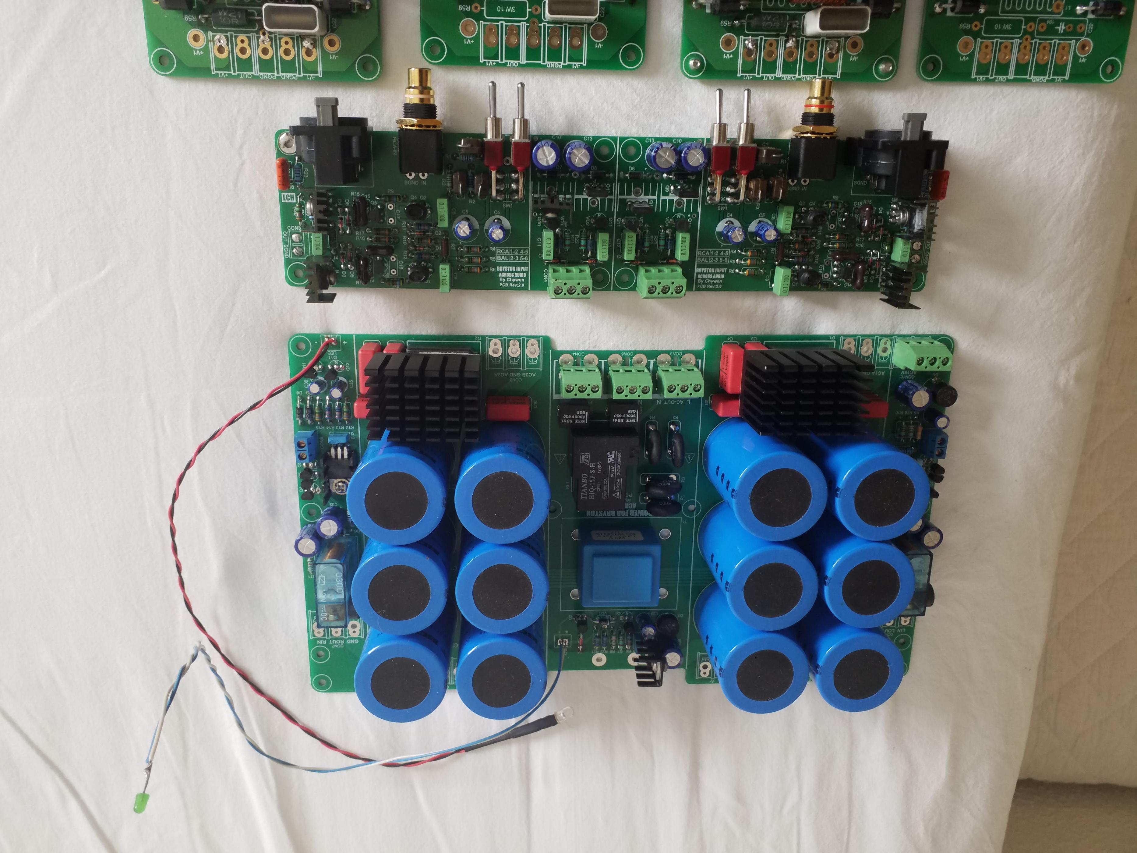

Hello again.
Chalky I see you're making progress, despite you been sick, work also stalled here due to work overload and sickness, well my boards are almost finished, just missing a few parts, input works fine, also psu board, I decided to make it 4 channel with bridging option, I got my hands on a fat 2kw toroid to power the beast, now my worries are finding a suitable large chassis to contain it all, pretty sure it's going to cost the tip of a jet plaine, anybody got it working yet?.

I haven't tested the SSR in a real amp yet but its works fine on the bench switching both ac and dc. The mosfets are FDP083N15A ( 150V, 117A, 6.85 mΩ on resistance ) and the photovoltaic optocoupler is ASSR-V621. Easy, but fiddly, to make on a small piece of perfboard. I'll take some pictures when I make the next one.

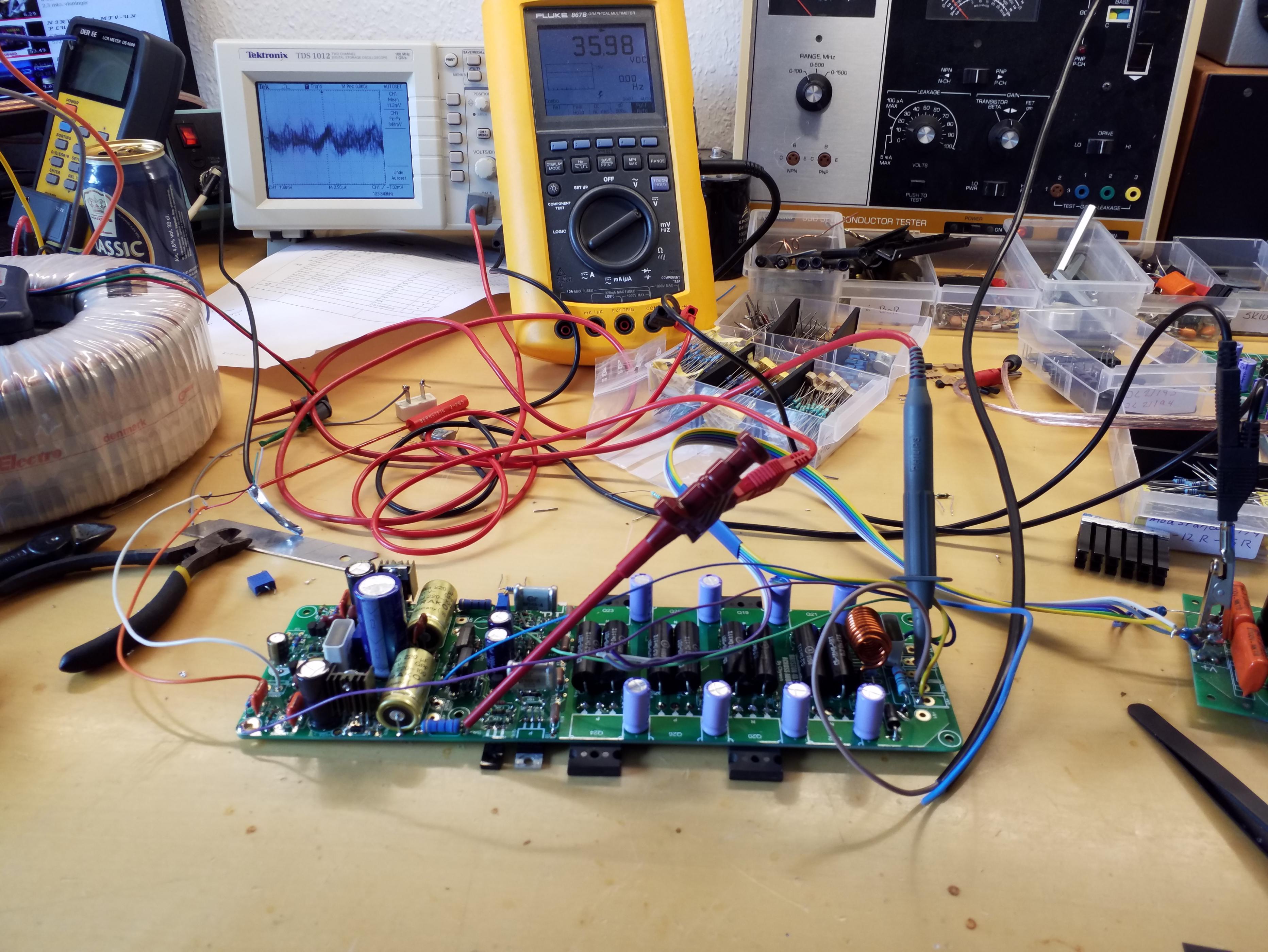

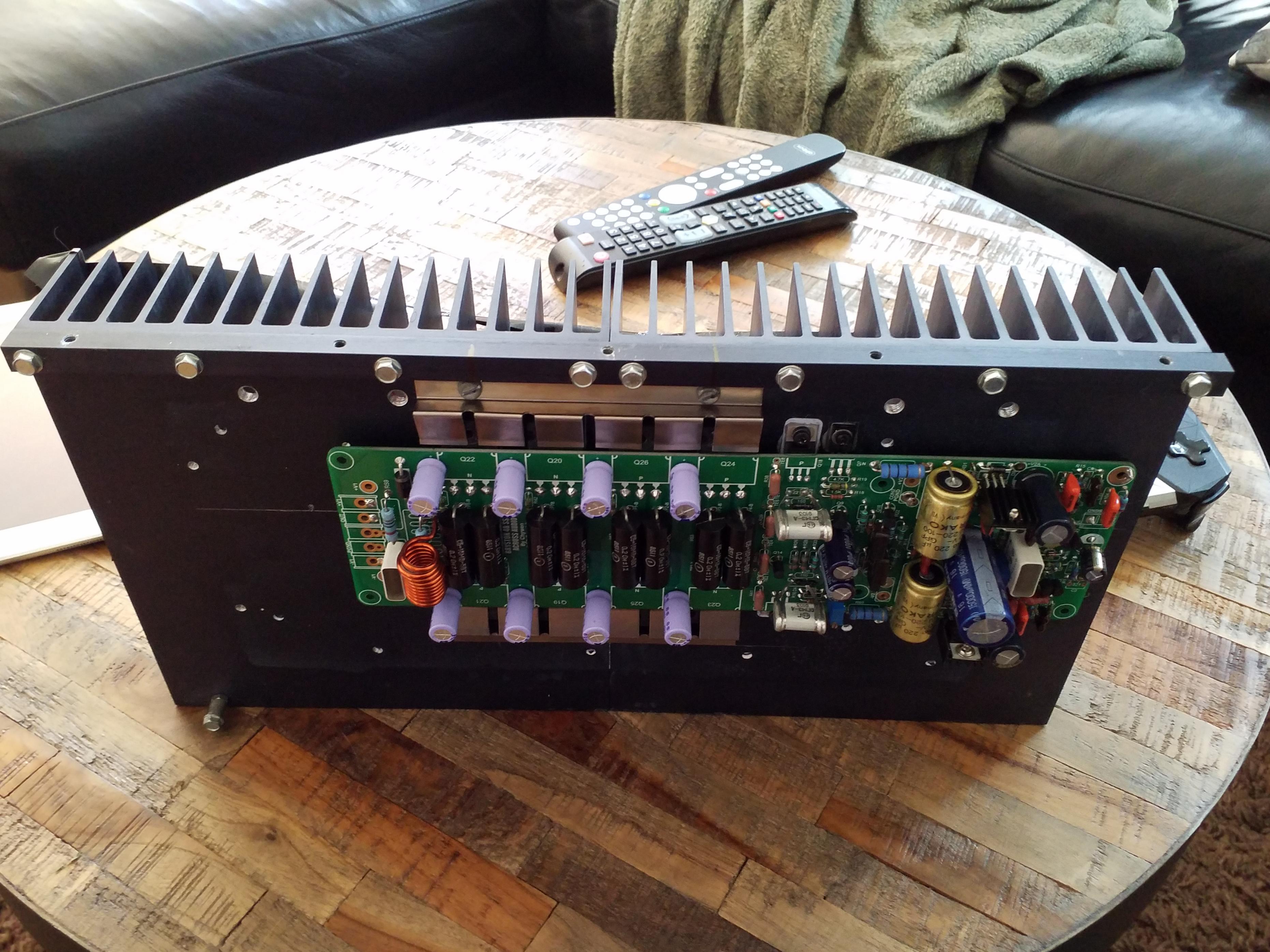

It's alive..!
After lots of hours matching pn100a and pn200a one channel is fully assembled and 100% stabil, put signal generator on and it produces near perfect square and since wave. Can't wait to get heatsink drilled and push it more,

Does that mean that you got a bunch of pn100a and pn200a all with the same hfe or did you just match all of the pn100a and pn200a separately. I haven't been through all of my stock but it looks like matching the pnp with the npn transistors might be difficult. Looking at the current limiting I can make the figures work for 300W into an 8R load, but I can't yet see how they manage to get 500W into 4R without the current limiting kicking in. More thought required.
Hi Amplitude, I noticed that you populated the decoupling capacitor positions adjacent to the output transistors; can I ask what value and voltage rating you used? I was going to use 470uf 100V but these seem to be unobtainium. Best I could come up with are Rubycon ZLJ series 330uf 100V. I'm going to use +/-70V supplies by the way.
Hi.. i had 50 of each pn100/200 I measured all the pn100 and took the highest hfe pair's, I did the same with the 200a and matched the pair's closest, as to the coupling capacitor, I used Cornell dublier 100v 47uf, had a bunch that fitted, my best reason.

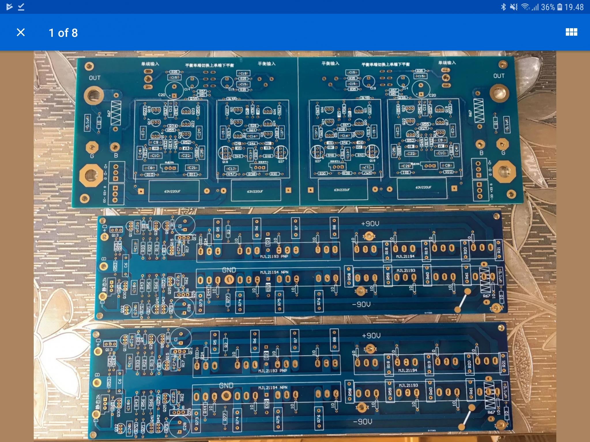

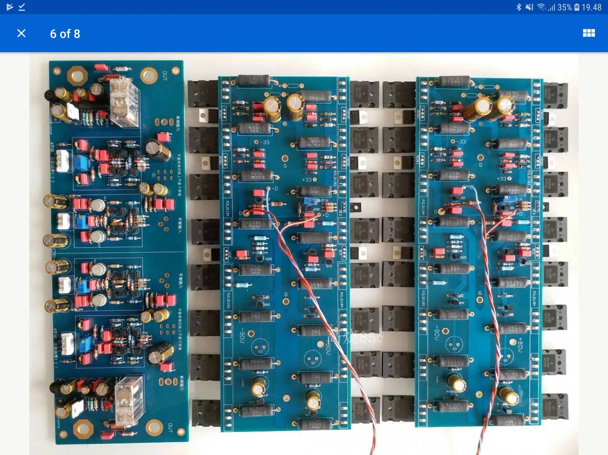

Just saw theese new pcb for the larger bryston 28b sst2, 32 outputs..! It's really itching to build big brother..
