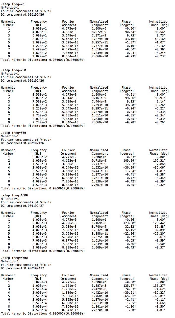

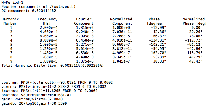

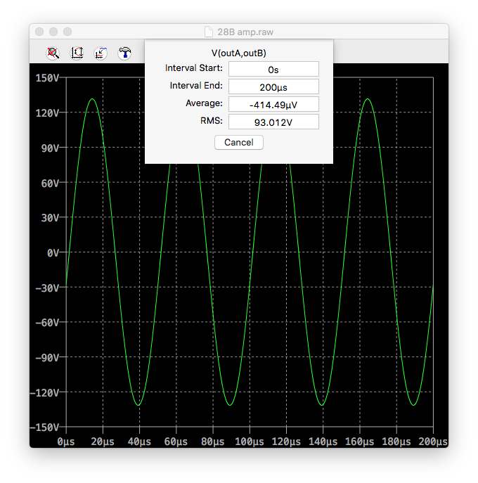

Here an other example of the 28Bsst2 bridge, with a little over 1kW output on 8ohms resistive @20kHz:
Not bad, about 93Vrms on the 8ohms load, more than 1kW, and only about 22ppm thd, and this is at 20kHz. Satisfying. The key is to get a real build to be as close to this as possible. matching parts should go a long way towards that goal..

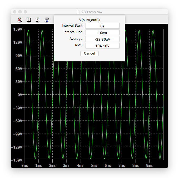

Spookydd why is the thd so high in the sim of post #100? Problem with large batches is that nowadays the processing is so uniform that there is little gain variation within batches. For example, I recently had batches of complementary pairs where hfe for the npns was closely clustered around 200 and all the pnps closely around 300. No possibility of an npn/pnp match. This has been my experience with the majority of cases. Things were better in the old days of 2SA/2SC transistors with their grades of hfe and variations within grades. Sigh.
Has anyone ever tried the version of the complementary differential input stage with current mirror and a darlington vas as described by Douglas Self in his book ( 6th edition pp226-227 )? Basically he puts a current mirror on one set of diff pairs and plain resistors on the other. The resistor side sets the vas current and the other side simply adapts to the set current. Self comments that the circuit is very linear and provides a graph showing very low distortion.
Have you looked at what level this was taken on?
It's 1.7kW of power output, a little bit before clipping starts really kicking in.
What I posted next was just a tad over 1kW and thd is great. It doesn't rise that much even beyond that, but it's normal when getting close to clipping to see a rise in thd, especially since the protection might also be close to engaging.
That amp isn't supposed to be putting out that much, it's rated for 1kW on 8ohms. They mention onset of clipping at some 1.6kW, so that's a bit lower than my findings because there are more losses in a real amp, with wiring and all that stuff, besides just the rail sagging due to transformer losses and the likes.

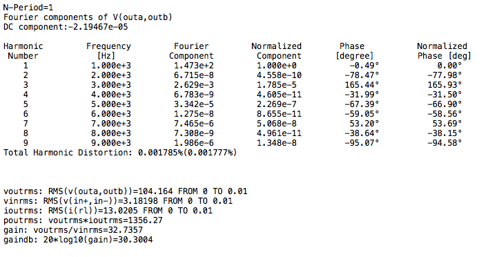

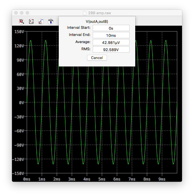

Here's the same 28B bridge on 8ohms @1kHz and a tad above 1kW output:
For this sim, I made it use the PSU sim with the rectifiers and cap banks, plus the regulated parts for the 33V rails feeding the doas. This makes for a very long settling time for the cap banks to charge, and there is a little extra ripple of course, so thd increases a tiny bit, some 1-2ppm thd added. Not much though.
For those 10ms of sine wave that are shown on the plot, 5 times more of that was skipped before that, because the amp isn't functioning quite right with the rising rails.
This is plain vanila 28Bsst2, with the doa68 and how they're basically mated with the power amps as they did with the actual 28b amp.
If we make a few little improvements on the doas, the diff amps stages in the power amps and a few other details, we might be able to improve things a little more. Personally I don't need things like RCA inputs and all those things they add there, especially the gain switching stuff. So I would simplify things quite a bit. I want to remove the electromechanical relays that mute the amps, and replace that by mosfet ssrs on the outputs, on the negative side (no negative side really on a bridge)...

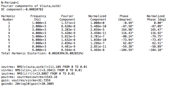

You see, it wasn't a bad thing that thd was rising some at 1.7kW+ output. It doesn't rise until it gets somewhat close to that, right before onset of clipping, quite normal.
Look at ~1.5kW output (same conditions), and we're still not much above 20ppm thd.
It's approaching 160V peak output, and no sign of clipping there.

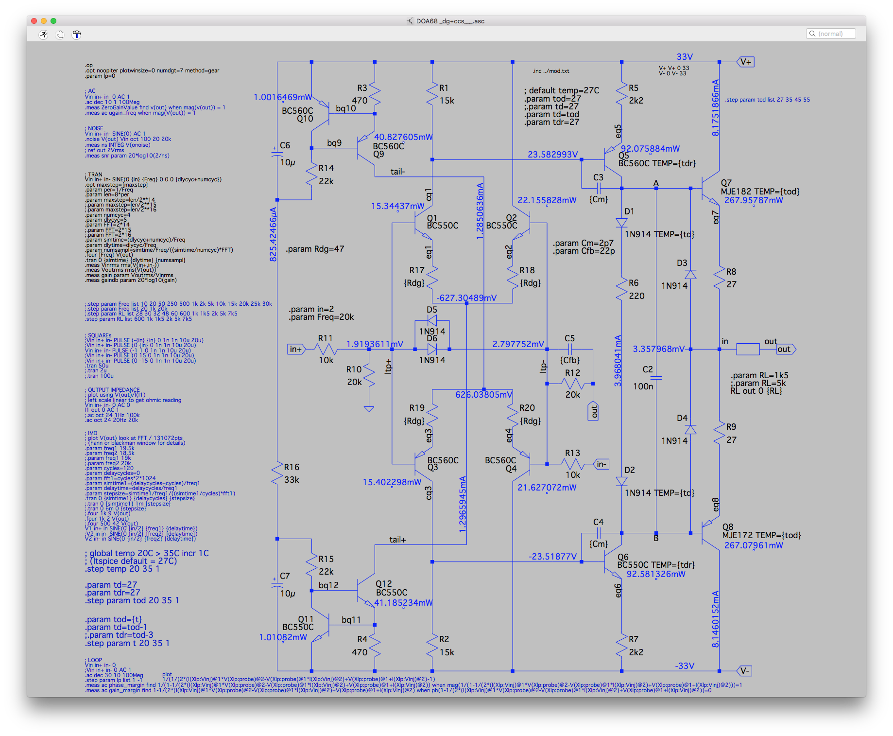

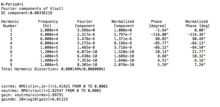

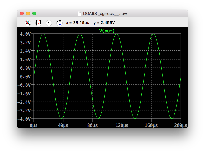

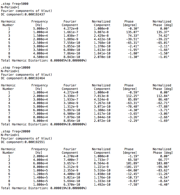

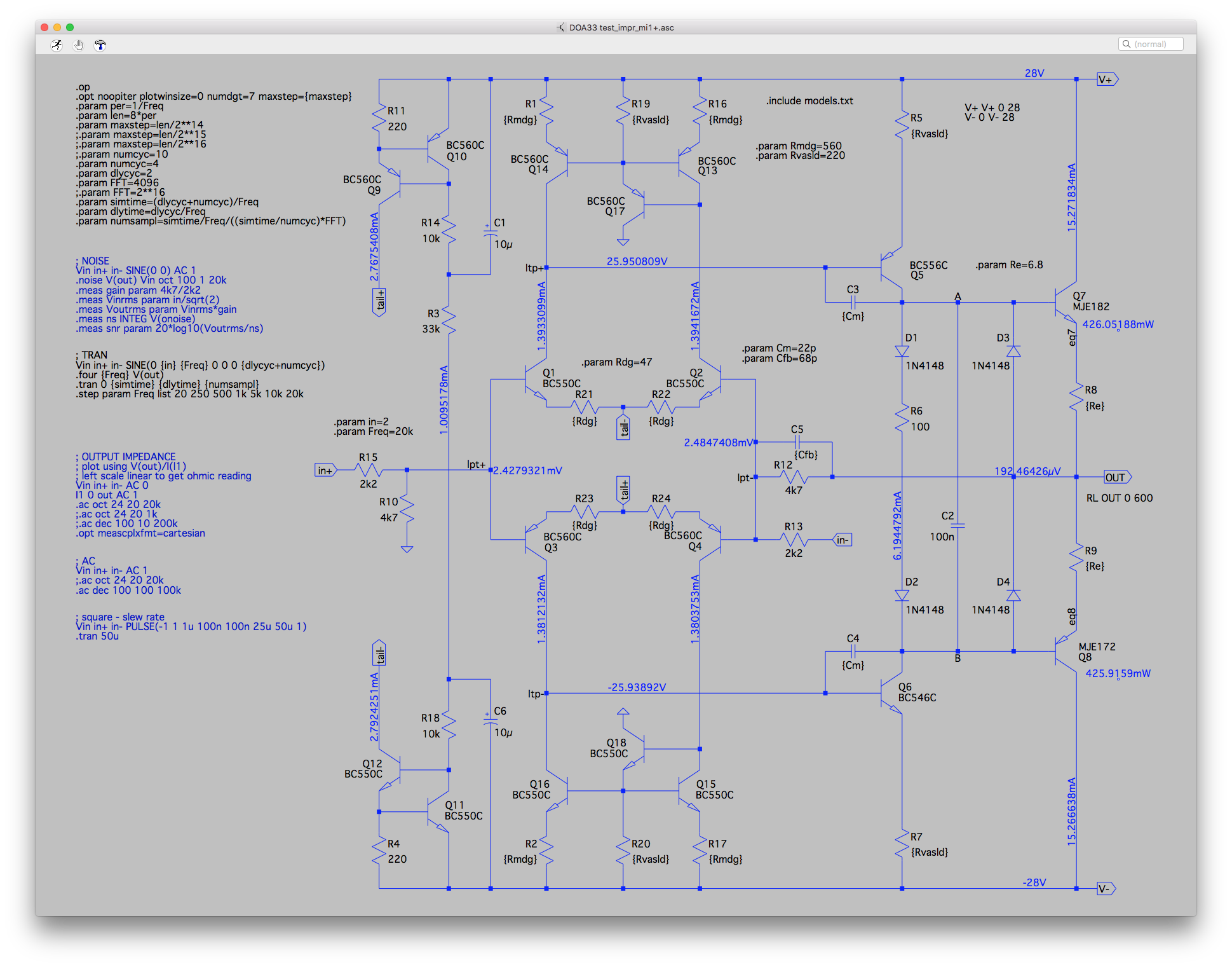

Here's an example of the doa with some slight improvements.
Done @20kHz on 1k5 load.
All trannies are BC550/560 except for the MJE outputs.
Current sources, dual trannies, plus the degen res on the ltp.
With the bias as it is, it has a good class-A region. Most of the time it will work as class-A.
Reflected in the thd figures..

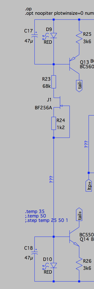

Here's one of the possible improvements for the current sources.
I think I'd favor the dual trannies for the sources instead of diodes or led, but adding a fet between the 2 helps a bit. Better than the plain resistor or grounding each one separately with res..

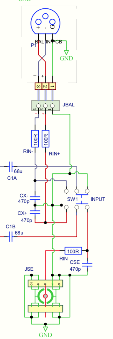

Balanced inputs are nice if the signal source is a bit far from the amps or the cabling snakes around many others along the way..

Spookydd I guess JSE means Jack Single Ended, and yes its the symbol for a phono socket. I agree its a weird symbol, maybe all the earths indicate the lugs that are soldered to the pcb for mechanical strength. Didn't read carefully enough before questioning the distortion just before the onset of clipping ( duh! ). Amplitude good to hear about the sound of the Bryston 4Bsst clone. I look forward to your new distortion spectra. No comments on the Self scheme for a single current mirror?
