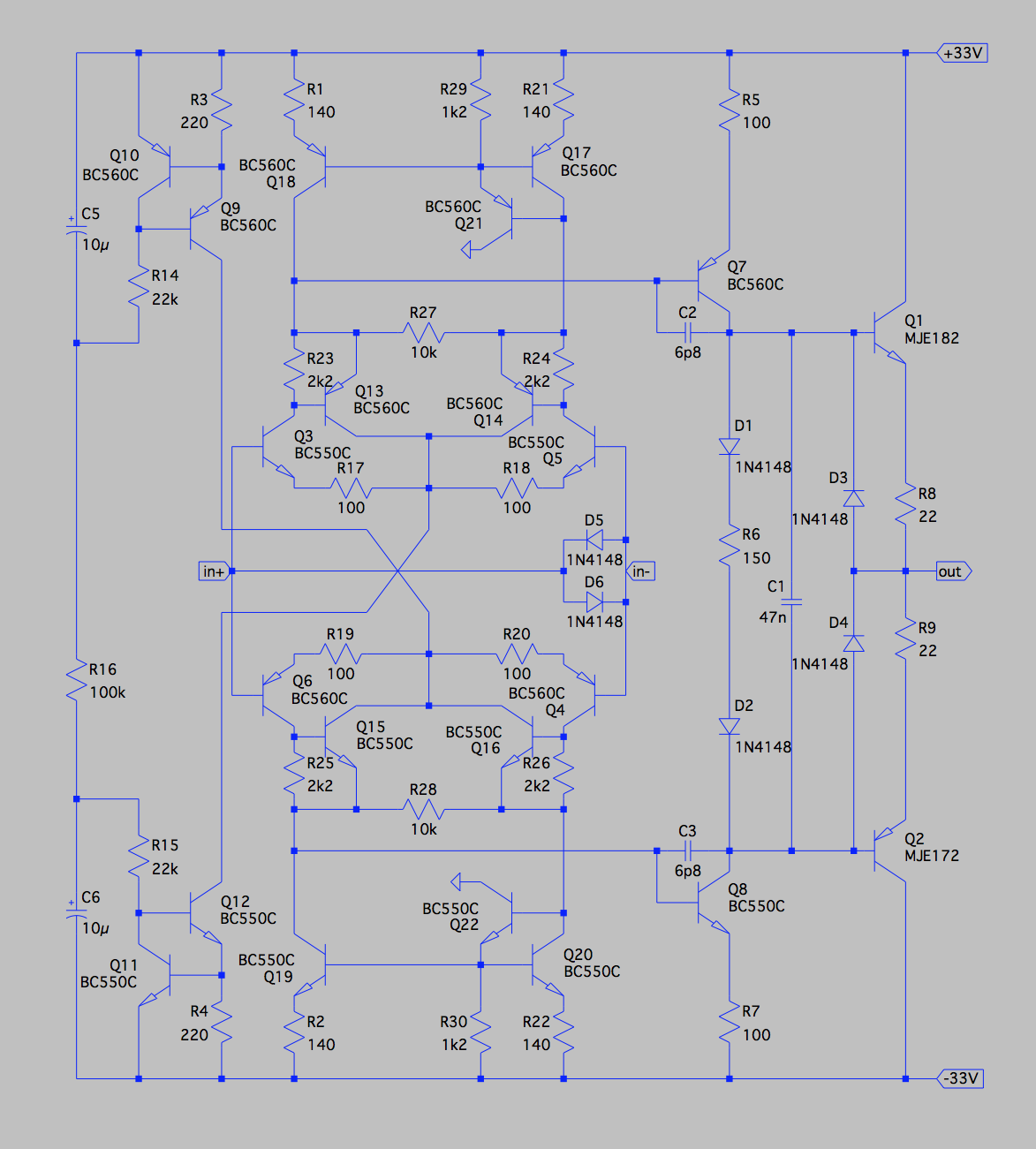

I'm pretty close to having a 28b bridge clone simulation to work. However I'm having an issue that I haven't been able to solve yet.
I made an improved version of the power amp part, with much less distortion and works nicely, which when used in a full bridge config with the original DOA68 as is, works very well.
However, I made an improved DOA68, which works extremely nicely on its own, but when 2 of them are coupled together as with the original DOA68 to get the 2 opposed signals to drive the amps, that improved DOA68 oscillates, only when both are connected to the input signal. They do work quite fine independently, if they're not both connected to the input signal.
Very weird and I have yet to find what the problem is.
Once I get this solved, I'll have the base to start a pcb layout for a cloned 28B "improved".

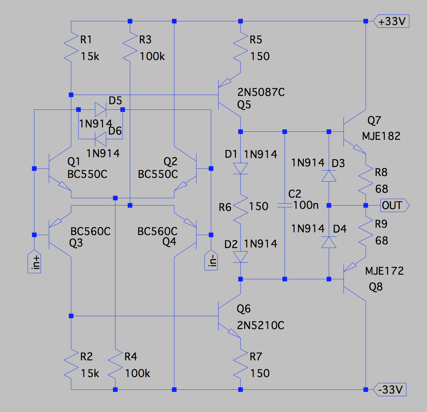

For info, the improvements that worked for the DOA68, that actually improved performance, besides adding current sources on the ltps, are cfp for the ltp, current mirrors with the helper tranny plus that Cordell suggested extra res to make it work reliably. Other than that, only value adjustments were made to make it work properly.
The improvement done on thd is pretty big, with less than .2ppm left at 20khz on a 1k5 load, gain of 2 (6db) and 12Vpeak output signal. Plenty to drive the power amps fully.

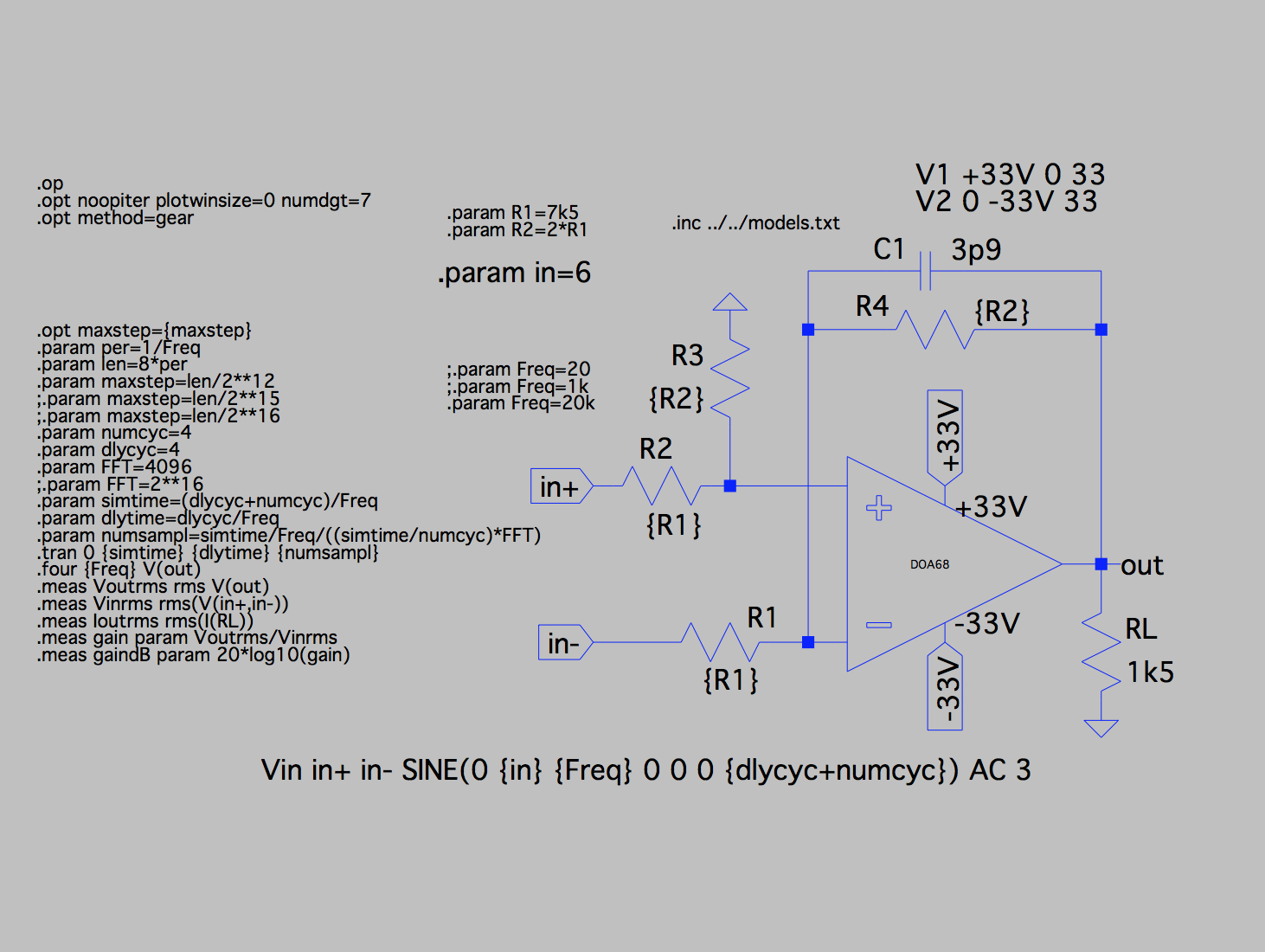

To illustrate, here are the 2 versions of the DOA and a quick test rig to check that out individually.
This tests only one at a time, and I have an other rig to test 2 of them, and that's where trouble starts.

I've tried various possible improvements, and although many do work fine, most don't bring any real improvements, nothing that warrants using them. And actually some improvements aren't improvements at all and actually make it worse.
I thought using led based current sources wouldn't change things too much, not really improving thd performance but would provide a more thermally stable concept, but it turns out this makes thd worse, so not so good for the DOA. Works fine for the power amp's input stage though, go figure!
Cascoding the ltp is worse, either with or without current mirror loads, so that's out.
Enhanced vas doesn't help. It doesn't make it worse, just brings nothing except increasing the part count.
I even tried doubling the outputs, but that too only increases part count without bringing real improvement.
An extra FET current source between the current source tails also makes it worse instead of improving, and curiously this works better on the power amp's input stage as well. Puzzling...

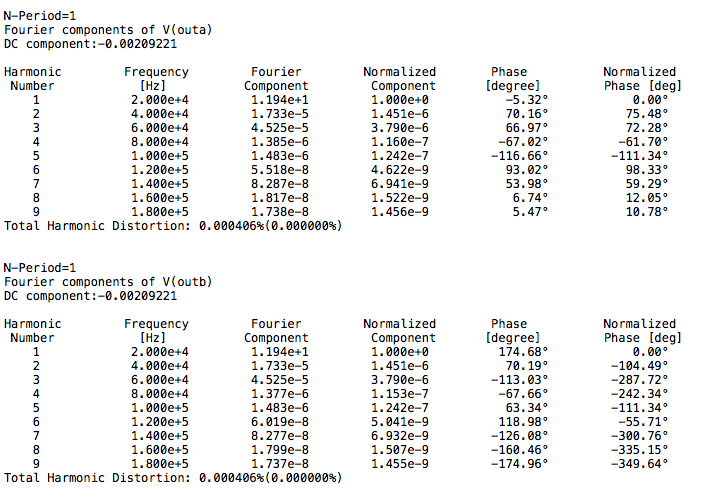

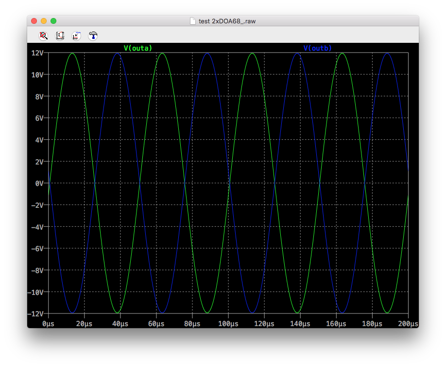

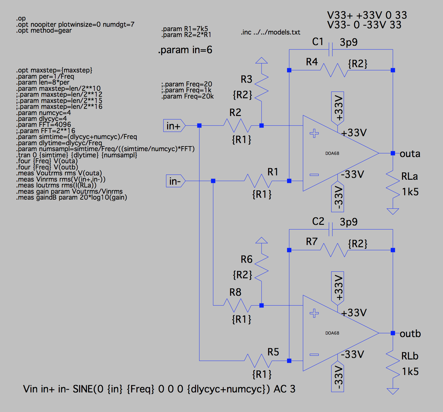

Here is the test rig used to test 2 DOA sub-circuits together.
This works perfectly if the DOA is the plain original DOA68, which uses 20k/40k resistors to set the gains, and the compensation cap on the feedback is 22p instead of 3p9.
The thd with that gain set up of 2 (6db) and a 6V input signal at 20khz, the load resistors 1k5 for all configs, is a little over 4ppm on one output, and the 2 signals are properly in opposition.
But when using that improved DOA68, with the cfp/degen/mirrors and all that, with the comp cap on feedback of 3p9, oscillations are present when both are connected to the input signal. That stops when either one is used and the other disabled/disconnected from the input.
And this happens no matter which resistance values are used to set the gain, always for a gain of 2.
A mystery I haven't been able to solve yet. Increasing the compensation cap value doesn't help stopping this.
If anyone has any suggestions, I'm all ears.
Bit of mental arithmetic gives me a vas current of about 2.5mA and an output stage of 10mA - about right?
Could also try adding a third module to make a classic instrumentation amp. Haven't figured it out yet but I have a sense that you've got cross coupling which leads to positive feedback with the new higher olg module.
Omit R2 and R8?
Can't work that way. Those are opamps after all, they do need their resistors to set their gain.
It works fine with the original DOA, and that's how they use it too.
On the improved DOA, that's about right, more or less. In the ballpark.
It's closer to 2.7mA tail currents, and not too far from 15mA in the outputs.
But how would you explain it does work right with the original DOA?
It's how it's used in the actual amps, except they insert in 3k48 in the DOA's positive input. I removed it in the test rig, but it makes no difference with or without, with the original working fine and the improved goes into systematic oscillation. The improved DOA works great on its own.
Here is a test rig that has the 3k48 resistor in the DOA's positive input, as they have it in their amps.
This is using the original DOA, as posted earlier as a sub-circuit.
And this is using the same res values as used in their amps, the 20K and 2 x 20K to set gain, plus that 3k48, for which I would really like to know what its use is...
It does work the same without that 3k48 res anyway. No oscillations or whatever.
I load the DOA's the same, with 1k5, give them the same input signal of 6V (peak) and the res ratios give the 2x gain (6db). Those plots are at 20khz.
The improved DOA under those conditions, individually, has less than .2ppm thd.
