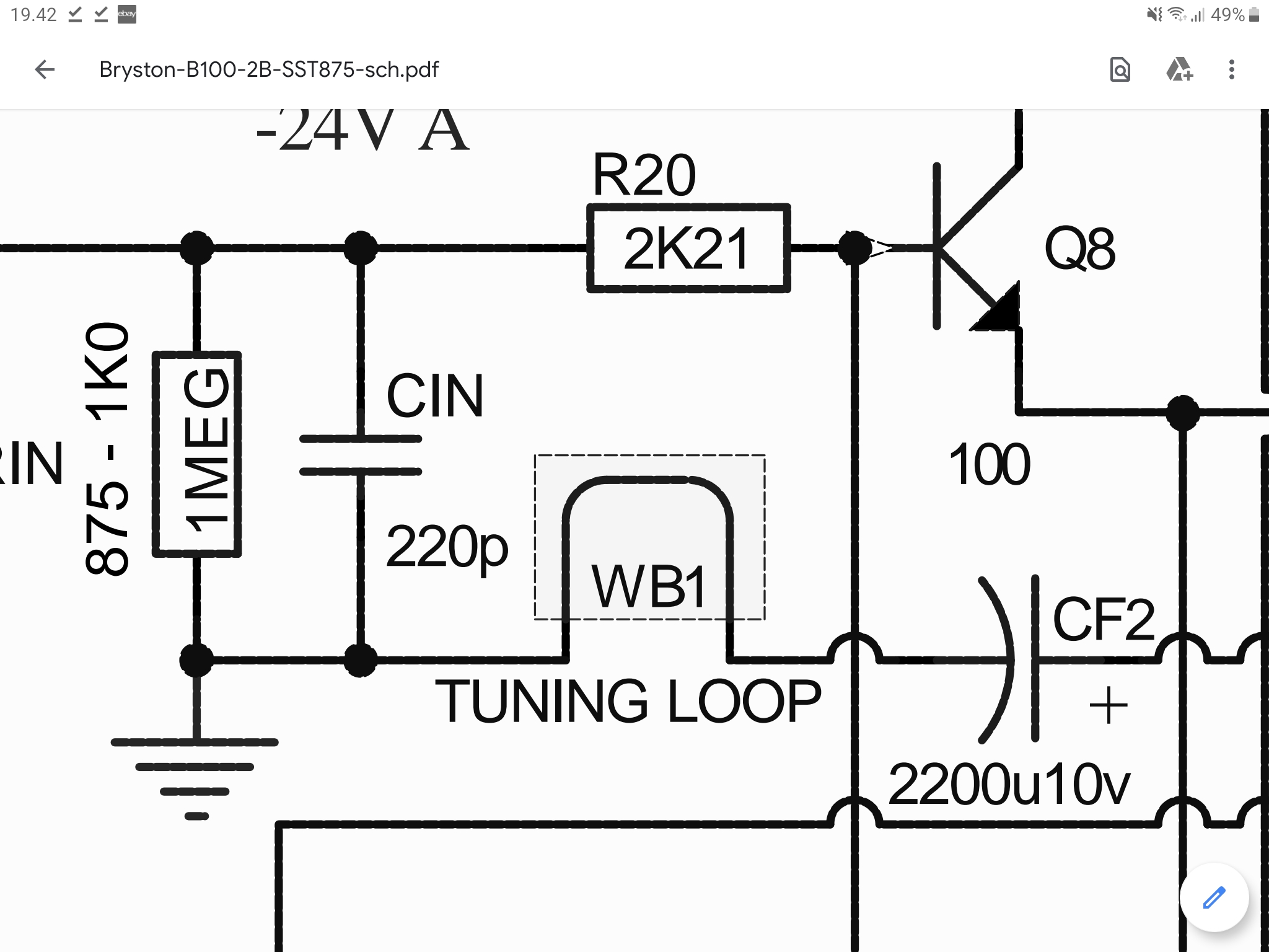

I've never seen that amp model, must be an old one. I'd be curious to see the whole schematic, and compare with what they're doing now, or at least their previous versions, since so far they're not sharing their newest stuff. I have yet to see any schematic for any cubed amps...
But this is interesting and it would be nice to know what's behind that thing. I'm guessing it would be some air core coil, somewhat similar to what's used on the output, but what's the real purpose and what does it do?
The circuit works fine without it, so I'm wondering what this extra thing brings to it.
Looks like you're right. I looked at other schematics and found the 2.5B model has that as well, explicitly mentioned a a tuning loop. I had never noticed this before, and never looked at the smaller 2.5B model, or I would've noticed.
So this is something to know more about.

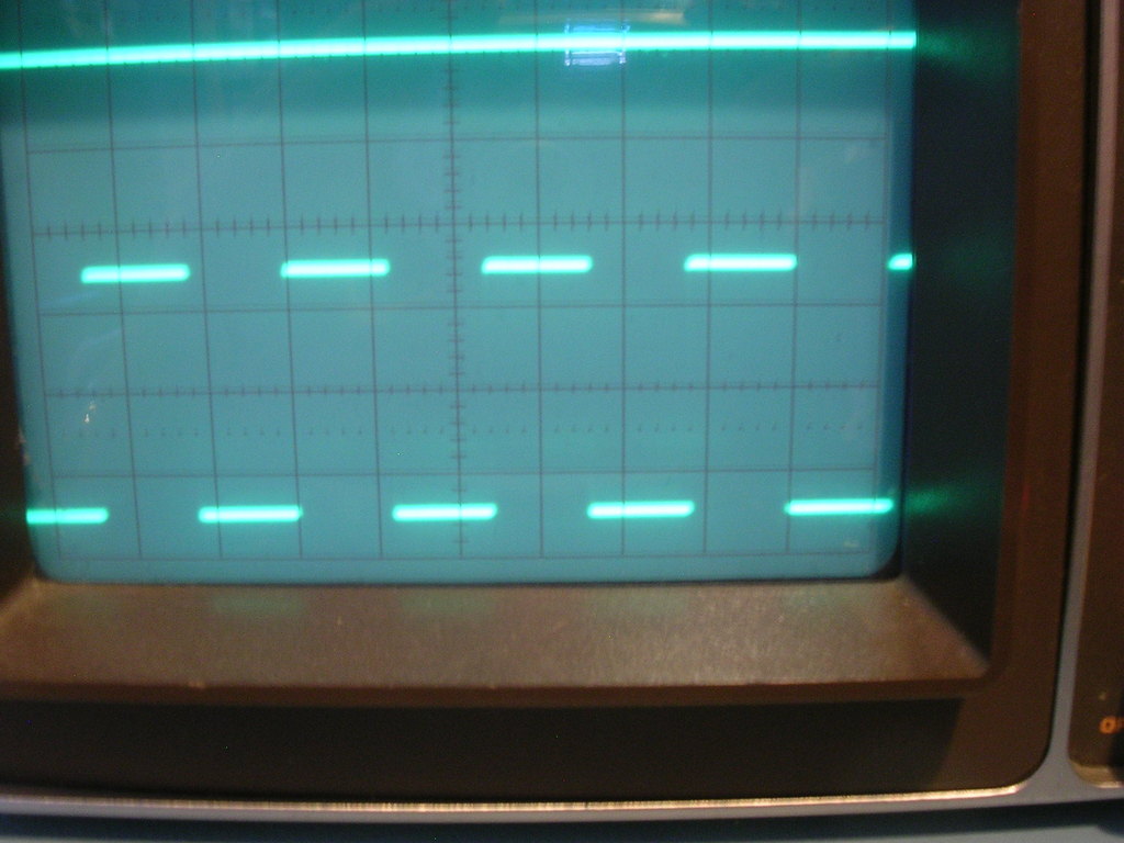

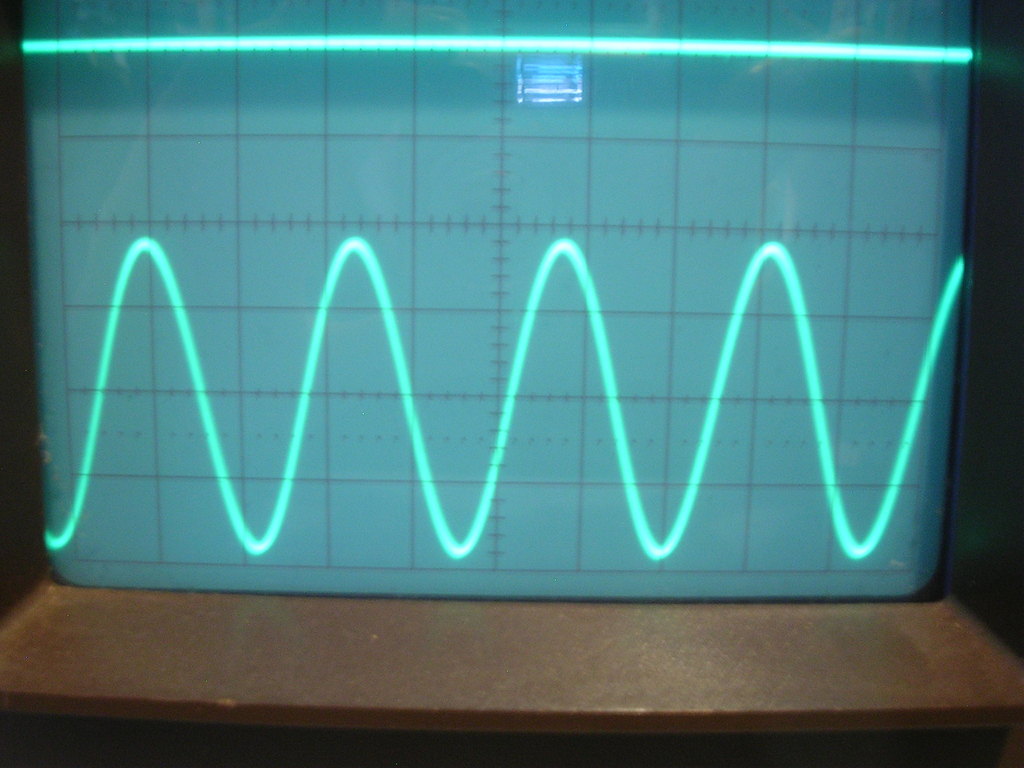

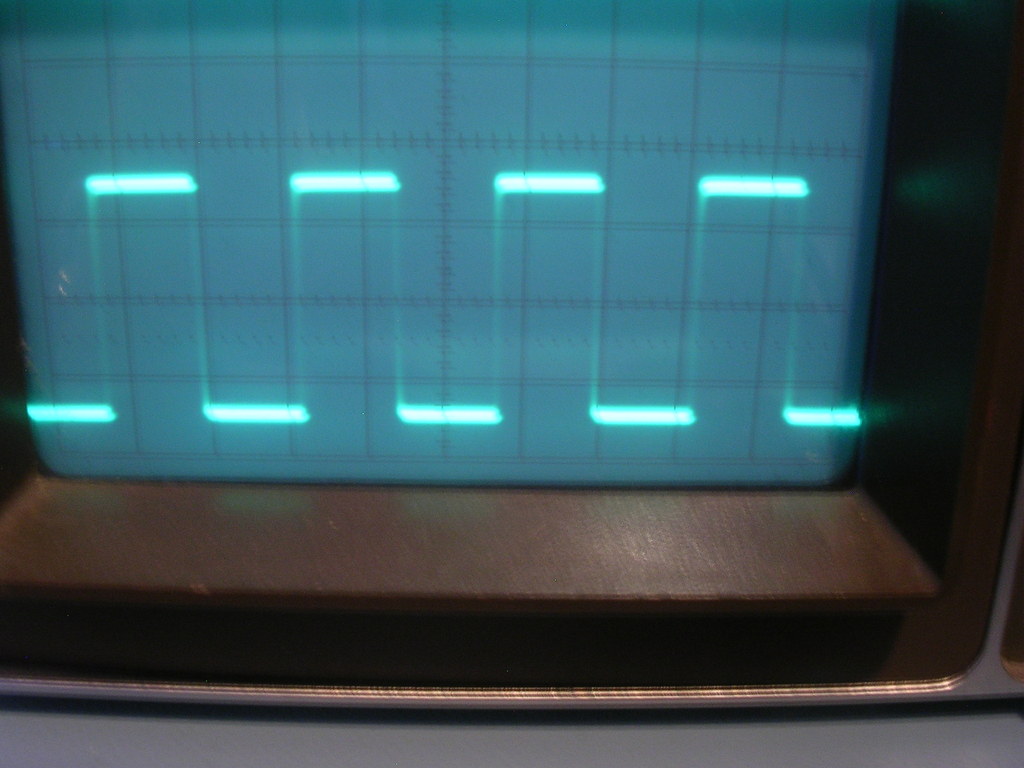

Ok here are the photos, complete with a bit of hand shake blurring. They are respectively the prototype, a 1kHz sine wave, a 1kHz square wave, and a 10kHz square wave. As you can see the square waves are nice and clean with no sign of ringing. All voltages and currents as predicted and no oscillation. Result! I'll post the schematic when I'm a bit closer to something I want to commit to a pcb, in particular I really want to give the stability checking a hammering and fix it so that the circuit clips nice and softly.
You're on the right path, looking good...Just noticed that you can barely see the rising and falling edges of the square wave at 1kHz but they're clearly visible at 10kHz. Possibly a tiny bit of rounding at the bottom of the 10kHz falling edges too.

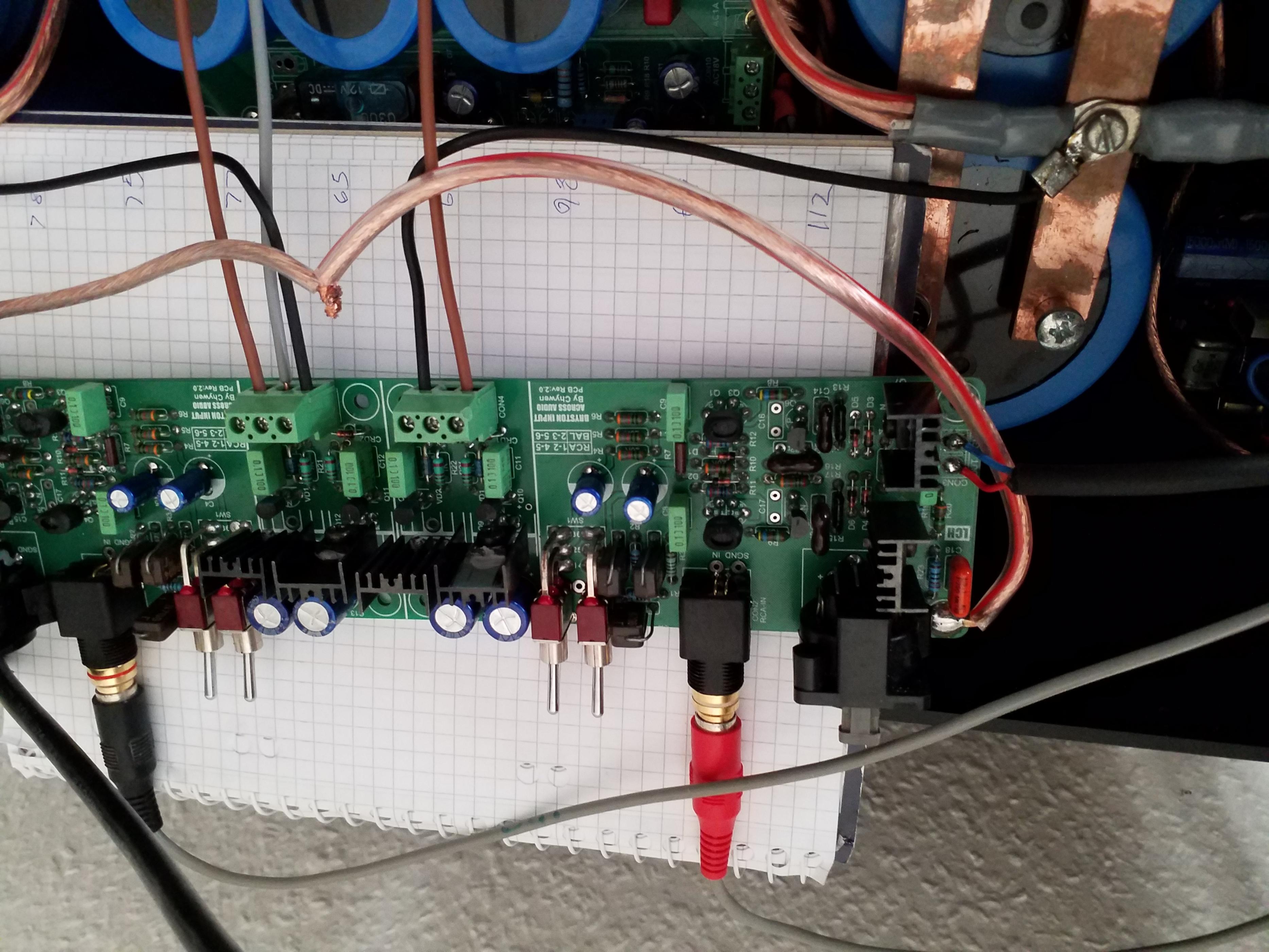

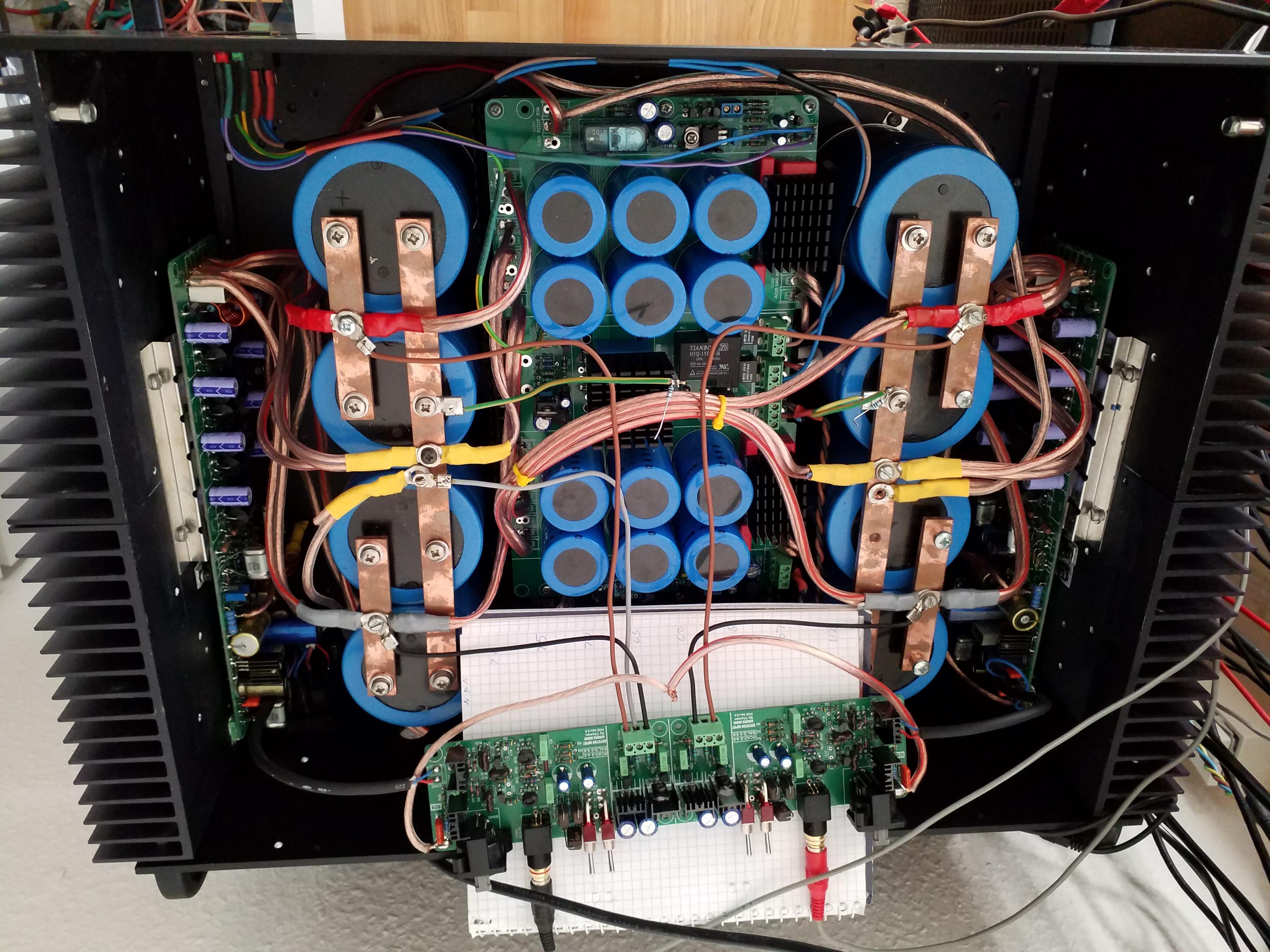

I had removed input board from the 4bsst to try other options, today I put it in place again, powered up and am now getting a really annoying 50hz hum, I tried isolate input board from chassis, no change, both RCA out, it's dead quiet, only left or right it plays as it should, so I must have a ground loop in input, I have dual transformers and have joined their ground, taking both grounds up to external sound cards RCA connector reduces the noise, but not totally, what have I done wrong, I'm sure the answer is simple, but to confused to think straight.
It's a working process, so it's a mess right now, but I succeeded in finding the ground loop, the culprit was the connector between the two ground busbars, flux ressidues made a bad connectionIs this with that clone or a real bryston amp?
So that's the clone, not the genuine bryston then.
Did you include ground isolators? DC blocker for the mains?
Where is(are) the transformer(s)?

There's no DC blocker in it, ac here is stabil and clean, the two toroids are hiding under speaker protection 2.4kw in totalSo that's the clone, not the genuine bryston then.

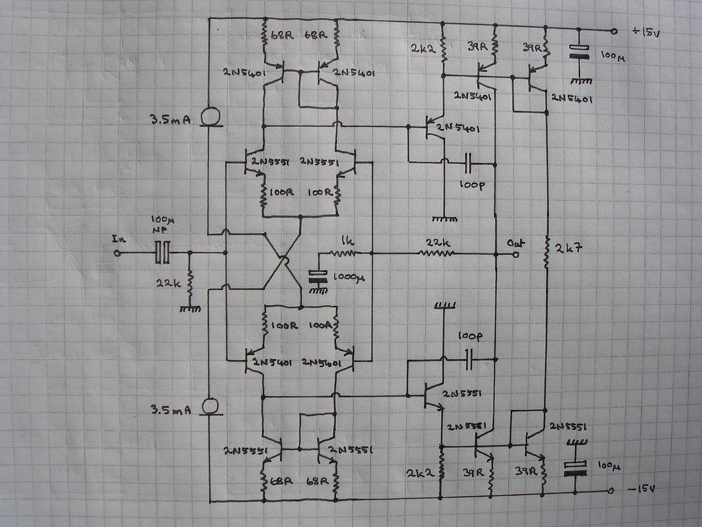

Spookydd I don't understand what you mean. In my circuit both vas transistors are parts of current mirrors and the vas current is set to a rock solid 10mA by the 2.7k resistor feeding the other sides of the current mirrors. Side benefit is that the vas is current limited.
Keep noticing things to improve. The balanced to single ended conversion at the input amp in both the Bryston and the clone is very simple and results in different input impedances on the + and - outputs, as well as poor common mode rejection. In practice I doubt that this effects the distortion or the sound quality. But if we're nitpicking and talking about good engineering practiice - weeelll. I think I'll use a THAT1206 for this job on my input board design.
That's just something we've been discussing lately, with current mirror fed vas, the vas base floats on the ltp, and we've been talking about adding a resistor across the ltp legs to force this, as prescribed by Cordell.
But I'm not familiar with that kind of topology as you described, and at the moment I don't know if it does solve that issue of undefined bias for the vas bases. Maybe it does, and perhaps you could elaborate on this, so the noobs (like me) can better understand how it works.
One thing I was wondering though, is why only 15V rails? With all discrete parts, there is no good reason not to go for much higher rails.
I see the fairly substantial tail currents and a fair amount of degen, should provide for some good slew rate...
Using those 2N5xxx may not be as low noise as with the BC5xx types though.
