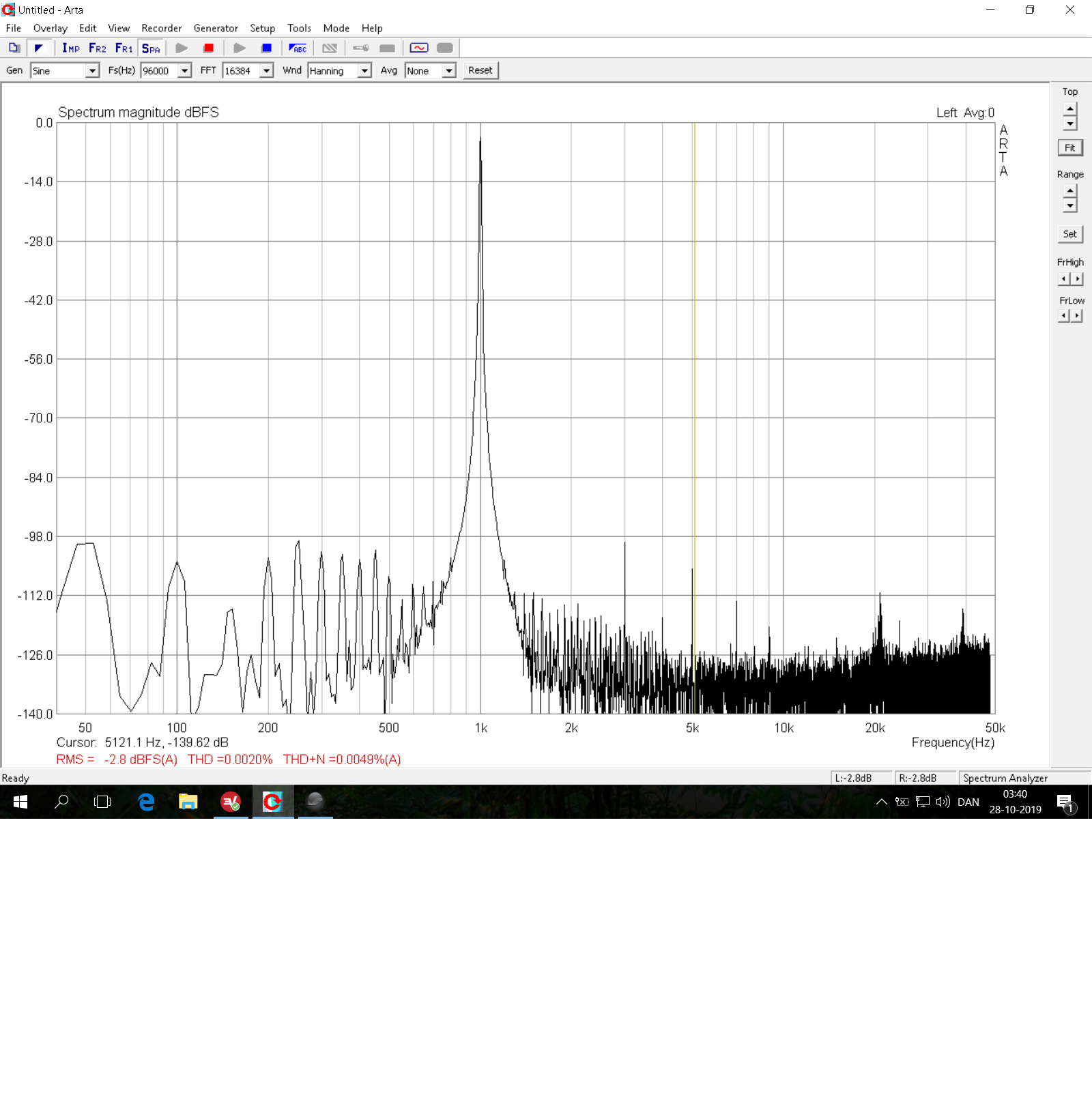

Chalky I have done some work on the bryston amp, I have raised the bias as we talked about, and noise looks better i think, but what's really bugging me is that bad noise figures from 20 to 500 hz, I tried better trafo shielding, twisted wires, shielded signal wire grounded in one end , but I can reduce noice with any of those approaches, maybe you have an idea I haven't tried.
The attached photo is 5.75 volt rms into 8 0hm load.
Amp is now idling at 160 watts in total.

First off is the noise real and not an artefact of the fft? If its real you need to find out where its coming from - the grounding scheme, the input stages, the power stages, or the the power supplies. What about the parallel R and C from signal ground to chassis on the pcbs. Are these in or out? If they are all in you may have made ground loops.
Well I investigated some more today, and you're right, most of the 20 to 500 hz is not from amp, I need some better shielded cable around audio input and the attenuator box, tried touching the 68 of Miller cap, and that immediately lowered noise all over, the Miller cap is a vintage Russian, big and bulky, so couldn't mount it on pcb but on extended legs, think I will have to buy some who fit pcb footprint, in order to get lower noise.
