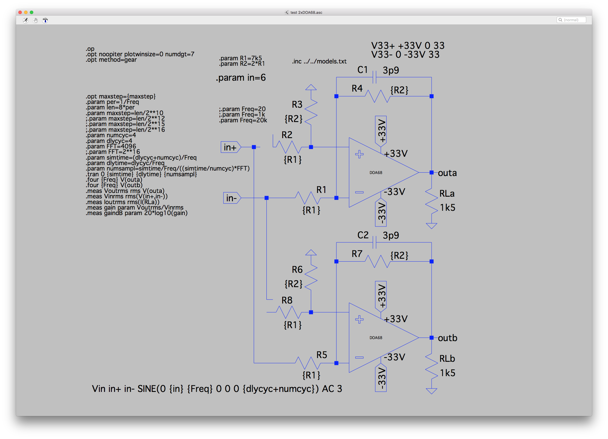

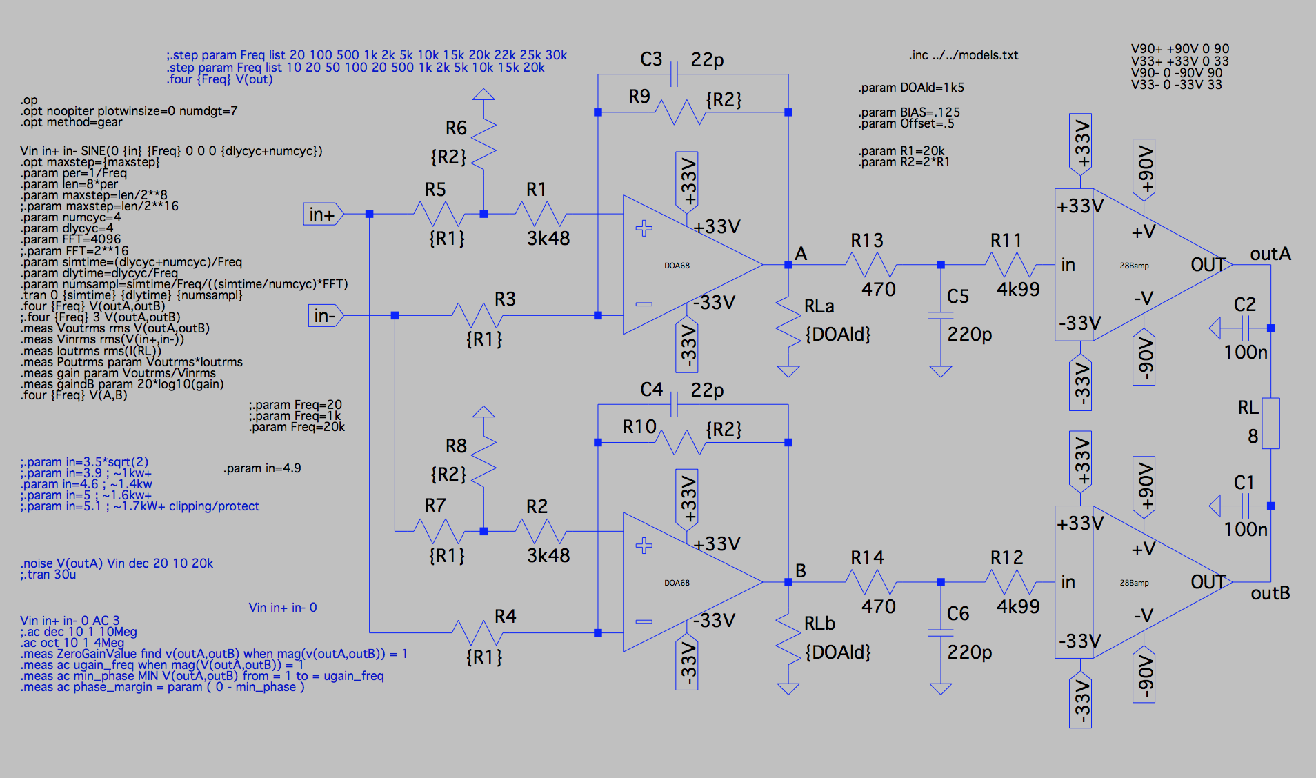

What I mean is have a differential input buffer with a single ended output which drives the tied inputs two further amplifier modules, one with a gain of +1, and the other with a gain of -1. The latter two amplifier modules have single ended inputs and outputs.
Yes, that's how many bridges do it.
It's not what bryston does. And it's actually quite symmetric this way with the balanced inputs going to both but in opposite direction.
There is no reason why this wouldn't work, and it does work great with the original DOA and hooked up just like it is in the 28B amp.
The problem is when using the improved DOA. That's a bummer.
Surely if you omit R2 and R8 you've simply got an inverting amplifier on each of the in+ and in- lines.

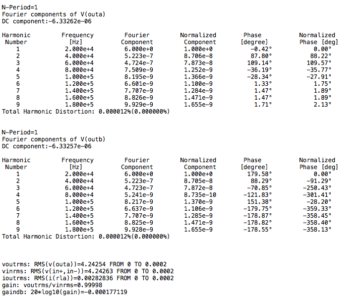

Here is a test of the improved DOA which is basically identical to that sub-circuit I made, especially since I used this rig as the base to put out the sub-circuit.
Works fine, on its own.

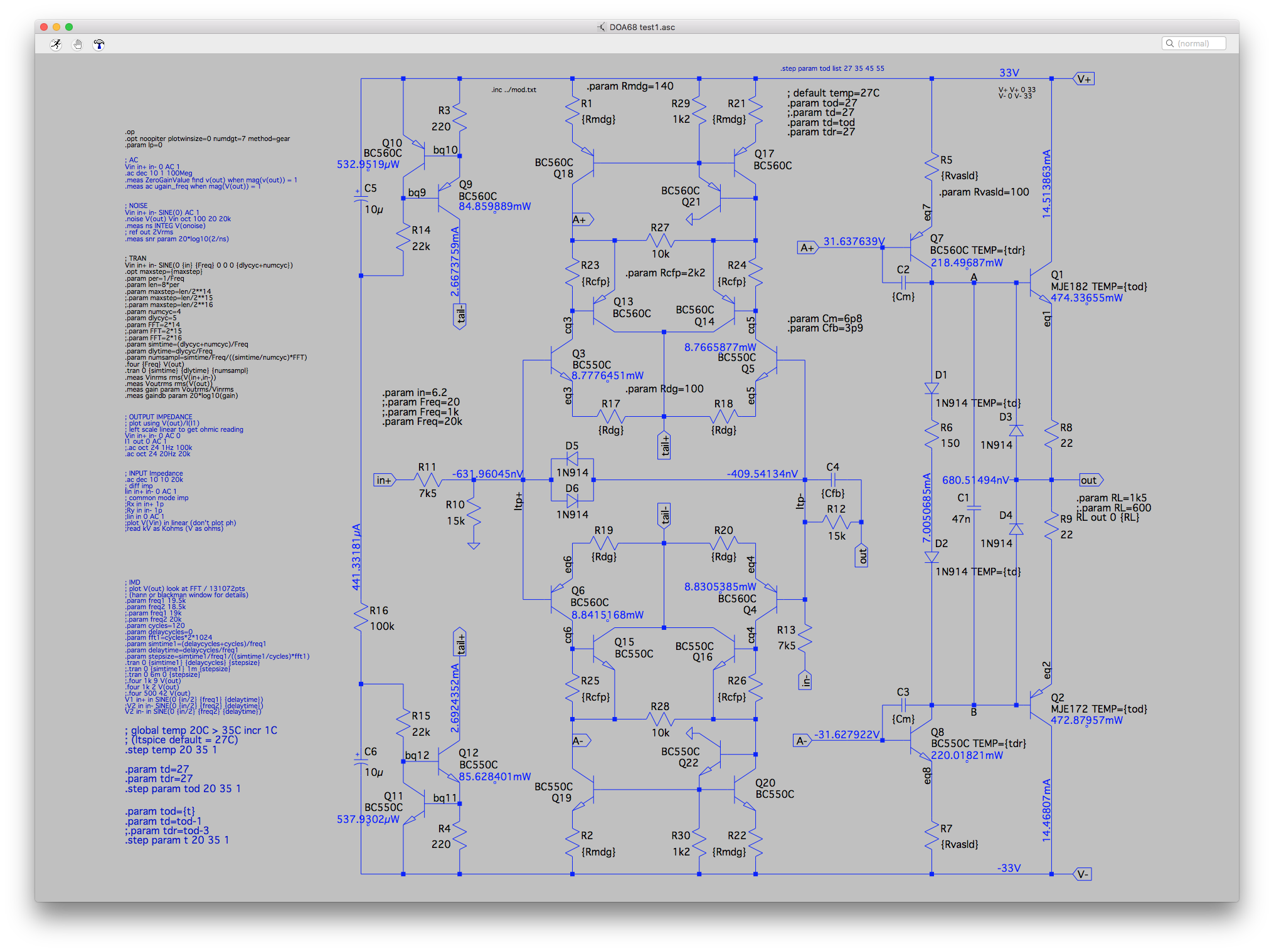

This improved DOA, has the "richer" tail currents from the ccs, for more slew rate... And rather hefty biasing in the vas and outputs, for a full class A regime, for nearly all of the output range, even under 600ohms load. It should hardly, if ever, get out of class A.

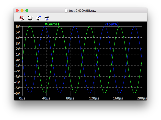

Sure, with no gain. And this does works (attached). But we need gain. The amps' gain is quite low and we need some in the front end to be able to drive those amps fully with a reasonable input signal strength.
As you can see, it's fine that way, no oscillations whatsoever.
What happens if you use 20k and 40k resistors a la Bryston?
Tried that, of course, with the bigger feedback cap 22p, in an attempt to curb that oscillation. But no change. The gain is the same anyway. I also tried with a bigger miller cap in the DOA, just in case, but no luck there either.
It's odd that it works quite fine with the original DOA, and it's wired just like bryston does it. I wonder what enhancements in the DOA could make this more prone to that issue.

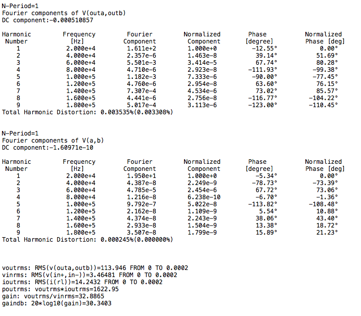

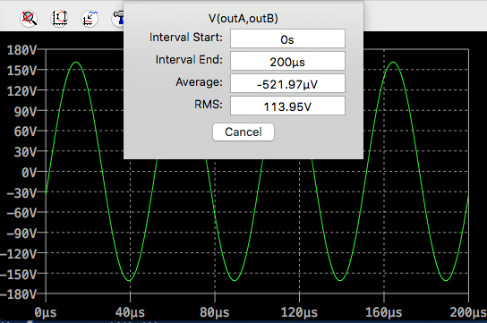

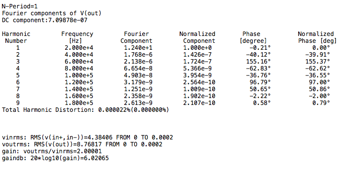

Screenshots attached, of the original bridge without any of the improvements, and only slightly altered in the interconnections.
This is at full power, slightly before onset of clipping, @20khz/8ohms. We get a little over 1.6kW with a 4.9V peak input drive signal, balanced.
I used the same gain setting resistors as the original, no input filters, and all the supplies are joined, and it works perfectly this way.

Did you try reducing the value of R27 and R28 from 10k to say 4.7k and/or increasing the value of the input and current mirror degeneration resistors? This will knock off some olg and may contribute to stability.
I didn't try going lower than 10k for those resistors (R27/28), I started from 100k and went down from there, but didn't want to drop them too low. It does bring a bit of extra thd, so I wanted to keep that to a minimum, or there is no point in adding the improvement, if it doesn't bring anything.
I did try a wide range of degen, but too much was really adding a lot to the thd, so I made a compromise that seem to work and didn't bring down the enhancement too much.

By the way, with the last tweaks done on the amp's gain with the slightly adjusted compensation, I get less than 20ppm thd before onset of clipping, on 4ohms resistive @20khz. No doa used in that simulation. The input signal required to do this, went down to 5.06V peak. This is pretty good, when we have a x2 gain doa ahead of it, this would be much more easily driven to fully power (~1.6kW before onset of clipping).

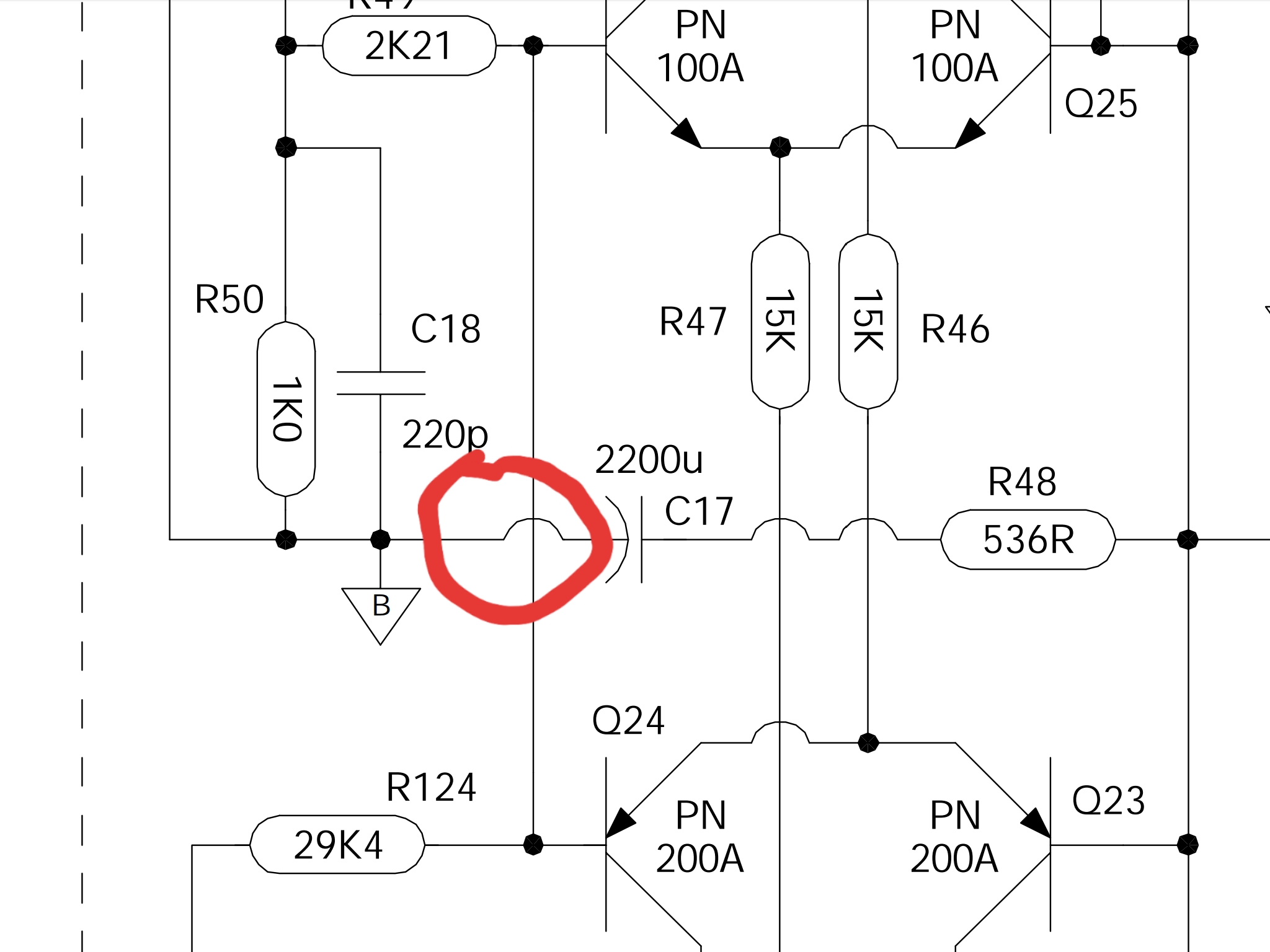

It looks like this in my schematic looping over traces?. Wire jumper..? English is not my best , what's it's name?Would anyone know what that WB1 loop is?
I never knew what that is and never seen this in any schematics anywhere.
I don't even know what that symbol means.
No, that's definitely not something like this.
It's an actual symbol that means something, like some kind of loop/jumper, but not a simple jumper, it seems like something more. But what?
Think I have it,, it's a tuning coil,No, that's definitely not something like this.
