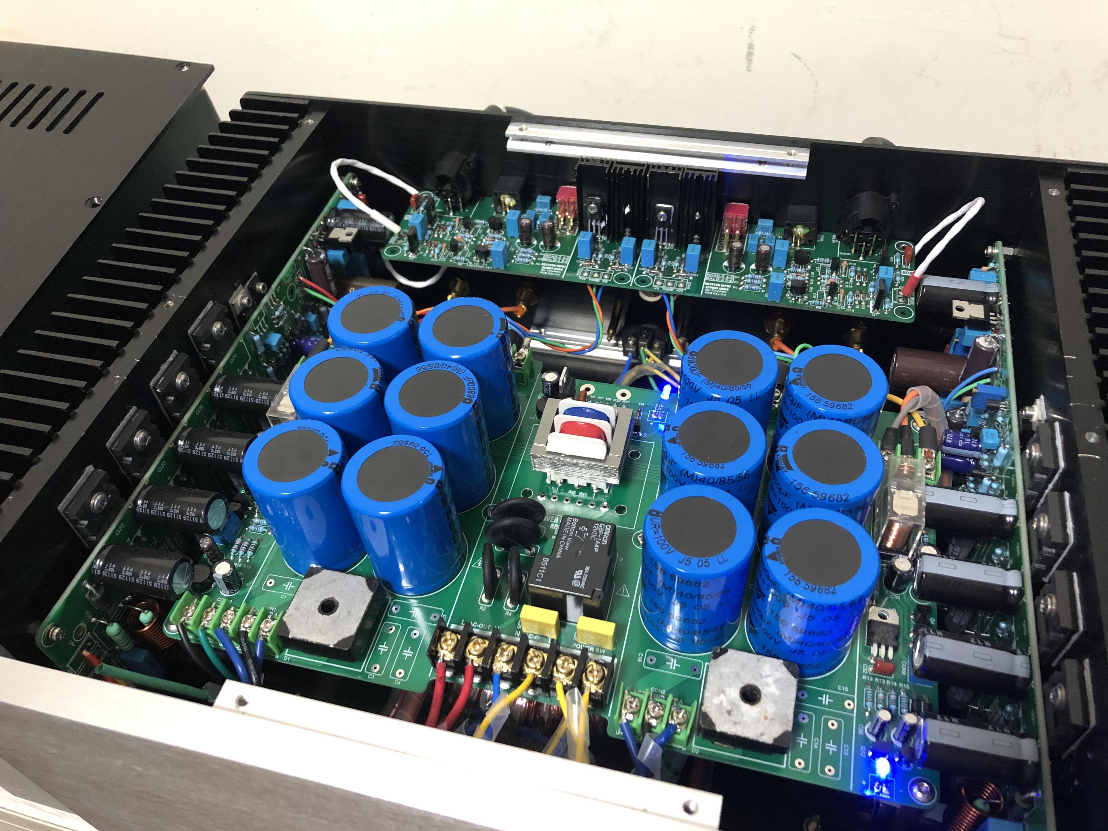

Hard to see solid state relay used in amps, few model of Accuphase amp maybe, I'm willing to take a shot:happy1:, and here is my build: +/-83v,DC couple.

Nice build swing. I'd put some heatsinks on top of the bridge rectifiers if I was you - they run hot if you push the amplifier hard. In answer to an earlier question about +V2 and -V2 these are not 33V rails but lightly filtered versions of the full rail voltages +V1 and -V1. Can't really see any use for them.
Very nice build, congratulations, are you satisfied with audio reproduction?
This machine very sensitive, if you change the electrolytic capacitors even the internal power wire (that I can't explain why), you can feel the differences, I spent months to experiment and adjust, now it sound better, my friend said those electrolytic capacitors beside the power transistors should not be installed(Rubycon ZLH 470uf/100v in my case), it made the 'live feeling' worse, but I still keep it in the place, hard to disassemble :stop:...

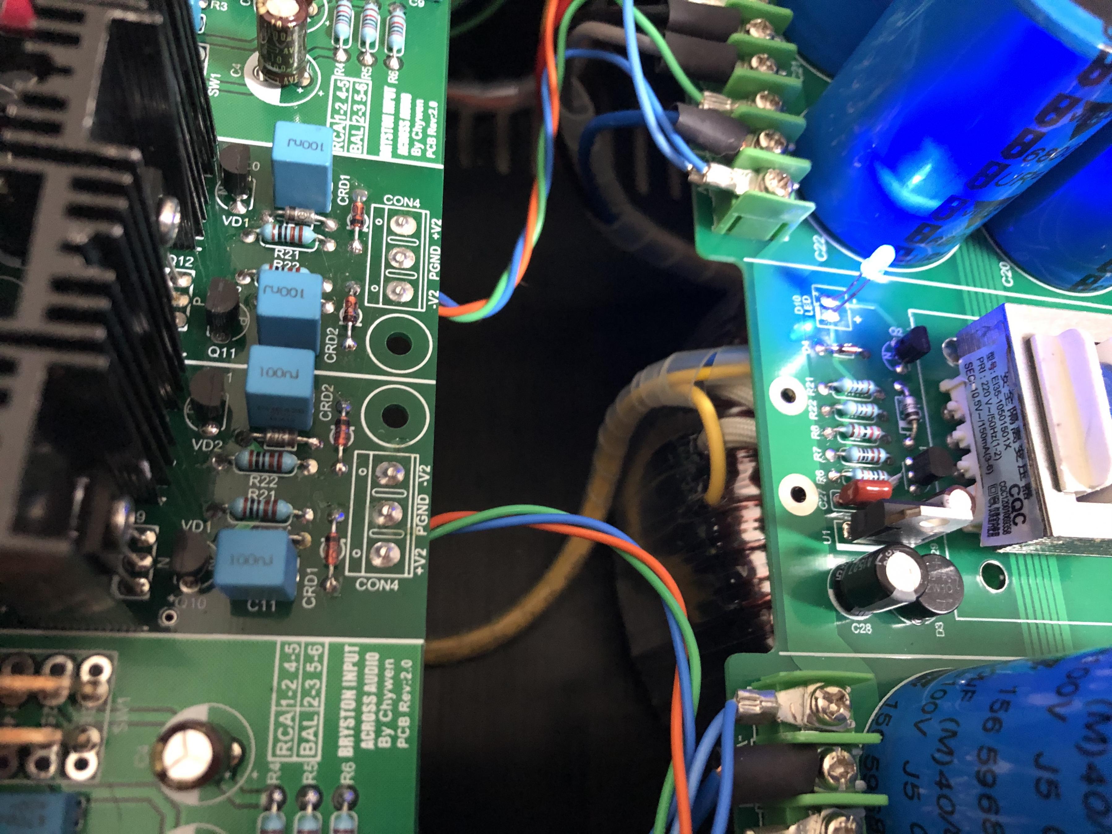

The bridge rectifiers are ok, I put this amp in my reading room, not much chance to turn it loud, but the heatsinks on the power adjust transistors in the input board got very hot, it can go above 80 degrees Celsius in summer, make me nervous, I must find a way to put a bigger heatsink on, the new vesion of clone has improve.
Swing you don't necessarily need bigger heatsinks on the input board. You could put 24-33V 5W, say, zeners in series with the power inputs to the board. This way the zeners would share the dissipation with the pass transistors on the input pcb. The problem arises because of your +/-83V supply voltage which gets dropped to +/-33V by the pass transistors on the input board. That's 50V across each of them with a current draw of around 20mA so the dissipation is approximately 1W into a small heatsink. So the heatsinks get very hot. An alternative to what I suggested above is to fit a larger heatsink underneath the input board and bolt the pass transistors to this with their legs sticking up at right angles into the pcb.

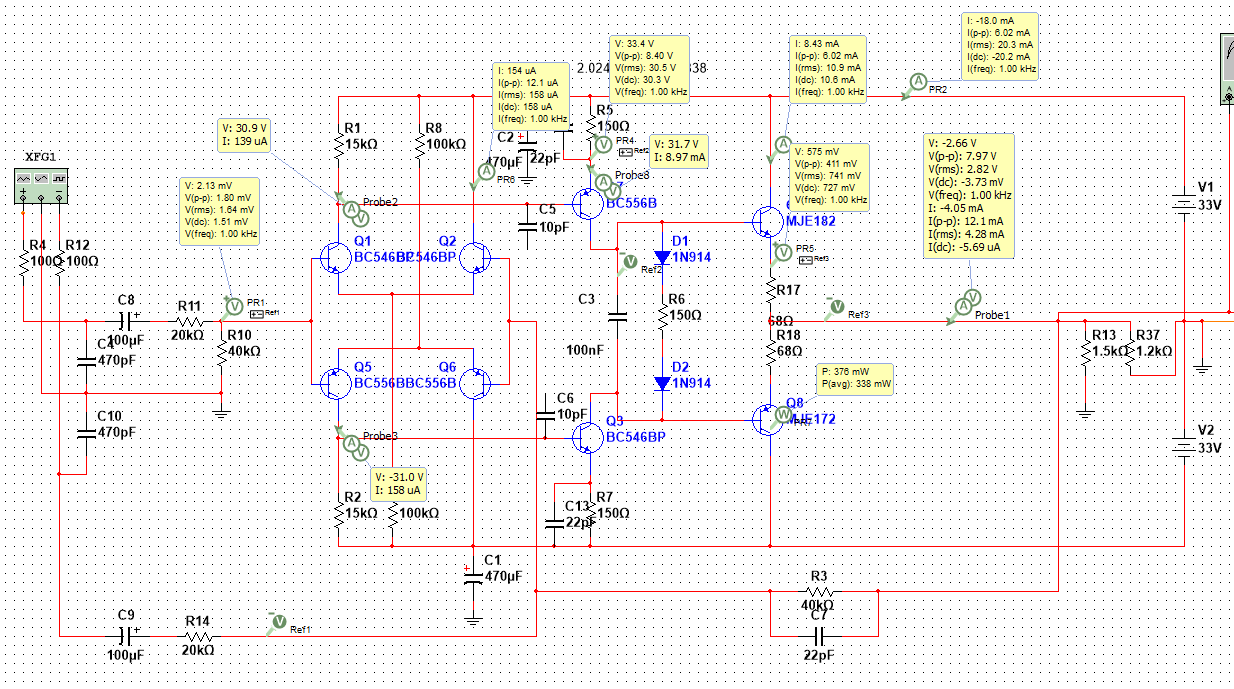

The input to the power amp is a bit odd with the suggested value of 1.2k because it attenuates the input to a third of its original value. If you made R2 4.7k you'd get less attenuation and probably reduce the output offset ( R14=R2+R3 approx. )

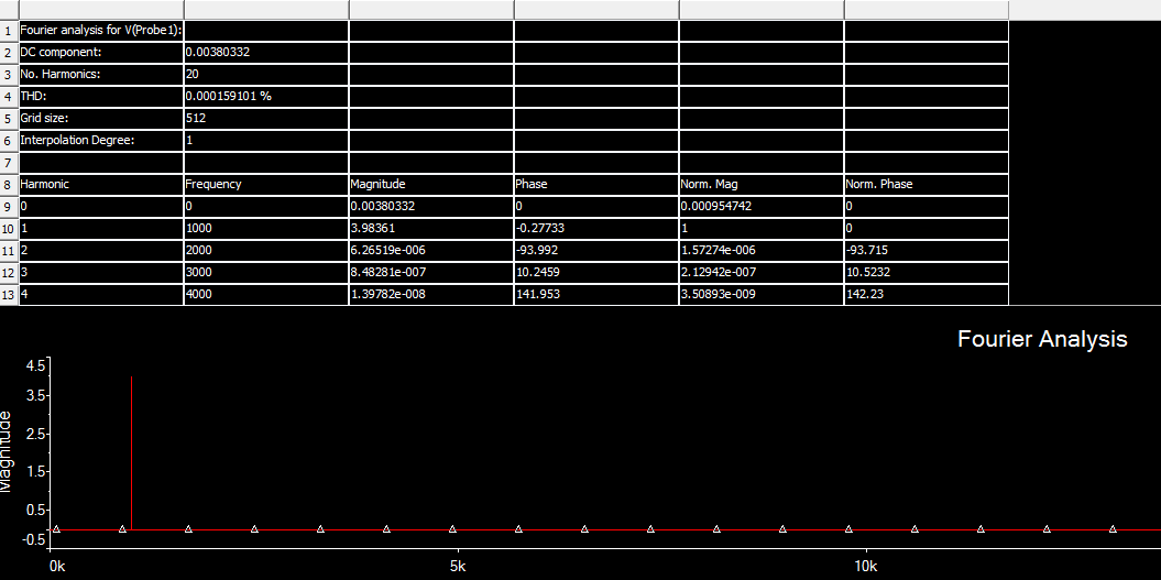

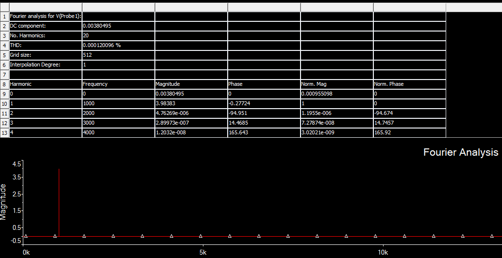

I use DC couple between input board and amp board, now output offset is 0.3mV(L) and 1.3mV(R),mostly cause by zeners tolerance(31V~34V), that is acceptable for me. But the input board R20(1.5K) parallel with the amp board R2(1.2K), definitely a heave load, if change to 10K+10K, THD will slightly improved in simulation, at least the output transistors on the input board still stay in A class when large dynamic comes.
