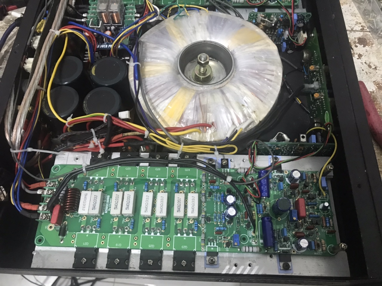

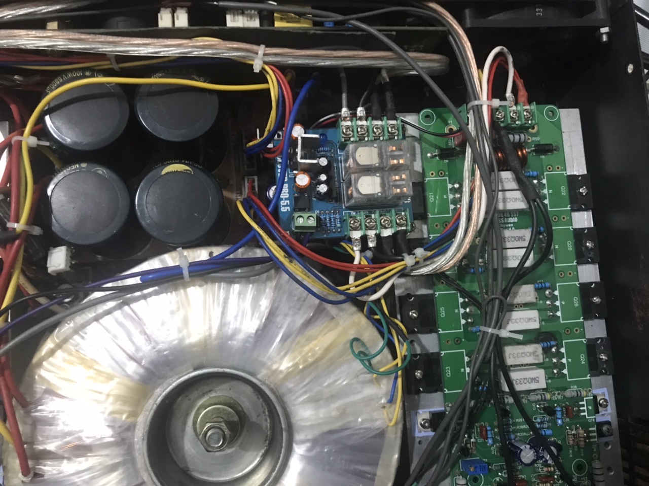

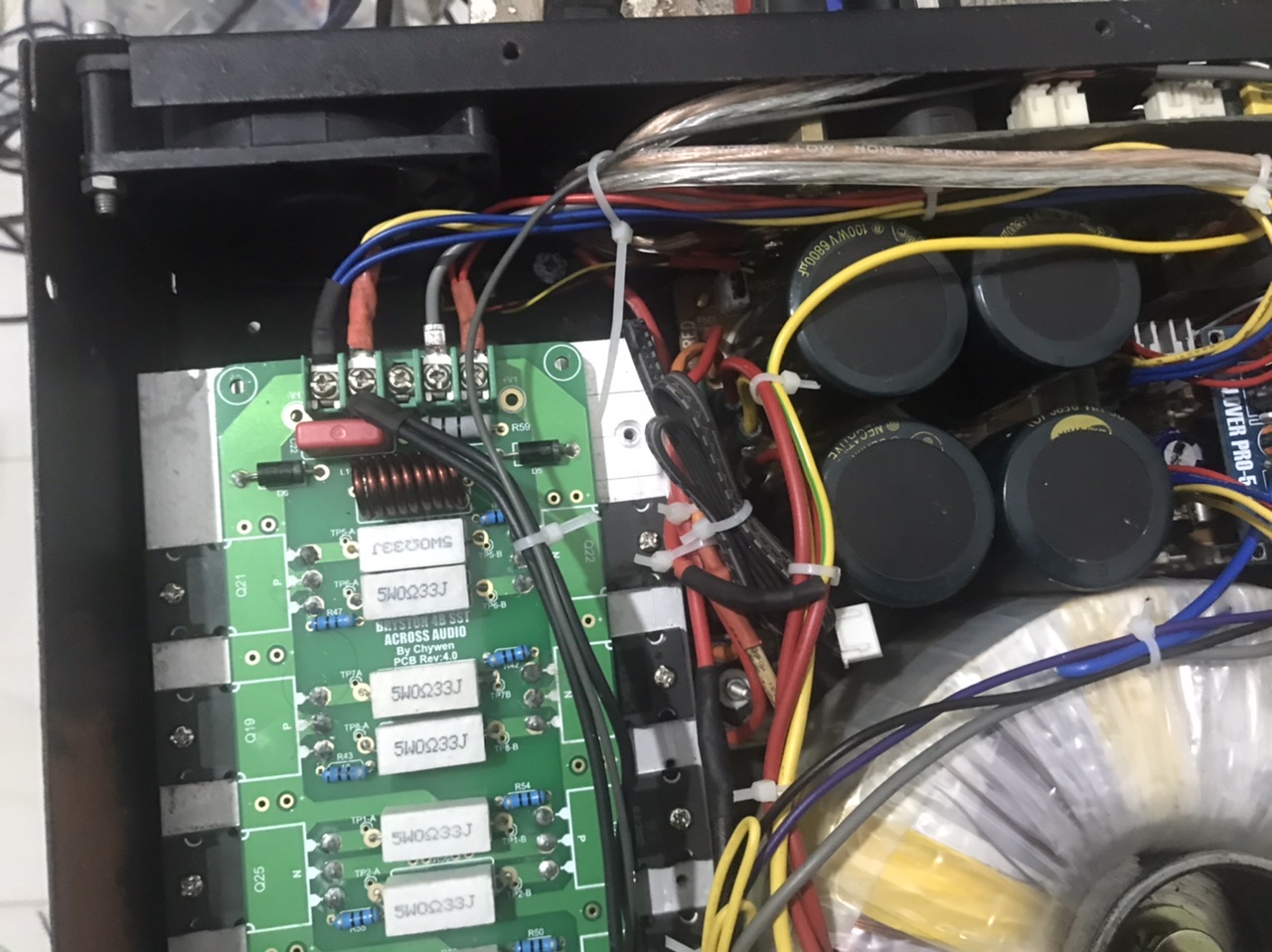

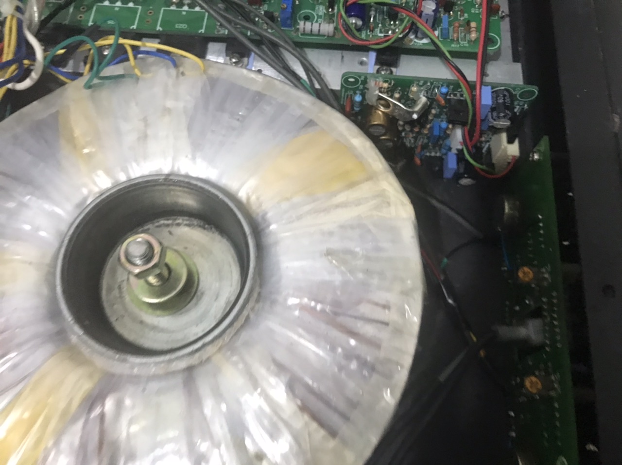

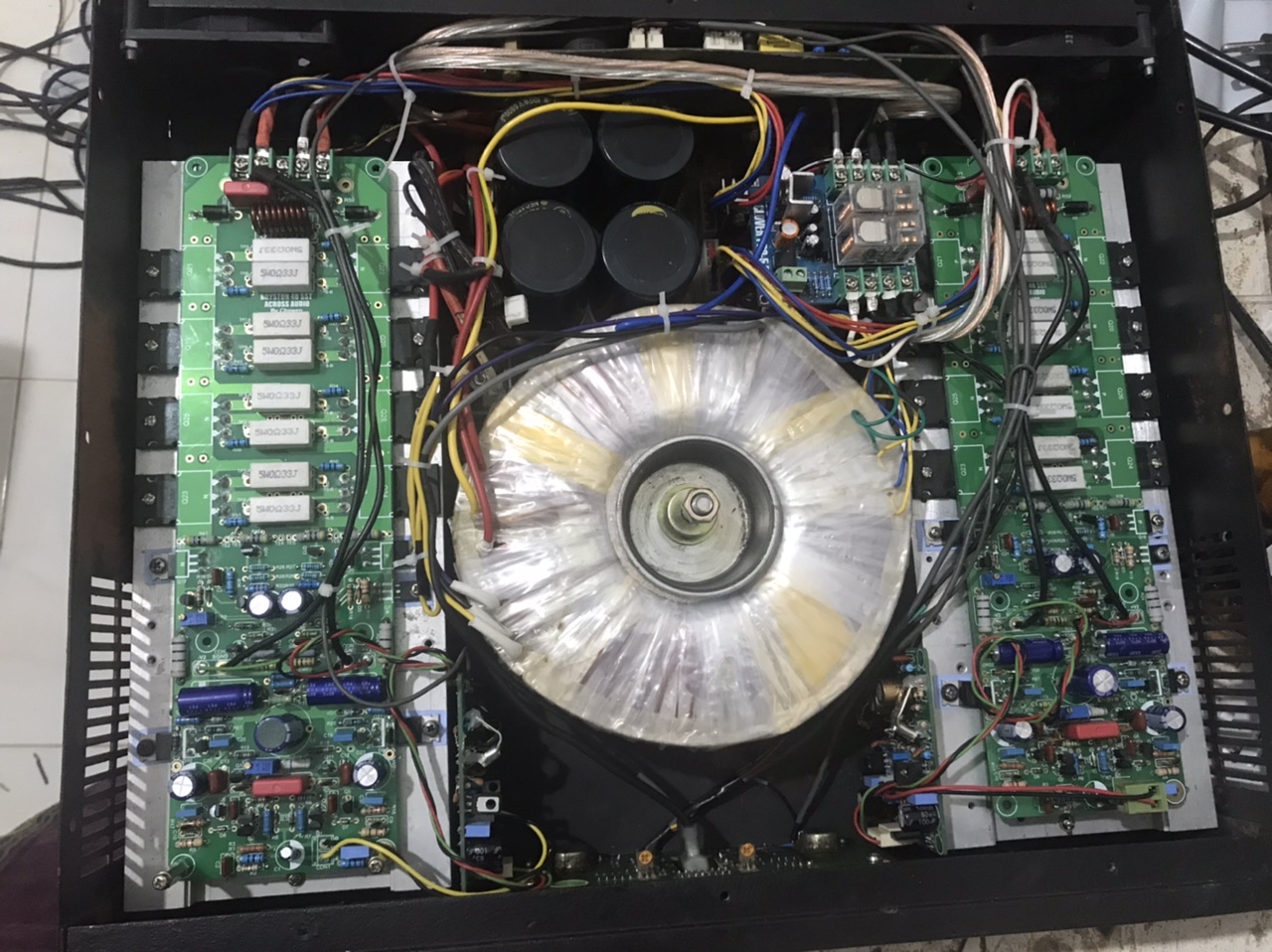

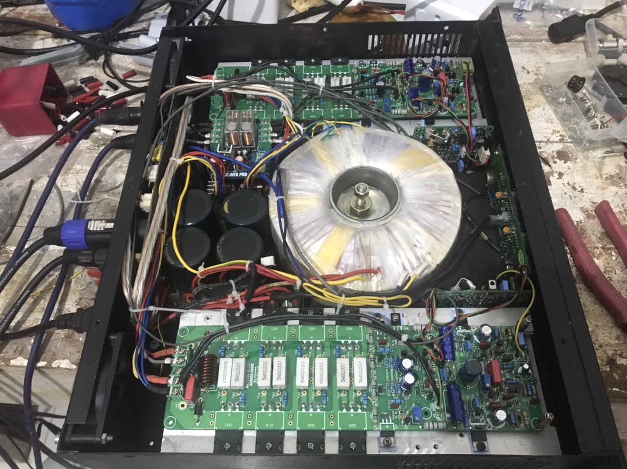

Few clicks at the end ....thanks for all specially Chalky and Amplidude
Nicely done fetamp. Did you reuse an old case? Kudos for using the Speakons. Are they fans at the back of the case - do you use them?
Thanks Chalky....yah...old case,old psu from Two different power amp...output through speakons,installed two fans as poor matching of OP transistors will produce extra heat...for little safe side?
