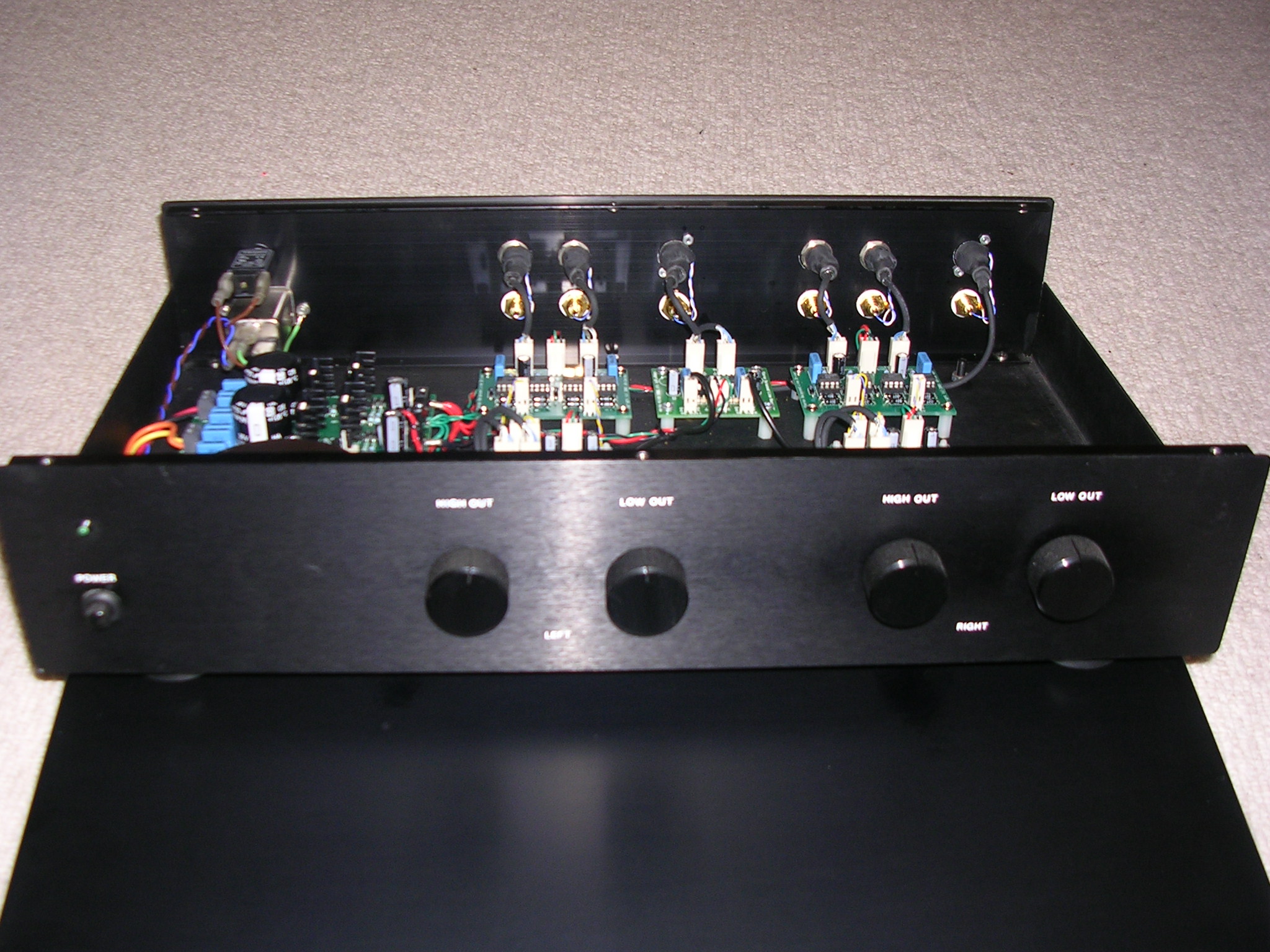

Nice, what rolloff do you use for your filters? Mine are two way LR, 4th order ( 24dB/octave ), state variable with balanced input and output. Each of my speakers has a pair of Volt 8 inch drive units in a transmission line, partnered with a ribbon tweeter. I'll post some pics in a day or two.

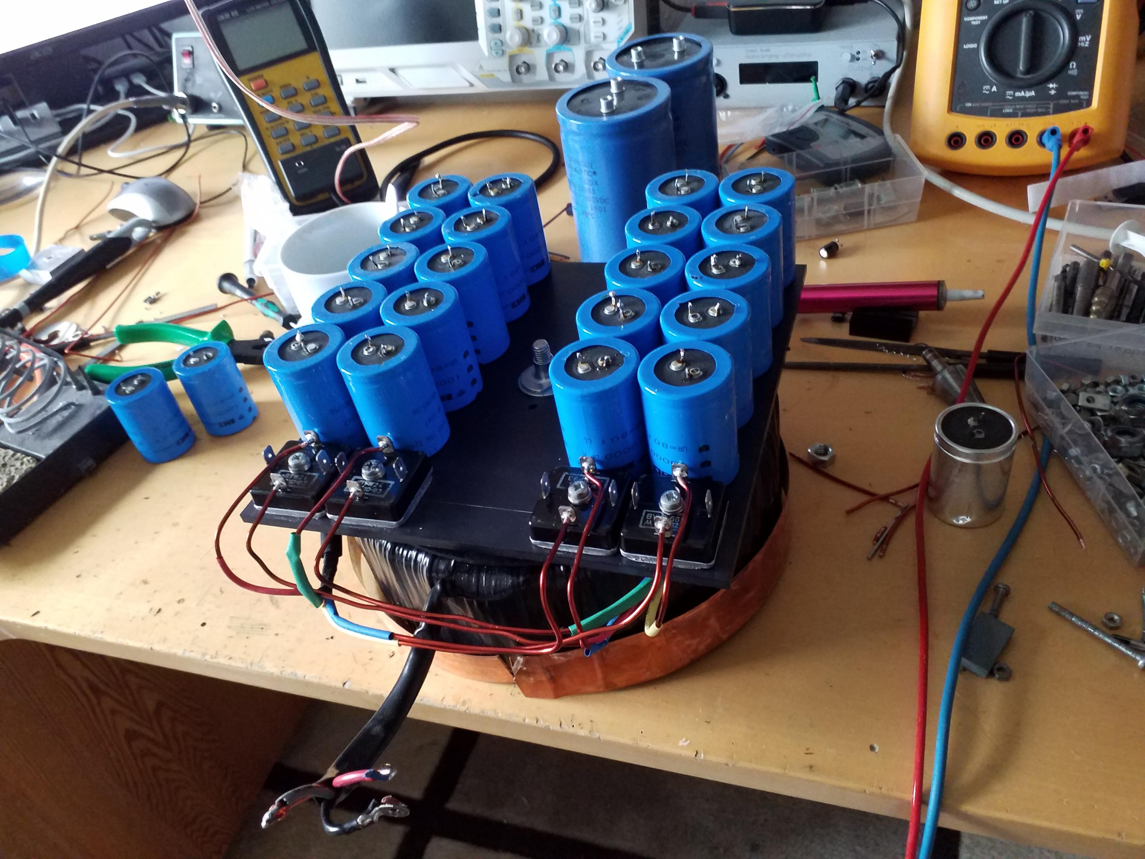

I got some progress on rebuilding my bryston clone, I skipped the entire psu board that came with the kit, I do like some good oldschool psu with brute force, so this is the new psu, its gonna be crc this time, see if I can reduce ripple somewhat, all wirring will be heavy duty solid core copper.

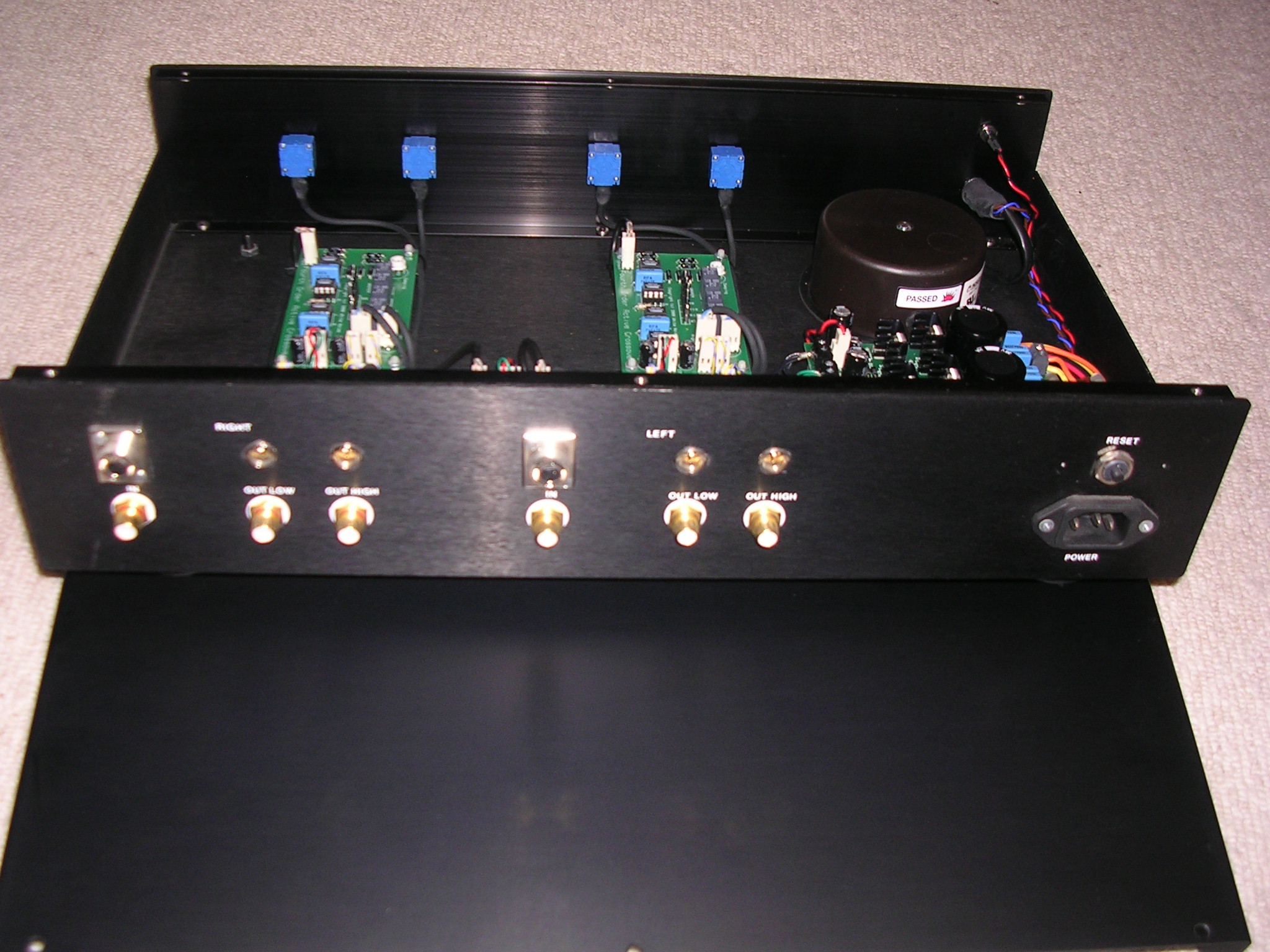

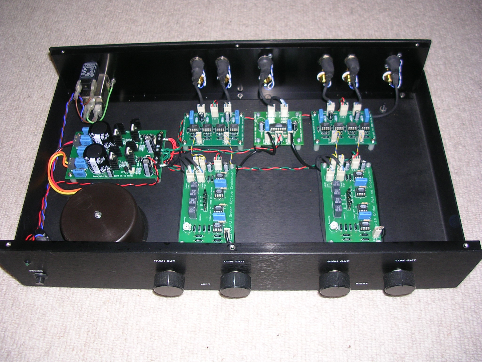

Here are a few pics of my active crossover. The pcbs along the back of the first picture are a power supply, a balanced output module, a balanced input module, and another balanced output module, respectively The two pcbs in the foreground are the 24dB/octave active crossovers. The crossover frequencies are programmable via small single-in-line modules and are set to 3kHz in this case. The inputs and outputs can be balanced or single ended and there are separate level controls for the low and high frequency outputs of each crossover. The modules and their pcbs are all of my own design. The case was chosen to match the size of all my other amps, preamps, etc. Commiserations on the dental pain, I think its the worst kind of pain ( for a man at least ).

Now that's what I call a power supply!! I must admit that I'm in two minds about the Bryston clone power supply module too. I have my own designs/pcbs for a soft start module, cap multiplier psu, and speaker protection so I might just use those.
That is very nicely done, I do like meticulously cabling, bravo..! And you made your own pcb with the possibility to change crossover frequency, not bad at all.

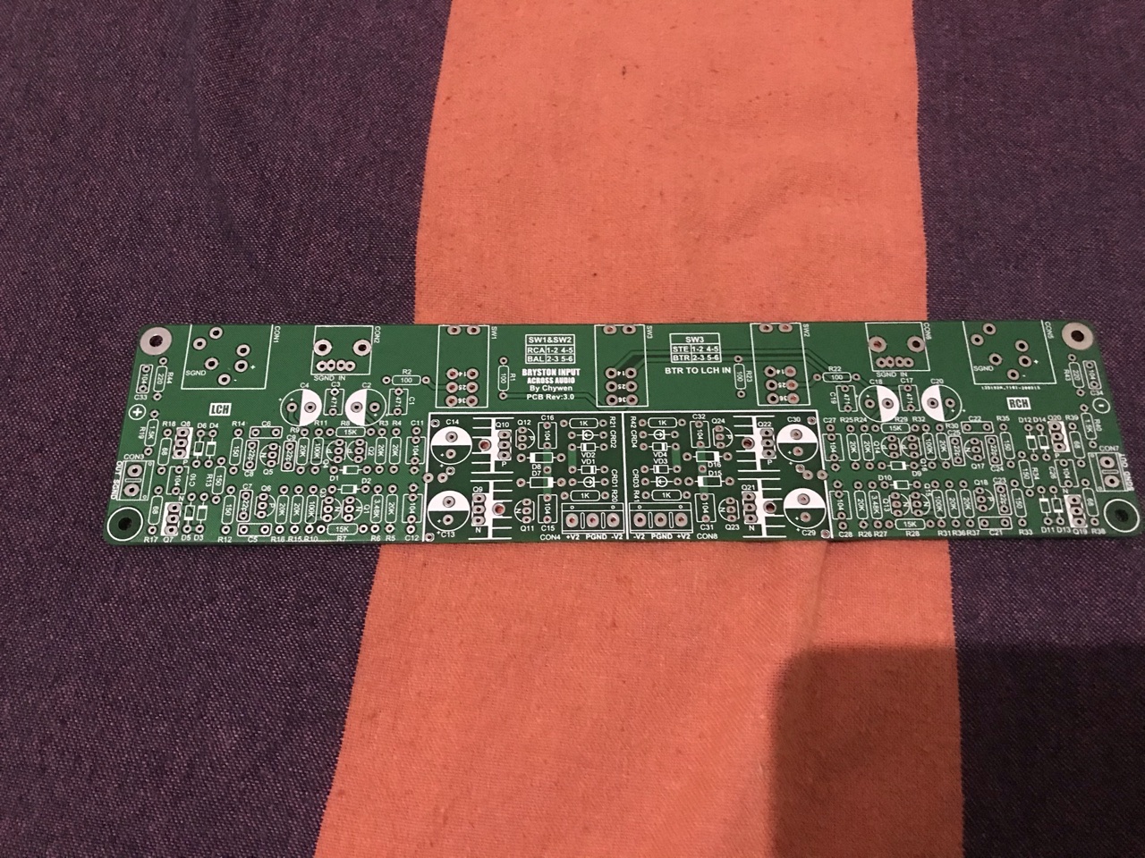

My recommendations are obviously for the big dual channel input board. The small single channel board is a bit trickier. If you look back to my posts showing a revamp of the small input board you'll see I had to get a bit creative. The rca socket I used was a bit of a kluge, it didn't exactly fit the pcb footprint. I couldn't find a switch that fit the rca/xlr position so I simply used two, small, single pole double throw, pcb mount switches. There is no pcb footprint for an xlr connector so I simply soldered in a terminal block.
Hi....chalky I bought this input board but it little different from previous version and schematic and bom I received are old one,what is that sw3. Can anyone send schematic and BOM for this board
The switch sw3 looks it selects between stereo and bridge tied mode. In stereo mode the input board acts like the old one, but in bridge tied mode one channel is inverted. In the latter case any attached dual channel power amplifier becomes a bridge tied mono amplifier with ( in theory ) double the power output. Usually the input proper goes to the non-inverting channel and the inverting channel gets its input from the output of the non-inverting channel ( whose input socket is then disconnected ). However without a board in front of me I can't tell which channel is which and the pcb legend is ambiguous. The physical layout of the Rev 3.0 pcb is different from Rev 2.0 but electrically it looks to be unchanged.
Exactly as I said. In bridged mode the input goes to the right channel and the left channel is inverted. The left and right outputs of the input board go to the left and right inputs of a stereo power amplifier. The loudspeaker is connected across the power amplifier outputs, usually the two red terminals.
