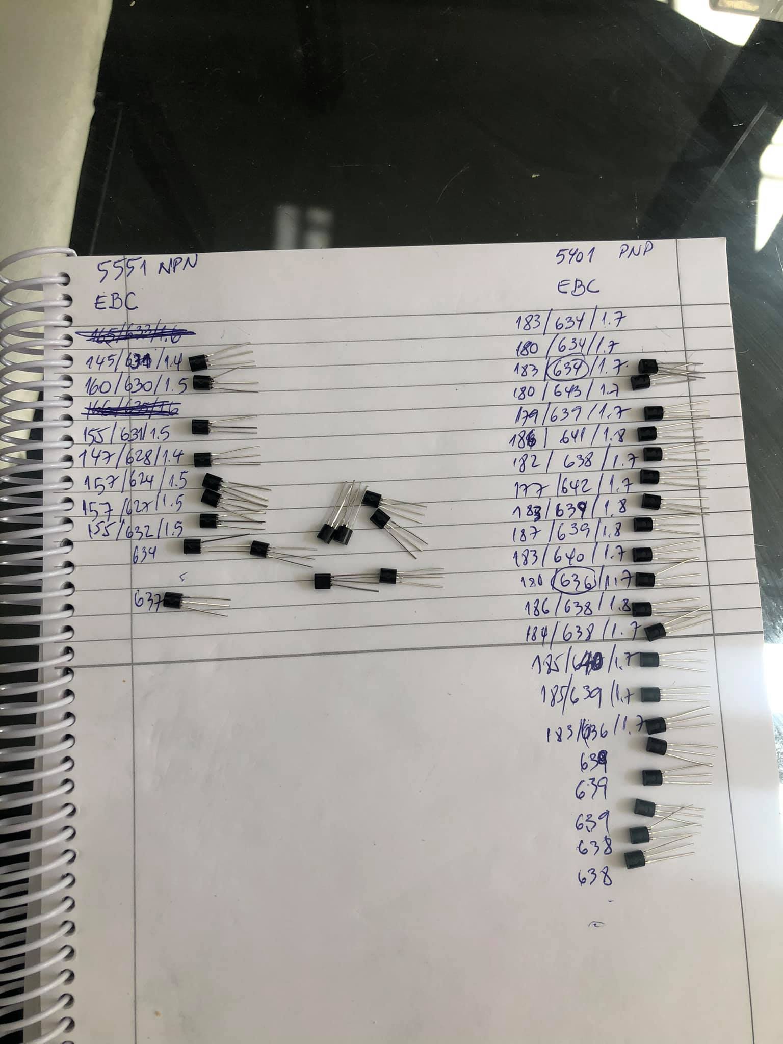

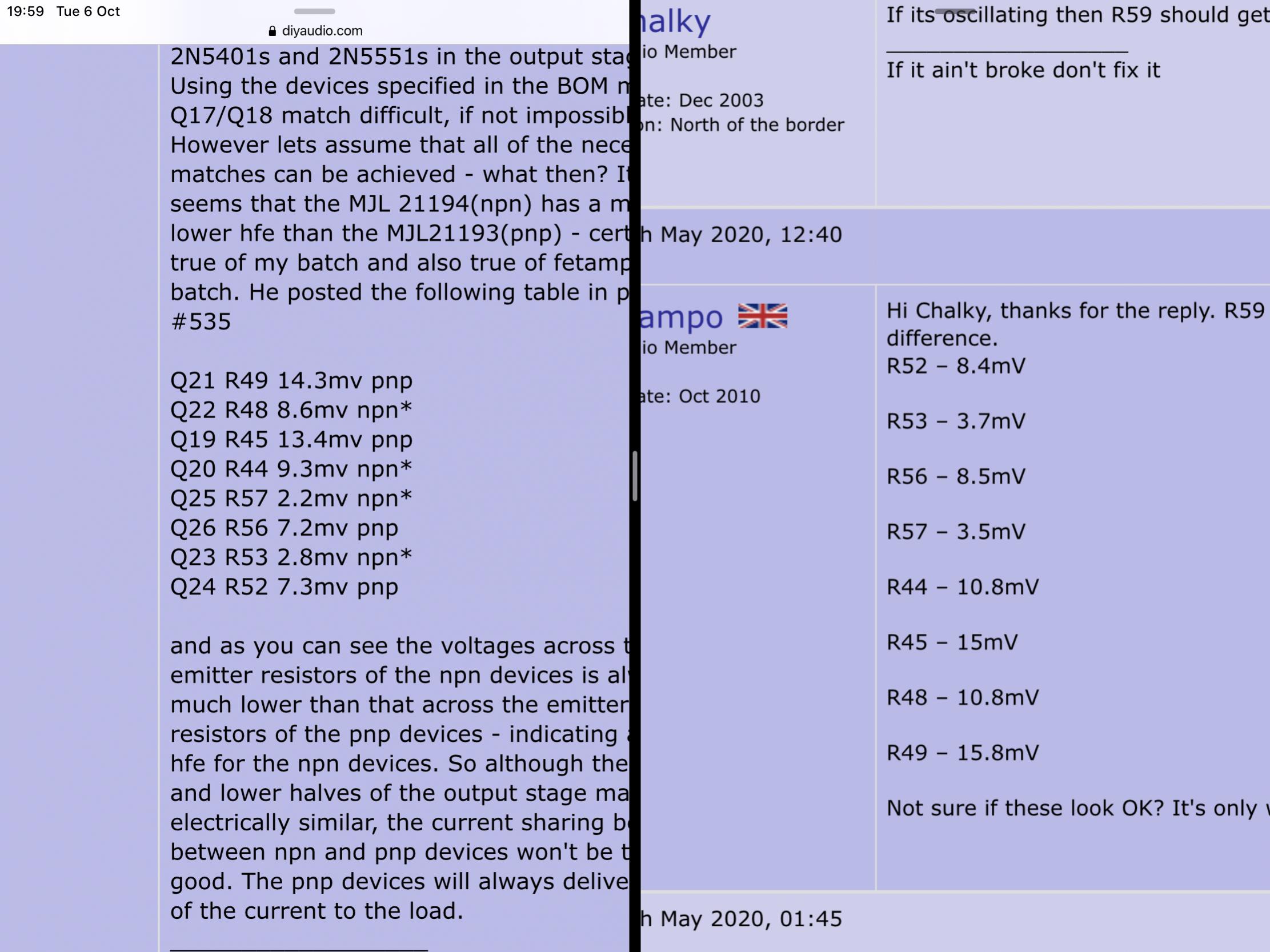

Fetamps measurements also suggest that the driver Q17 mje15030(npn) has a lower hfe than its counterpart Q18 mje15031(pnp). This is indeed the case; all of the npn transistors in the mje1503x series that I have measured have a much lower hfe than their pnp complements. I can't find any currently available devices which go any way to solving these problems. However it may prove possible to use TIP35C and TIP36C for the output devices as they have a sufficiently low ft (3mHz) and I have a few matched npn/pnp pairs with an hfe of about 100. Vceo(min) is only 100V but my measurements give about 130V for th TIP35C and 200V for the TIP36C, so good for up to +/-60V power supply. The devices I have are pretty old so I'll but some modern ones and check them out.
Congratulations chalky.....please post some clicks.......I will post my values vs Trampo’s please comment it...why similarities?
Similarities are because modern semiconductor production methods are remarkably consistent - all the npns tend to be very similar as do the pnps. It was really only the Japanese that selected for hfe(transistors) or Idss(jfets) and they've largely stopped manufacturing now. So getting any kind of npn to pnp match is that much harder. Maybe even harder if Bryston is skimming the best matches off the top of the devices used in their power amps. Matching of npn to pnp devices doesn't make a lot of difference in the case of most output stage topologies but it does with the Bryston and results in lower distortion and better current sharing amongst the output devices.
Both of us highest in R49 and lowest in R57.....?

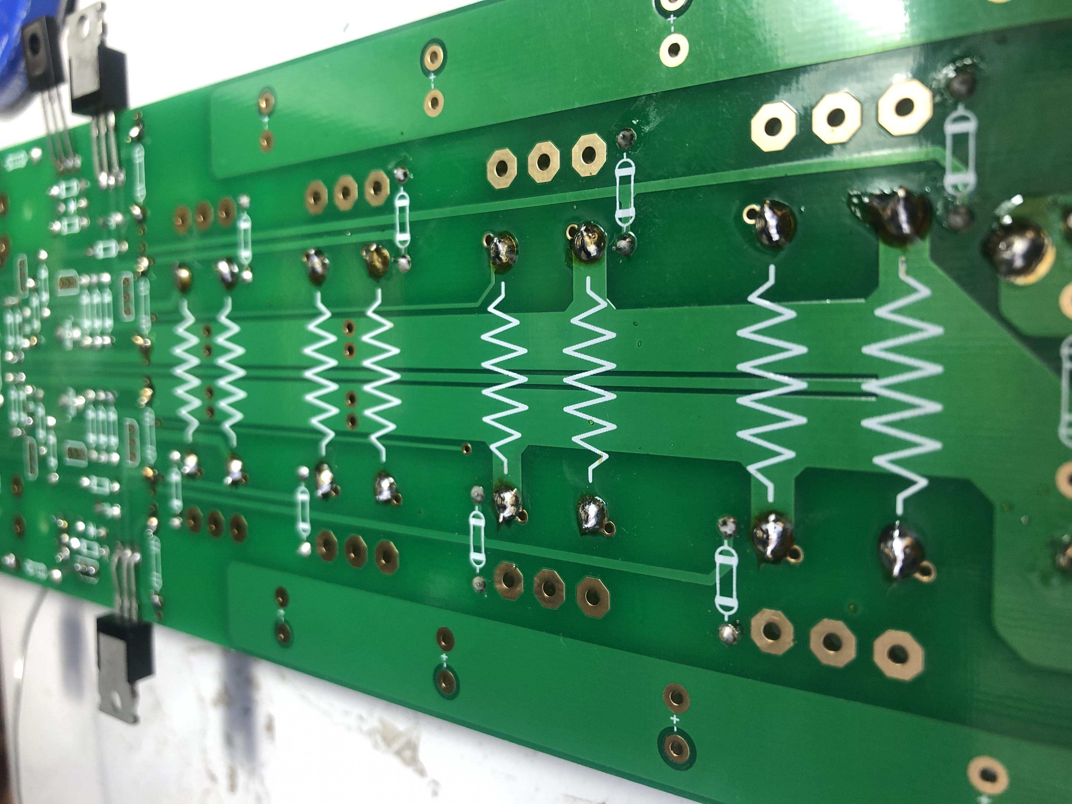

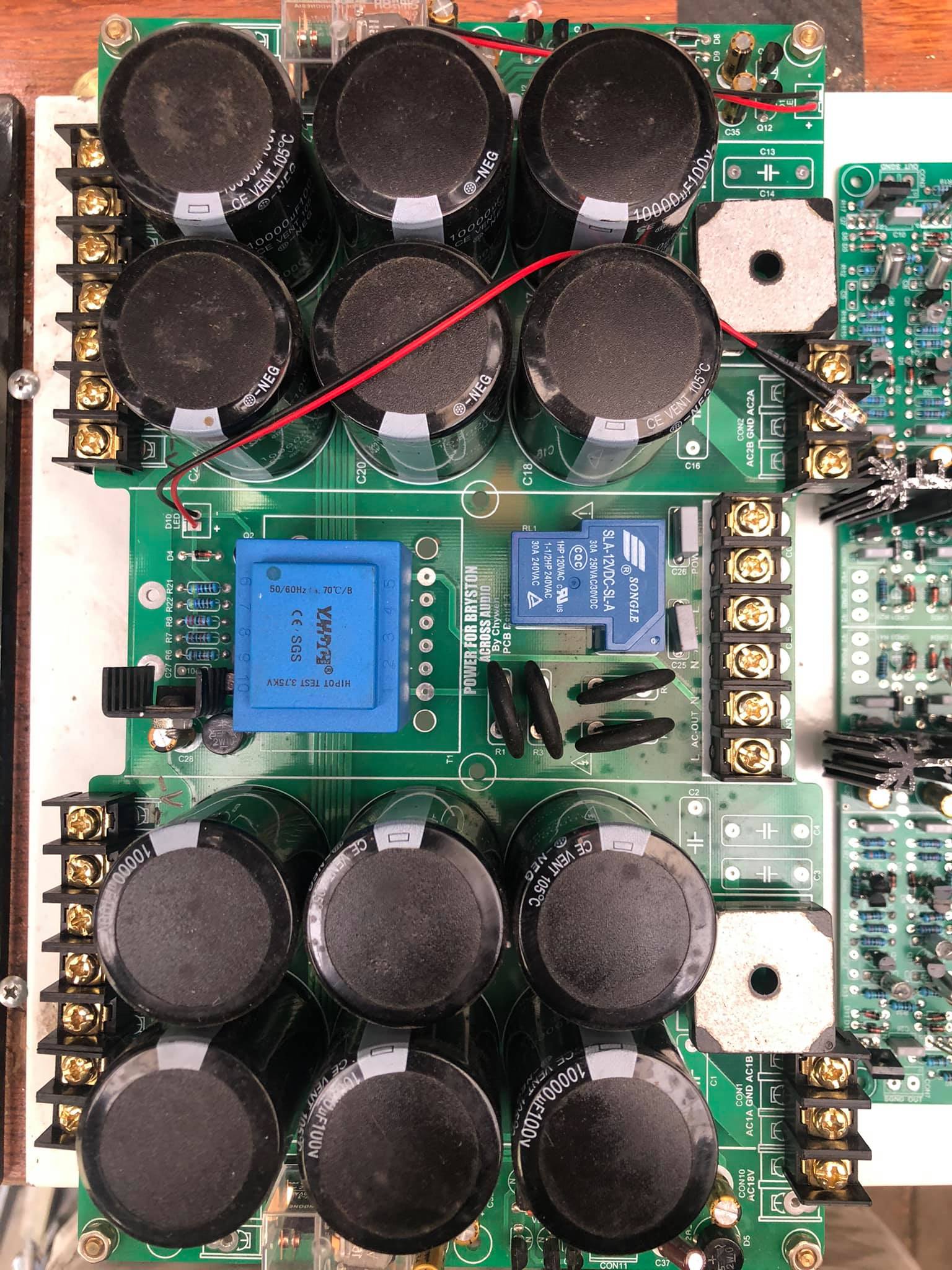

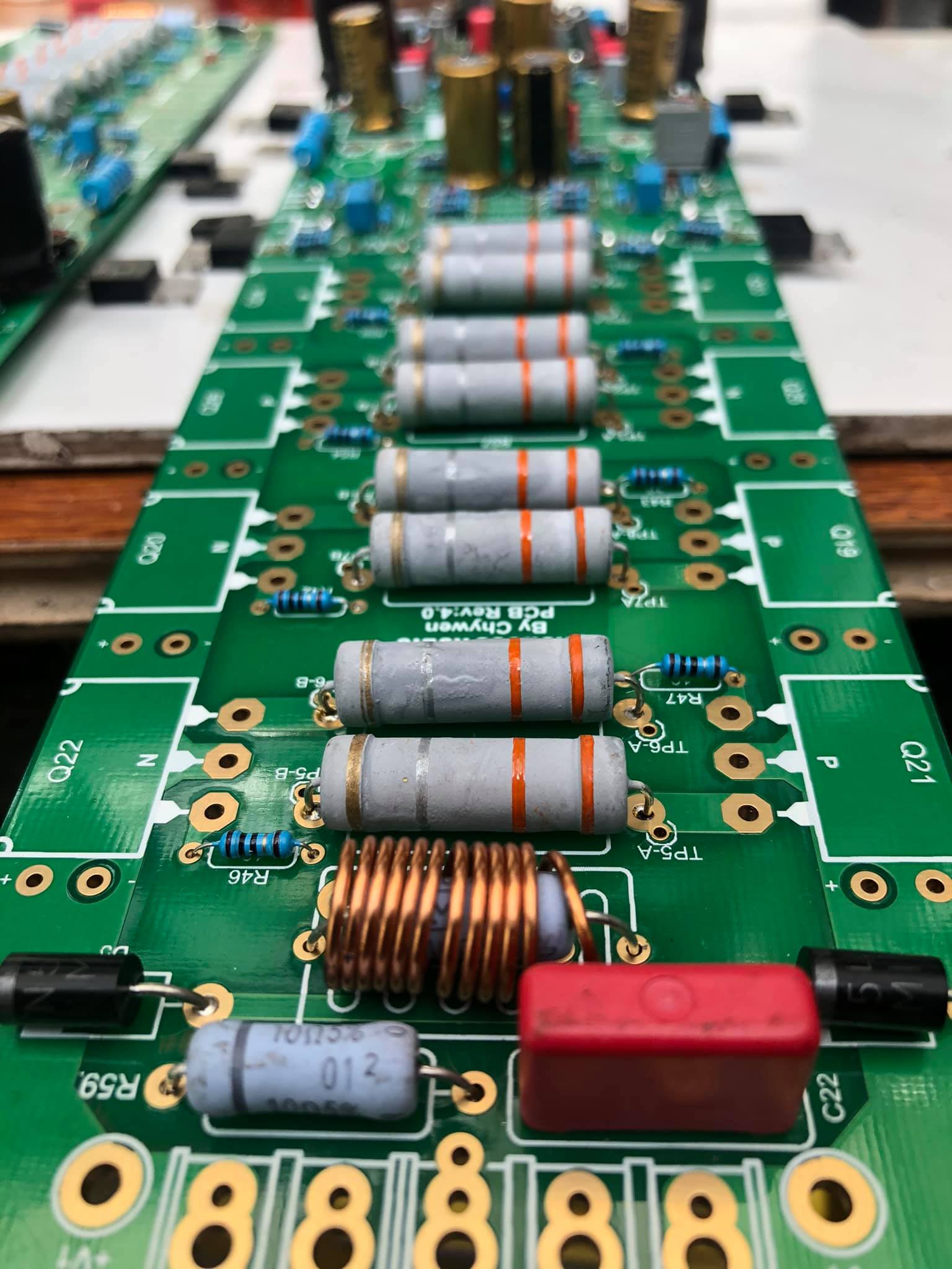

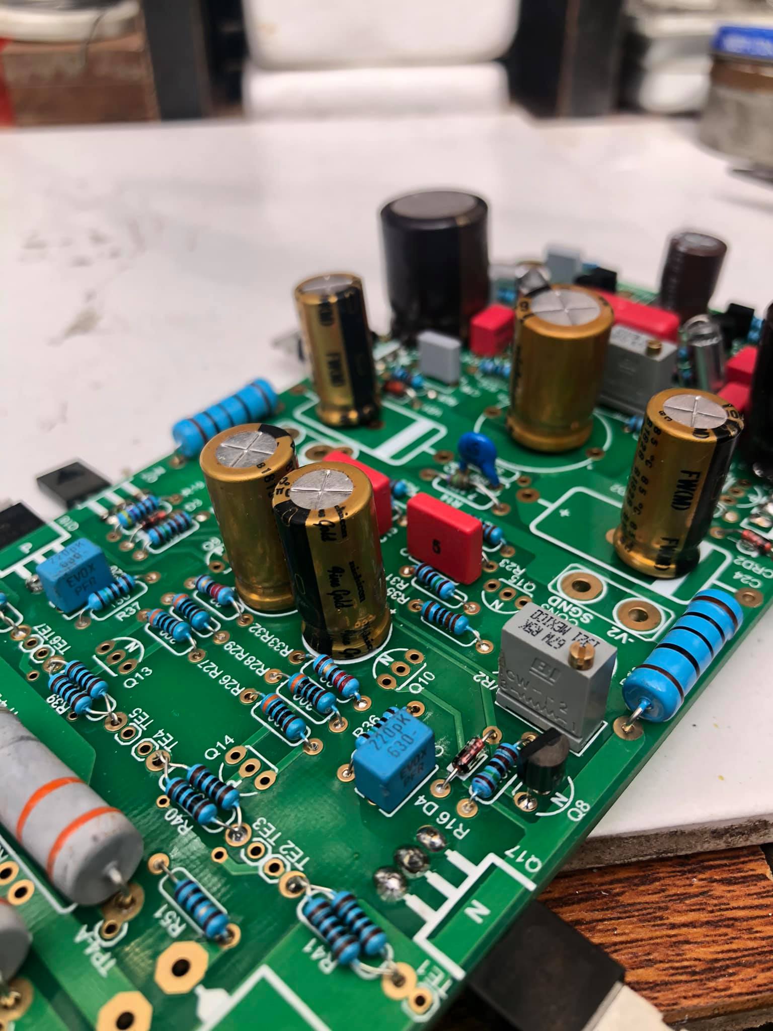

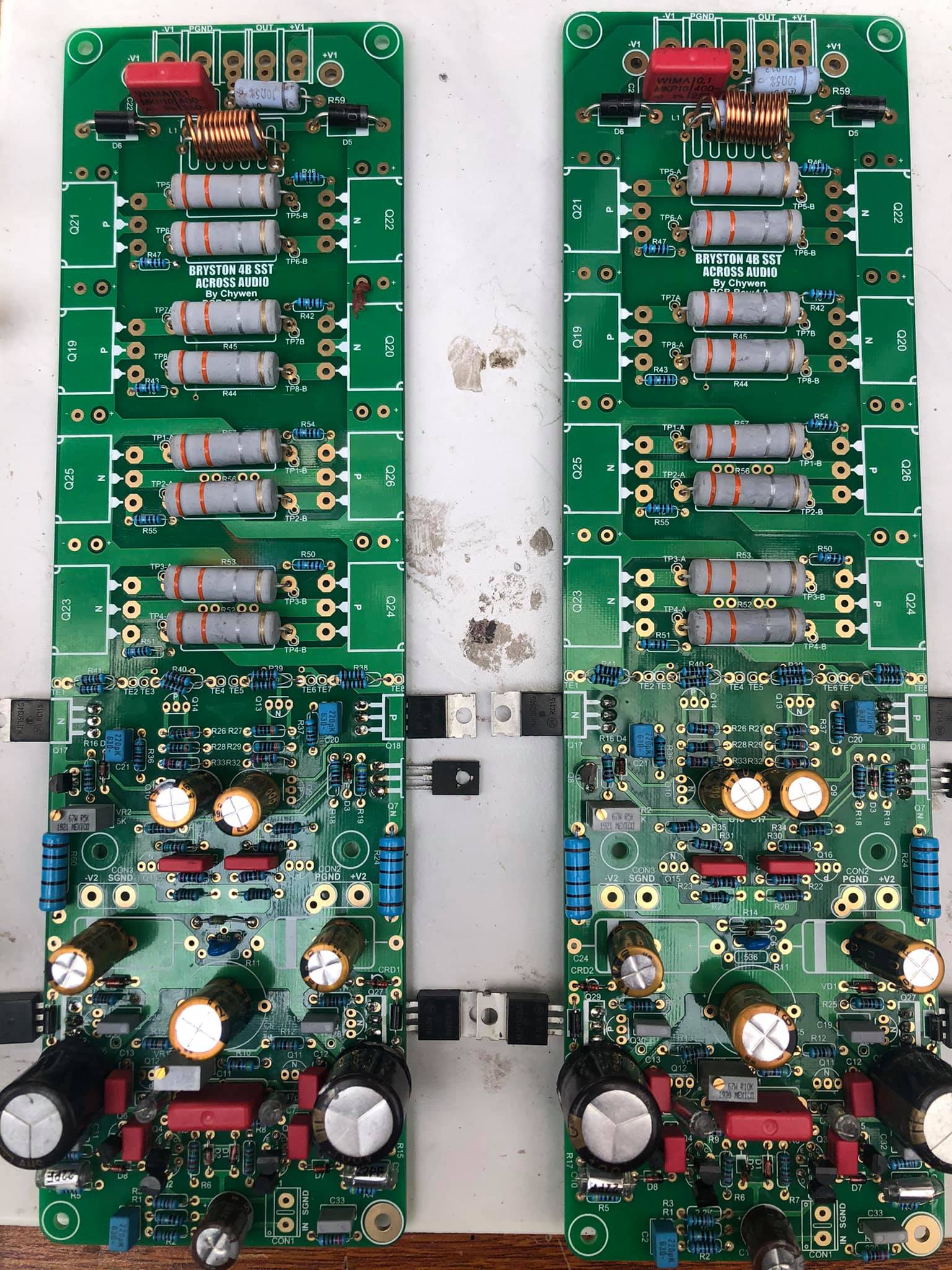

My bryston 4b sst clone!!
Y have to finish matching transistor y debugging process.
And a chassis to house everything.

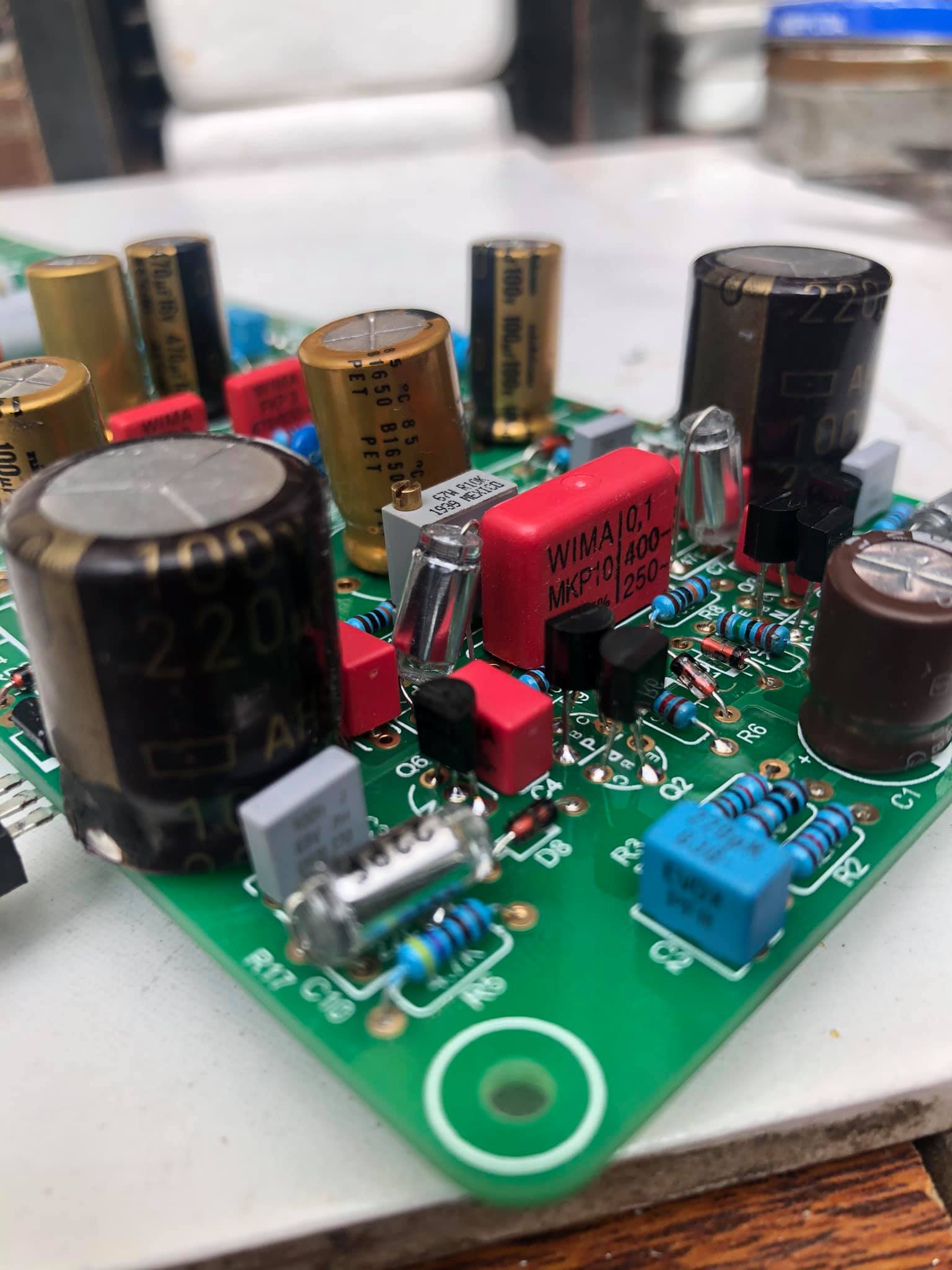

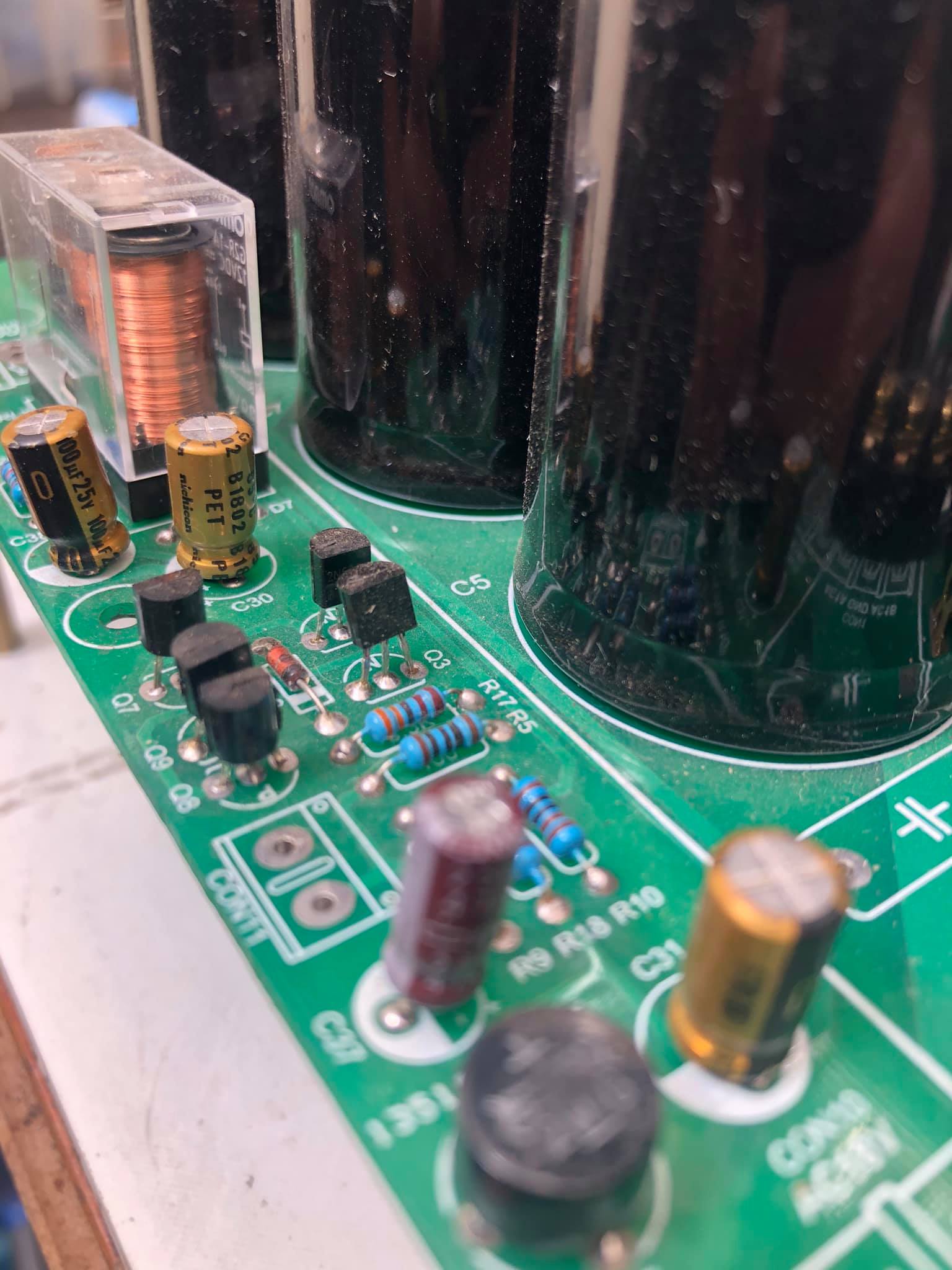

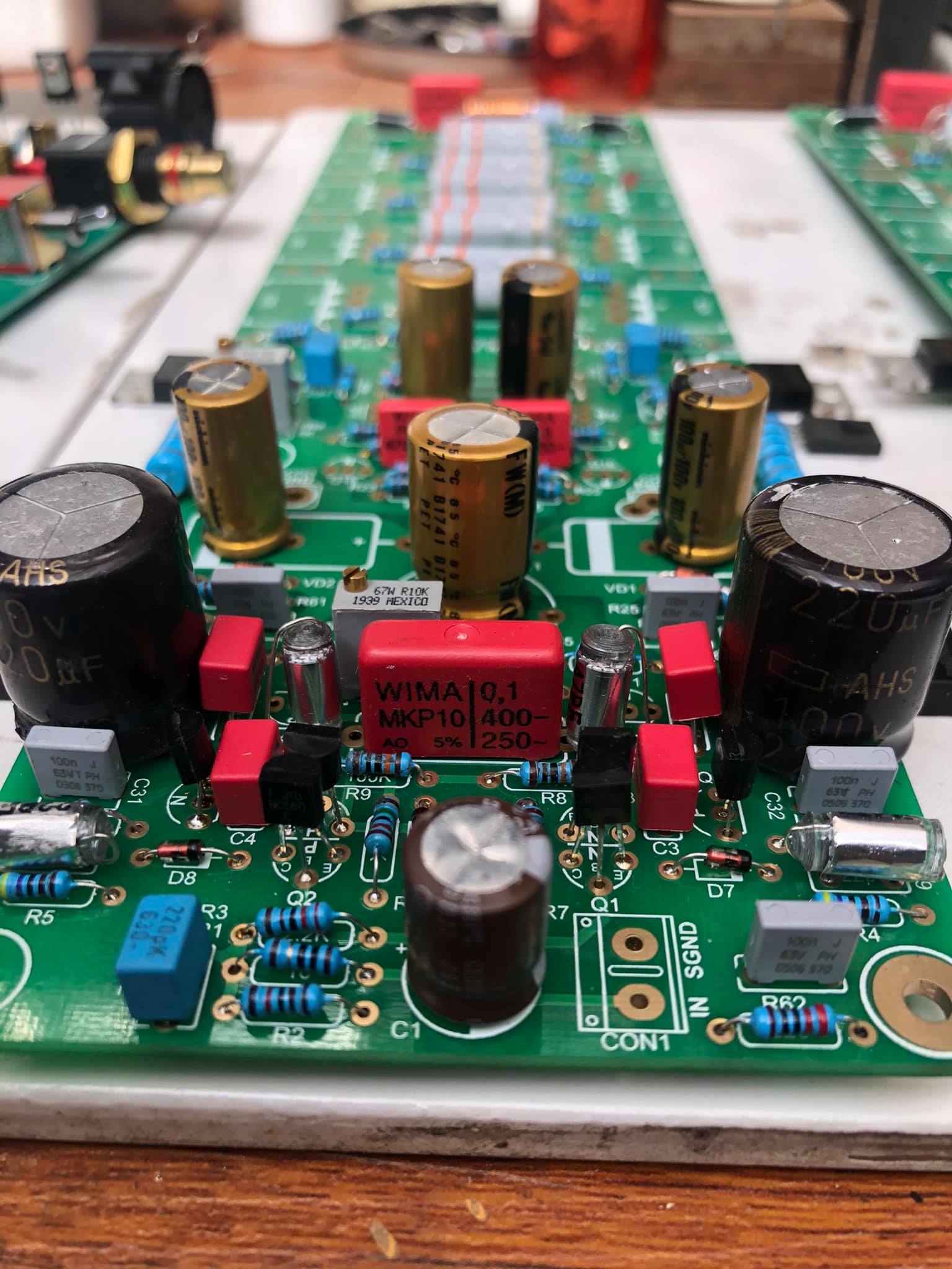

Congratulations hschier ,nice job...please share your experience with us ,please let me know about Q5,6 in input module are they hot to Tuch? Please post some pictures of AMP cabinet,
i replaced pn100/pn200 for bc550/bc560, that's why they are installed backwards.

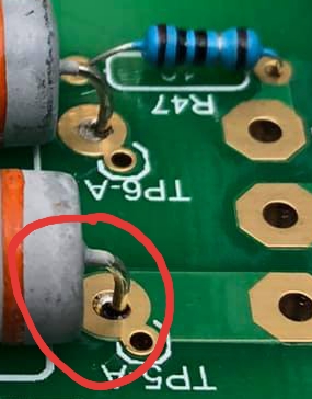

Congratulations on your build, but from the photos it looks like your soldering could use a little more heat,
thanks Thomas!!! only expert ayes. Thanks
I reflowed all of them. here is the pic from back.
