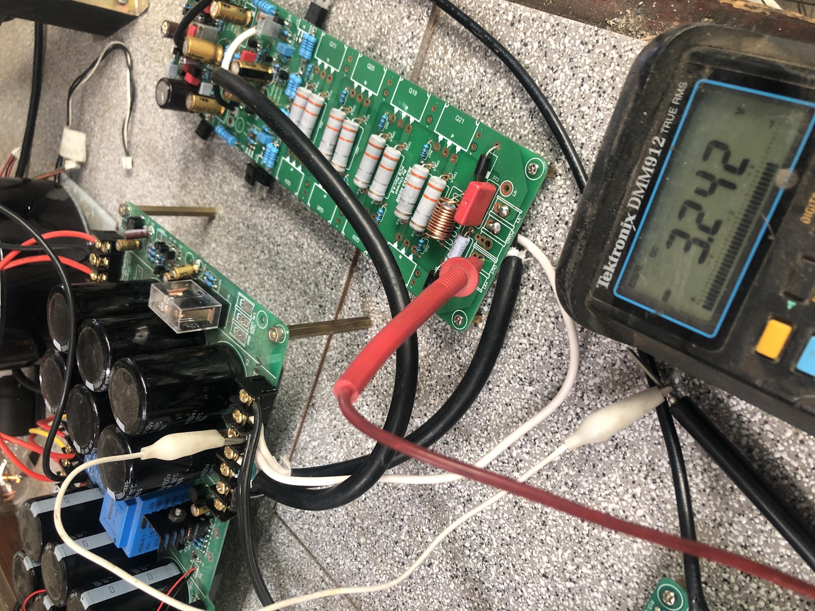

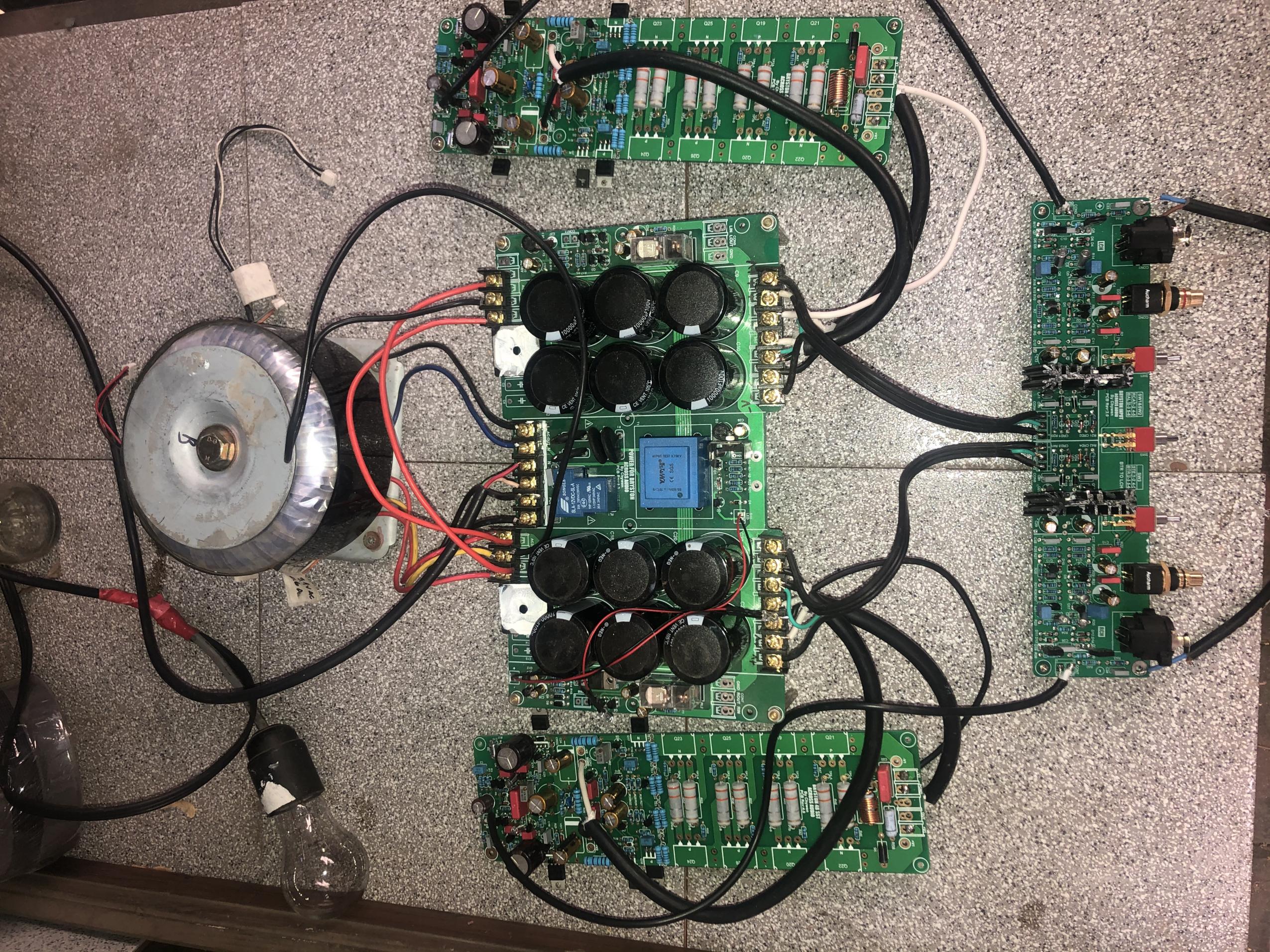

hi to all.
I am in debugging process rigth now. Questions:
What do you mean when you said that the input board must be shorted?
When i conect the bulb, it works like a voltage divisor, so voltage drops. Does it affect anything?

Short the inputs, yes the bulb affects max current draw, you can't adjust bias, but make it low, try to get dc offset close to zero also, if al works out, you can remove the support wheels, aka bulb, and the final has to be on heatsink, check with multimeter that all transistors are isolated from heatsink before powerup, if you have or have access to a vario transformer use that, otherwise some low amperage fuses will take eventual heat
1. Ensure that all components are of acceptable quality and properly installed;
2. Ensure that all solder joints are free of false soldering and short circuits;
3. Do not install the power tube before power-on and the transformer is connected in series. 60‐100W
Incandescent bulbs, especially all SGND and PGND on the board
Use the GND of the large reservoir;
4. Test whether +/‐V2A (ie C26, C30 capacitor voltage) is after power-on.
+/‐33V or so (all between 31-33V is normal);
5, adjust VR1, the measured output OUT is close to 0V (+/- 10mV);
6. Adjust VR2 and measure R38; R39; R40; R41 The voltage across R41 is the minimum value, and the range is about 0.5‐0.58V (if there is an oscilloscope to test the signal channel, there is no problem);
7, properly install the power tube (must connect the incandescent bulbs in series), adjust VR2
Make Q19 current about 5mA; after removing the bulb, adjust VR2 again to make Q19 current 70-80mA (ie, the voltage across R45 is 23-25mV);
8. Re-adjust VR1 to make the output OUT close to 0V (within +/-10mV);

Turns out that the setup procedure in the debugging instructions is wrong. Bryston recommend that there should be 25mV across a corresponding PAIR of emitter resistors ( i.e. about 12.5mV across a single resistor ) in a fully warmed up amplifier; whereas the debugging instructions suggest 25mV across a SINGLE emitter resistor. So it turns out that your 10mV setting is only a little lower than the Bryston suggested value of 12.5mA.
