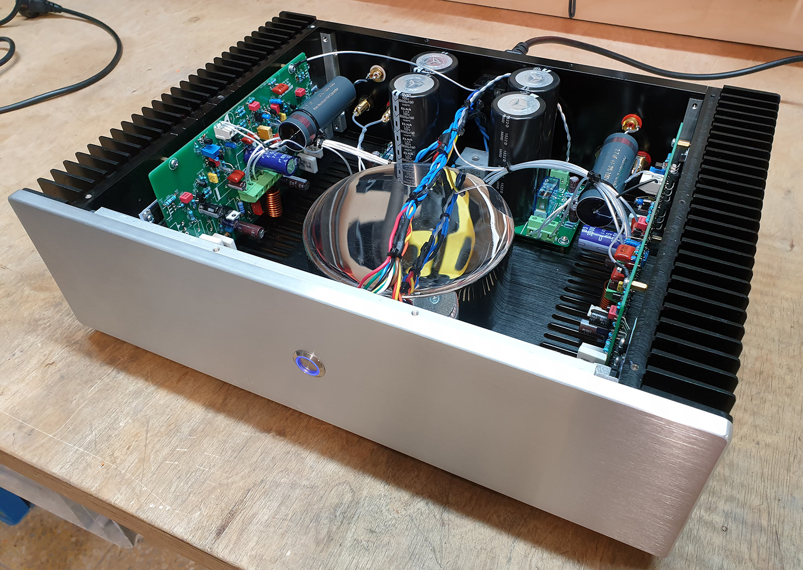

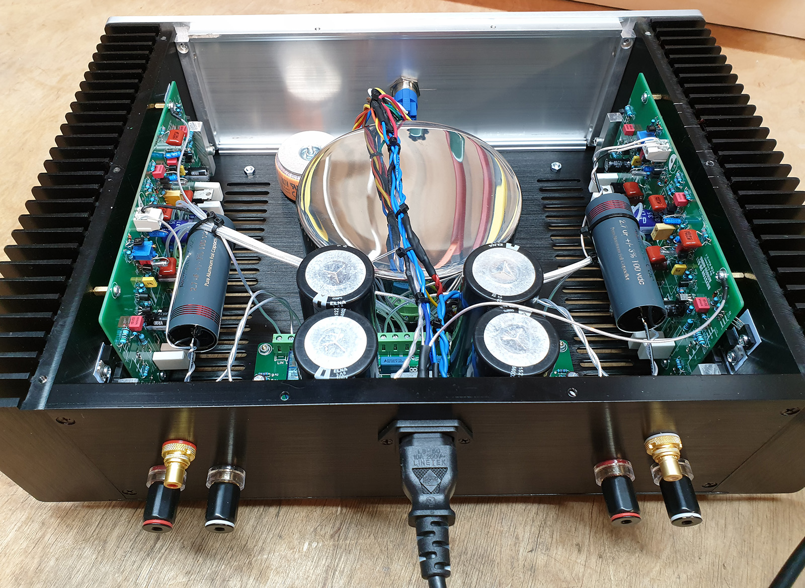

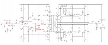

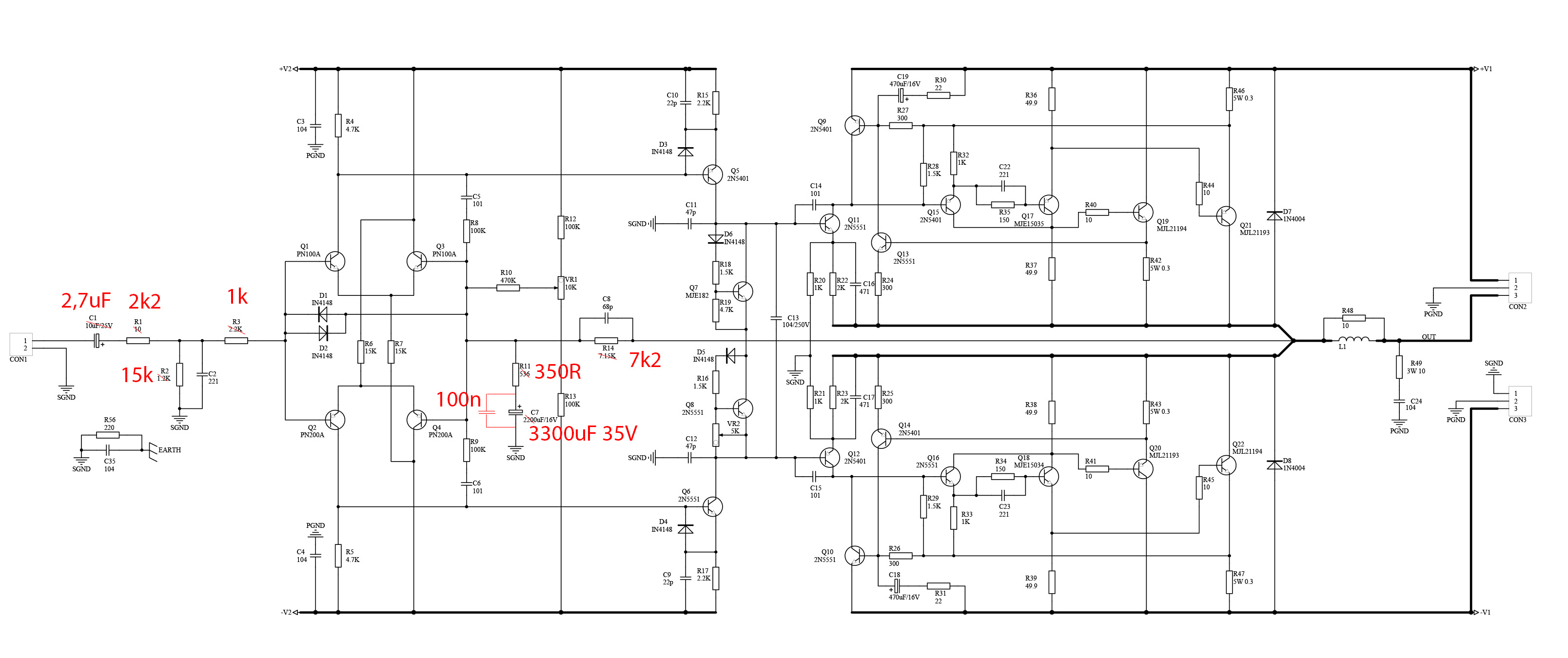

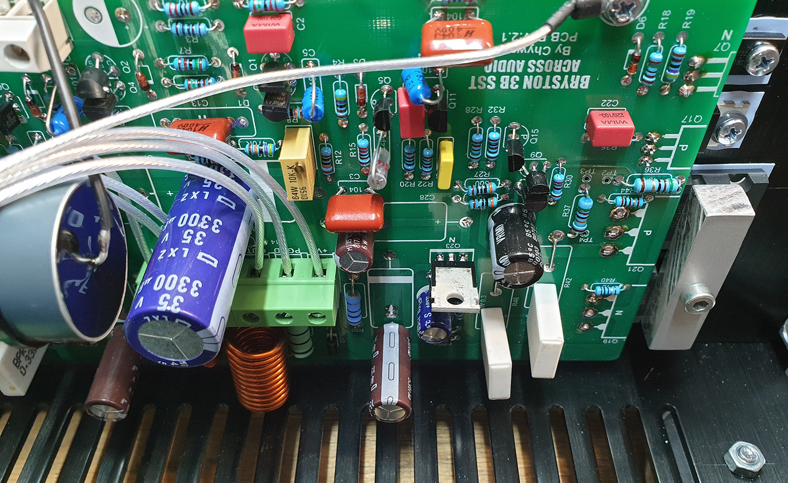

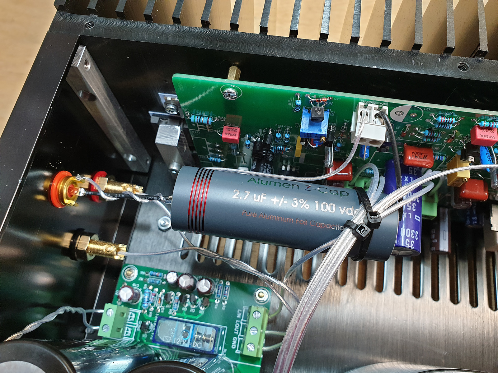

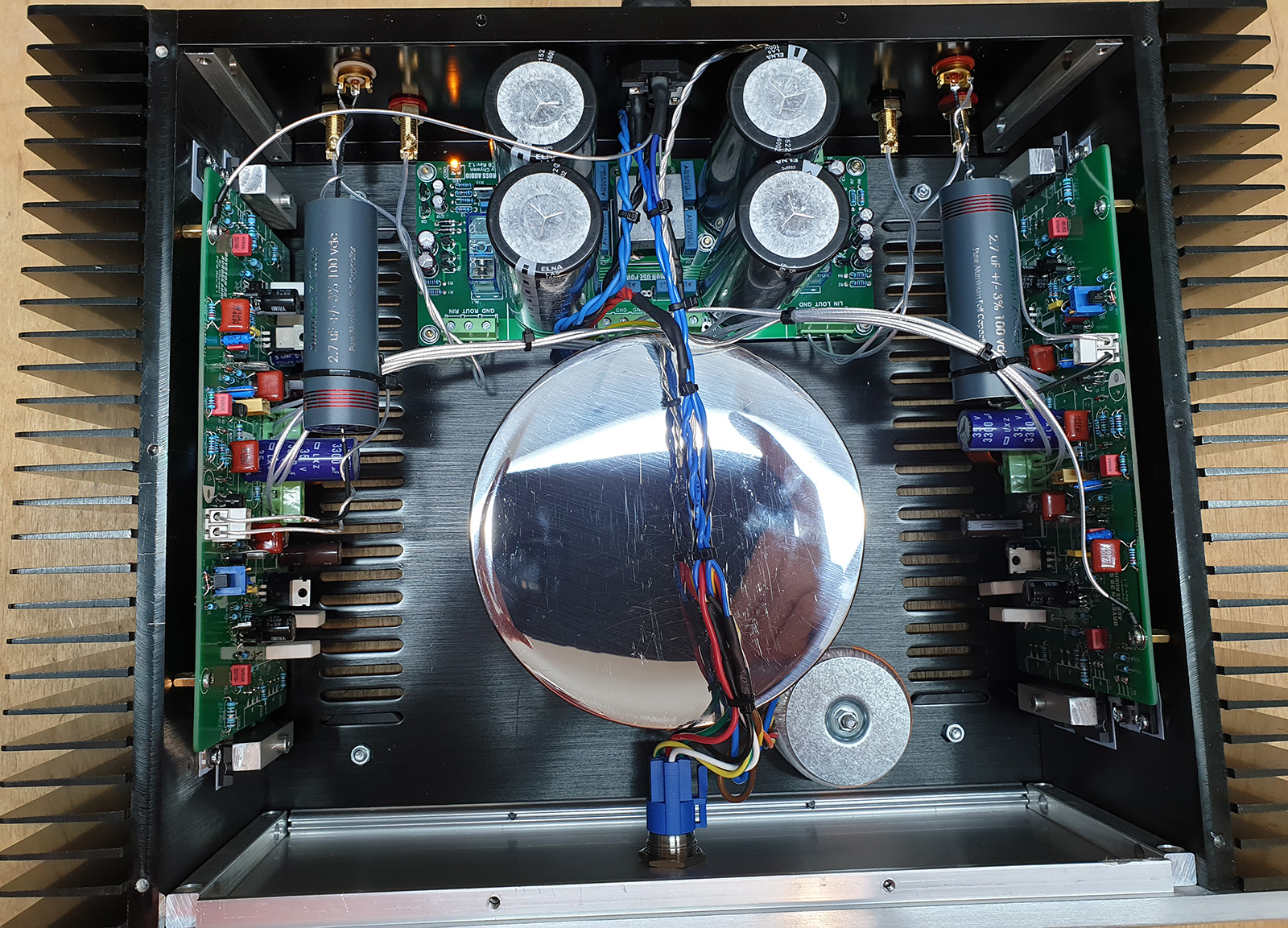

Bryston 3B SST clone - in final case
Here is my promised update of this build😀
In the final case with proper wiring - AC/signal/DC power separated as much as possible.
- Running at +/- 49V, 300mA bias / channel
- without input board - My muses02 opamp preamp can easily drive this amp
- all transistors and symmetrical resistors matched
- PN100A/PN200A input stage
- 300VA transformer
- 4x 20 000uF filter caps
- Input caps 2,7uF Jantzen Alumen Z-Cap
- Attached is a cirquit diagram of my mods
Cheers
Paul

Wow....congratulations, bias 300ma ?
