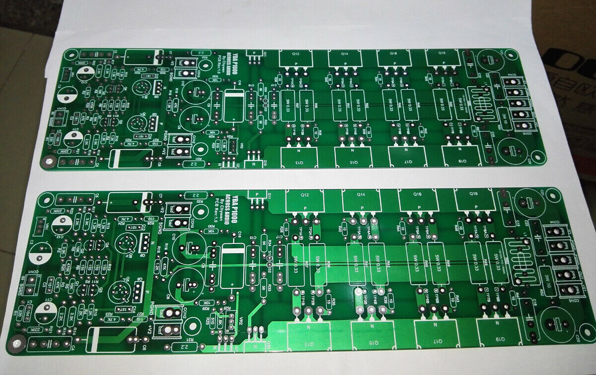

Any of you guys seen/tried these amplifiers? Designed by the same guy who did the Bryston 4B SST boards. They seem to be a more conventional design so I've bought a couple to see what they're like.
Pair of 400W+400W Stereo Power Amplifier PCB Board based on YBA P100 Amp C 2.0 | eBay

Yes I have also had my eye on those French clones, that guy chywen makes some pretty decent boards, the rewiev in stereophile was very promising as I remember.

I'm always curious. Had a look at the service manual and can see lots of ways to improve them from an engineering point of view, but what effect this has on the sonics who knows? Given that their distortion spectrum is almost all second harmonic I guess that they sound nice and valve like.
I would consider lowering rail voltages and use lower distortion transistors, and reduce outputs to maybe 4 devices
The clone has a few changes from the original. The input diff pairs are fed from 2T constant current sources rather than a resistor bias chain; the VAS current is upped from 4mA to 12mA; the two 10k resistors hanging off the VAS collectors(!) are (thankfully) gone; the Cdom compensation caps are reduced from 150pF to 30pF; and there are only 4 rather than 8 output pairs. Yes plenty of scope for experimenting with different transistors. Did you ever finish your 28B SST amplitude?
Sounds like chewyn did some nice upgrades already, but aren't crd diodes a bit noisy, could be a future project.
