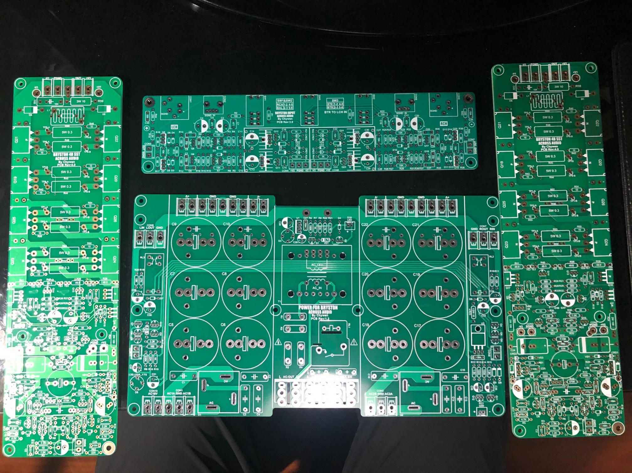

A few pics..

Hi Friends, what fuse for system use?
It's dependent on the components you used in your powersupply...
I bought the same to you.
2xamp Pcb+ input pcb + psu pcb

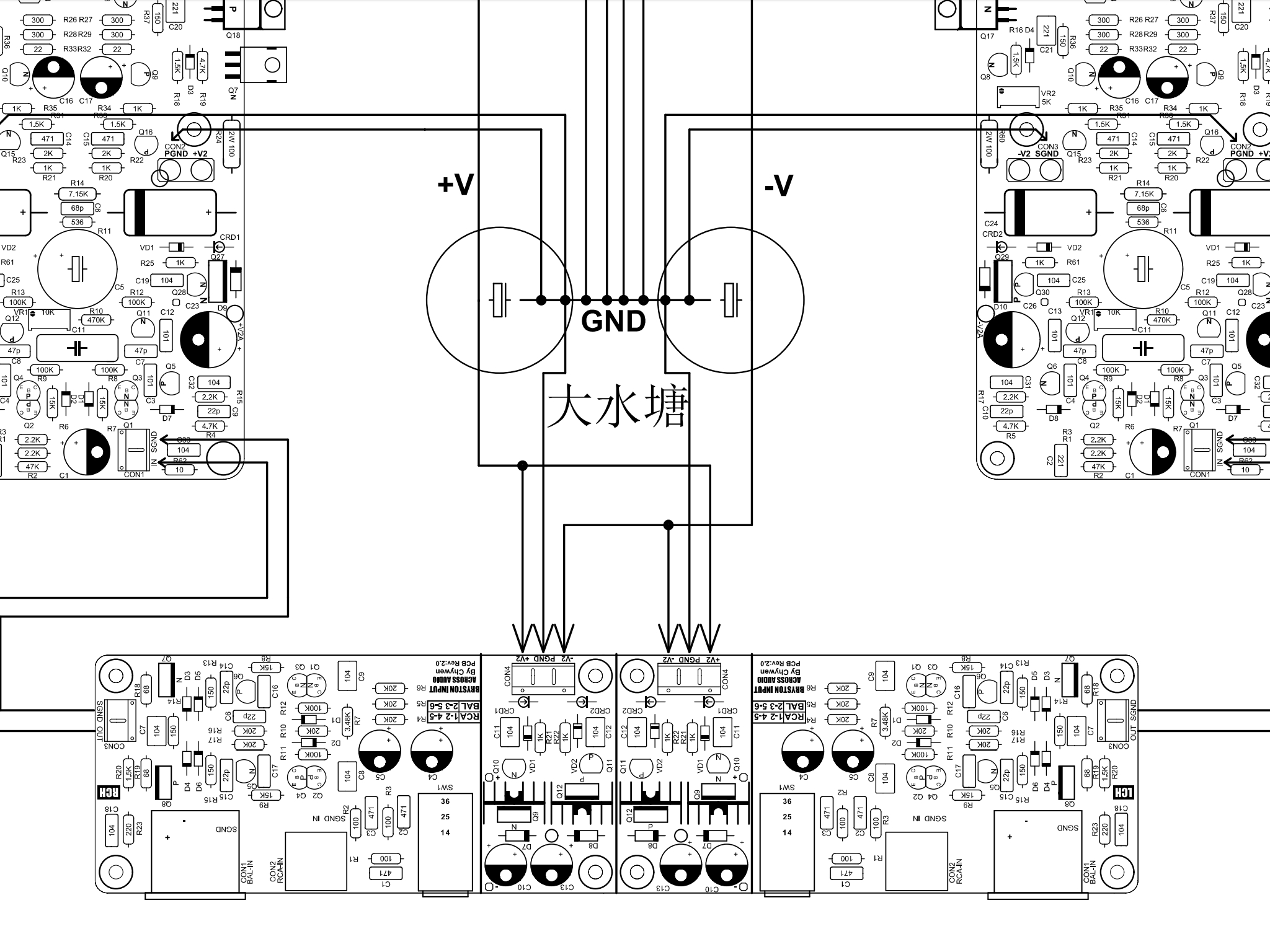

It seams Input work with 33v and the v2 input is from amp pcb v2 output?
A wire diagram between the pcbs will help me a lot
Thanks.
All documentation is already available in this thread, somewhere.
A wire diagram between the pcbs will help me a lot.
the documentation shows the input pcb is feeded from the same dc output to feed the amp pcb, this would be 65vdc.
The middle part of input pcb is a dual voltage regulator, it delivers the 33 volts as needed.
so what is for the +-V2 (33v) output from amp pcb?
