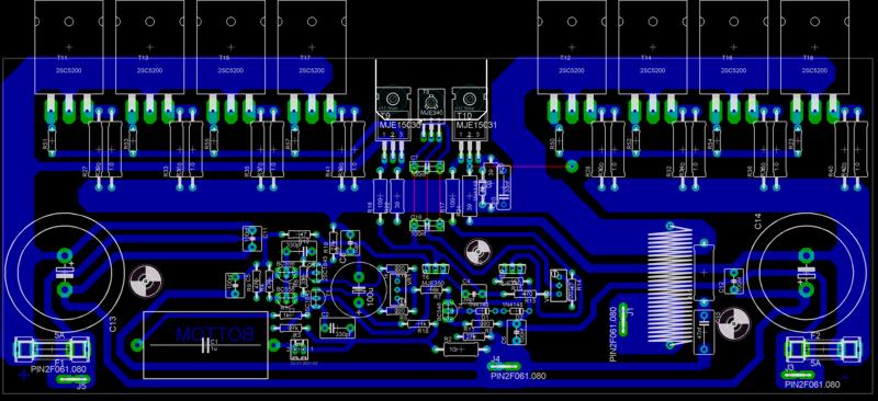

i would chmange the thicknes of the trace that supply the drivers etc. since the board now changes length wise ...
it seems to me that the trace is kinda small ...
in my boards i made them bit thicker but also feed them with aditional soldering for the all length
regards sakis

Good advise I will modify this point , and lay on some solder.
Marc

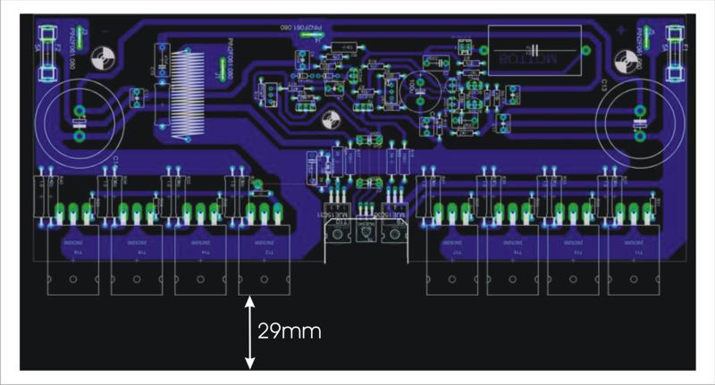

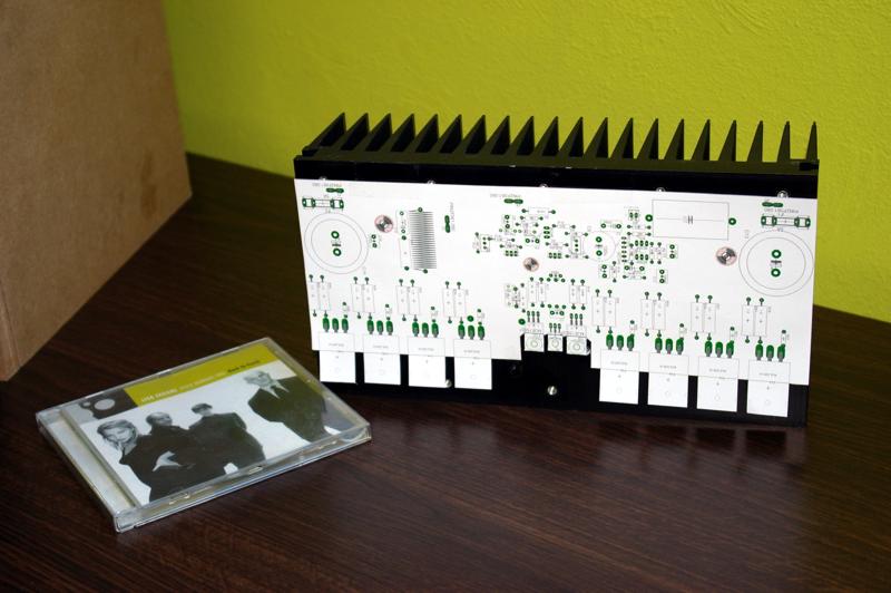

So here the latest evolution with my design. I optimise the board size to fit to the heatsink i have in stock and to the pcb board i can by and manage. With a 300x200mm borad i can etch two amp board.
The heatsink mesure : 265x140x75mm with a 15mm base thickness.
Sakis : i grown the driver supply trace.
Marc
Marc

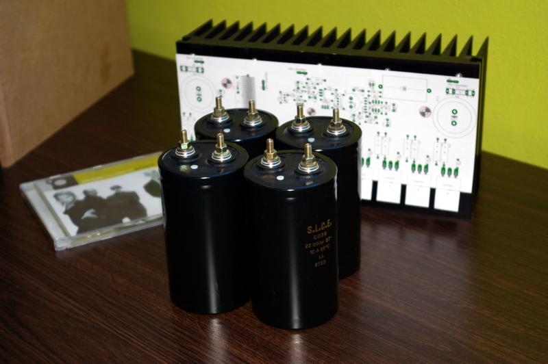

I will buid a first stereo version with parts i have in stock 'most of them came from industrial rubbish) : 4x 15.000µf/53V, 2x(330va 2X15V) I will put secondary in serie to have 2x(330Va 1x30v), heatsink above on picture, 16xMJL3281A from Onsemi. Then If i succeed i will build a second sterao amp in monoblocks form. I will then choose either 30vac or 35vac for supply depending how the first version will drive my speaker.
Marc

Hi Ide,
try to get your output devices bolted to the sink about 50 to 60mm up from the bottom edge to get best dissipation from your 140mm tall heatsink.
Your present PCB layout makes this impossible. You cannot turn the PCB to horizontal because the devices are not at the edge.
AndrewT said:Hi Ide,
Hi andrew,
The latestet version is 10mm small then this on heatsink on picture. With the new version if I placed the board on heatsink top there is 22mm beteew bottom edge and begin of output device I will look how i can manage to apply your advice. Brackett I have are 50x50mm (thickness 3mm) could allow this, but the first statement was to not use brackett
Marc
Nice board...
Idefixes,
I have to say your layout is wonderful, very neat, very artistic, and very good technically. You handle minor criticisms too with grace, I take my hat off to you,
Hugh

that's better than many can manage.Idefixes said:With the new version if I placed the board on heatsink top there is 22mm beteew bottom edge and begin of output device
The loss in heatsink performance will not be great, just be aware of it.
So i manage to change the output device position on board.
There is yet 29mm between heatsink bottom edge and output device begin.
Marc
Marc
