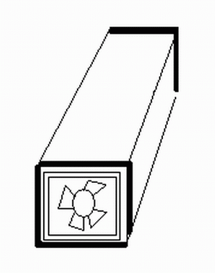

I think your heatsink may work with 100 plus 100 watts RMS
and three times more if you decide to use paper tunnel and installing two fan blower, one pumping air and other exausting air.
But use a lot of thermal grease into this "L" shape adaptor, because there you gonna have a lot of thermal resistance.

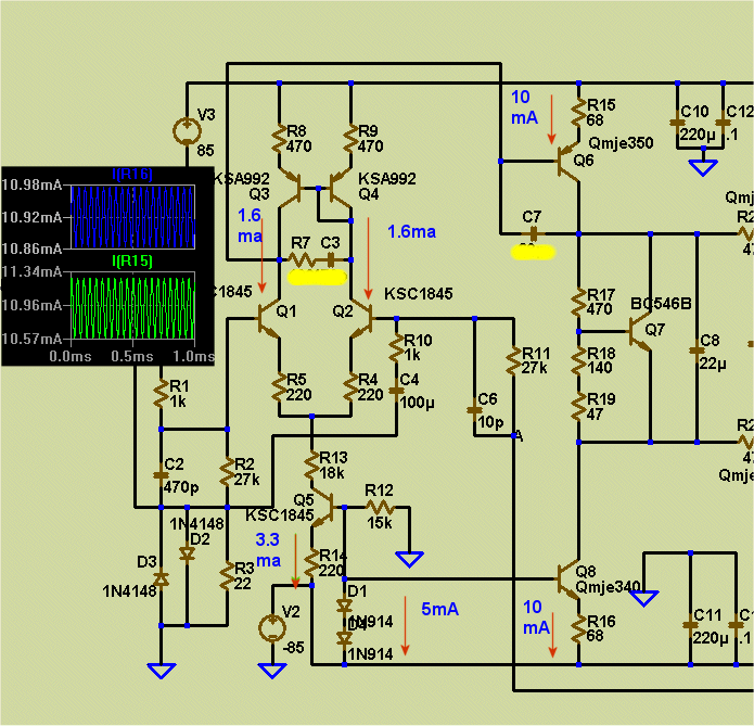

ok ...here is a question ...
i have a box that previously used to be an altair MF 16 Big mosfet amplifier> we asume that this amplifier has been hit by thunder cause there is no other explanation of the extnsive damage that the boards have .
caps are in perfect shape though Trafo also rectifiers are to be replaced anyway just in case i dlike very much to bulit a quasi inside there since the rest og the hardware exists BUT BUT BUT rails are almost 85+85 volt at no load condition
Do you think that a quasi with 10 outs will work under this rail voltage ????
may so many outs require base resistors also ????
here is a thread that i started with the intention to change/rewind the trafo and here is how it actually end up http://www.diyaudio.com/forums/showthread.php?s=&threadid=144445
quoted by os (ostriper )
Why not port the BO quasi to handle 85V? I use same OPS / input
with +- 80v all day !
Make all rail caps 100V , Change T2/3 to 2sa992(120v) and T4 to another 2sc1845(120v). use mje15032 / 33's for drivers(250v) , make r8 240- 270R.
A lot easier than rewinding the trafo. With 27K Rfb you will never clip , but be aware , at the higher rails you will be approaching SOA limits.

Agree. +-85V isn't that high. Actually, less than 10 pairs should be ok. How many will fit?
As a comparison, the Crest CA4 has +-90V rails and just 4 pairs of 2SC3281/2SA1302 in series-parallell (to get better SOA at high voltage). MJW21194 has better high-voltage SOA so series-parallell won't be necessary. Also, these are rated 200W instead of 150W like 2SC3281.

Sorry sakis , I only guessed before with my BOQ advice. I was close. The only issue remaining would be increased VAS Iq (14ma+). The (attached) schema will show the changes. the higher Vce drivers- mje15032/3 and 2R2 base stoppers + 5 pair are
absolutely guaranteed. All currents and values are very close to lower voltage BOQ , so original performance should remain the same. 🙂
Edit - you might want to up r12 (15k) to 22k for 3mA across diodes... I use red LED at 20k = 4ma.
With 5 pair and the same feedback you would never ever clip and not exceed the power rating of the original BOQ but might have a
little more headroom.
