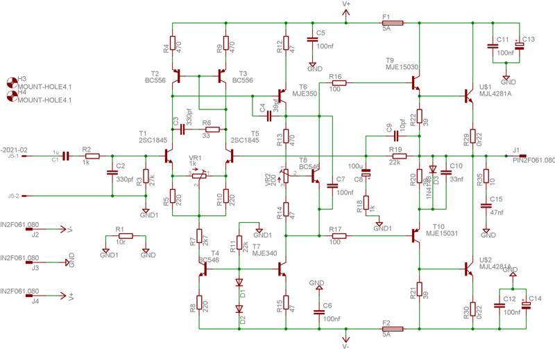

oki doki
up and runing
had to debug a couple of mistakes i ve made
data :
63+63 volt rails
6 pairs MJW 21194
arround 200w
the only problem i get is that at idle even if idle is 40 ma the pair MJE 340-350 gets pretty warm ....dangerous warm id say ....i wonder what will happen in full power ...
all is as in the original schematic except MJE 350/TR6 miller cap instead of 39pf is 33 pf since this was available in a good quality
in the pair there is a 3x5cm x2mm piece of alouminum but doesnt look really enough
also at square wave arround 10khz i got my shelf some ringing
have i missed something ????

Stereo SPLs
at full power most listeners expecting high quality will be using an average output of ~2W.
The heatsinks will hardly change in temperature compared to the quiescent condition.
If you are using 87dB/2.8V/m speakers you will be achieving average SPL levels ~93dB @ 1m and ~85dB @ 2.5m.
That is LOUD.
I hope you are not expecting Disco quality.
The drivers are dissipating 3W each.
using a 5C/W sink shared between the two drivers will create Ts~=39 above Ta.
Inside the case Ta could be anywhere between 25degC and 50degC.
5C/W is too small for Ta>=30degC.
Check the temp de-rating for Ta=30degC and P=3W

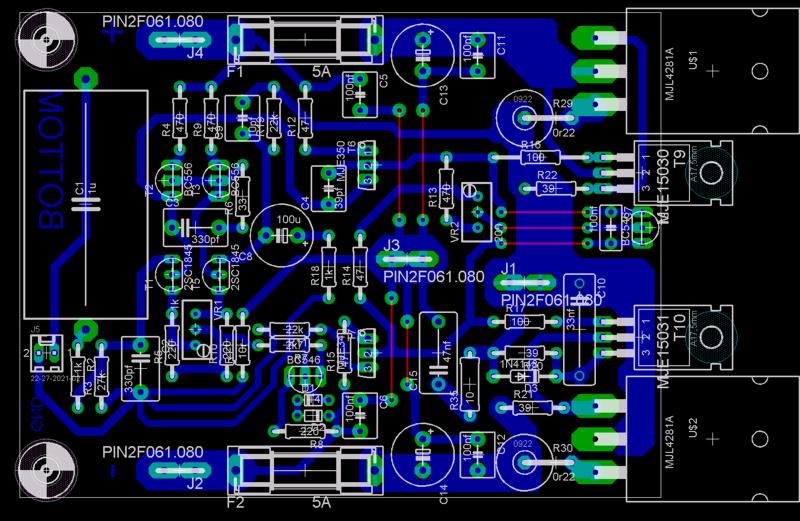

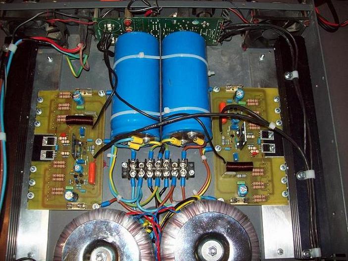

ok ...this done for testing
it is based on indefixe's pcb but features piggy boards with VI limmiters hiden down under ....
it is not 100% debuged yet ita has a few cosmetic issues on the pcb .... it will requiere a bit of better arangement regarding drivers and a bit of space more for for a biger cooler for the pair MJE 340-350
it is working as we speak runs cool smooth scope agrree also so we have our shelfs one more amp .......
particular one is 63+63 rails 6xMJW21194 per board and all the rest as in the schematic ...
at the prize i buy the semis i think that this is really cost effective
i actually have a complete sassi of one altair amp burned beyond repair in the amp boards ( water inside ) but the only problem is that PSU will produce almost 80v ...too much for this amp i think
there you go chief

Re: oki doki
T7 and T6 will dissipate about 1.5 watts so a bigger heatsink for these is a good idea. But they are very tough transistors so don't worry too much.
You should not be getting any ringing with the square wave test, although the output filter may be contributing. Try measuring before the filter. If you still have ringing then try changing all the 0.1uf bypass caps to a different type or brand (0.1 to 0.47 etc is ok).
The bandwidth of the amp is quite wide so you should have great treble performance. Is the schematic exactly the same as the original or has it been changed in some way?
Anyway good to see its working.

Hi quasi, the board is based on a modify early version of mine....based on yours. I juste change TO3 devices to TO264 devices, and adapted placement to parts i have acces. Normally the majors rooting design is based on yours, particulary ground rooting. So The result must be coherant to yours. I made some more cosmetic arrangement to optmise size of board and swap speaker protection outside amp board. I made a sigle pair BJT version based on Nmos200 rooting. I will post later this to work to have your (and others) opinion. Take care that tis work as i wrote it over is not tested and perhaps not completly debbuged.
regards Marc
regards Marc
....more results
well thanks quasi for looking in to this ..... the amp is just fine the only thing that was wrong was D1 placed with the wrong polarity ...the heatsink is enough ....
now the drivers are getting a bit hot but also they are not placed in a proper hetasink ( not located in the main heatsink for a number of reasons )
idefixes pcb is perfect ....
to my opinion though some cosmetic changes are to be made ....
----i think just a bit more space arround output transistors will be good
---- more space around the MJE340-350 for a biger heatsink
---- and finally outputs and drivers are not alligned properly ...i think drivers need to go a bit more up
otherwise all is fine ...but more tests will proceed and see how its going
as about the ringing ...after replacing the D1 in the correct polarity is gone .... i got some crisp though in the uper waveform of 1 KHZ sine just before cliping .... after and before cliping all is as supposed to ... weird ...but i ma looking in to it

Here is the latest version
Output transistor and driver are direct screw on heatsink without bracket. The board will be cut on driver zone.
Marc
Marc
Here is the Nbip_100 version based on Nmos 200 with one pair of MJL4182 and MJE15030/15031 for driver.
Marc
Marc
The goal is to realise to amplifier for HT use :
- one with 2 NBip_300 chanel (500Va 2x30Vac) => R and L front chanels
- one with 3 chanels (1 Nbip_300 for center and 2 NBip_100 for rear R and L suround). 660Va 2x30Vac for the 3 chanels.
I have to look how to change value of to resistance to maintain gain and current level for input stage.
Marc
Marc
idefixes ....
i think tha yor latest versionj of pcb is runing to the same mechanical error like all the previous ones ....
Drivers MJ15030-31 will require a "large" heatsink , in the original brothe of quasi drawing the drivers +vbe multipier is located in the main heatsink in the center of the all thing so the heatsink will have an easier job to cool drivers down .
locating the drivers so low will need another heatsink ...since the main heatsink ....or a thick corner aluminioum that somehow drivers are placed on and then the small heatsink is thermaly coupled to the main heatsink
let us not forget that also there we need to have a vbe multiplier that needs to be functionable also ....
cuting the board has to be factory made otherwise will look to ugly ( that is not cost efective )
also the all think is not versatile this way since only massive heatsinks can be used and any corner brackets is simply out of the question
just an opinion

you even
have to cut the insulation pads .... to fit them in to transitors .... too close to each other ....some mm more to each needed i think
