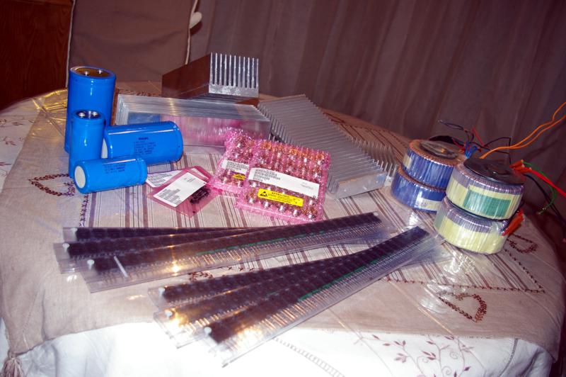

I begin to collect together the possible part for BoQ i have on hand.
Most havy of parts are from industriel rubbish ( Caps, heatsinks, and the 2x (336va 1x24v) blue tranny). I have two 3 batch of 25 MJL1381A and 3 batch of MJL1302, 25 MJ15003, 25 MJ15004, 25 MJE15030, 25MJE15031, 25 BC556, 25 BC 546. Since Nbip is based on NPN i will clearly use MJ15003 or MJL3281. Any preference for one?
I will build one first version on AndrewT advise : 3 pair NPN output, i will first use the two yellow tranny above. They are 400va 2x18v (il will put secondary in serie to obtain 1x36Vac). If i find amp suit i will by a 500va 3x35Vac pour final buid. Next step could be building 5ch with 2 output pair pro channel for my futur HT/music room.
Marc
Marc

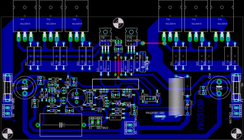

Hi Marc
That looks like an impressive bundle of parts. Did you say you got them out of rubbish? If so, nice haul.
I used 200v capacitors for the on board filtering because I get access to lots of old PC power supplies and strip the capacitors from these. You could use capacitors you have on hand provided their voltage rating is more than your supply voltage by at least 10% (maybe 20%).
A TO264 transistor may not have the desired characteristics (gain, thermal change). Try using a TO126 transistor that will still give a screw hole mount.
Cheers
Q
Cheers
Q

quasi said:Hi Marc
Cheers
Q
Hi quasi,
Yes most parts came out from industriel rubbish. These are only samples i selected from stock for BoQ. Quasi i don't understand this :
The To264 (MJL3281A) transistors I have may be used only in Output stage as power transistors. Are they not suited for this employement? If there are is they a significant difference in sound personnality compared to MJ15003 ones.TO264 transistor may not have the desired characteristics (gain, thermal change). Try using a TO126 transistor that will still give a screw hole mount.
For driver I have MJE 15030/15031. For To92 i will use 2SC1845, BCC556, BC546.
I will use a voltage rail on about +/- 50VDC, so i don't need 4 output transistor pair. I redrawn your layout for my propre use. Since I have my own DC protection i deleted it from amp board.
Marc

here is the adaptation of quasi layout to TO264 package for 3 pair of NPN. The board as been downsize 215x110mm.
The quasi layout spirit (grounding methode, VAS near input stage for exemple) as been keeping. Transistors will be mounting direct on heatsink. I will try to switch BC546 for thermal trakinkg by 2SC2911 for better heatsink mounting.
Marc
Marc

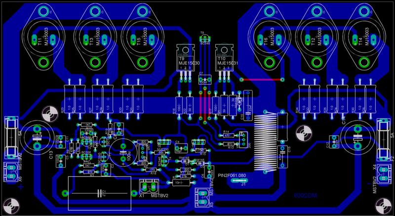

I made some little evolutions on TO264 board to reduce the pcb size a little bit
In the same time i manage to root a lighter version with 2 bipolar pair. It's for HT use or for more sensitiv seaker.
On Nmos tread quasi give some tips to estimate the number of necess
On Nmos tread quasi give some tips to estimate the number of necessary transistor pair based on power there power dissipation rating. I supose i can use this tip for bipolar. I will a highest use 35VAC trafo. The most power i could expect is about 190W/4ohm. With one MJL3281 and 360W power dissipation at 30% handle 360x0,3=108w with 2pair and 216w it seems to be good enough for my requierments. Am I right? In the same order Quasi shown on his web site a table with resitor value adaptation function rail voltage. Since mosfet and bipolar version of quasi have same topology at these location could the first one modification applied to the second one?
Marc
Marc

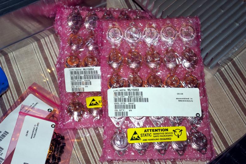

Hi Indefix,
I have seen you got a bundle of MJ15004 with you. Since you are using 15003 only for this, would the 004 be just lying around? If you might be interested to 'get rid of them', wonder how much you will ask for and they are directly from 'ON's ? My email :
tony_chan_cf@email.com
I have some new boards for the Quad303 and can use 2 x 15004. so I am trying to get some stock but my vendor sells them at 100. If you are keeping them, could you tell me where you get them (you get them by 25pcs/bundle , right?).
Tks
Tks
