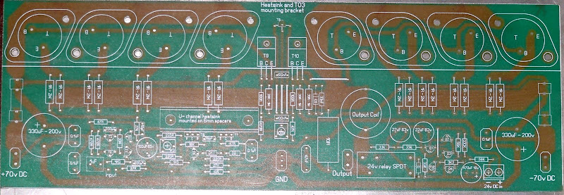

Penjim, very nicely done amp. Could anyone tell me how much the board measures?
Also, with the original +/- 70V supplies and 8 output transistors, will the bipolar amp be able to drive a 4 ohm suboofer?
Vivek
Vivek
The PCB measures 276.9mm x 93.3mm.
With 70 volt rails and with the specified transistors (or similar) it will drive a 4 ohm load all day, provided there is good heatsinking and ventilation.
Cheers
Q

Bipolar Quasi
I would like to build an eight channel amp...I have some MJL21193-MJL21193 available. I was thinking of making a pcb layout for the bipolar quasi for the TO-247 package using (2) MJL21193 and (2) MJL21194 output per board. Would 4 output devices be suitable for +/- 45 volt rails ? How about +/- 55 volts rails ? Would I need to change any resistors (like on the NMOS200 for different rail voltages)? My other option might be to redesign the Leach TIM amp for TO-247 outputs. Thanks for all the help!
build a one channel amp as this first project get it working. Test it, listen to it. See how well it drives your speakers then decide if you want an eight channel amp.

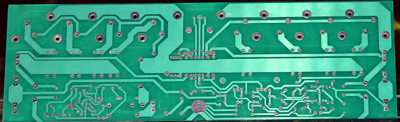

My Version!!
Hi Quasi 🙂 , me and my buddy are building this version of the Amp ! he has already communicated the same with you !
As you had asked Am attaching the pics of the PCB ! Please comment on that !
Also we were wondering as which would be a perfect match for this ?? could please help Us out 😉 ?
I've built the Mos version and we compared it with many other amps ! and Am glad to inform you that it kicked butts of all the one's we compared
Regards.
Regards.
