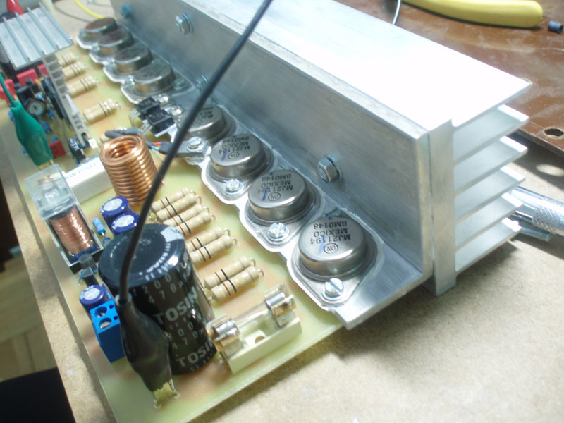

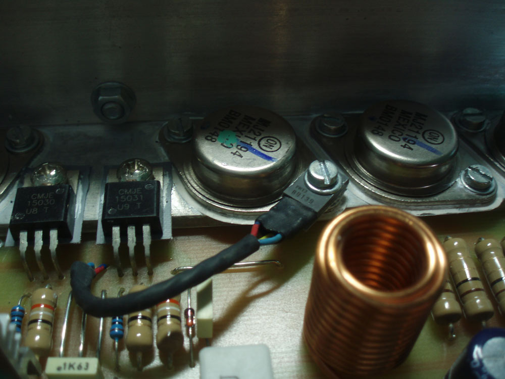

Hi to all,
First module up and running!!!
Bias current set to 160mA, offset voltage under 10mV. Main heatsink barely gets worm with no input, predrivers heatsink is at room temperature. For T8 I'm using BD139, mounted on one of the power transistors (close as possible 🙂)...
I already try some music, and very pleased with sound, although with small lab power supply (+-35). Amp is dead quiet with no signal on input (just like his mosfet brother).
One more module and then mounting all in the case!
THANKS QUASI FOR ANOTHER GREAT DESIGN!!!

Congratulations Miodrag,
You have done a great job. Soon you will be able to tell us how the bi-polar amp compares to the MOS amp.
Good luck with the rest of the build.

Nice!
Miodrag, how did you wind (and keep) that coil so perfect.

Hi Todd,
Salvaged from blown Crown amplifier CE3000...

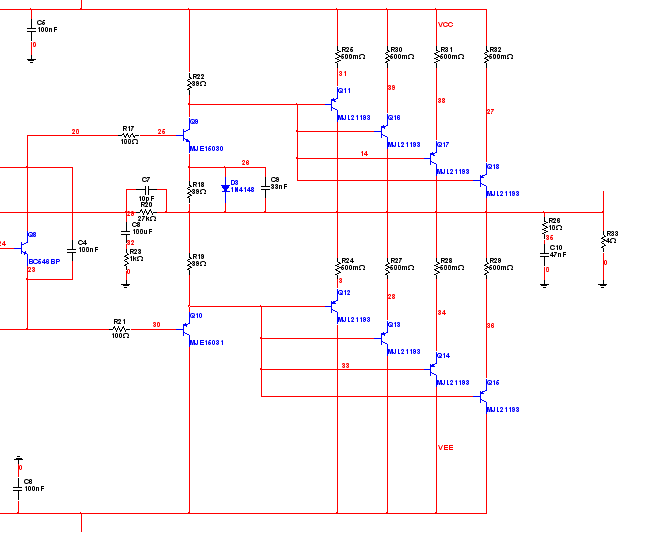

hey if i change the output stage like this so i can use p type transistors instead of n type (reason being i have 50 mjl21193 laying around)
will the amp work fine?
guitar_joe said:hey if i change the output stage like this so i can use p type transistors instead of n type (reason being i have 50 mjl21193 laying around)
Of course! It should work with PNP output stage!

Hi pejinm,
Did you measure the value of that nice air coil of yours in post134? Can you give a bit more detail of it? say T, D, d ?
The way I mount my TO-3 is to drill a 5mm hole on the heatsink,
putting in M3 nylon washer 1mm thick and whatever height that matches your heatsink thickness and the M3 screw thru it. Seems to be a little more handier than thermal shrink insulation. You might smear your thermal shrink but I don't think you can ever crack your nylon washer. Just another alternative to what you are doing.
