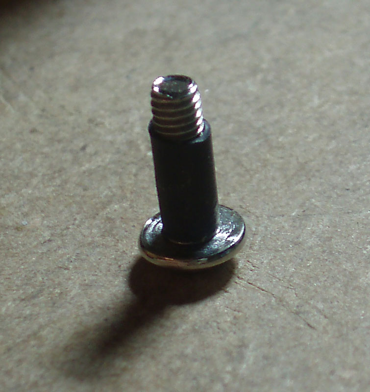

Hi all,
I got two question.
Should the heatsinks be on ground potential?
How to conect colectors of power transistors with pcb and not to make contact with heatsink (short)?

yes,pejinm said:...is this the idea?
thermo-shrinkable isolation around the screw...
and an insulating washer under the bolt head.
You can buy "top hat" insulators for this purpose.
Some packages are isolated around the hole to allow the use of a standard uninsulated bolt fixing.
Hi Andrew,
Thanks for reply!
But if I put isolation under bolt head, how should the colectors be conected to PCB?
Miodrag

Hi pejinm!
Like quasi's image show or demonstrate, but use silicon insulating around the screw.If you don't have call me (cimni me).
Regards zeoN_Rider

Thanks Quasi,
Your image Quasi makes it clear, I recon it something like that...

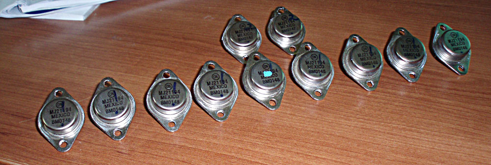

Hi Guys,
Earlier in my posts I mentioned, that I salvaged 13 of MJ21194 transistors, from the blown crown ce3000 amplifier.
All of them have some kind of markings on them. I think they come from manufacturing process.
My question is, do I have to take this markings seriously?
Is this mark the paired/unpaired devices?
Here is the photo...
Thanks in advance for reply!
Miodrag
EDIT:
Also, the ones with "2" write on them have additional marking BM0147 in difference with the ones with "!" (BM0148)
Also two have dot marked with green pen like one in the middle...

I think you will need to measure them to see if there is a correlation between the markings and the test results.
