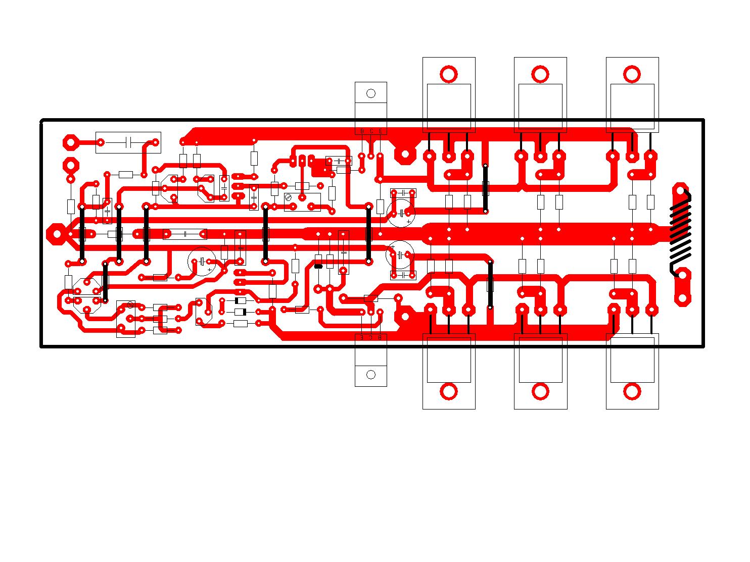

ok here is a pcb i ve made that is especially designed to meet a specific size of board box and heat sink i have
since this was a quicky please let me know what do you think and see if you can spot any error
thanks

it looks excelent i thing but my friend you are in the wrong thread this is the bipolar version of quasi ...
also your pcb is double leyer .... in a double leyer you can do miracles regarding space but you cant be realy sure what is going to happen before you test the board regarding induction and capacitance between traces and leyers ...

Hi Sakis,......what you dont know,.... this is a combined Quasi PCB
I can use it as bipolar or mosfet Quasi

sorry i missed that
if so then this is really inovative

Hi Sakis here is the schematic... for bipolar we have to add devices in PCB
VI Limiter is from Big Power PA Amp, to design this Quais PCB was a lot of nights work
If you have ideas to improve 🙂 or find faults... send me message

as about the schematic and your pcb i have to say that looks like a pretty well made job on the other hand though i have to be very skeptic regarding an untested device and/or schematic .
