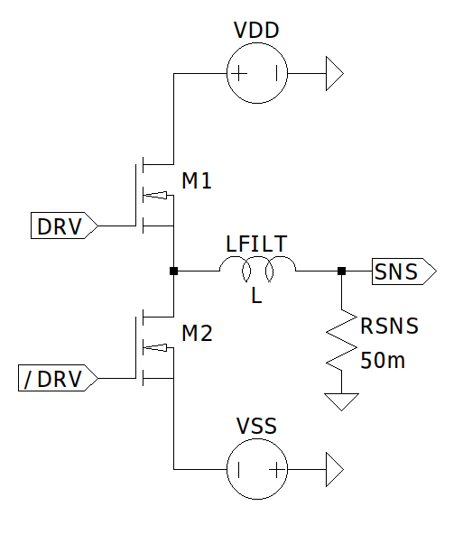

This occurred during very moderate load testing, but it does not happen at the lowest levels. For my loudspeakers i need all (or nearly) all the power available from the Purifi modules, so I need the full rail voltage. Also, even if the one lowers the voltage, if it is jumping around all over the place, thta kind of defeats the purpose of the "regulated" supply?
With your efficient speakers of course this may not be a problem with your set up, have you monitored the Connex rail voltage during high level music playback, I am just curious?
I am a little surprised that Audiophonics had this problem with the Hypex supply though? As i have seen full power tests of the Purifi modules, powered by the Hypex supply where there was no actuation of the protection circuits whatsoever? The ASR website did full power testing with the Purifi demo amp, and never once had any issues with the protection circuits kicking in...so I have to conclude that the Hypex supply did not have the same over voltage problem?
This is somewhat to be expected when one uses a regulated 65V supply, since the regulation will defeat the tendency of the supply to sag under intense load and therefore inadvertently facilitate supply pumping. Apparently with their design Audiophonics incurred in this phenomenon with the Hypex supply as well and they declare they have done steps to mitigate that.
I know that the future Purifi power supply is going to be at 65V and regulated. This means that they must make sure that the increase in voltage is less than 8% in order not to trip protection. Indeed, this is one of the reasons I chose to pick the 54V supply (which was readily available from Audiophonics) and I did not order a custom one (and if I had had to, I would have probably ordered 60V not 65V).
Well, yes and no. It is to be expected in a power supply where the VCC and VEE are coupled by a transformer, but only one of them is regulated. You could build a regulated supply where both VCC and VEE were regulated. Such a supply would not suffer from supply pumping.

Only in the sense where both rails are regulated in a manner such that they can both, both, source and sink current either to each other or back to the input supply. Otherwise the pump is still on.
It's what they say about that:
What do you think ?Both modules are driven in opposite phase, to cancel out the «Power-Supply Pumping» effect. This allows greater stability in the power supply by alternately distributing current draws on each rail, thus increasing its overall capacities.
Driving channels on the same supply out of phase is common practice and goes some way to ameliorate supply pumping. The assumption is that low frequency music content, the biggest contributor to pumping, is in phase on both channels. Pumping involves the transfer of power from one rail to the other. Inverting the phase on one channel causes it to pump in the other direction assuming both channels are reproducing the same signal. Having inverted the phase of that channel you have to connect its loudspeaker in reverse to restore the phase. Bridging two half bridges completely prevents pumping since the amplifier is behaving as a full bridge where the issue does not arise. Beyond that you might consider taking an active route the simplest of which would be to run a dummy Class D amplifier to regulate the rails against relative variations using current mode control and driving into a zero ohm load. Conceptual piccy...

The Hypex SMPS1200A400 is made specially for single ended amps like the NC500 or the 1ET400A02B – and there will be no pumping – as it does not use rectifiers in the supply but instead have mosfets that can sink current.
In case with the Connex or a transformer/rectifier/capacitor supply you need to connect the channels in reverse phase, and/or have plenty of capacitance…
So with e.g. a 4700uF it should not be an issue when playing music."
