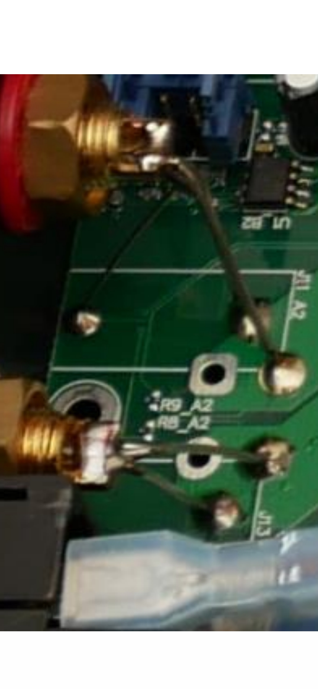

I am going to use wires to the eval board for the output to the speaker binding posts. I do not think I am going to bother extending the sense wiring to the binding posts-to me this seems like much ado about (nearly) nothing. I suspect that as long as the output wiring is relatively short, and of sufficient gauge, there will be little to no actual advantage, and perhaps even problems could develop (RF pickup by sense wiring, possible?). I will likely just make the sense connection on the eval board. My speaker output wiring will be short, ~3", and 12 AWG.
I just stepped over this @ASR.
Can somebody tell me why they use 2+1sense wires per leg on the shown image?
Is it just to cover for high current situations!?!?
When I was looking at some of the DIY build images I can't recall to see a sense wire
going to the outer binding posts. Obviously there are different ways to handle this.
Or perhaps the impact when choosing different positions can simply be neglected.

Just for testing I'll attach a sense wire straight to my speaker cable.
That'll bypass all the LCRs in between.

From the purifi reference build
