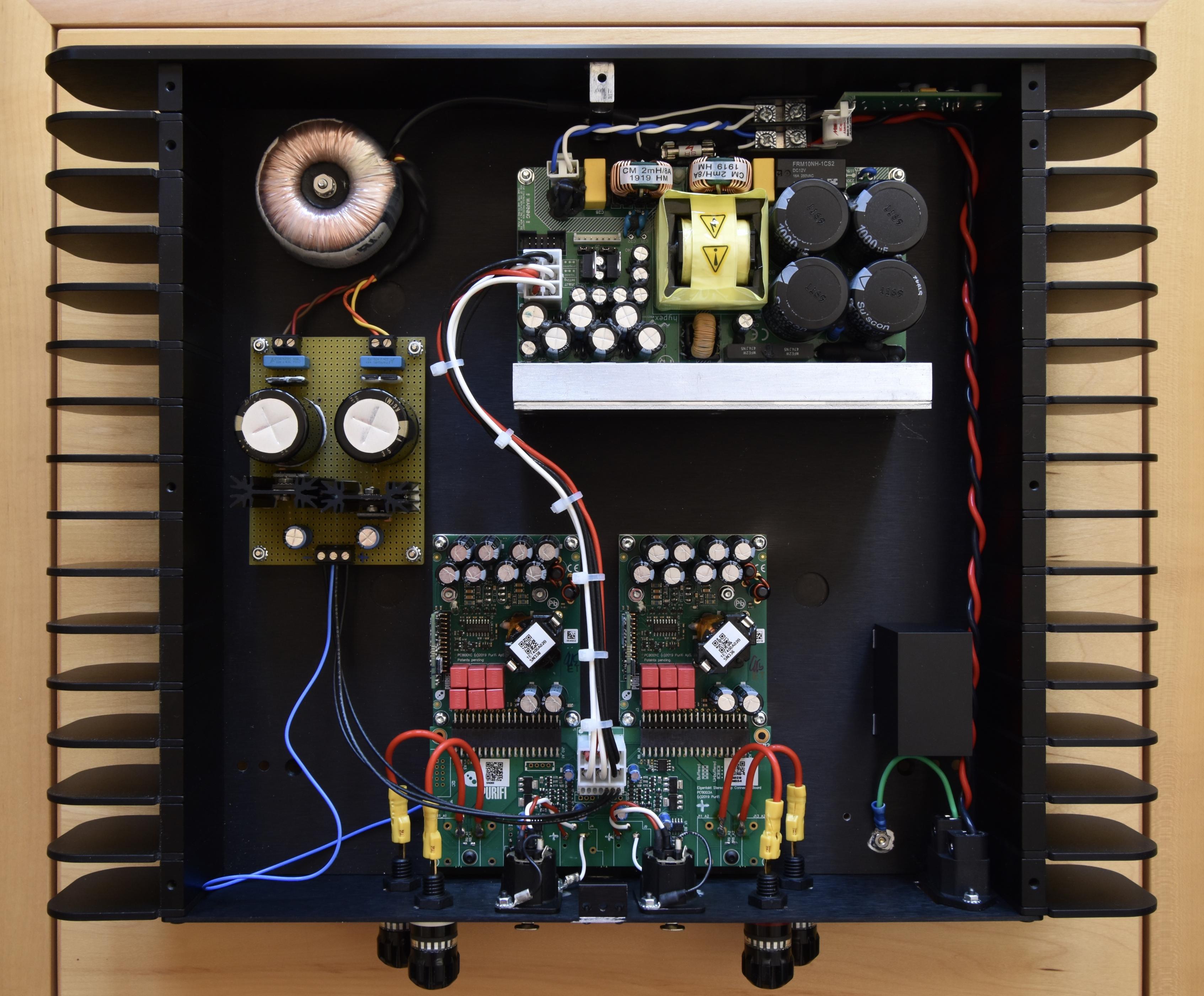

Here is my Purifi build, some details:
Custom linear supply for +/- 18 VDC to the input stage and modulators
WBT 0708 binding posts
Neutrik XLRs
I have been too busy enjoying the sound to wire up my standby switch yet, hence the blue nAmpon wire just tied to ground. I'll get around to it eventually.

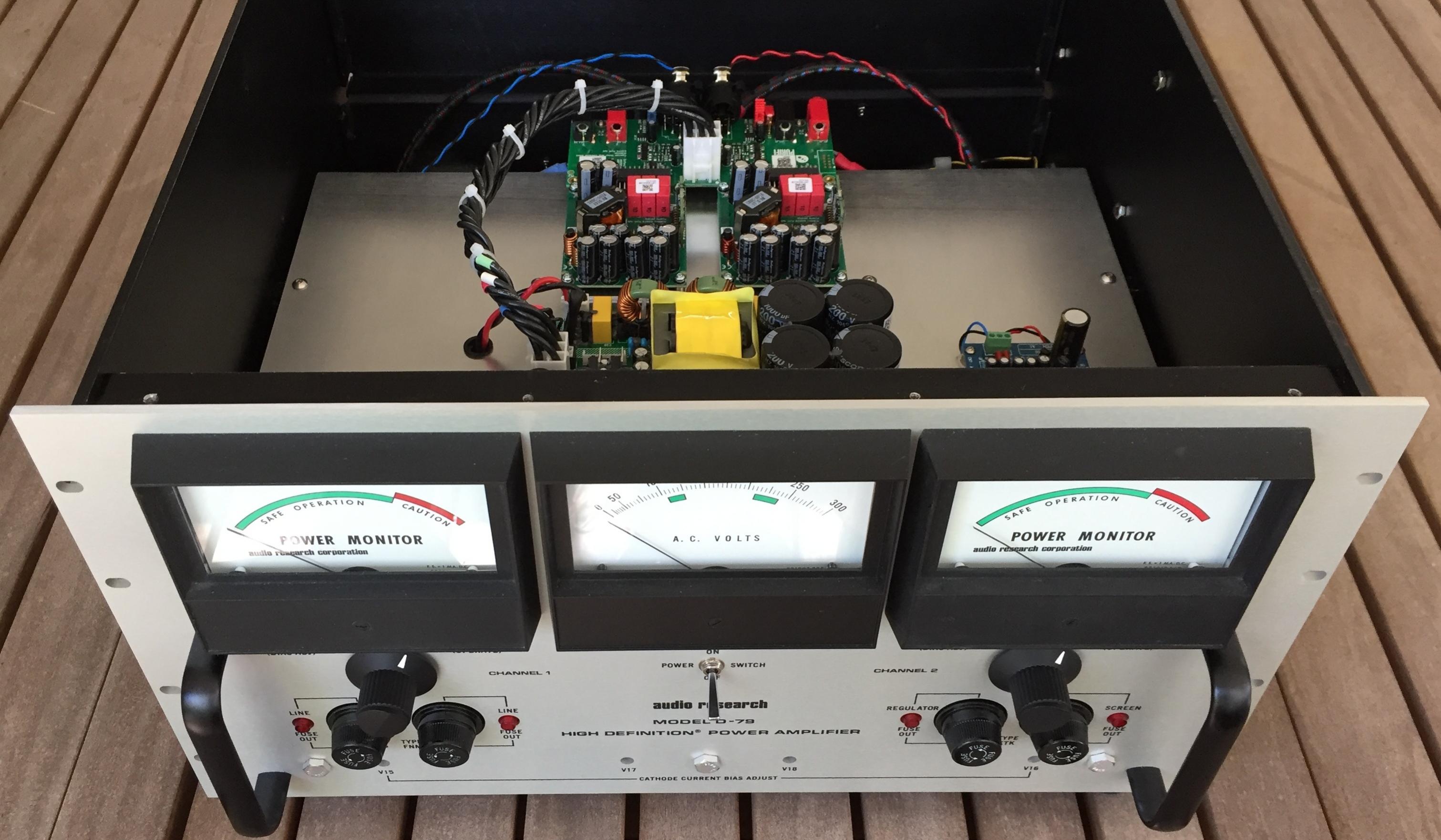

Another Purifi amp build - in Audio Research chassis
Here's my Purifi amp build using a vintage Audio Research chassis. Details here:
Purifi Amplifier Project
Mike
Mike

Very neat builds, congrats to both of you!
Once you spend more time listening, do tell us about your impressions. Also please share a bit about your system and what amplifier the Eigentakt is expected to replace/dethrone.
Have fun listening!
p.s. mikebarney, visited your website where you've documented your build - well done and should be helpful for other folks.
Have fun listening!

Hi, may I ask where you bought your very nice enclosure ?
Jean Claude
Actually...
I work in high end audio for Sonore. This chassis was obtained from the chassis supplier we have build our chassis for Sonore Signature Rendu SEoptical. It is not actually available to DIYers in general.
Jean Claude
Ah, understood. The enclosure was one of the very first I've seen yet with some thought of what the dissipators should be to exchange heat with outside passively

thanks for your opinion. My friend just built one last week His initiate impression is, purifi has power but lack of dynamic. Did u have such experience? Would it be better after burn in? He didnt use LPS for the buffer part. He just use the unregulated power from the same Hypex power supply.
One last question, when u imput LPS,do u need to switch the jumper or something? Purifi buffer has its own regulator
Ummm...
1. I perceive no problem with dynamics here with my build.
2. I do believe the amp has improved after about 200 hours of playing time.
3. My linear supply for the input stage and modulator section is set to +/- 18
VDC, so nothing needs to be changed on the Eval board to accommodate it.
Yes, the Purifi board has onboard discrete regulators which reduce the voltage
to the working voltage. Of course, two stages of voltage regulation are often
superior to just one as long as the regulators used in the first stage do not
impede current flow, my linear supply uses Belleson regulators which feature
extremely low output impedance, so no worries there.
